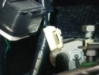

    Can anybody tell me what type of plug this is that goes to the clutch switch for cruise control? Mine did not come prewired for this part of the install. Stalk went into the steering wheel just fine and lighted the dash but will have to wire to get the clutch switch to work.
    So I am trying to figure out what this plug type is called or if someone has one that they cut off from somewhere, let me know.

    I doesn't look like the cruise control clutch switch connector, it seems to be the automatic transmission parking brake switch connector.

    It is definitely the clutch pedal switch. I screen grabbed it from a video that was the same year as my truck.

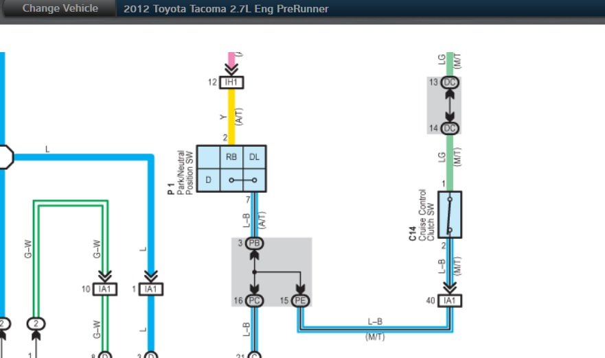

    Cruise Clutch Switch is connector C14, it would have a Blue/Black and Light Green wire going to it.

    Cool! Now i poke around the internet till I find somebody that sells that c14 plug type

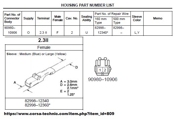

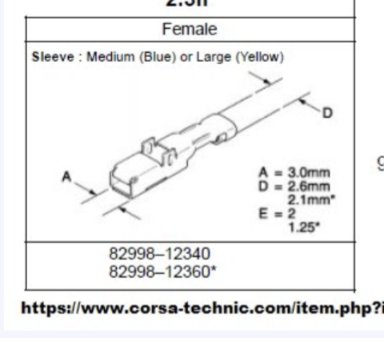

    Thanks. I think I am reading this to include the connector and the barrel terminals? All in one package?

    No, info on the terminal required for the missing connector.

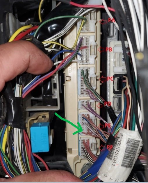

    Are these the same connectors to go on the other ends of the wires that fit into the EM1 and IA1? Have included the pic of IA1 PE#15

    Thanks. I was asking if the barrel connectors you sent me the link for are the same ones to use in these spots also.

    Nope.
