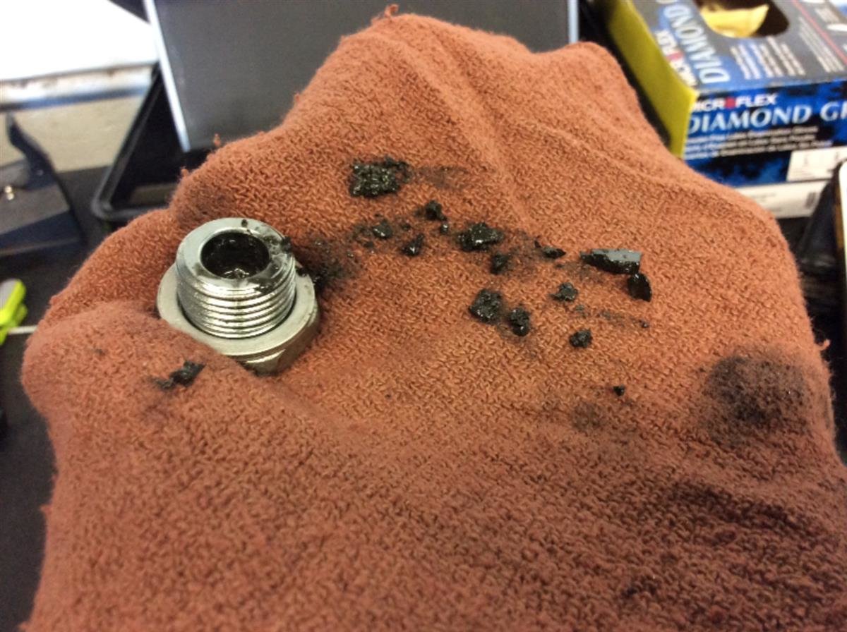

    so this came out of the transmission when changing the fluid. I guess (at least) one thing had to be wrong with this too good to be true rig. the silver lining, my shop seems to think there's still plenty of life left in the tranny but referred me to a tranny mechanic for a 2nd opinion. consensus was that it's not the throw out or input shaft bearing, but something else. I'll report back when it gets diagnosed, but for now, the noise doesn't bother me, it shifts fine, and there's new fluid in there so I'm not losing sleep.

    Mine makes this noise, it's normal. I'd just drive it and be happy if it shifts good.
    Currygoat, socalkid[OP] and Dalandser like this.

    I personally wouldn't invest much having the Tranny diagnosed. If it shifts fine, I'd leave it be. Change the fluid more often... Just be on the lookout for a new tranny. I see them for $300-$600 often.

    I see the tranny he has, W59, for $150 regularly. It's a common tranny and very reliable if your engine is under 200hp.
