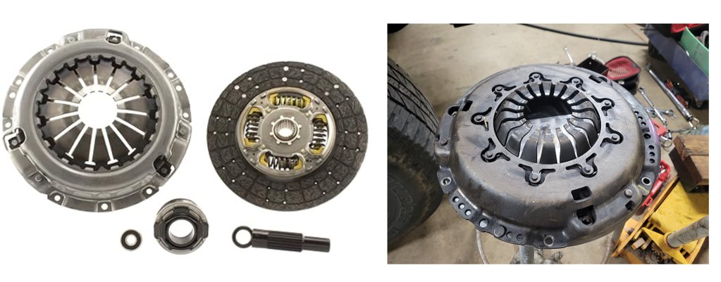

    Had to do a rear main seal. Replaced the clutch, pressure plate, throw out bearing while I was in there. Got it all back together and after bleeding the clutch I can't get it into gear. I can feel the syncros pushing the truck forward when I go for first gear. With the slave cylinder cover plate removed I can see that I am getting full stroke or what looks like full stroke out of the slave cylinder and it feels normal. Slightly easier as I greased everything when I was in there. When I have the clutch depressed there is about 1/4 of inch from the rotating pressure plate and the throw out bearing arm that is pushed on by the slave cylinder. The clutch is an Aisan CKT-057. The pressure plate looks slightly different than the one that came out. I have three things in my head that could possibly be wrong enough to cause this. 1) the flywheel was machined wrong and there is not enough of a step to give clearance. 2) the clutch kit is wrong. 3) there is some adjustment or bleeding procedure that I didn't do correctly. Any thoughts. I really don't want to pull that all apart again.

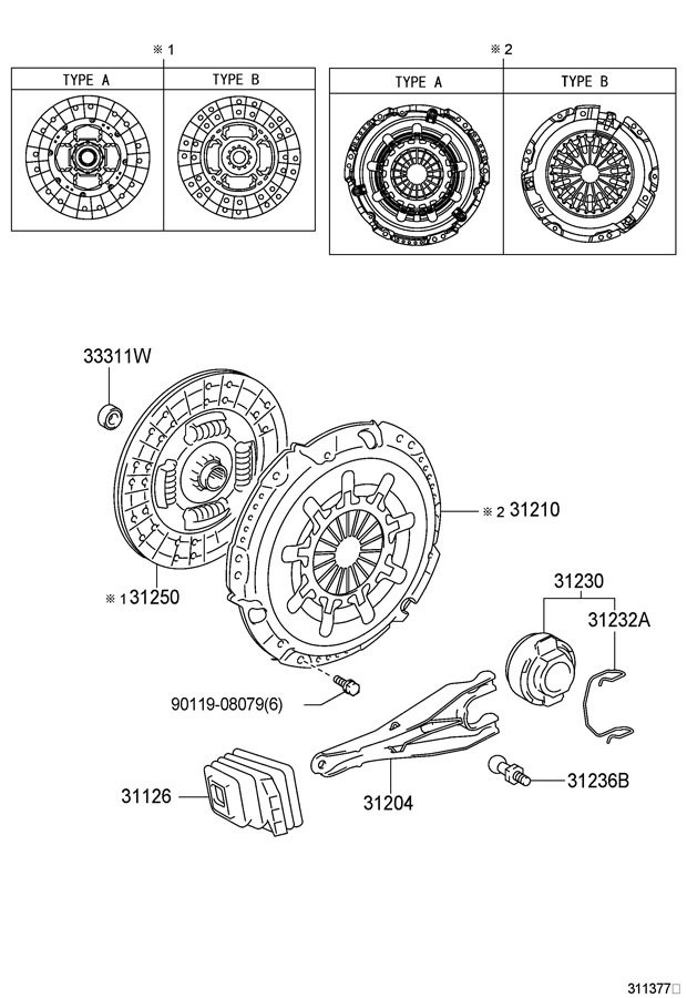

    Generally not, it needs to make contact with the slave cylinder rod. Enclosed is a pic. I was looking at your images. The pressure plates look different (maybe because it's a different manufacturer), not a biggie, as long as the levers/fingers have the same distance to the plate.

    The clutch cover doesn't really look the same at all, yes they can look different and still have the same application.. but the new one looks really different
    Any chance the friction disc was installed upside down? :anonymous:

    Sorry, here's the pic
