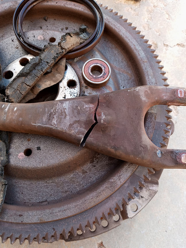

    A few days ago I drove into work with nothing out of the ordinary. When I went to leave, the pedal initially felt normal, but over about 15mi it progressively released lower and lower until it stopped releasing entirely and the pedal felt softer by then. I figured the MC failed, so I replaced it first(and I have a new slave on-hand too). I'm not confident that I got all the air out, but the slave does move the fork about an inch. However, I can push the pedal to the floor easily with my hand and the clutch still doesn't disengage(the pedal always had a rather heavy feel). The end of the fork is also not aligned with the slave push rod; it's about 1/2" lower so the rod is angled. :confused:
    I'm going to replace the slave today, thoroughly rebleed, and double-check the pedal adjustments. I don't know if the clutch is original. If it is, it has about 230,000mi. I also have a new clutch and flywheel if it comes to that. I'm just trying to avoid dropping the trans right now.
    Does this sound more like a clutch/fork failure or a problem with the hydraulics?

    Sounds like the fork pivot pin broke/fell out/wore through or the fork cracked/broke if the slave rod won't align on fork.

    Definitely something I'll check. If that's the case, hopefully it didn't break the pivot post ear off of the bellhousing.

    Annnnd....the fork is broken in half. Guess I'm dropping the trans.

    I was gonna say check the fork for cracks. Had that happen to me about 2 weeks after I put a new clutch in so I had to drop the trans again. At least your 2wd. That should be a cake walk.

    Once you said the slave cylinder was not lined up I knew it was the clutch fork.

    Well, the -20071 fork looks just like the old one. Minus the cracks, of course.
    All done and buttoned-up. New clutch feels much lighter than the old (apparently aftermarket LUK) one, so I suspect that either there was chronic binding in the release system or the pressure plate was unusually stiff, leading to increased stresses that caused the old fork to fail. It had been cracking for a long time before it failed completely. Pivot stud was in decent shape, but replaced it anyway.
