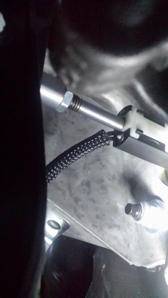

    Look under the dash. See if you can adjust the throw rod that goes from the pedal assembly. It goes from the pedal thru the firewall.
    Adjust it out so it's longer and it will push the master cylinder further.

    This is my Ram but the rod will look like this if it has an adjustable one.20160926_185439.jpg

    I'm not sure if it was the original clutch because I bought it off of some one else. Now I'm the third owner of the truck and the pressure plate does look like a factory one. It has 148 thousand on it. Now I have movement on slave I adjust the ram and still nothing.

    Adjust out that rod some more unless ur maxed out.
    I have a stage 2 in my 1st gen and it took quite a few like 4-5 full turns. Half and inch.

    It's completely adjust out. Now my only thing I can think is I got a bad slave cylinder because everything is refurbished.
