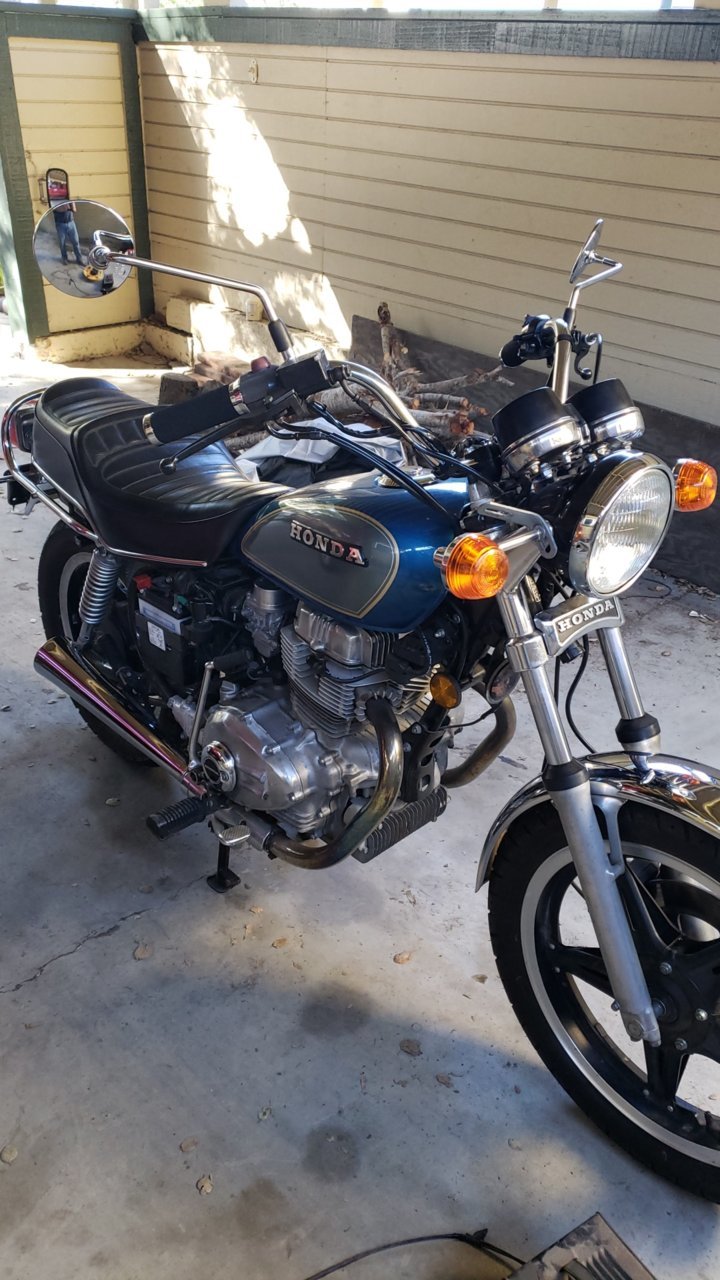

    ok, tomorrow I will be the semi-proud owner of this bike. I can't ride it yet because the mirrors are too low and I want to get a new handlebar for it, similar to the stock style but maybe not as much of a "chopper" style.
    Suggestions of where to get the parts and any tips you may have are appreciated.

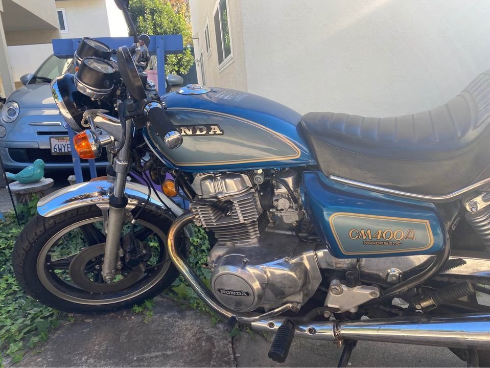

    I think this is the stock handlebar style..

    I get the bike tomorrow (finally - PO issues). Things to do:
    1. swap handlebars (have) replacing mirrors (have)
    2. change oil/filter and new plugs (have)
    3. repair speedometer chrome lower case (ordered)
    4. swap out all lights except headlight with LED's (ordered) when I do #3.
    5. replace controls with chromed versions (ordered)
    6. install new battery (ordered)
    7. inspect tires - find new ones. need to see if current ones have tubes or not, they are a weird size. Fronts are 3.50S18-4PR, rear is 4.60S16-4PR tubeless according to manual
    8. inspect chain, replace? (ordered)
    9. find LED replacement headlight, stock one is useless at night
    10. buy some riding armor. maybe knee/elbow pads
    11. inspect front fork oil/replace seals
    12. install analog fuel hydrostatic gauge (ordered) - inspect gas tank while empty and clean/install inline filter if needed
