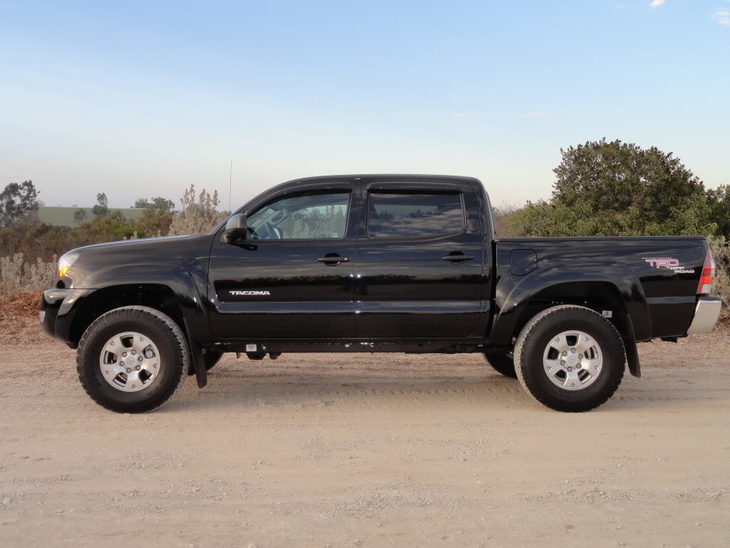

    Just got my 2011 Tacoma Double Cab TRD Off Road about a month ago, and it's time for my build thread! Starting off pretty slow but I plan to add more as time progresses and funds become available.

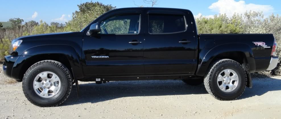

    A couple of days after I got it:
    First off I replaced the stock P265/70R16 tires with BF Goodrich All Terrain T/A K/O's in LT265/75R16 :

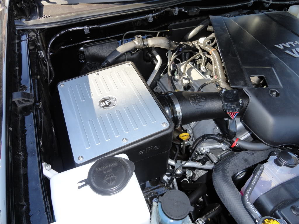

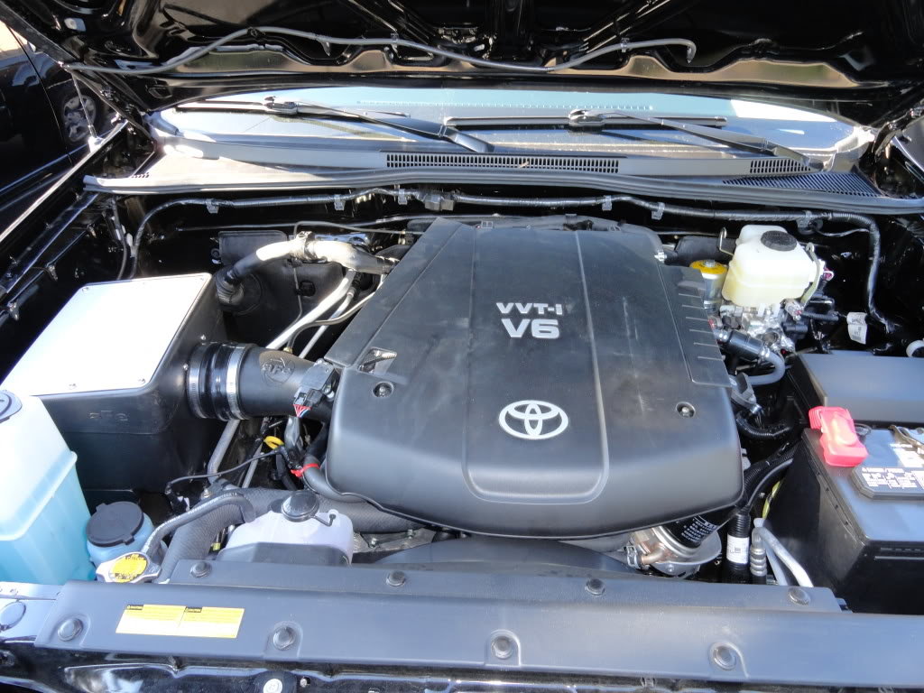

    Next mod was an aFe cold air intake with Pro Dry S filter:
    The CAI was a breeze and my buddy and I installed it in about an hour while we were bullshitting around one afternoon. Like alot of people have posted, the directions that come with the CAI are pretty crappy. However with a little bit of mechanical aptitude anyone can put it in. The truck came with a TRD Cat Back exhaust so as of right now I have no plans to modify the exhaust.

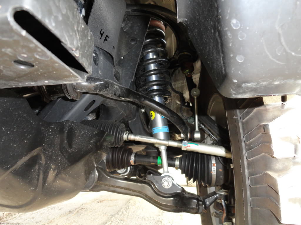

    Today I had Bilstein 5100's installed all around, set at 1.75" up front. Also had installed Icon 1.5" progressive AAL's:
    The shocks and aal's were done at Off Road Warehouse in San Diego.

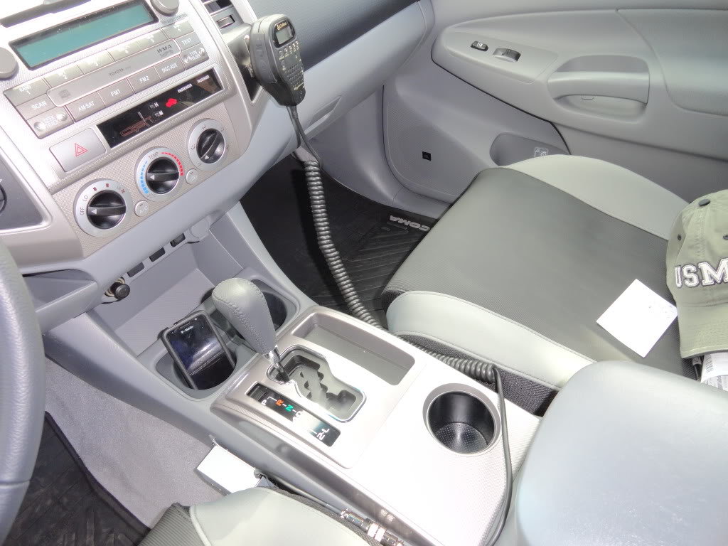

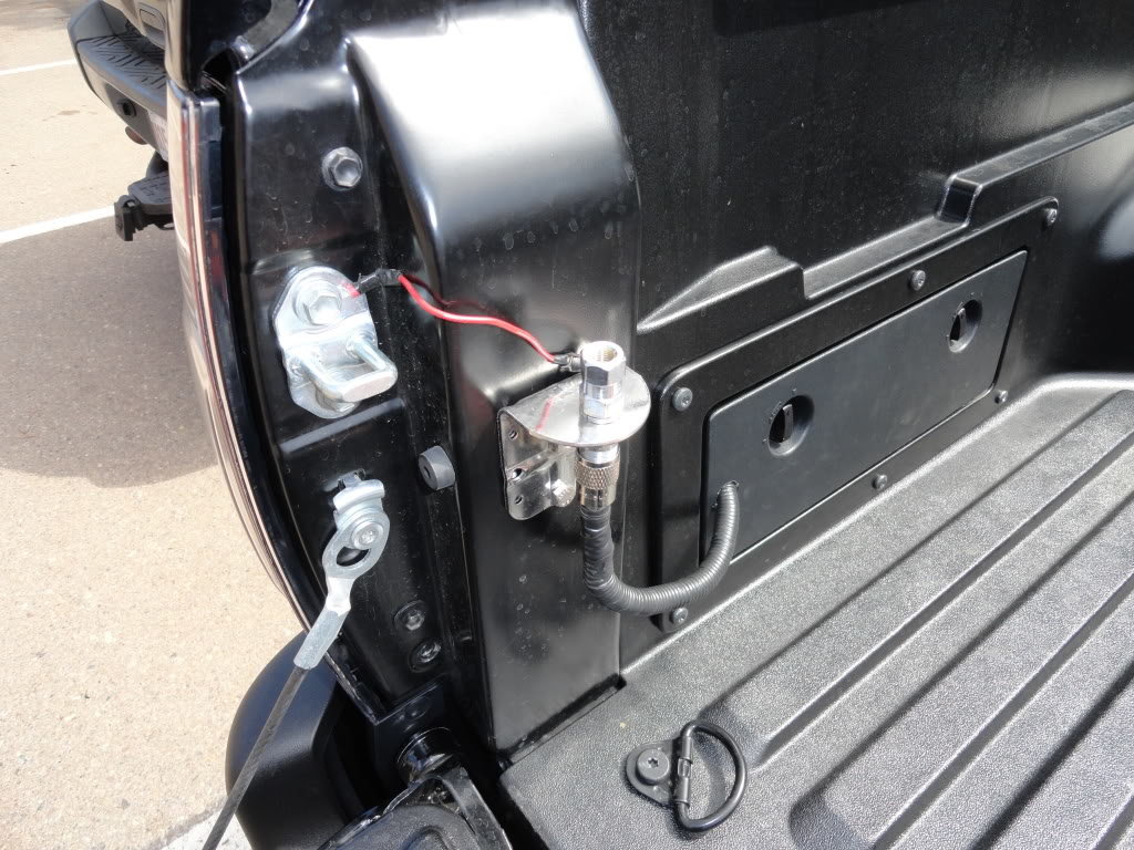

    Well I installed my cb radio Friday. Took me awhile since it was my first time doing anything like this. I installed a Cobra 75 WX ST with a 4 foot Firestik FS4 antenna mounted onto the metal portion of my left rear bedside.

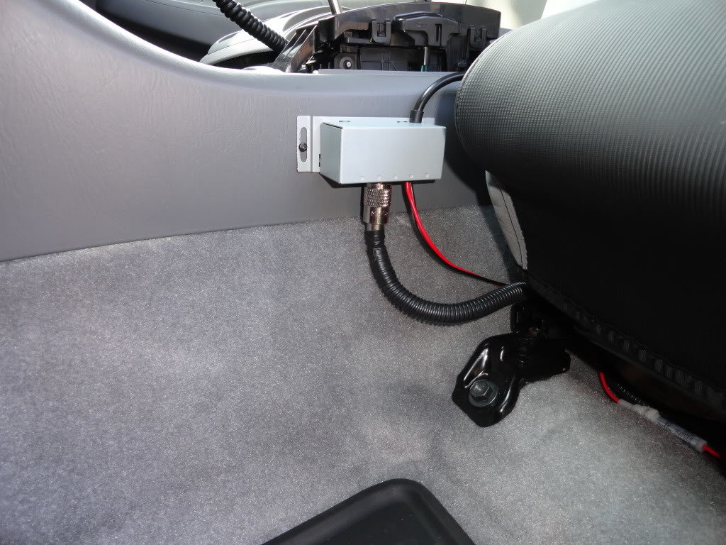

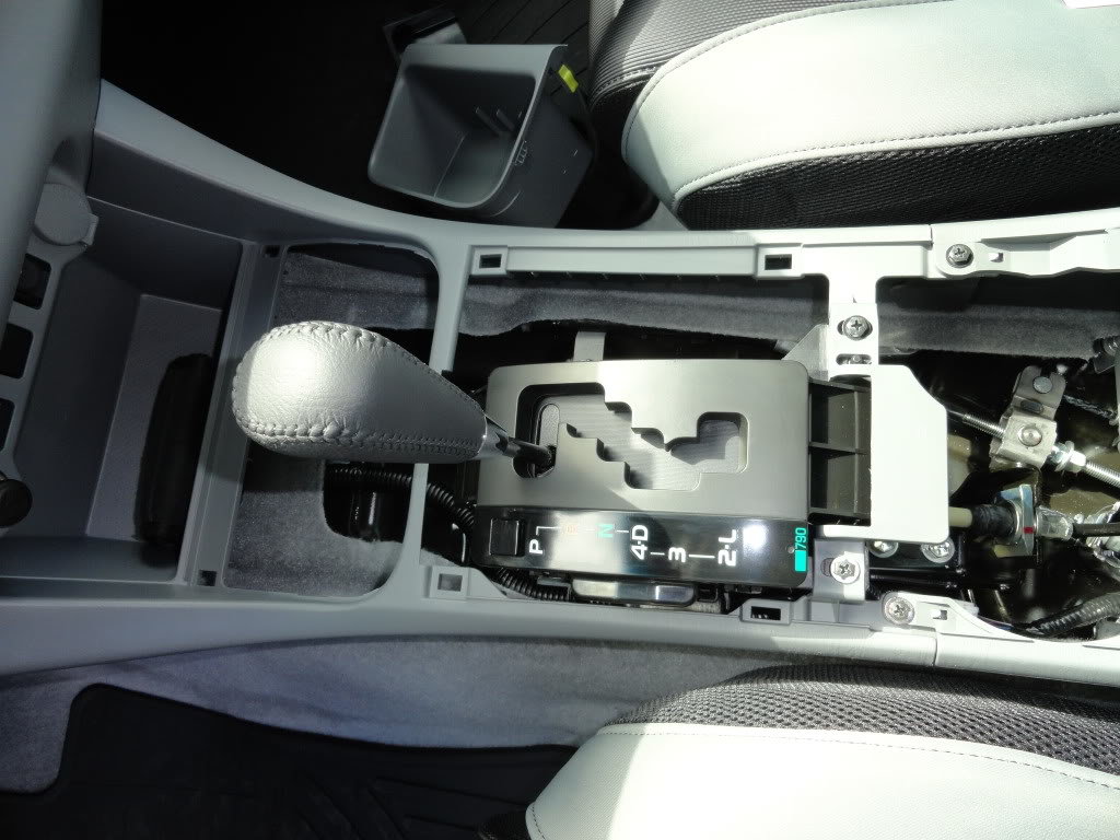

    Opted to install the small connector box for the radio down on the left side of the center console. I was originally going to hide it in the small cubby hole just under the steering wheel on the right side, but it later proved impossible to get to in order to connect the SWR meter. I removed the plastic around the shifter to make sure I had enough clearance for the screws:

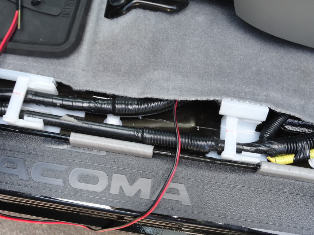

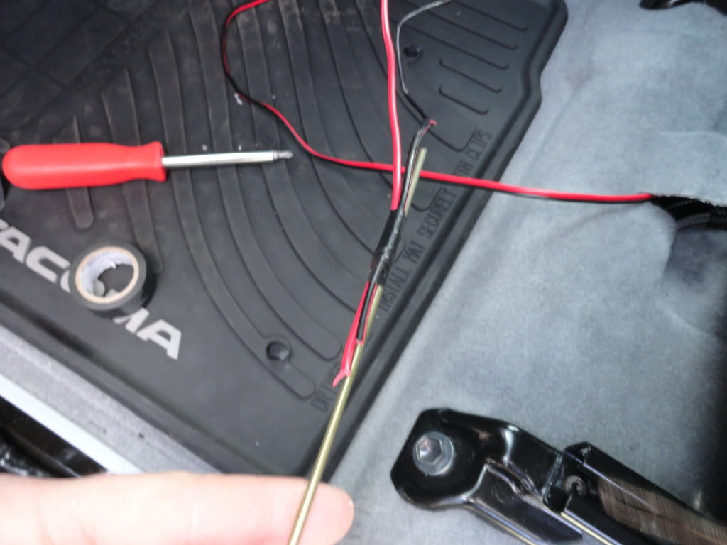

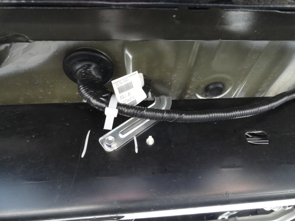

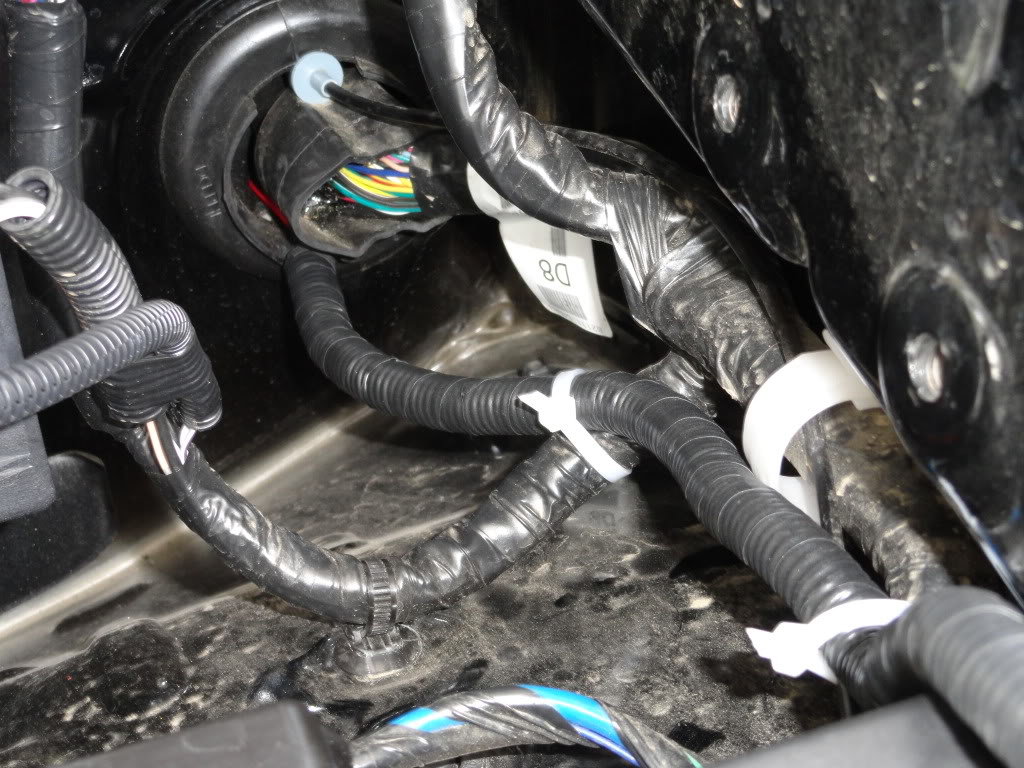

    Saw this little trick from another guy's cb install thread. Basically use the straight piece of a coathanger to thread your wiring through hard to reach areas, such as under the carpet and through the firewall:
    Up through the firewall via the coathanger. Just punched it right through the grommet holding the rest of the vehicle wiring:
    I ran the coax through the floor and up through the bed:
    Being the only metallic portion of the bed, I opted to install my mount here, so that when I removed the antenna my vehicle would look "clean" from any outside view.
    The grounding wire isn't the greatest in the world, but it does the job, and is still hidden when the tailgate is up.
    You'll also notice in this photo that I put the extra washer and teflon insulating washer on the bottom, where the coax connects, instead of underneath the antenna adapter. After spending quite some time trying to figure out why my SWR readings were so high, I realized this mistake and promptly switched the washers to the correct side.

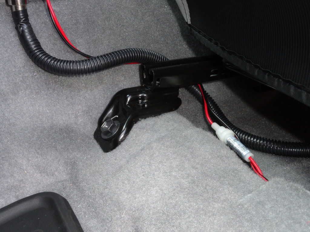

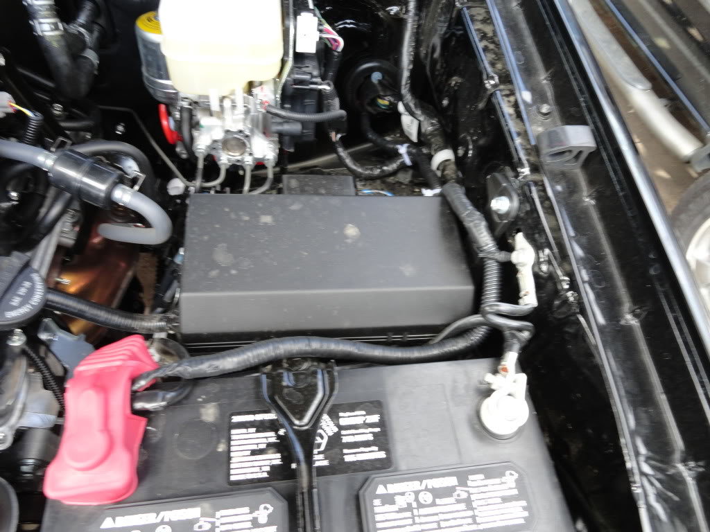

    Connected the power wire to the battery terminal, and ran the grounding wire to the battery ground point on the frame:
    And... all done!
    Managed to get the antenna tuned down to about 1.2:1.2.
    All in all it was fairly simple, even for someone who had never done anything like this before. Stay tuned for more mods as they come!

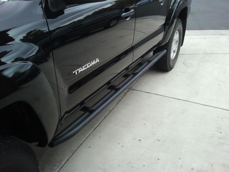

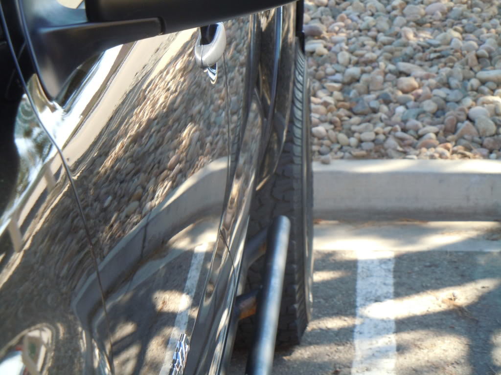

    Latest addition: Demello bolt-on rock sliders. Powdercoated black.

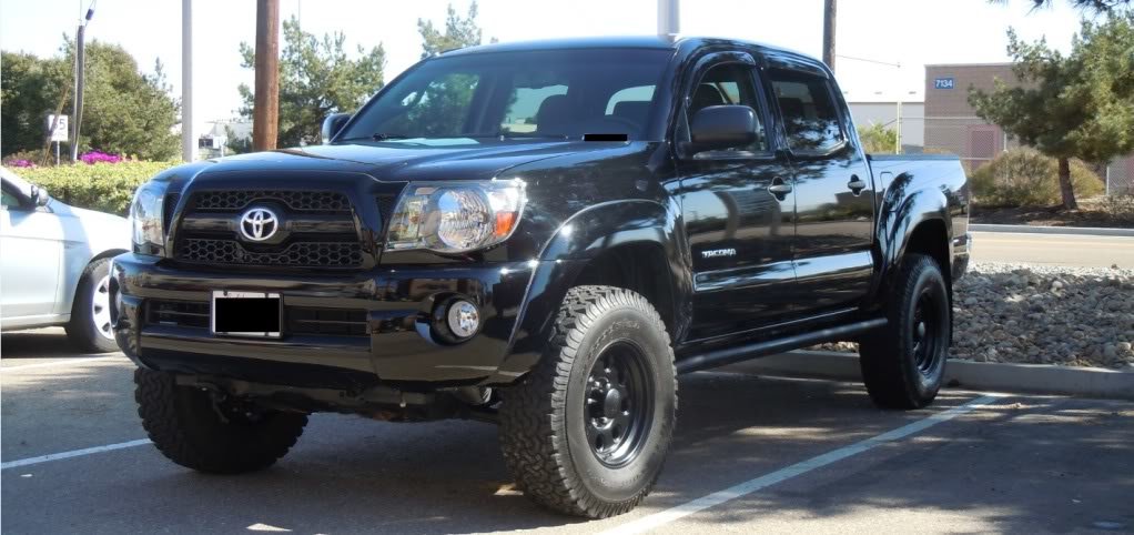

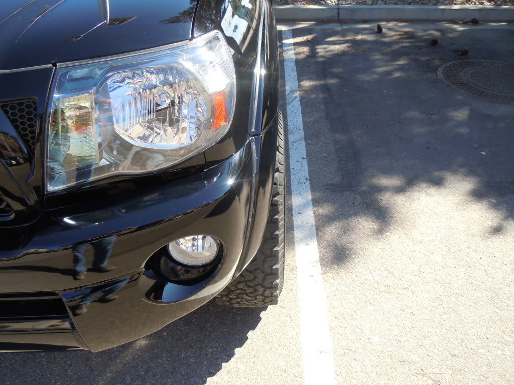

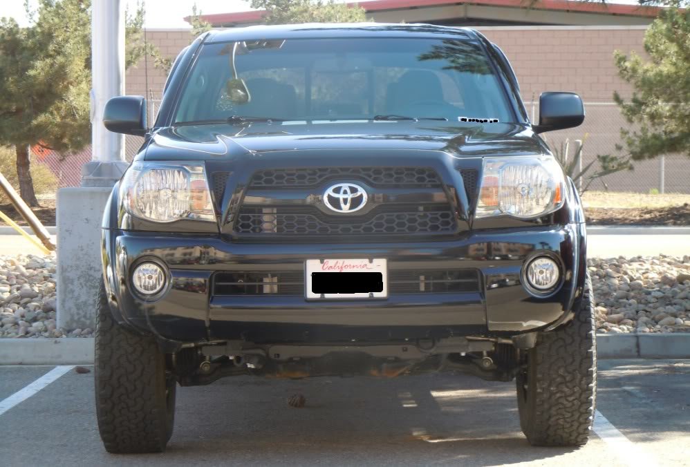

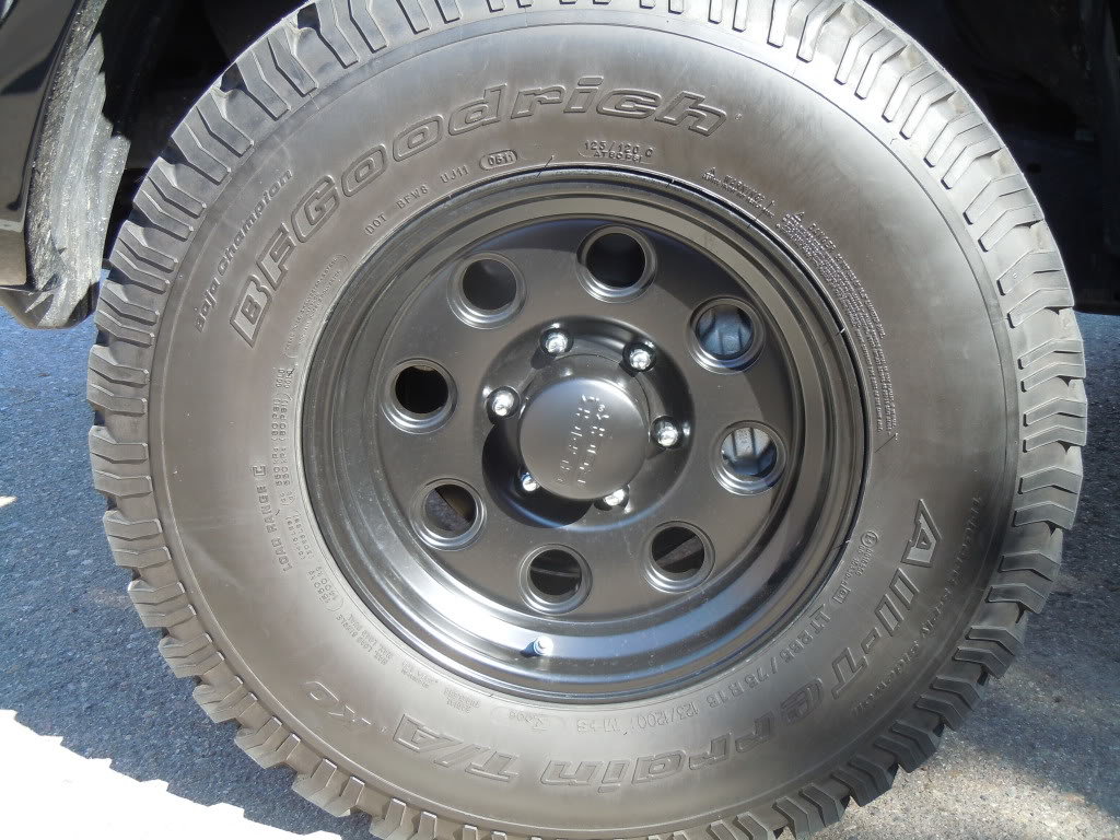

    Latest additions: A black color matched grille to replace the original stock grille, and a set of Black Rock Yuma 908b wheels. Specs: 16x8 6x5.5 4.25bs, 0mm offset.
    They easily clear the calipers, and I'm loving the new wider stance.
