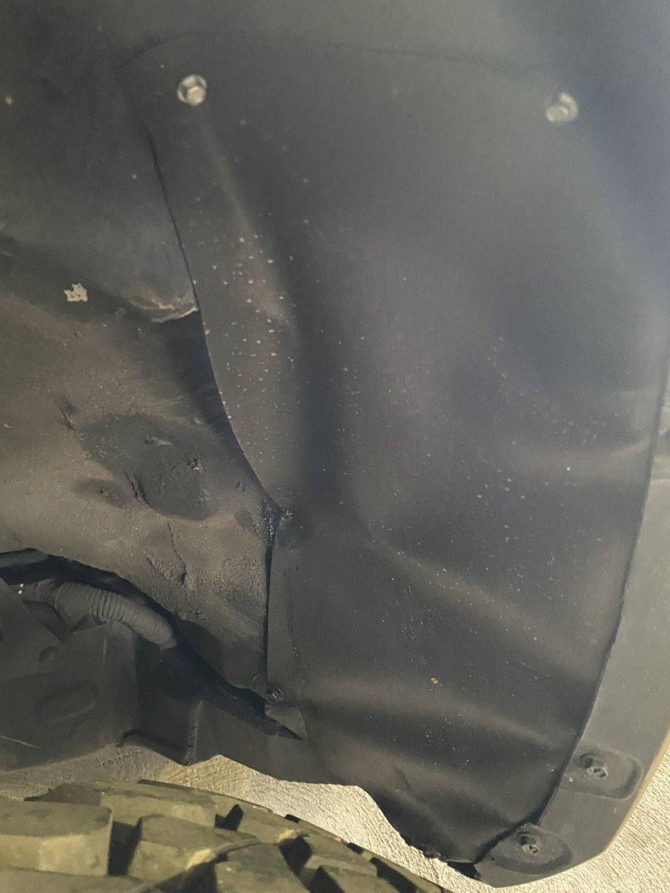

    Yup, used the heat gun method for a while but somehow, edges kept getting caught on the tires and pulled forward. Tore about a foot out each side and just used the shelf liner. No snags so far

    Top bolted into oem, outside is tucked in and screwed with existing bolts, and used an existing hole for the chassis side.

    Looks really good, will do the same! Thanks for the idea.

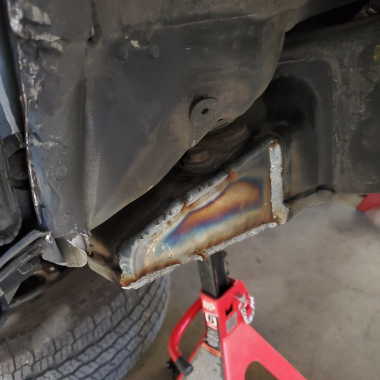

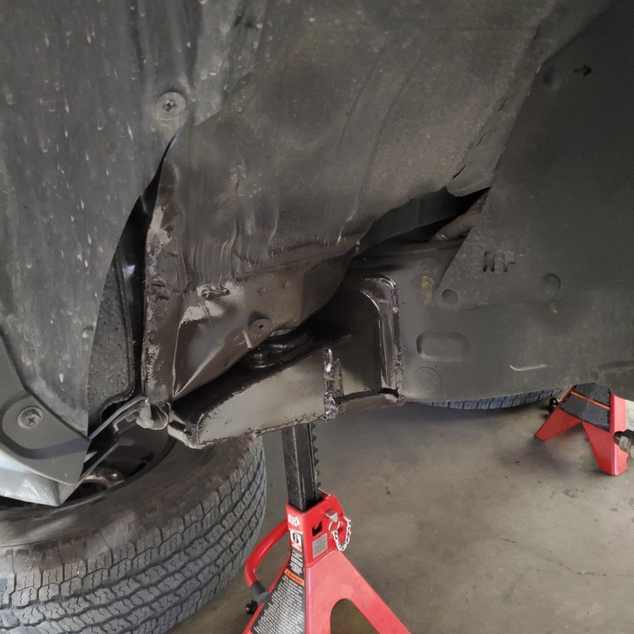

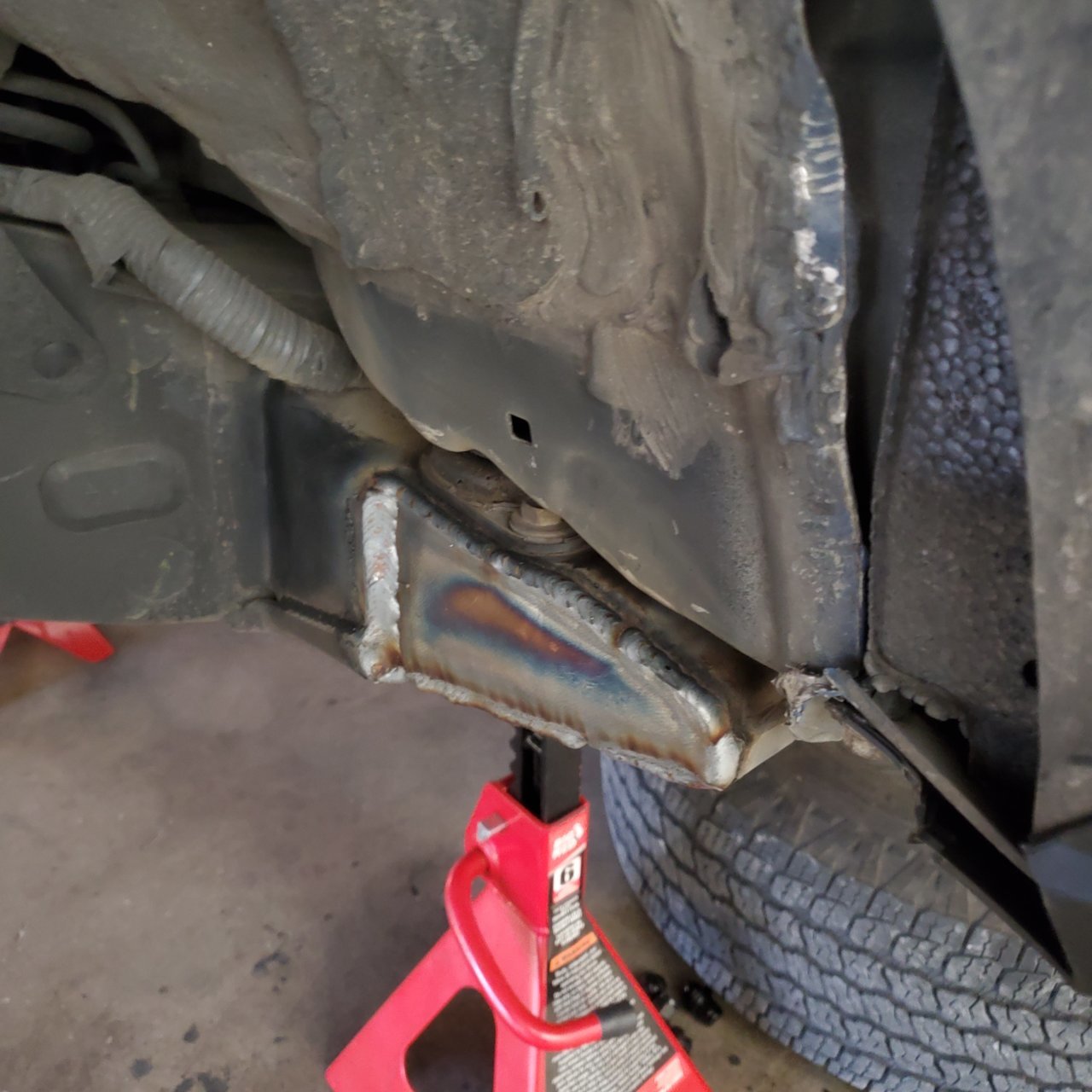

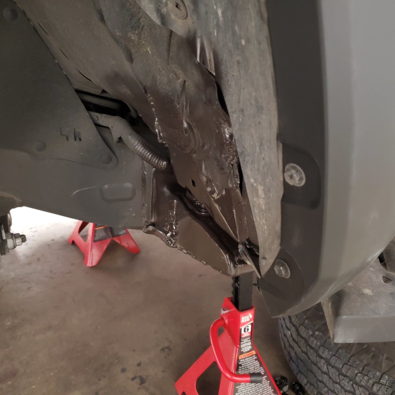

    Always beat em in
    20210318_194523.jpg 20210318_194536.jpg 20210318_195056.jpg 20210318_195525.jpg 20210318_183909.jpg
