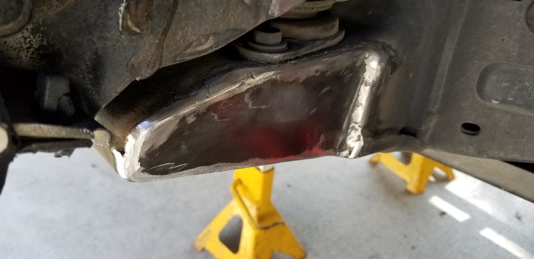

    Hey guys, a great place in Mass (endangered species 4WD) hooked me up with a CMC yesterday. Great bunch of guys. Unlike many, they requested I didn't bring plates as they wanted to make their own cuts in case they don't need to cut off more than they have to. They stuffed my tires and measured how much I needed (with a little wiggle room obviously). I'm not rubbing on and off road and am happy with it but i'm only on 33's. The only question I have is I noticed mine has a "notch" cut out instead of the usual plate that smooths it out. Do people usually just put a larger plate that covers that cut and declines back I'm assuming? The notch doesn't seem to be in the way or anything to cause an issue.

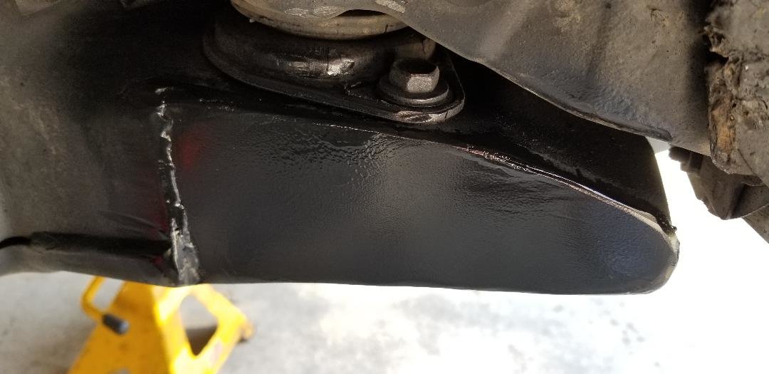

    Should look like this.

    Right, I'm assuming they just didn't make a big enough plate to go more diagonal and back. And instead just filled that little notch. Whatever, it works.

    I've seen it done both ways. Smooth and notched...

    If they went diagonal, the top and bottom would have a gap and be annoying to make a tiny fill plate/weld.

    Or, they didn't cut aggressive enough to allow for a nicer, smoother plate.

    There's nothing wrong with that way other than aesthetics, which is personal preference.

    Aesthetically, yes. But, how often do you stick your head in a trucks wheel well to check out their sexy cab mounts (never, I promise you, it’s never)

    good to hear as I know you do a lot of these. I guess I just wanted to make sure it was still a good setup structurally, although either way I guess takes away from the rigidity of the mount.

    What they did was cut a little too aggressive actually. Right here, rather than make a nice diagonal cut for the smooth look, they cut further back. Hopefully that clears up the difference you're seeing. Nothing wrong with it at all though.
