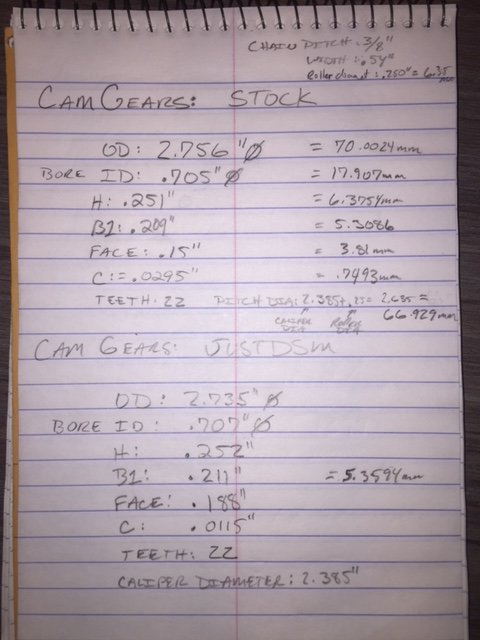

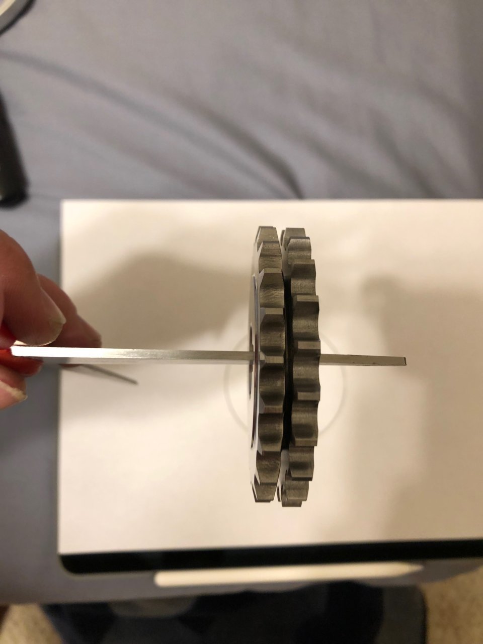

    Regarding the teeth, there are manufacturing specifications for them. Do we know if Toyota follows JIS standards B 1801, B 1802, and B 1803 or a European Spec like ISO R606?
    The URD teeth are the same dimensions as the OEM sprockets. The deflection to concern our selves with is the deflection of the chain at high rpms and the engagement accuracy on the broader teeth face. I think this deserves more conversation. Hopefully, this is nothing as it would much easier to just machine out the key way.
    Below is stock gear with pink paint on the 0 degee mark:
    Below is a URD cam gear on the left for comparisons sake.

    Personally, if the stock gears are only $25, I'd rather pay a little extra to have those machined rather than find out at high rpms theres an issue with the teeth on these.

    Looks like the gears and chain follow an ISO R606-1 specification. This calls for a 5.31mm tooth face width. For reference, Stocks are 5.03086mm after 60 thousand miles and the JustDSM's are 5.36mm. Here's some other dimensional information here:
