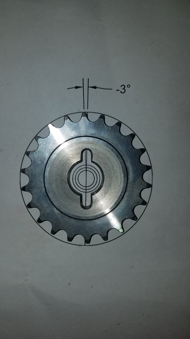

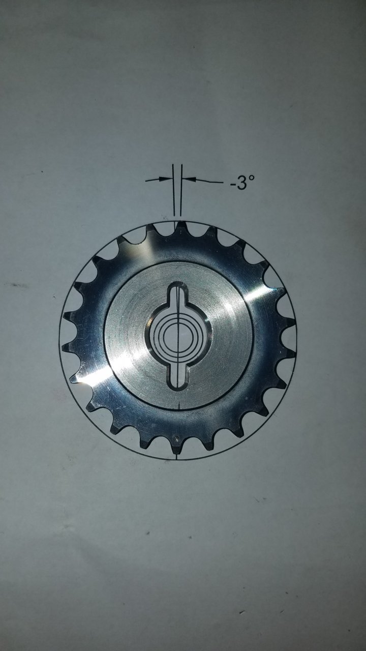

    So I was successful in machining out the gear and will be able to replicate my results. Bottom picture has the gear upside down (notice lack of timing mark) to show the teeth are exactly 3 degrees off. Accuracy to within 1 minute of a degree (1/60th). If time allows- will install next weekend for further proof of concept.

    So, I have a question that’ll likely cause a shitstorm.
    This quote that is probably off the urd site: "The exhaust cam gears retard the exhaust gear timing by 3° in relation to crank angle. Allowing the cylinders to empty more completely on the exhaust stroke. On the intake stroke the cylinders will fill with more air and fuel increasing the overall volumetric efficiency of the engine. There will also be less hot exhaust gas left heating the incoming air and fuel and reducing it's knock potential. This is very advantageous with forced induction conversions."
    I’d like to know wtf. First of all, if we are retarding the exhaust cam by 3° Of crank angle, then our cam gears should only be machined for -1.5° of cam angle.
    Secondly, by retarding the cam we are increasing valve overlap. Which, doesn’t sound to me like the correct way to go with a supercharged motor.
