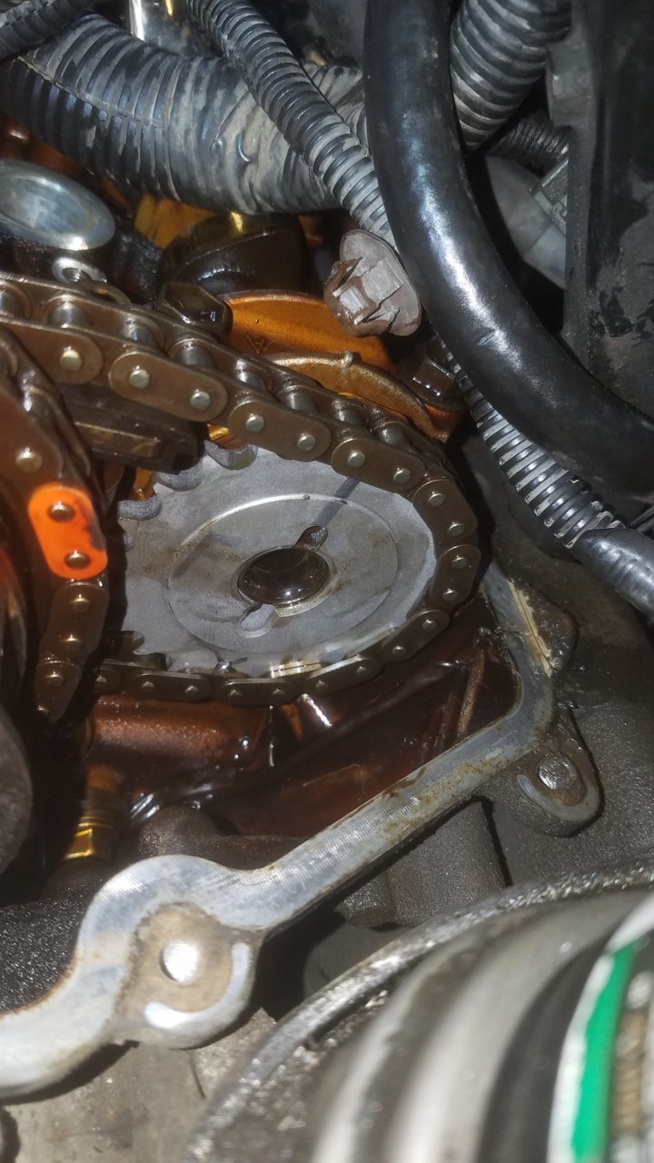

    I installed factory gears with the new 3°R. However I did temporarily install the gears Justin had machined out for us to confirm a nice fitment.

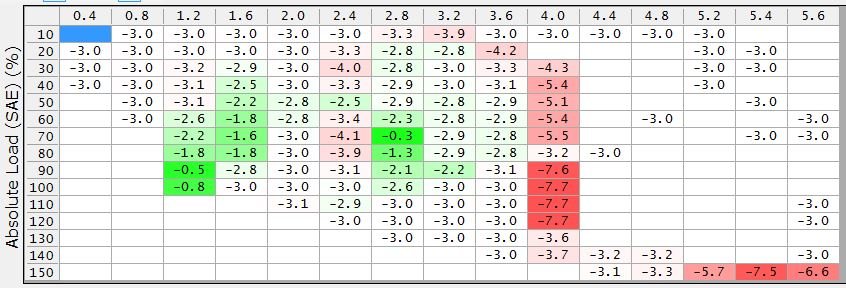

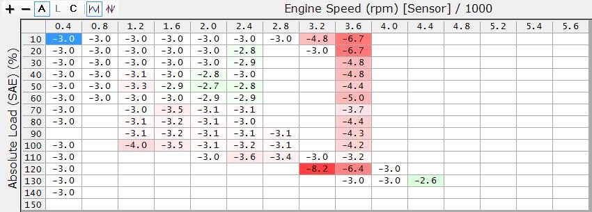

    They show an increased knock threshold. :) Are you familiar with the Knock Feedback and Knock Correct Learn values the ECU uses for knock control?
    Using the same tune, here's what I see that's telling:
    Stock Exhaust Cam Timing:
    3 Degrees of Exhaust Cam Retard:
    It should be noted that the apparent knock activity observed is happening at the very high end of the Knock Correct Learn value meaning the truck is in it's most advanced state. Additionaly, the "standard" value for Knock Feedback is -3.0
    (Sorry for the edits..I originally posted the screenshots with some specific filters that did not show the raw data, what is posted above now shows the raw data)

    Am I correct in seeing an extra 3 degrees of ignition timing with the new cam gears? Thats a ton!
  13. Jun 23, 2019 at 11:55 AM
    #253
    JustDSM
    JustDSM [OP] Oderint Dum Metuant
    Jan 16, 2015
    #146525
    3,315
    Justin
    Ogden, UT
    It's actually a bit more complicated than that.
    Not to get too into it, here's a very brief summary:
    The baseline value in the table above is -3.0 (think of that as 0). A value less than -3.0, that indicates an increased amount of knock activity. Anything with a value greater than -3.0 means it's HAPPY, and wants more.
