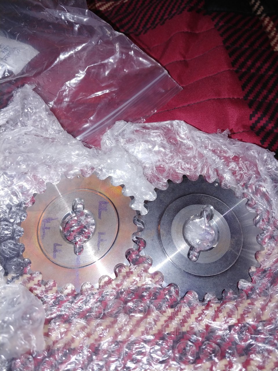

    Gears are heading out the door with some arriving as early as tomorrow. If anyone else wants in before the price goes up, send me a pm.20190626_133454.jpg

    DesertRatliff
    DesertRatliff Well-Known Member
    Jan 14, 2012
    #70618
    2,438
    Mt. Hood, OR
    Mas Tacos Por Favor
    Nice work Mightytacoman! Those look sweet!

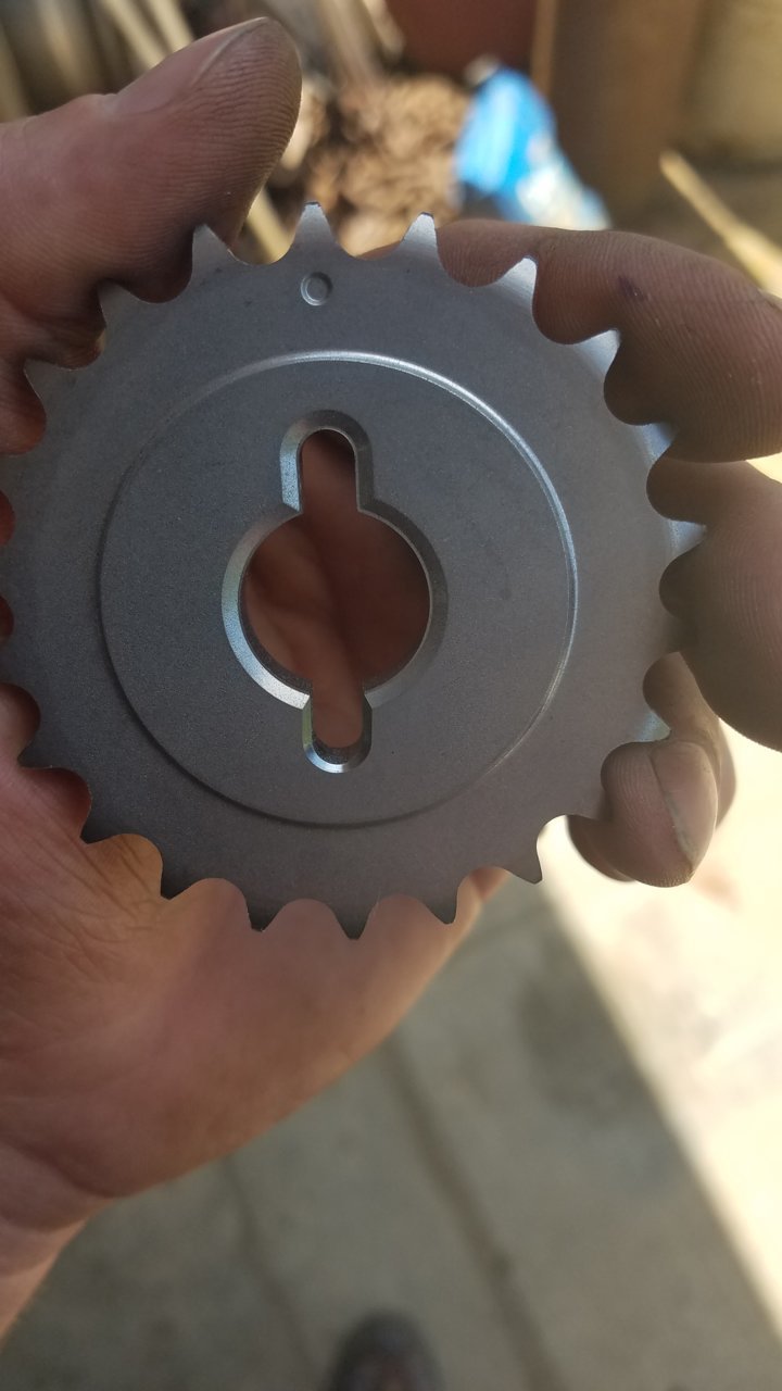

    Brian Crower stroker kit, Carrillo pistons moly/ceramic coated, BC sportsman rods, arp s2000 head bolts, Darton M.I.D sleeves, Kelford race cams, Magnusson supercharger, hp tuner tuned, 650cc flow matched fuel injectors, CSF radiator, Walbro 255 fuel pump. pulleyboys quick change pulley with 2.3", fpr mod, NST crank, water and alternator pullies, 160° mishimoto thermostat. Puma On-board air, Radflo CDC ext coilovers with 14" 700# springs, extended length rear Radflo shocks with CDC, Dakar leak pack, Brute Force Fab front bumper galvanized and powder coated, DTRL mod, yellow fogs, fog anytime mod, relocated rear differential breather, synthetic fluids, custom airbox, tundra sized intake. 76mm throttle body, secondary air filter removed, Airflow snorkel, 4x innovation sliders powder coated, URD equal length headers, DT y-pipe, Aero-Turbine 2525xl exhaust dumped over axle, seat belt chime disabled, Warn 8000i winch, 1- 20" slim light bar in grill, 42" curved roof light both with custom brackets. Mesh grill, Brute Force Fab rear bumper with extra reverse lights, u bolt flip kit, SS extended brake lines, hockey puck bump stop extension, AT shackle flip kit, Light Racing UCA's, 4crawler 1.5" bodylift. custom built front and mid skid plates, re-geared to 4.56s, windows tinted 25%, Sony stereo, 8" skar sub-woofer, 1000 watt mono amp, retrofit headlights with legal demon eye, Kryptek Marathon seat covers. North Star agm 27f battery, Helo 791 rims, 315/75/r16 Mt/r ARB front air locker
    Should be a two others that got them in the mail today too! The other 4 that went out look like they will be arriving tomorrow. Looking forward to any feedback people have on my machining so that I can improve as needed. Again the 3 degrees of retarding should be within 1 minute angle as I take the time to re-calibrate for every single gear so that any factory imperfections can be accommodated for.
    So whats that leave for my margin of error on a ~2.5" tall gear? About 0.00073" if I still know how to math.
