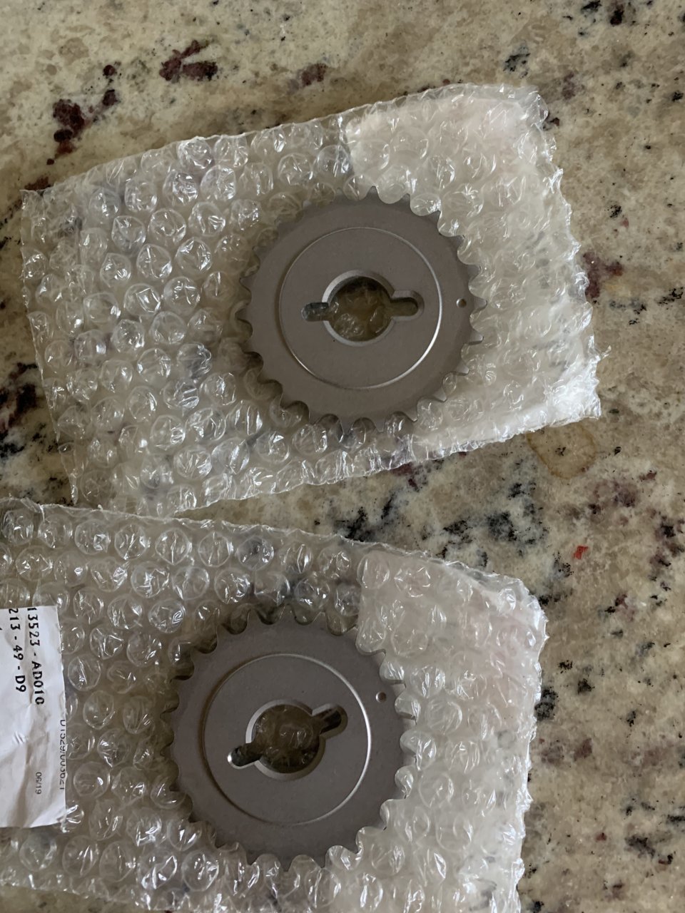

    My wife confirmed mine arrived, I was so happy I made her open them and send me a picture :rofl:
    Everything looks great. If I get home when I am supposed to they will be installed Wednesday. Thanks again @mightytacoman :D
