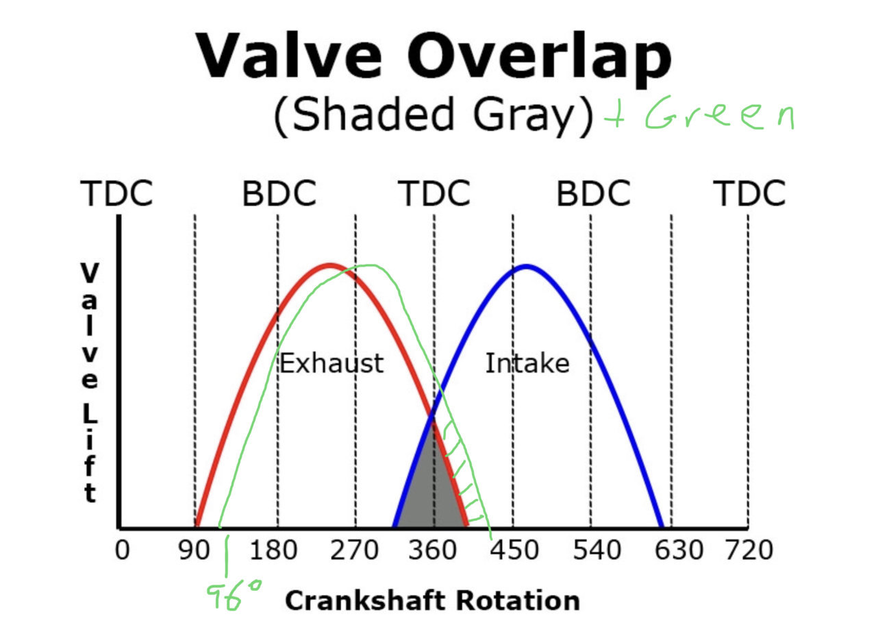

    Certainly it’s for emissions. These gears are increasing overlap. That’s more unburnt fuel down the exhaust. That’s a no-no in smog town. Efficiency and power be damned...

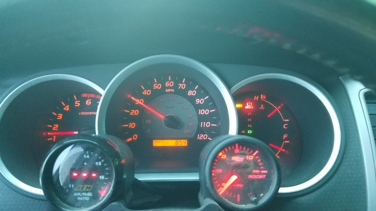

    Glad you got it figured out. Don't be afraid to shoot me a message next time. I'll do my best to answer but family events today kept me away from my phone..
    On a positive note, I finally got through a tank of gas with what I'll call grandpa driving. In the past with the trucks current set up I haven't been able to get past 230 miles on the trip meter before the gas light comes on. Tires are 13% larger than stock. 230*1.13=259.9 miles a tank. Today I was able to get 244 before the gas light came on. 244*1.13= 275.2. That means 15.8 miles gained on a tank of fuel driving the same routes I always do!! That's pretty huge I think. Truck isn't set up for mileage by 20190704_203657.jpg 20190704_213859.jpg any means as shown.
