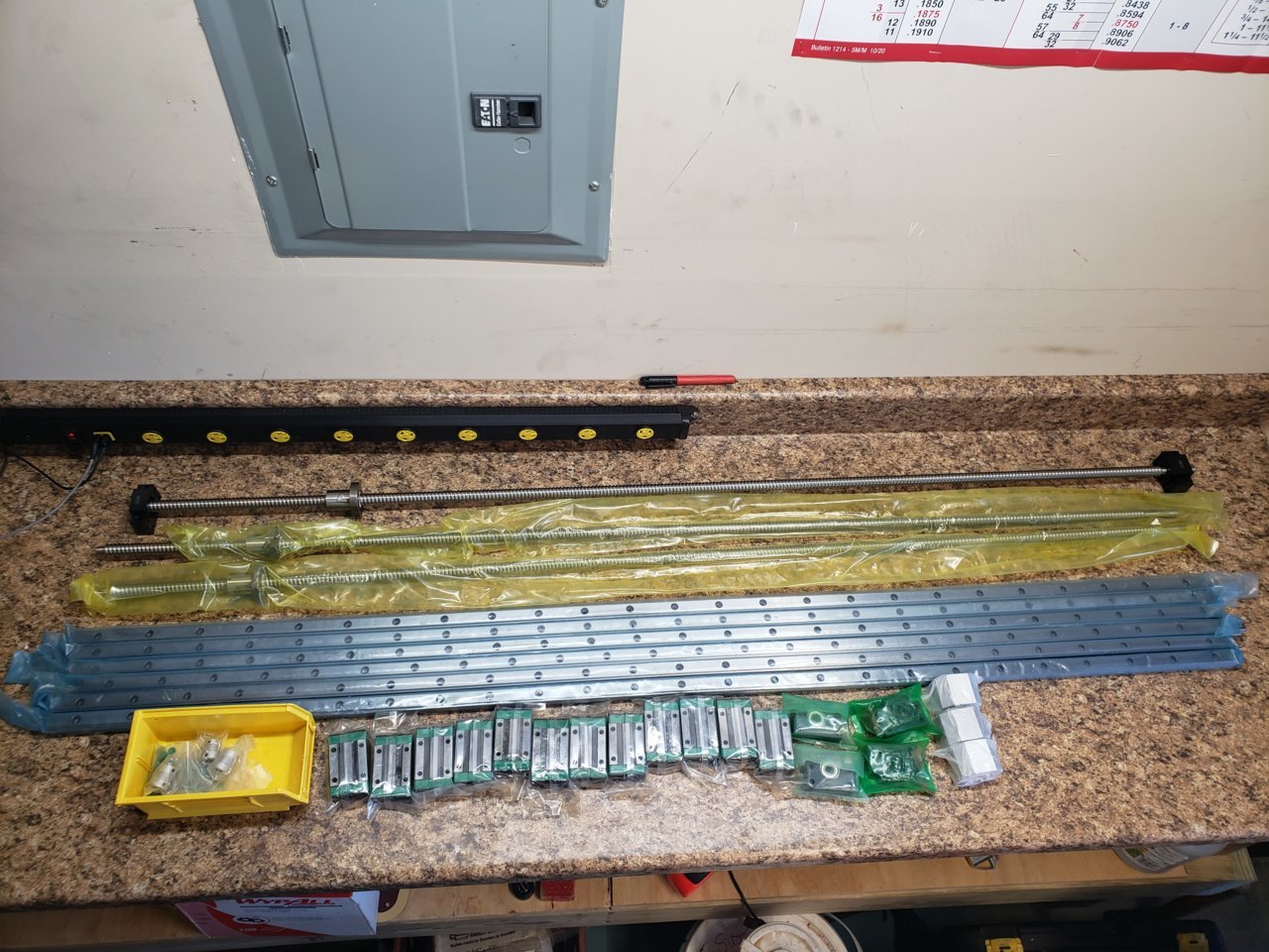

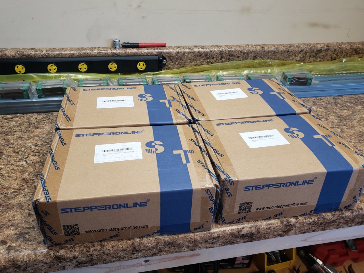

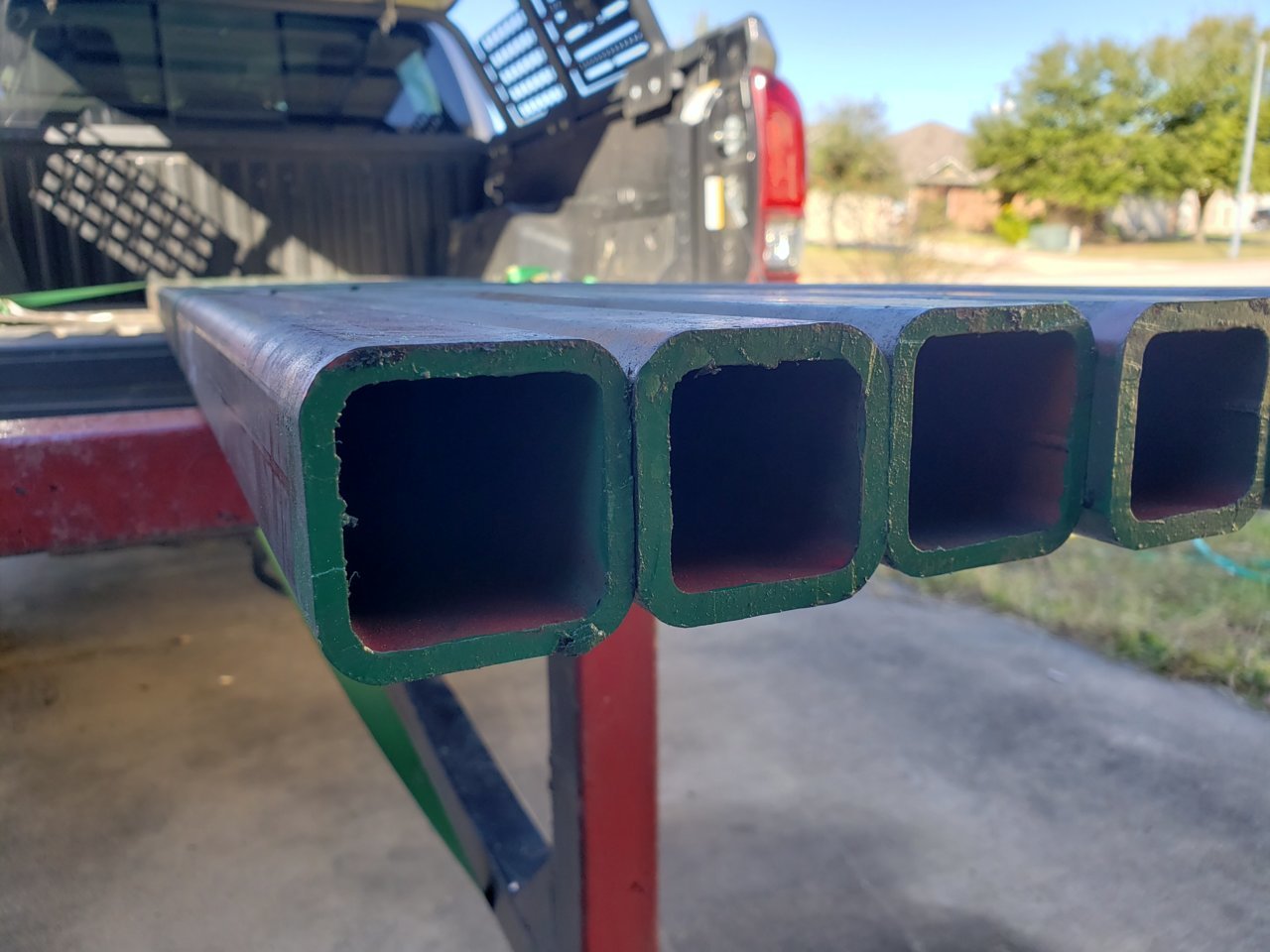

    I have Slowly been gathering parts and materials to build a CNC Plasma table. The Planned Cutting area is 4'x4' with Linear rails and ball screws attached to 3nm NEMA 23 motors
    Right now there is not much to see. other than some pictures of Steel

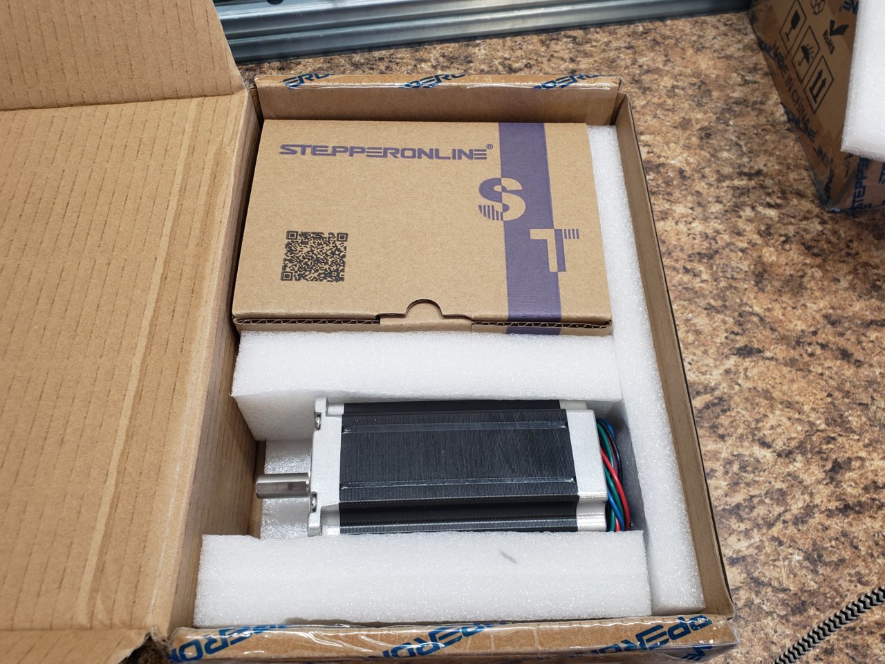

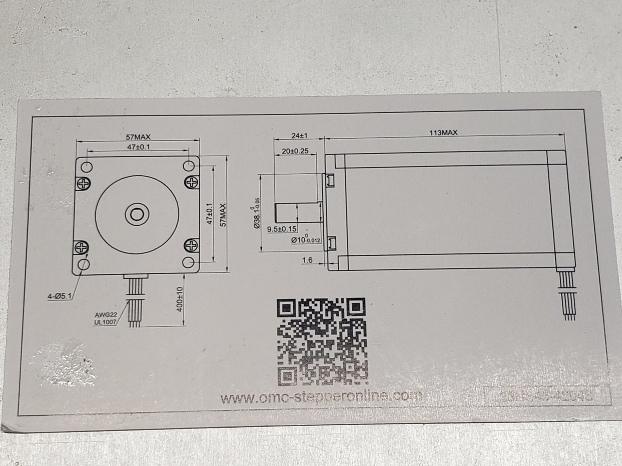

    Random specs and data for future reference:
    Stepper Motor 23HS45-4204S:
    • Manufacturer Part Number: 23HS45-4204S
    • Motor Type: Bipolar Stepper
    • Step Angle: 1.8 deg
    • Holding Torque: 3Nm(425oz.in)
    • Rated Current/phase: 4.2A
    • Voltage: 3.78V
    • Phase Resistance: 0.9ohms
    • Inductance: 3.8mH ± 20%(1KHz)
    • Frame Size: 57 x 57mm
    • Body Length: 113mm
    • Shaft Diameter: Φ10mm
    • Shaft Length: 24mm
    • Number of Leads: 4
    • Lead Length: 400mm
    • Weight: 1.8kg

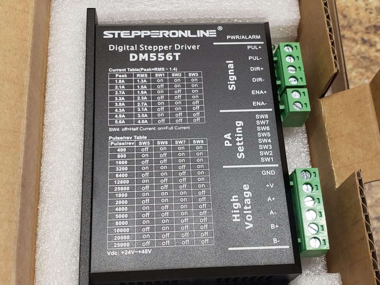

    Stepper Driver DM556T:
    • Anti-Resonance for optimal torque, extra smooth motion, low motor heating and noise
    • Motor auto-identification and parameter auto-configuration for optimal torque from wide- range motors
    • Step and direction (PUL/DIR) control
    • Multi-Stepping for smooth motor movement
    • TTL compatible and optically isolated inputsto 5.6A
    • Input voltage 20-50VDC
    • 16 selectable micro-step resolutions of 400-25,600 via DIP switches
    • 8 selectable output current settings of 1.8A to 5.6A via DIP switches
    • Soft-start with no "jump" when powered on
    • Pulse input frequency up to 200 KHz
    • Automatic idle-current reduction
    • Protections for over-voltage and over-current
    Electrical Specifications:
    • Output Peak Current: 1.8~5.6A (4.0 RMS)
    • Input Voltage: +20~50VDC (Typical 24-48VDC)
    • Logic Signal Current: 7~16mA (Typical 10mA)
    • Pulse Input Frequency: 0~200kHz
    • Pulse Width: 2.5μS
    • Isolation Resistance: 500MΩ

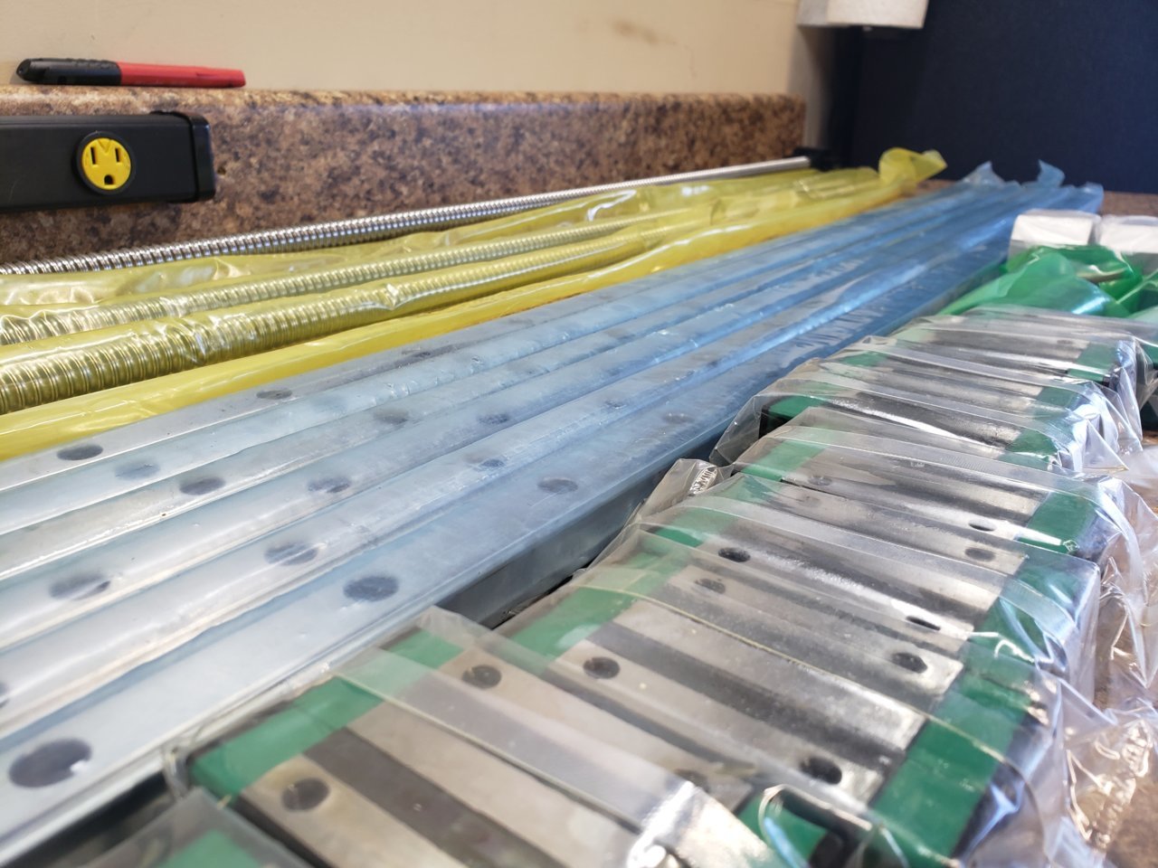

    Type: HGR20 Slide Rail
    • Material: Gcr15 steel
    • Rail Shaft Length: 1500mm/59inch
    • Nuts: BF12/BK12 nuts
    • Fixing Screw Hole Size: M4x16mm
    • Static Load Ratings: 25.31
    • Allowable Static Torque: 0.17kNm
    • Weight: Approx.300g (10.6oz)

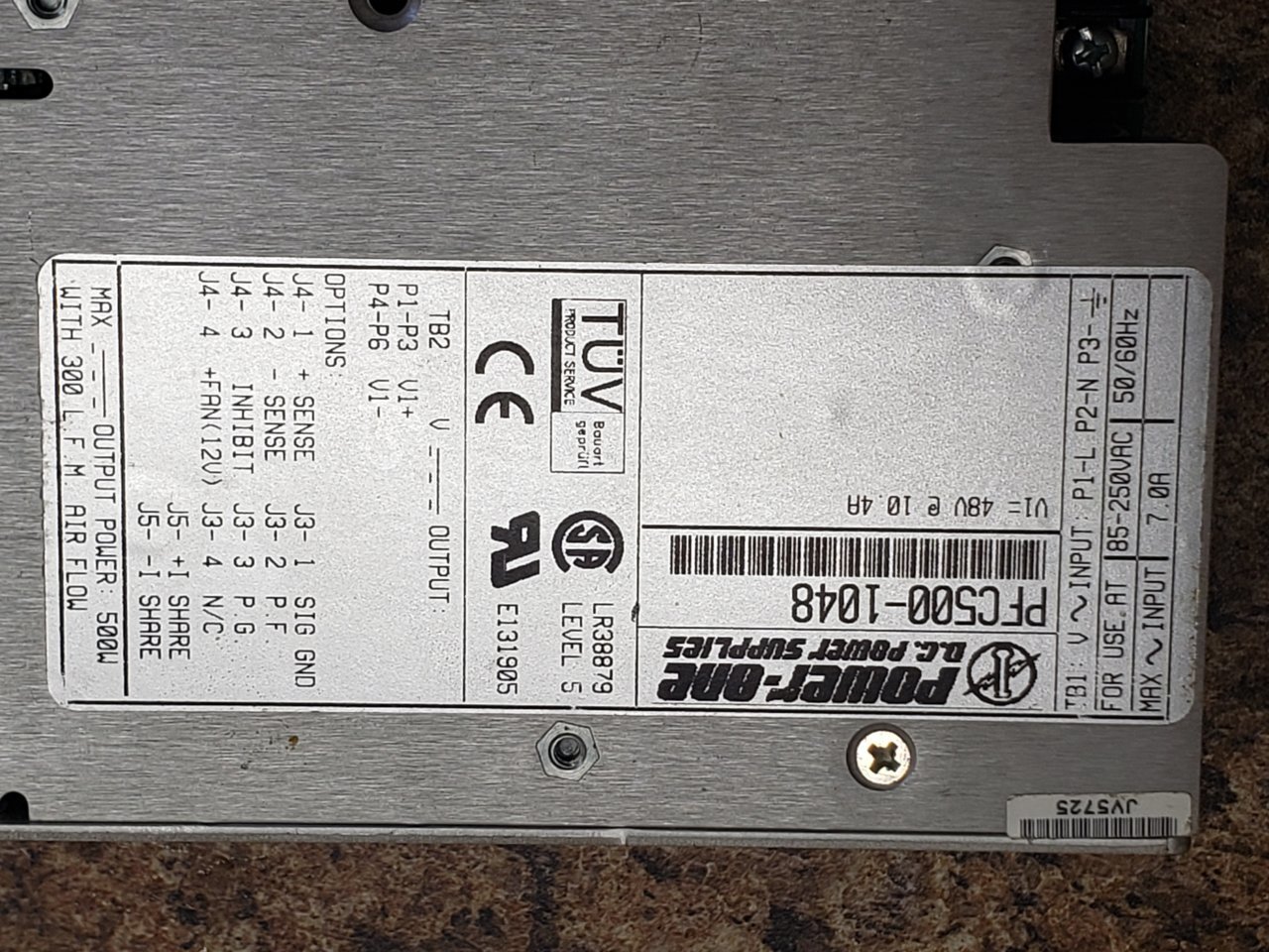

    I found a 48v 500w power supply on my parts shelf leftovers from another life. It will become the power supply for the motors.

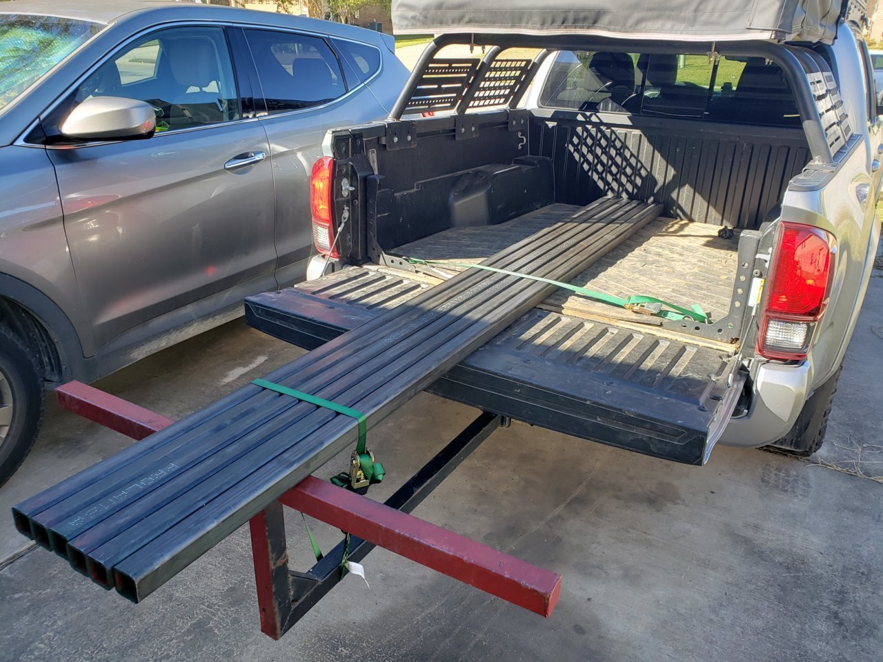

    I am planning on aluminum extrusion for the gantry beam. The 8dea being to reduce inertial mass. Hoping the heavy frame and light gantry combo helps performance.
