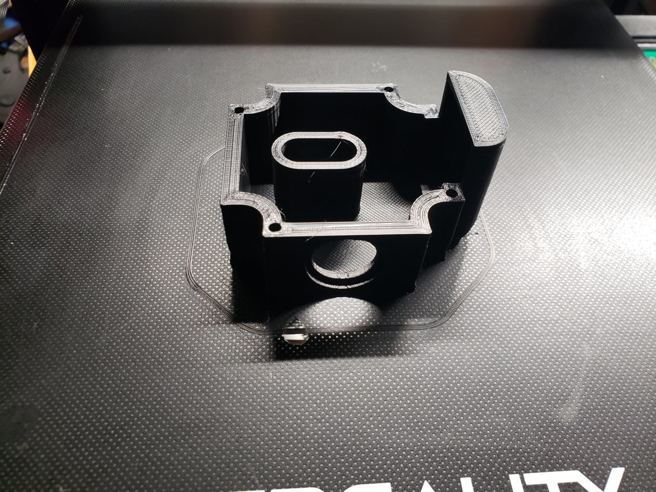

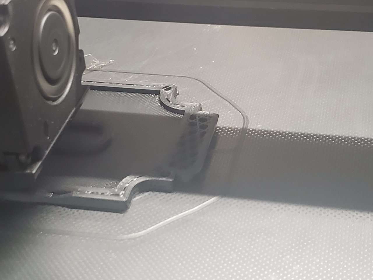

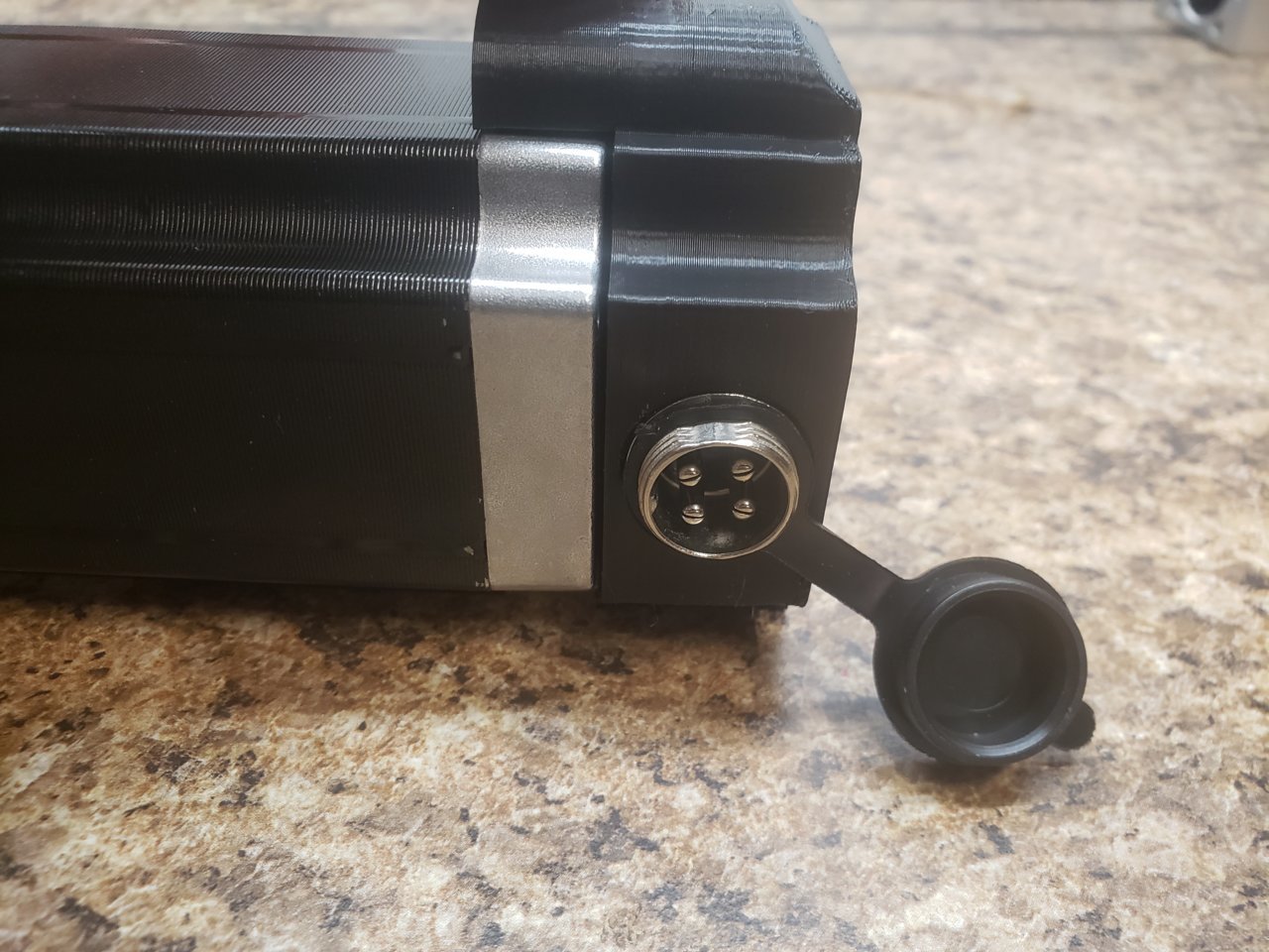

    Today is a 3d Printing day..

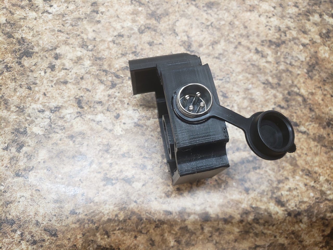

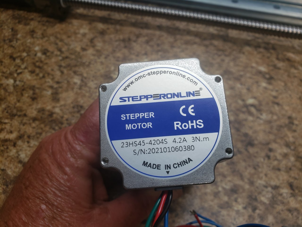

    running a test print of a NEMA 23 motor cover with the GX16 connector to make sure it fits. or if I will need to find a new design or create my own..
    thingiverse link for this part.
    https://www.thingiverse.com/thing:243126

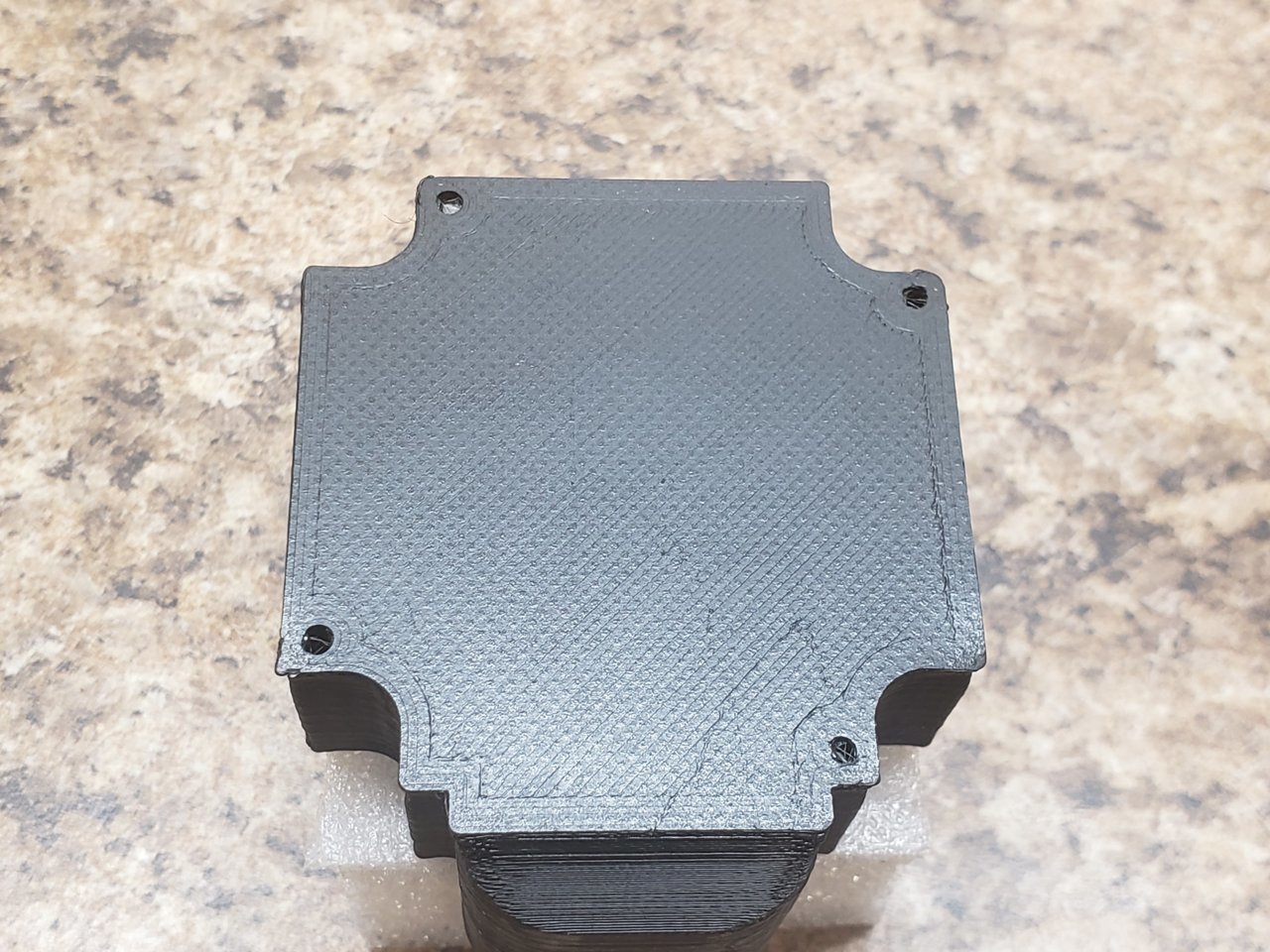

    The Test print for the stepper motor cover is finished, good news is it is the right size for the motors, and the the GX16 connectors fit perfectly. bad news... the bolt pattern is wrong.
    Now to try the next model that was created from this one, with a Bolt Pattern that appears to be right.
    https://www.thingiverse.com/thing:1002246
    Juisebocks and Shmellmopwho like this.

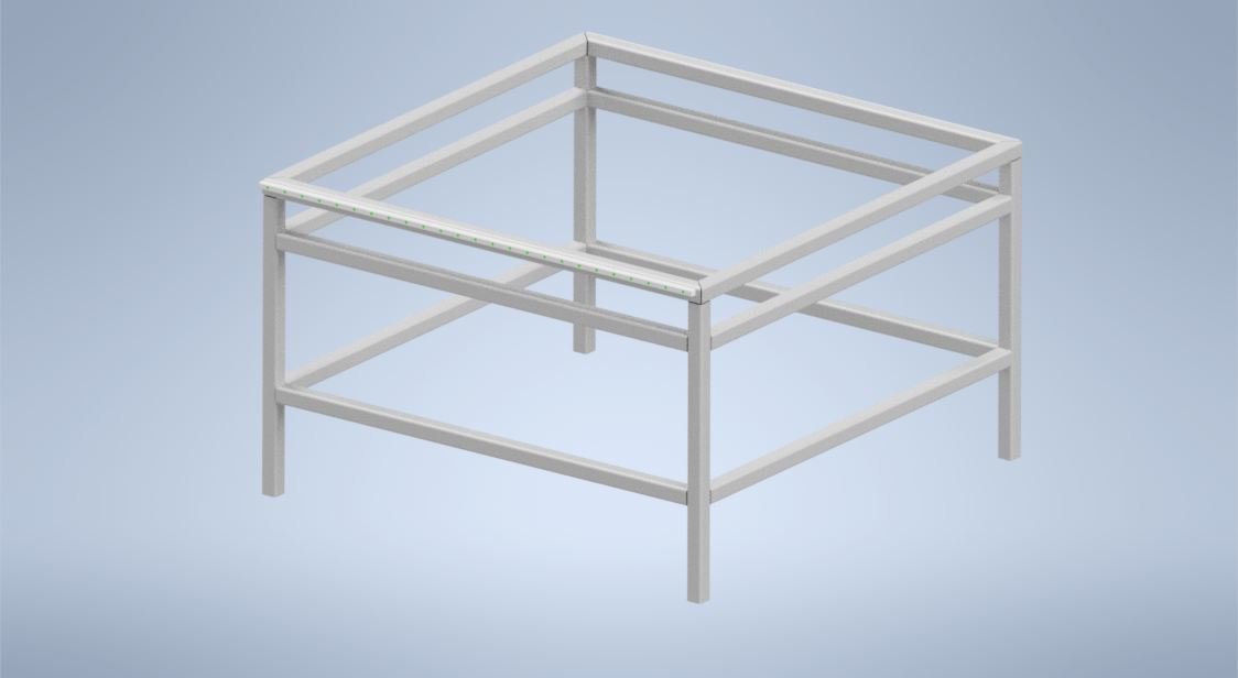

    part of design as you build, I am trying to force myself into doing a cad model of the table to increase my skills, and to help sort out errors before I start cutting Steel.

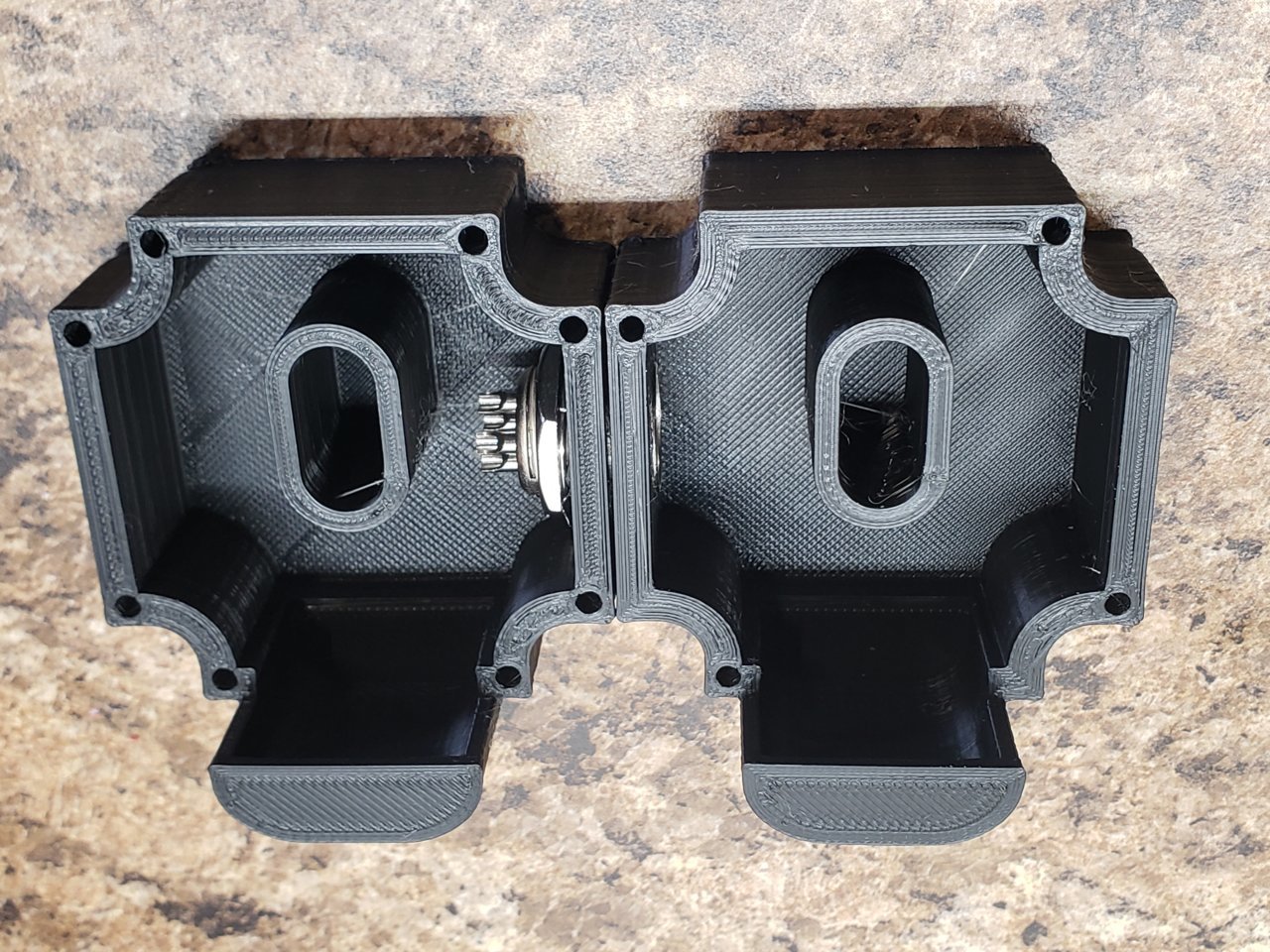

    The Second Model for the stepper motor covers is the one I need. it is a "remix" of the first model and fixes the missing screw holes.
    The Correct one is on the Left, and you can see the added holes.

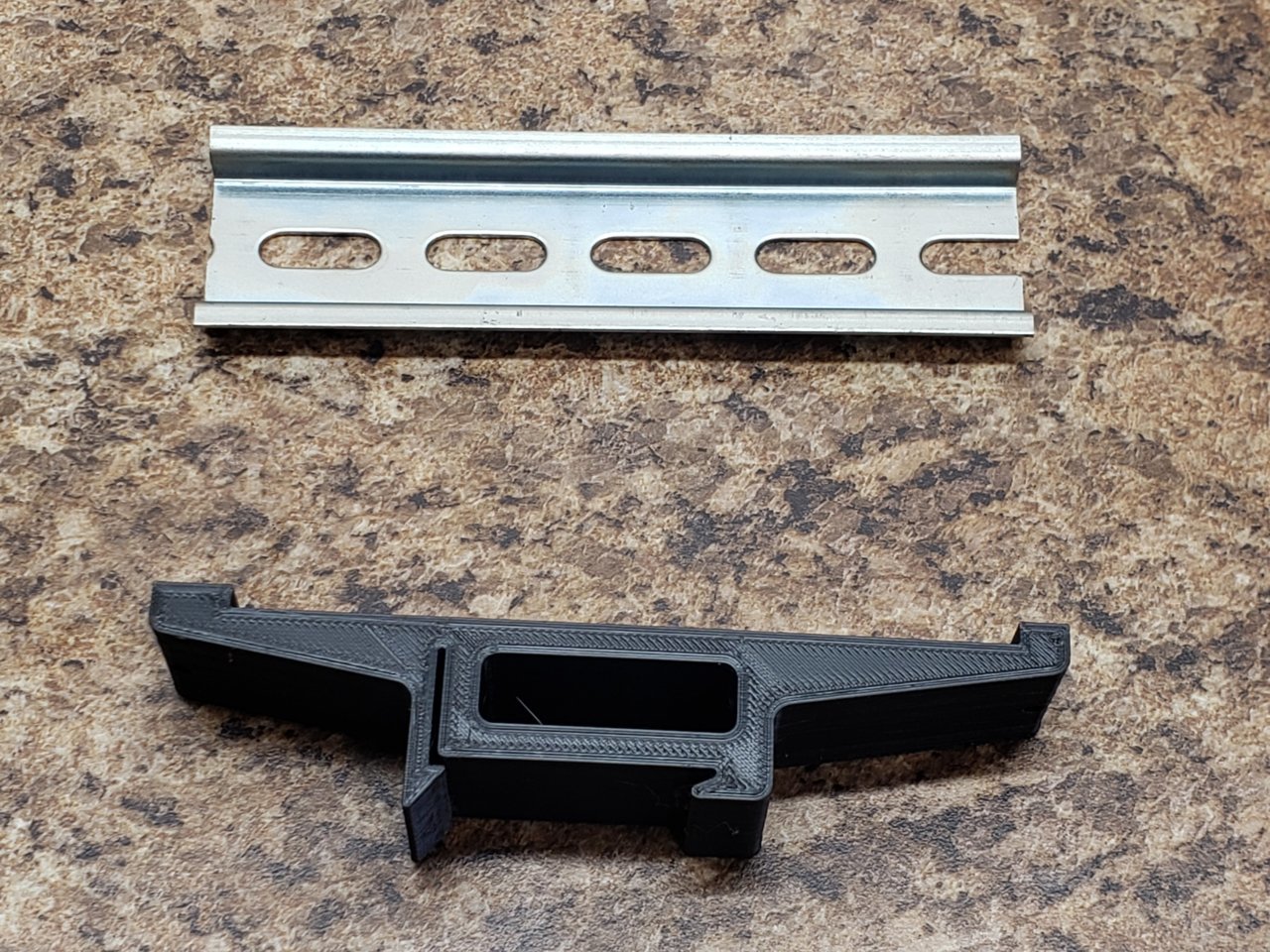

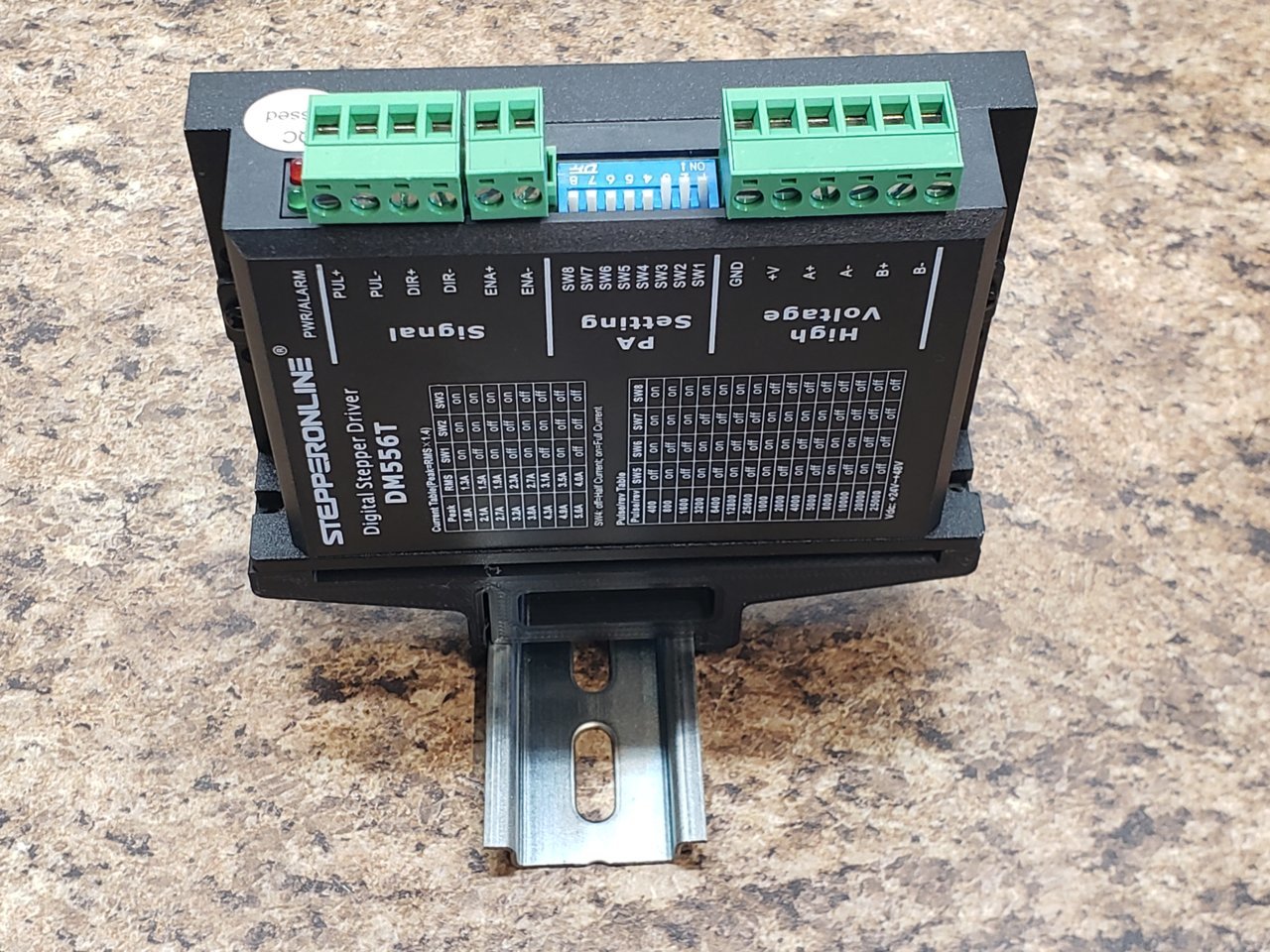

    I also printed out a DIN rail mount for my motor drivers. I have decided to go with DIN rail for the cabinet to help keep everything Neat an tidy, it is also something I have not worked with before so why not use this project to learn.
    inside the thingiverse file there are multiple parts for different driver models. The one I ended up using was listed as being the 3HS557 or DM556
    use m3 x 12mm hardware to mount the driver to the 3d printed bracket
    Now to load the carbon Fiber Nylon, and spend a couple days doing the final prints.

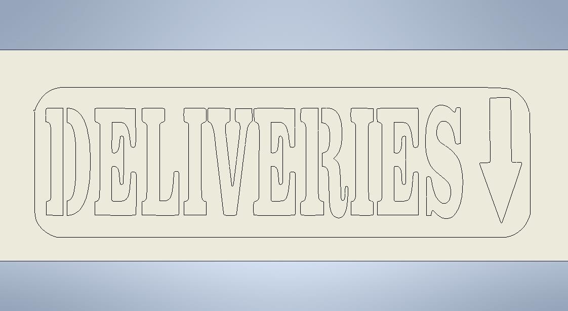

    My wife and I want one of these signs to help the delivery people.

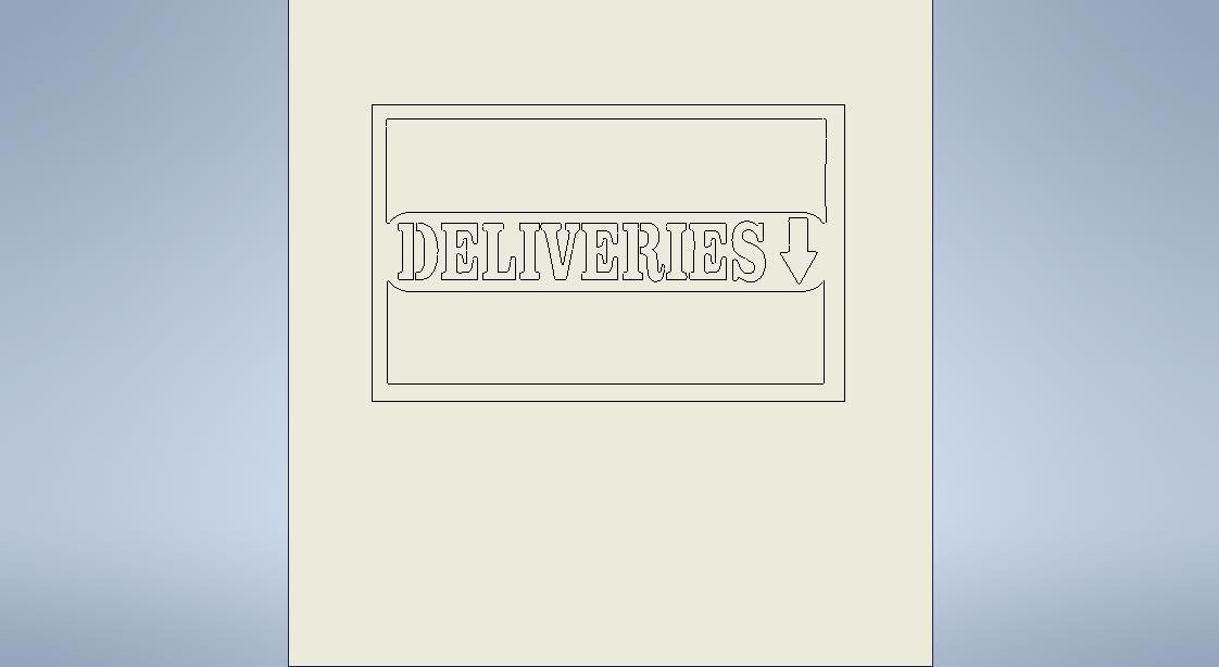

    @koditten Thought I would give it a go.. DWG file is at the bottom if you want to try and cut it
    Juisebocks and koditten like this.

    Hell, yes! You saved me some time!

    I'm going to try it with no border as well. I can get away with a small piece of sheet steel.

    like this?

    Yep. That's exactly what we wanted.

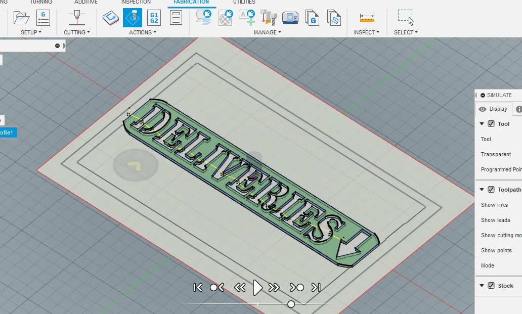

    I have it programmed into F360, just need to creat the Gcode.
