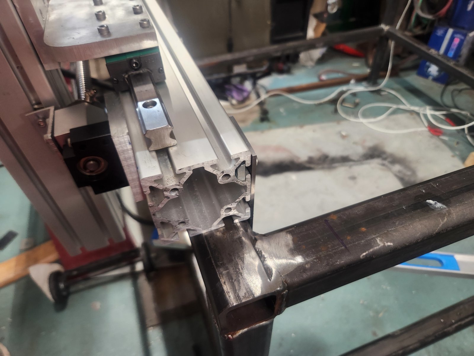

    My design goal was a 50"x50" cutting area.
    Base table is 60"x60", .an I am pretty sure i can get to the goal. By getting it all adjusted right
    Kwikvette likes this.
  4. Dec 25, 2023 at 8:51 AM
    #164
    Pyrotech
    Pyrotech [OP] Well-Known Member
    Nov 25, 2018
    #273741
    2,992

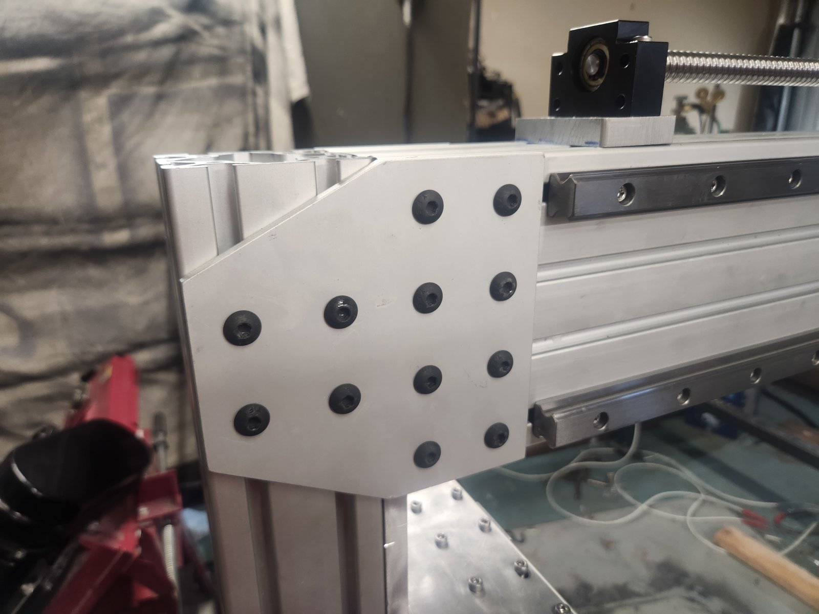

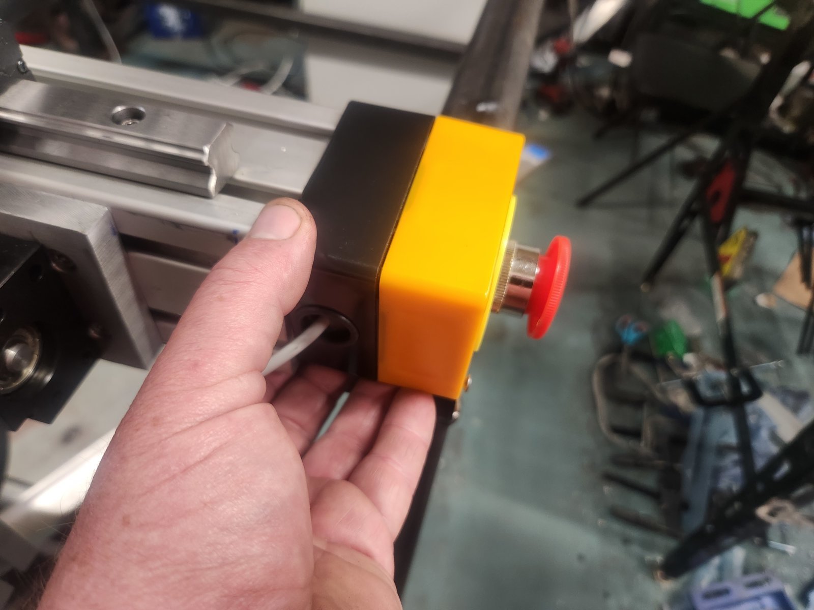

    Looks like I was able to gain a bit of room and hit the 50x50 cutting area goal.
    I may not be able to use the floating head mount I 3d printed last year, but I added THC and touch sensor so That is probably not needed anymore.
    I gain a bit of room by pushing the Y axis rails back a bit..
    An it makes a great spot to mount the E-stop buttons. keeps them out of the way yet still easy to hit the big red button.

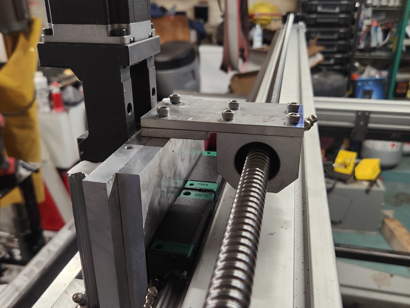

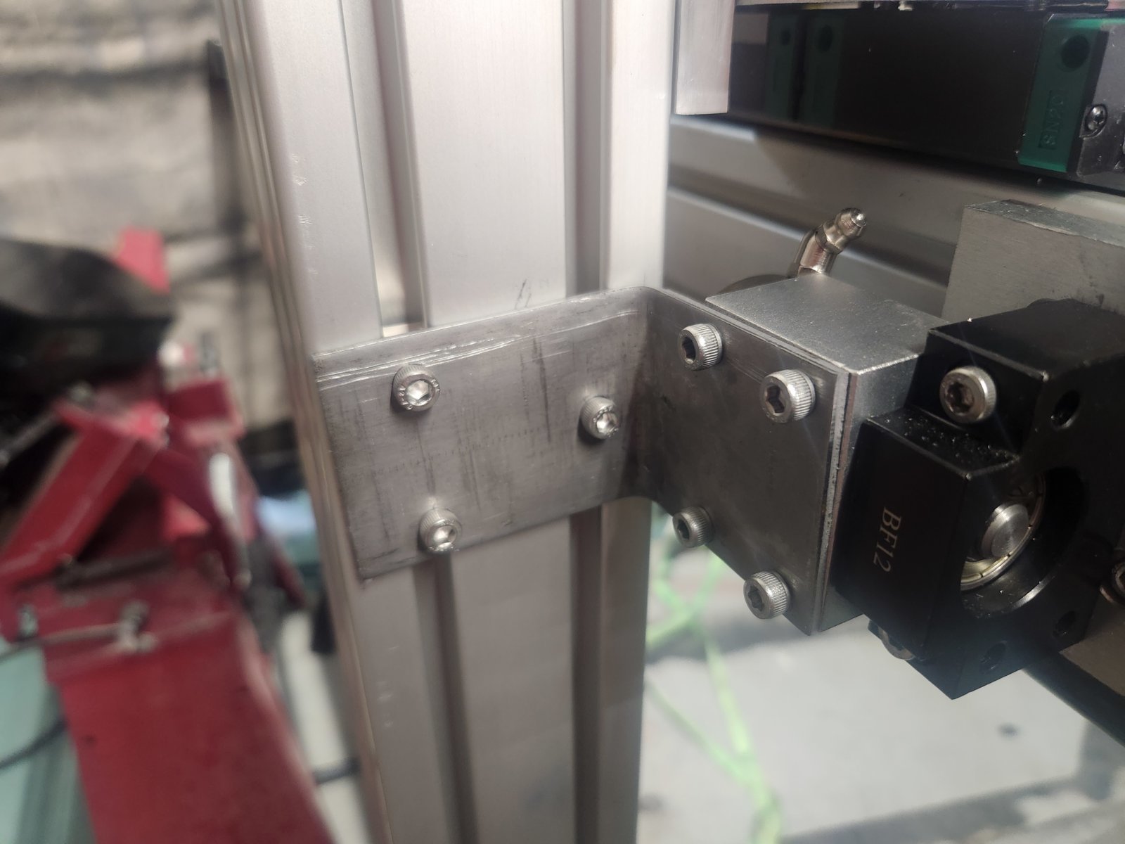

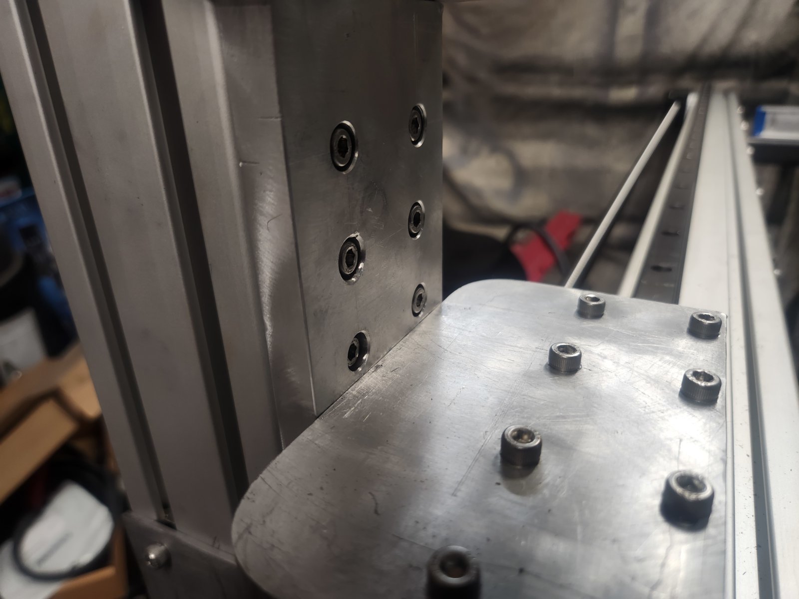

    Spent a good part of the afternoon, actually fixing the crashed gantry. While I had everything apart I also added in the front plates.
    Since I ended up with a different color screw on this order, I decided to put them on the left side, as a visual reminder of the home position, or least I can say that if asked why the screws don't match...
    I also Counterbored the mounting plates for the gantry.
    New mounting brackets where made from 1/8" steel and bent on the brake, I picked up the Swag offroad 20" finger brake kit a few years back, and while I do not use it a lot, it is been very nice to have.
    Did Some preliminary motor tuning and got the travel distance reasonably close after a few tries, I will reverify with longer travel distances once I get the the home and limit switches, and Estop buttons wired in.

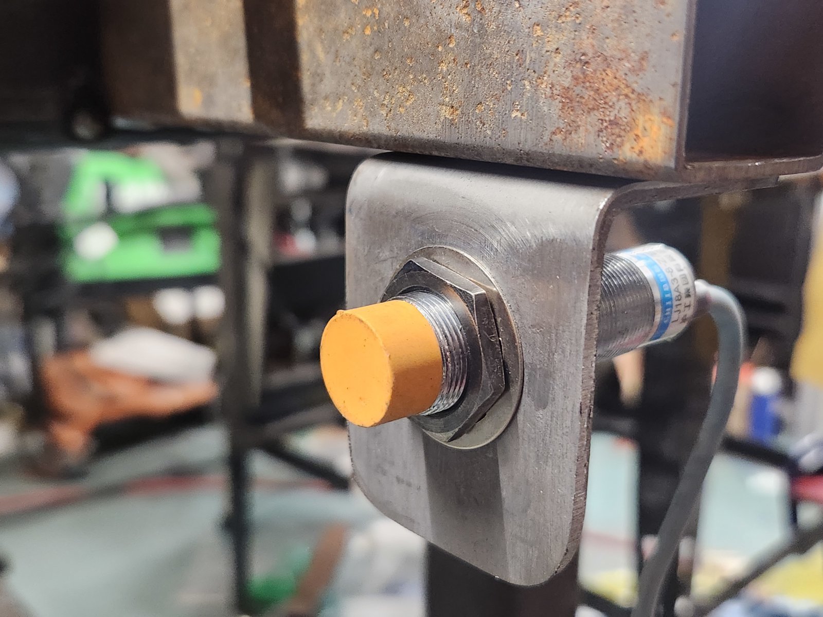

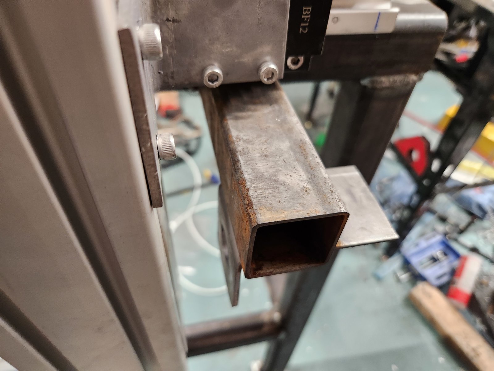

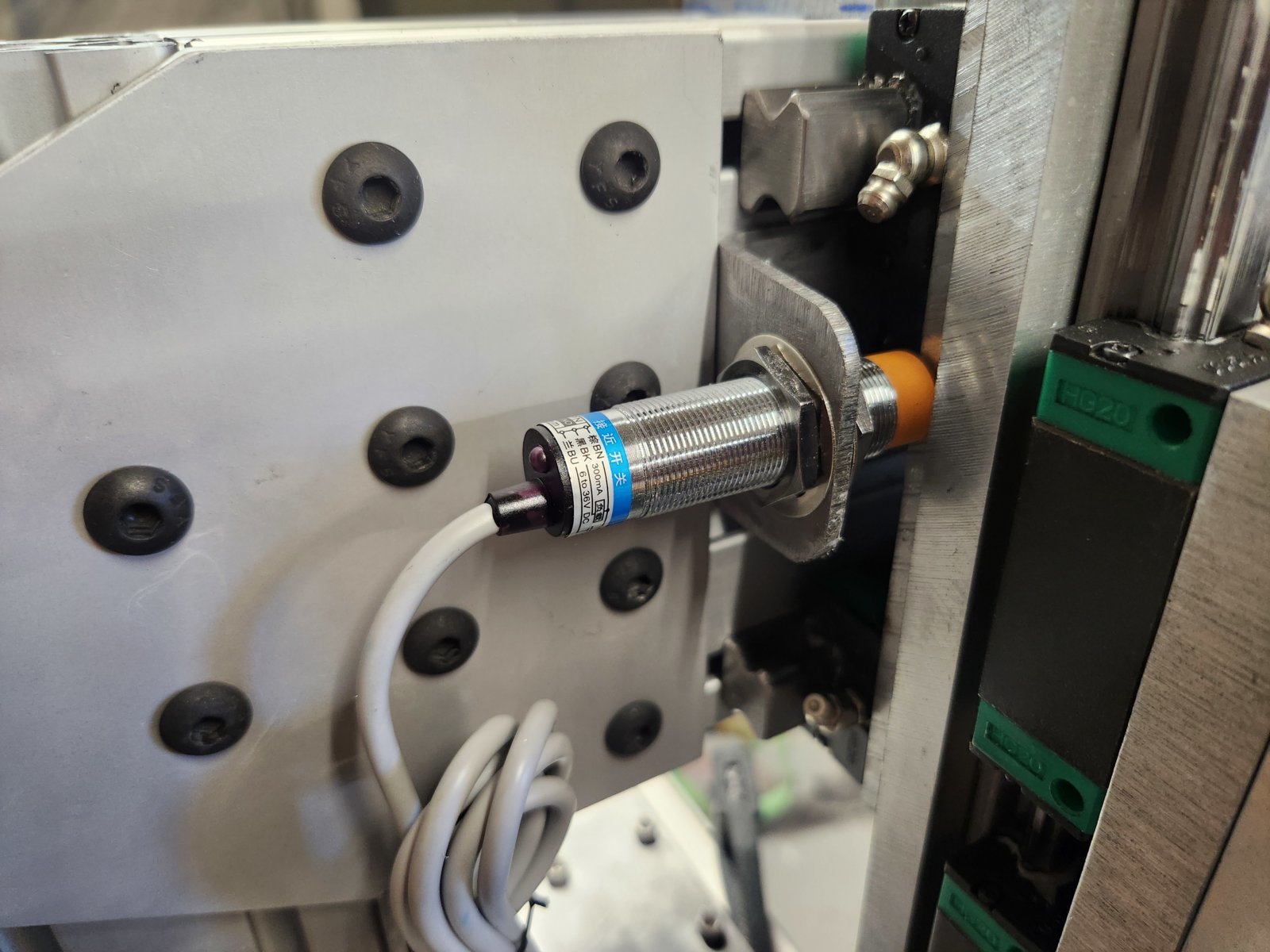

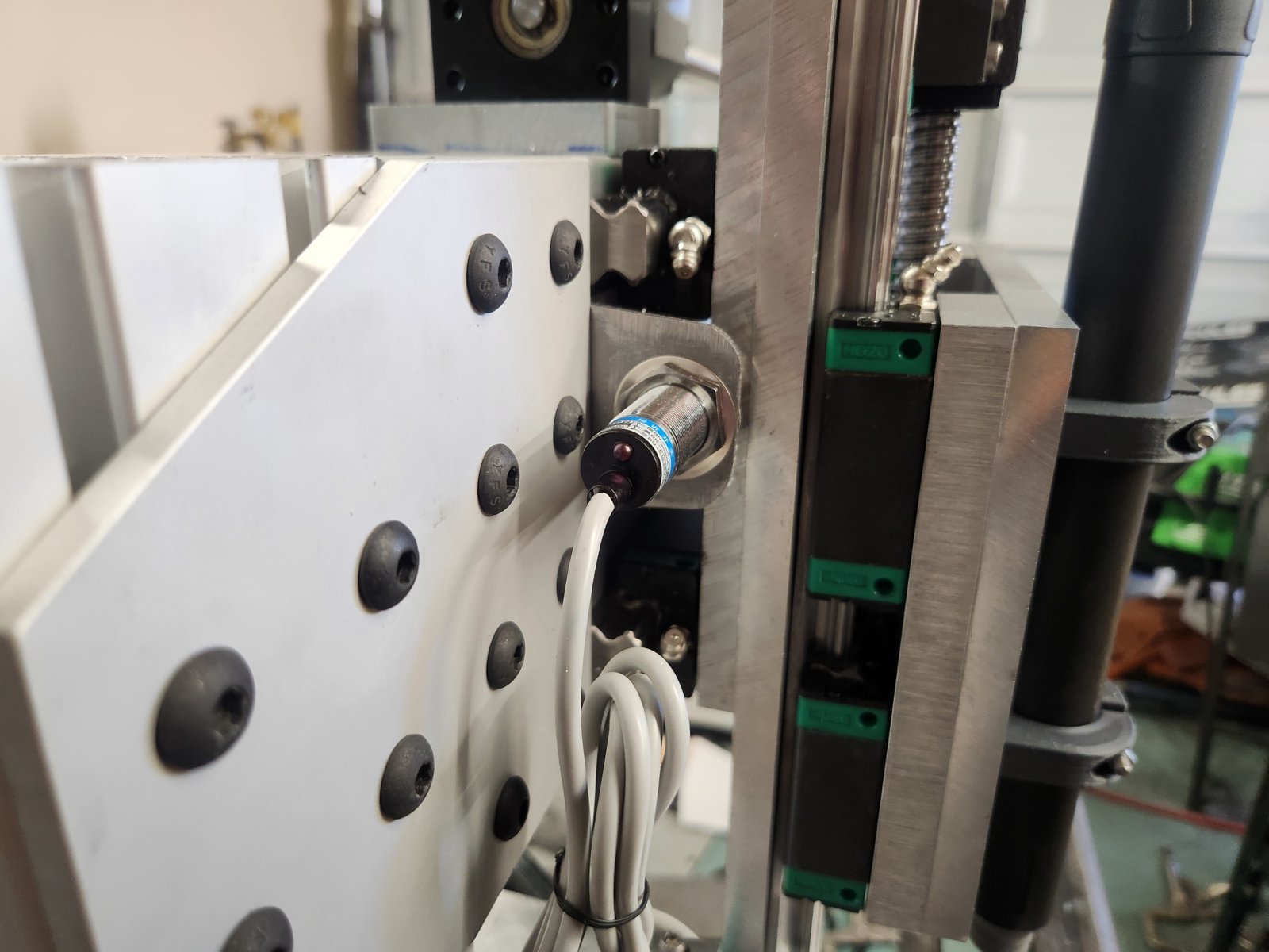

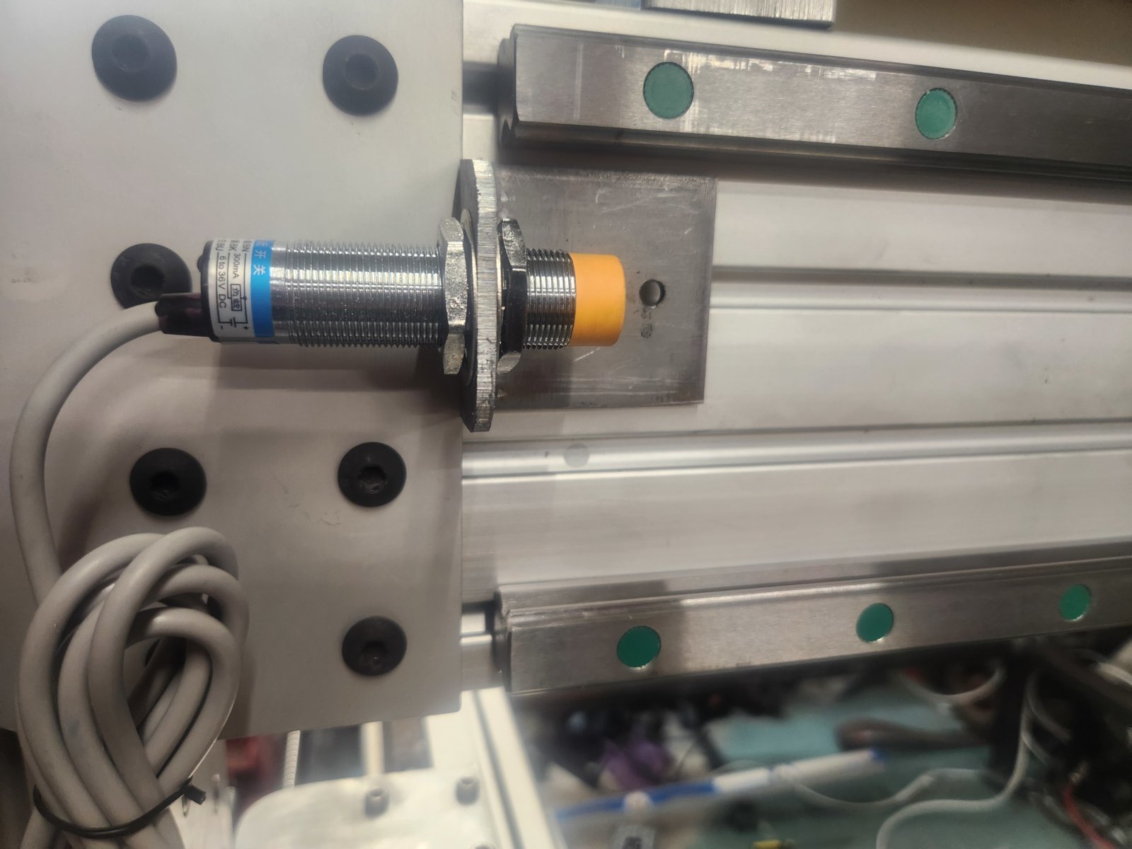

    Ran out of wire and the roll in T-nuts. So Not able to get the limit switches installed
    But I did get the bracket an mounting location figured out for the X Axis.

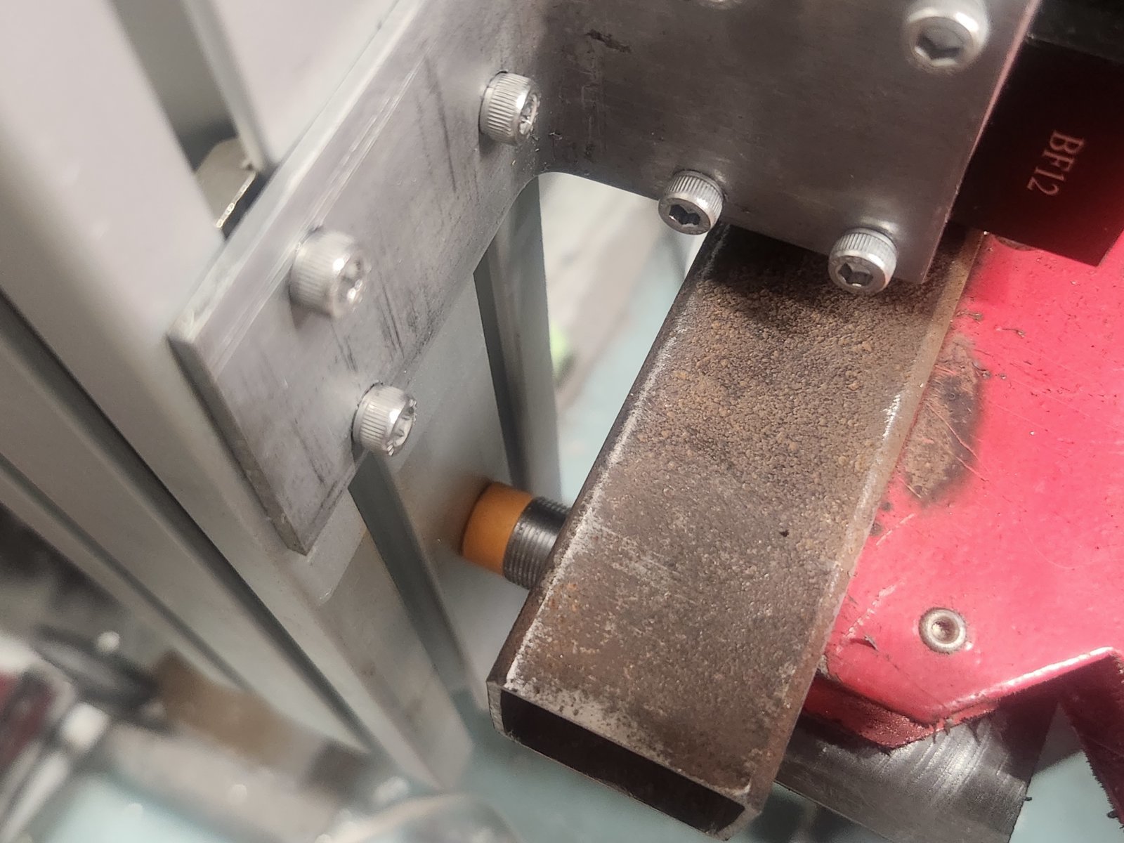

    I am also going to relocate the Y axis switches, the original location has proven to have a very difficult and fussy way of adjusting, the new idea will also become a built in spacer to keep the machine off the wall or future equipment, and t may help mounting the drag chain for Y axis as well
    The New Design...
    Putting the Proximity switch so it picks up the front / Rear face of the Gantry uprights, will make it a lot easier to adjust the desired stop position than the original idea of picking up the inside of the upright.
    I am using the forward most gantry position to set the initial location, while leaving a good amount of room to adjust the sensor position
    generalee2010 and koditten like this.

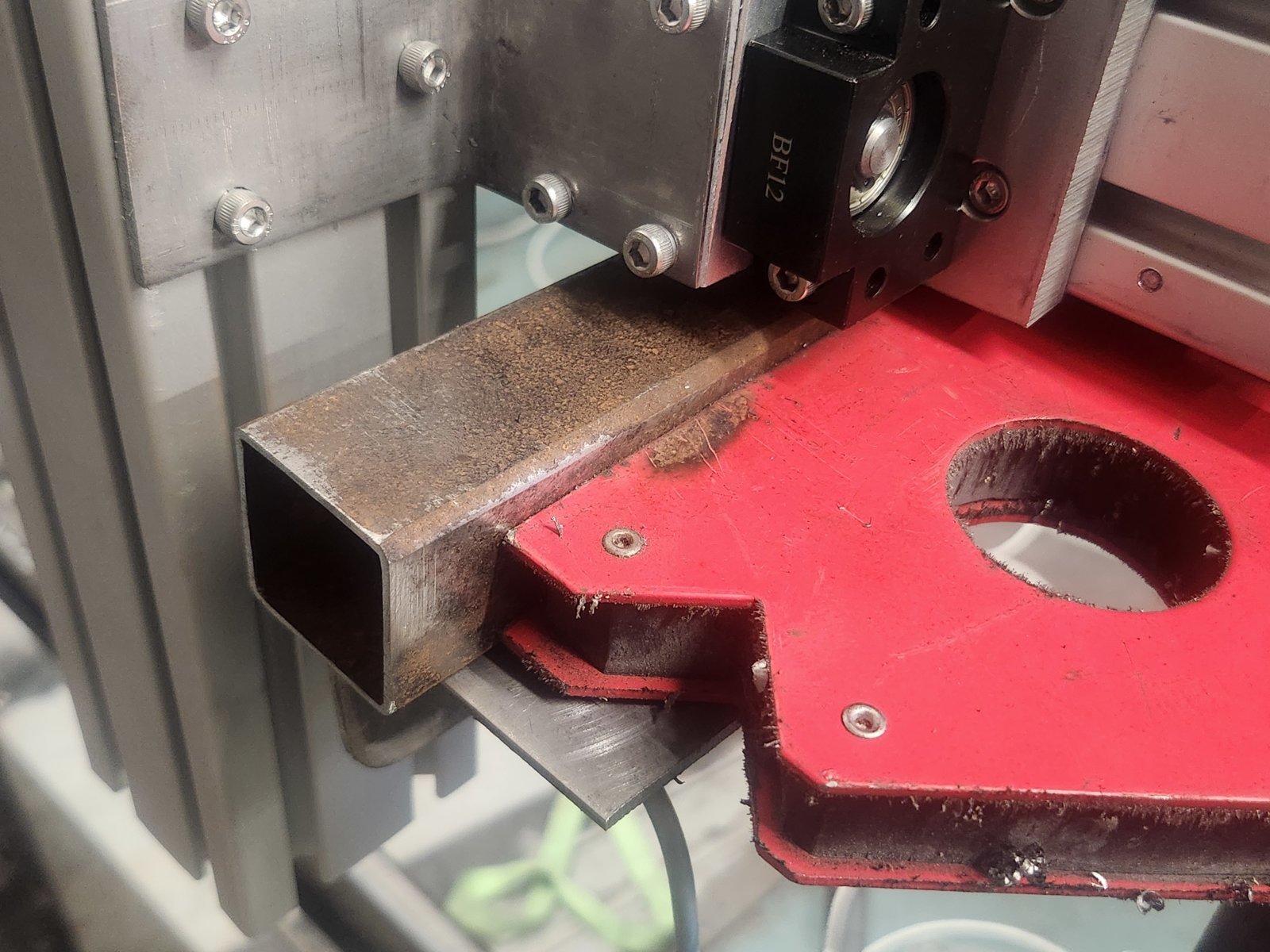

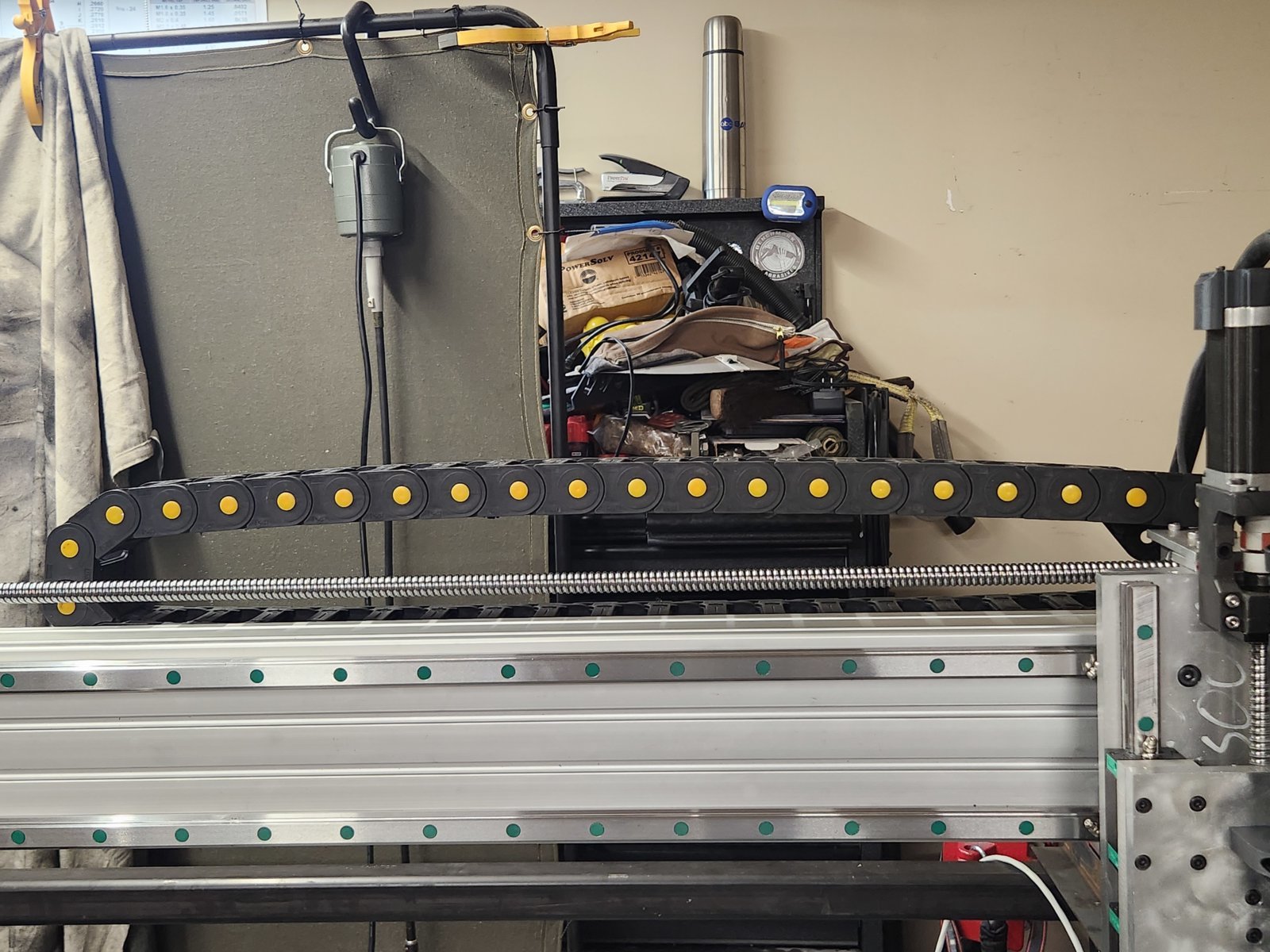

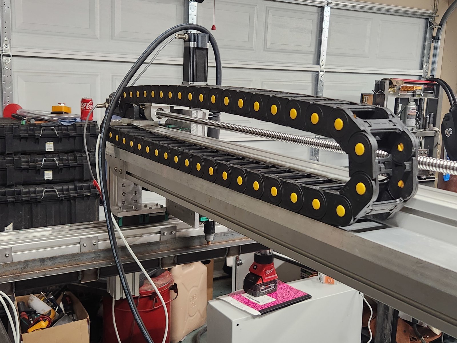

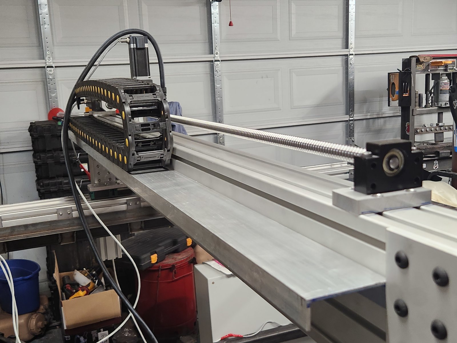

    Homes switch brackets are in place for the Y Axis
    I still need to adjust the proximity switches, and wire up the rest of them as well, Been feeling a bit under the weather so I have not spent a lot of time in the shop.
    I did order some stuff to get the drag chains mocked up, I started with the X axis since it was the simplest.
    I used some 1x3 Aluminum channel as the support track for the drag chain, Yea bit overkill but it looks good, an it fits the rest of the machine well.
    I am thinking of adding some bright white LED strip lights to the underside of the channel, any thoughts?
    I will need to remake the connector bar that connects the Z axis assembly to the gantry, it needs to be extended so the moving end of the chain can attach at that location, the fixed end will get mounted to the 1x3 channel.
    I will also trim up the spacer plate so it will match the Z axis plate thickness.

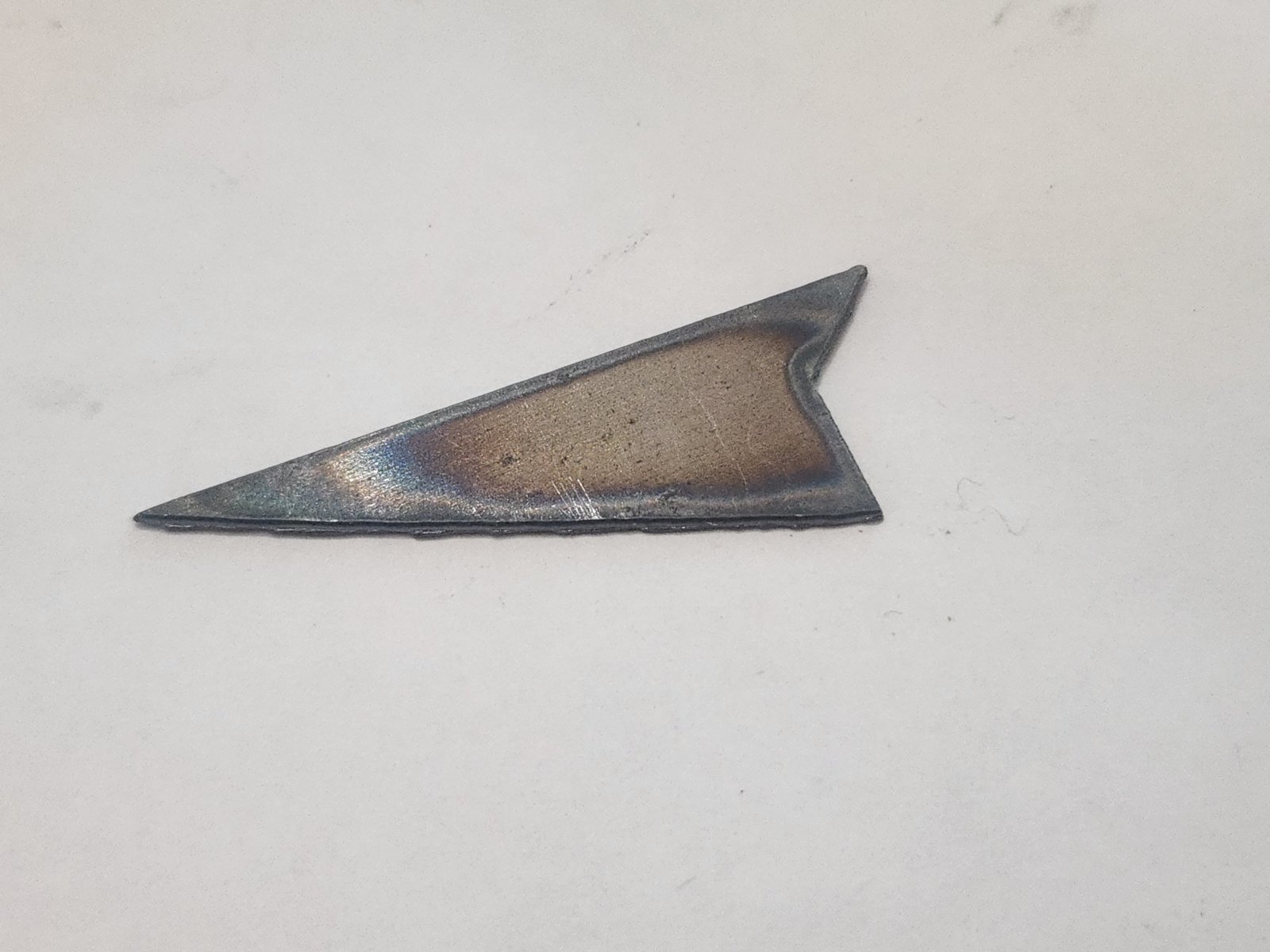

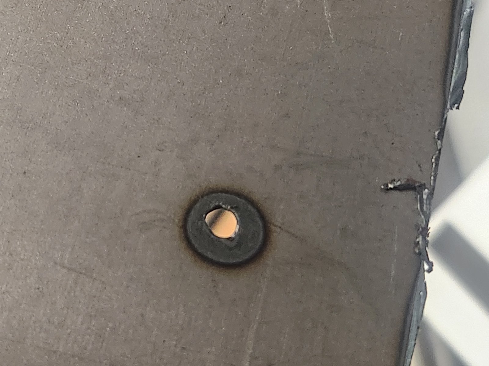

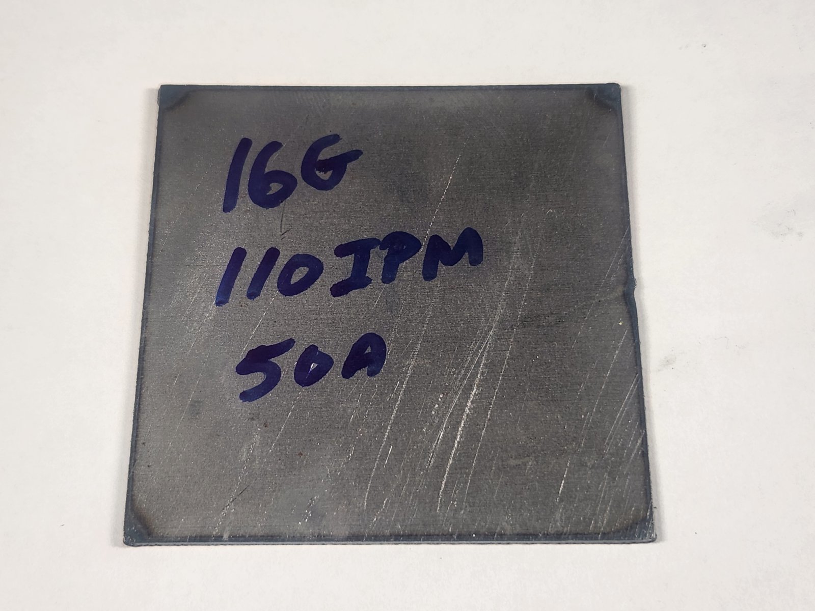

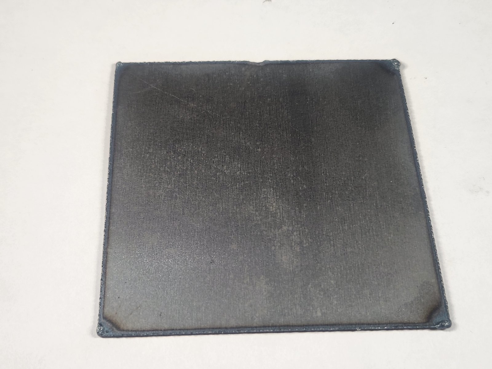

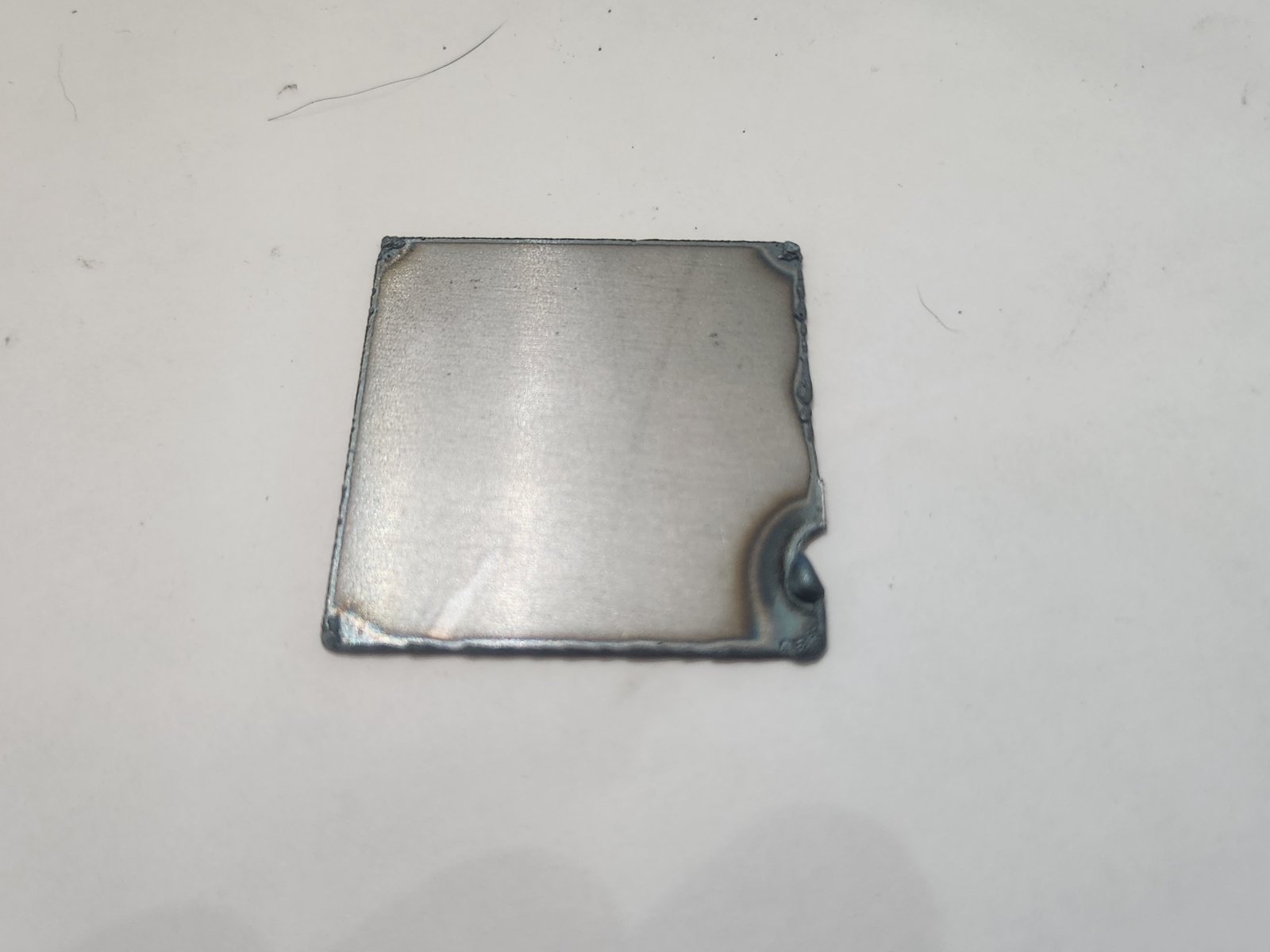

    Well, Finally did it. first "part" cut on the homemade CNC plasma table.
    I tried a test square from fireshare and ended up with a very unexpected result
    it should have looked like this..
    I figured it was a mistake on my part when generating the g code in sheetcam. So I decided to write some manual code to cut a 2"x2" square right inside mach4.
    ok, the machine can cut a square, even though this was a bit rough, I played around some more trying to get a better result. with out much luck.
    I then broke down and installed Fusion 360, I am not a fan of Fusion and much prefer Inventor, But Fusion has the CAM side I needed. I wanted to try something other Sheetcam an see if perhaps that was causing issues.
    I drew up a simple 3"x3" square with a small circle and a rectangle on it. run the simulation and it appears to be working. I even ran a couple dry tests on the machine an again it all seems to be fine.
    Run the actual part, and again not what I expected, this time the inner portions did not cut, for some reasons the torch did not fire, even though it traced the path for both of the inner portions. It did however cut a pretty clean square.
    Considering I am still getting the motors tune, it came out nearly spot on dimension. So maybe Kerf width is the issue here.

    Thanks for the tip in the right direction. I figured the tool library kerf setting was something that I needed to figure out the right value for.
    I think the whole workflow was off when I generated the tool paths. I created a different file and did each profile separate, and this time I made sure to click on the setup before running the post processor. This time when viewing the G-code I see two comments for different profiles.
    Before you was asking why the 3d-printed torch mounts... well... I caught the torch on a cut out and this happen
    I need to do a closer inspection to make sure the torch head or body is not damaged, hopefully it survived with no hidden damage. but the it broke the carbon fiber nylon mounts before I could hit the stop button. if they had been metal I would have broken the torch with out a doubt.
    This does reinforce the idea of making a magnetic breakaway mount. Which My thoughts right now are to use the threaded holes I am currently using for locating pins, attaching a strip of sheet metal to back of the new mounts and counterboring a hole for some small round neodymium magnets
    But for now, I am waiting on parts for the plasma cutter. Somehow I managed to break the regulator and there is a ton of air escaping through the front vents. So I got to test out that Primeweld customer service today. and it lives up to what every says about it.

    Also, what plasma cutter are you running?
    50 amps and 110ipm on 16 gauge is either, too hot at that slow of a speed or too slow for that hot of a setting.
    Varying machines are around the 28-35 amp rating at 100-120ipm, if going higher like 45-50 amp rating they're normally running over 200ipm.

    Ahh ok, never ran Mach 4 and interesting that one post process supports your THC and the other doesn't with different CAM software.
    I don't run a PTM-60 (although I used to) but I believe I was about 100-110ipm and some 28 or 29 amps with my CUT60.
    My current UPM-105 runs 100ipm and 30 amps for 16 gauge.
    Hope these numbers get you closer to where you need to be.
