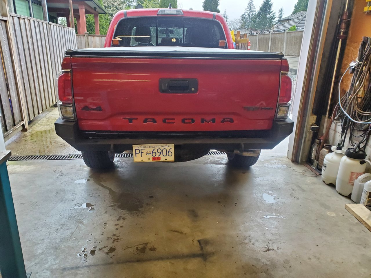

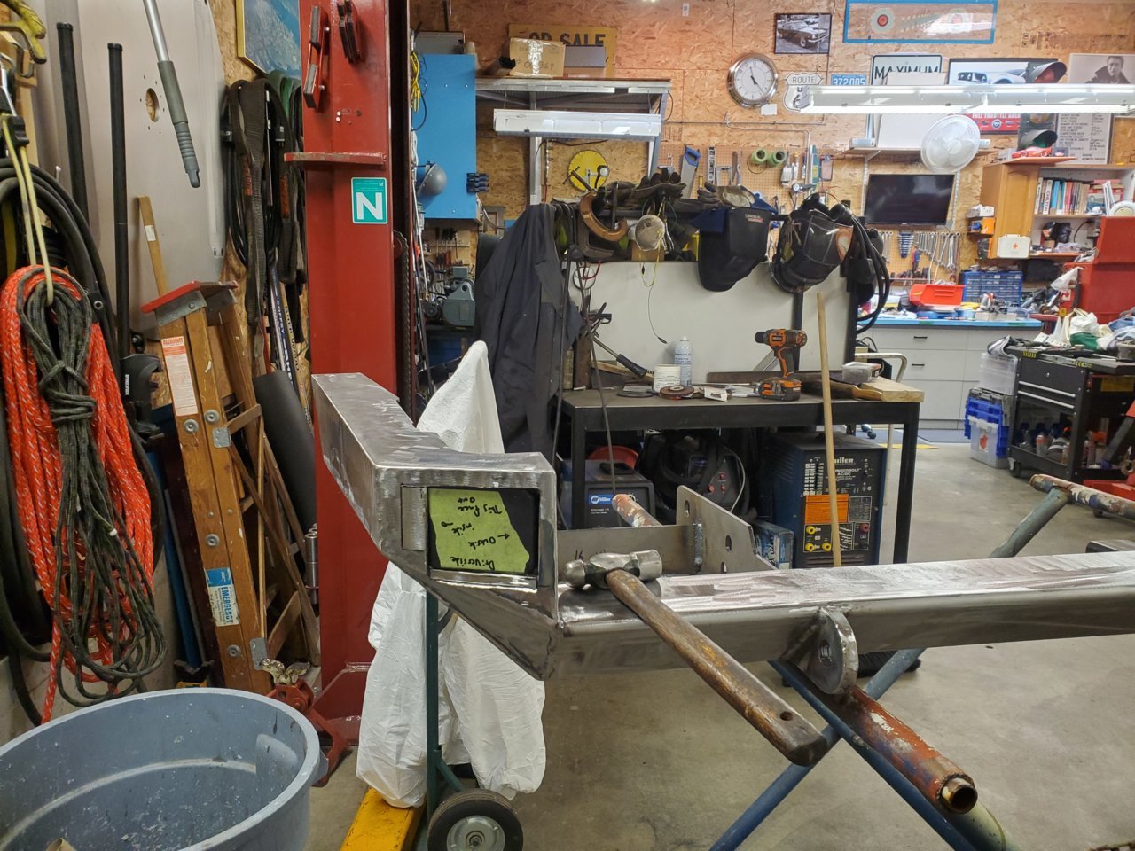

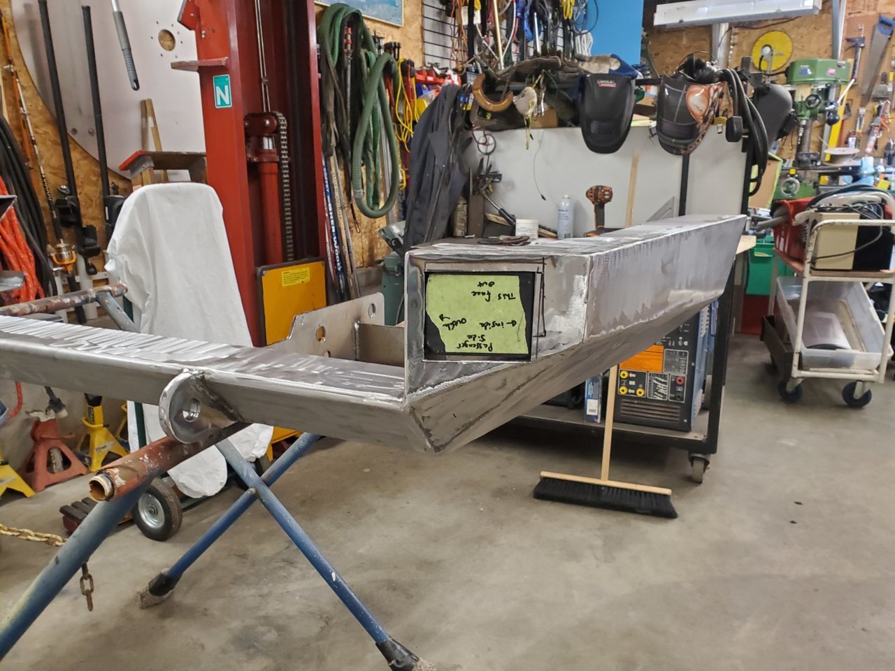

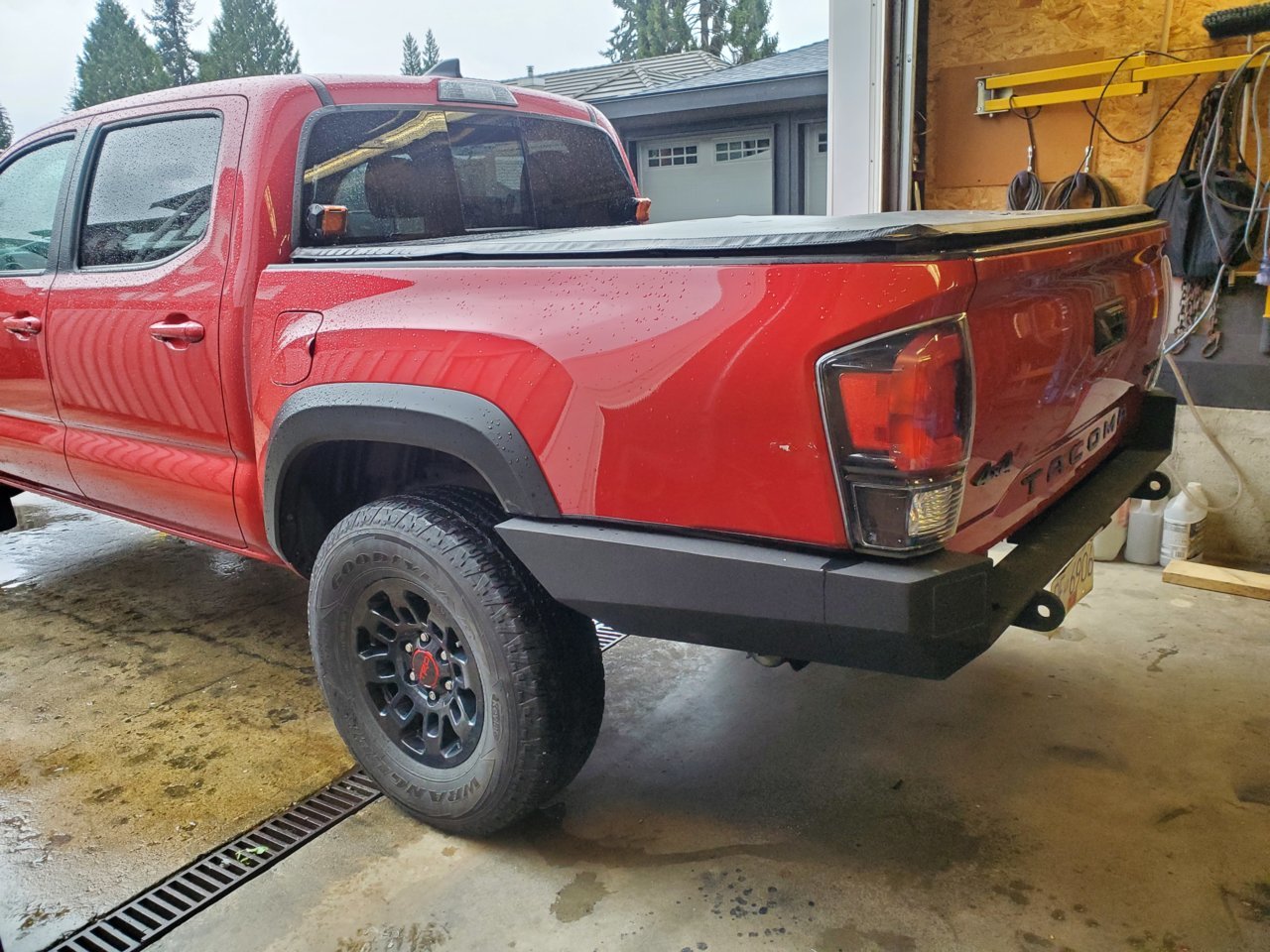

    I recently built up the coastal offroad rear bumper. Cut out a section for the blindspot sensors. Has been working so far! Used lexan to cover the opening and then painted everything in raptor liner.20210424_171739.jpg 20210424_171722.jpg 20210710_133751.jpg

    There are 2 holes drilled into it for the license plate but it covers the hitch. I am currently just using one bolt with some fender washers but you could get a flip up license plate cover.

    Sick! I will look you up down the road when I do mine. I dont even see the sensors on yours...?

    Are your BSM sensors working well with the new bumper? I think I might try something similar

    I just have the blind spot sensors in the corners. I imagine for the other sensors on the newer vehicles you could do something similar with the Lexan covers. You need to make the openings a fair bit larger than the actual sensors. I don't know what the sensors look like for the clearance sonar but I would imagine they are all pretty similar in function. Personally I would take the bumper off and "hot glue" some steel plates beside the sensors to mimic a fully steel bumper and see what happens.
    I tore the original bumper off and fixed it with some steel plates on the inside near the BSM sensors and that is how I knew the metal would not interfere with the sensors. On my first attempt with the openings on the Coastal off-road I did not make them large enough and was getting some interference/ false positives, so I made them a bit larger and have had no problems since. I think its just important that there is nothing metal where the sensors are "looking".

    So far so good! When I originally cut them in I had some "false positives" when driving next to fences or metal poles but I cut the openings a bit larger and that has worked. I will still get the occasional light coming on for a fence or some other metal object but I have also put on 33s so it sits a bit higher and I don't think I angled the sensors perfectly (I eyeballed where I thought the sensors should be....). I honestly did not have much hope of it working since all these professional off-road companies have seemed to fail at it, but it has turned out well.
    If I was to do it again I would spend a significant amount of time trying to replicate the factory angle/position and cut my opening much larger than the sensor. I would also find a better mounting solution as mine are kind of just wedged in the corners and held in place with a shit ton of epoxy......
