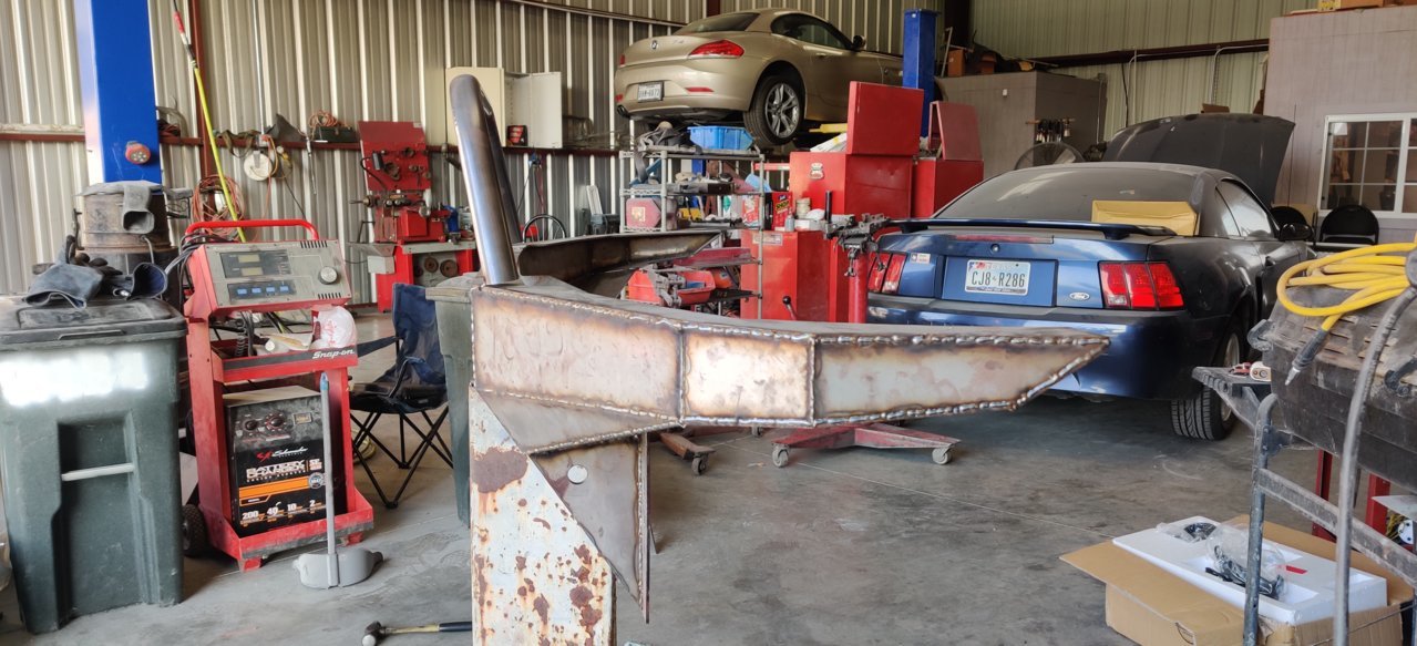

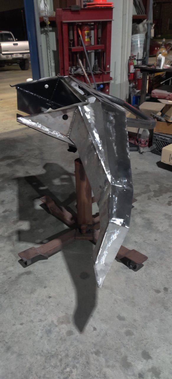

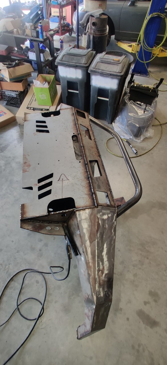

    Almost all of the welding is complete except the front plate. I plan to paint the inside of the bumper and front plate and then assemble. Not before grinding what I currently have down and setting the bar angle as I do not want it to run parallel to the grill.
    Picked up two large canisters of 75/25 wm8 today as well. Should be good for awhile. I definitely need to hook up the 220 as I noticed some funkiness with the 110. Nonetheless I ran full welds on both sides. It wasn't so bad honestly!

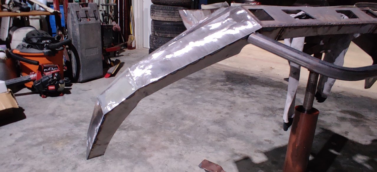

    Finished up a wing.. I really wanted clean lines, and I definitely learned a few tricks! Really tedious stuff, especially in this heat lately. I am happy with how it came out so far, definitely not looking forward to doing the front plate :D
    Grinded with 50 grit, will be stepping it to an 80 and then the paint stripper doodad for some smoothness

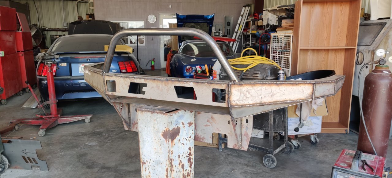

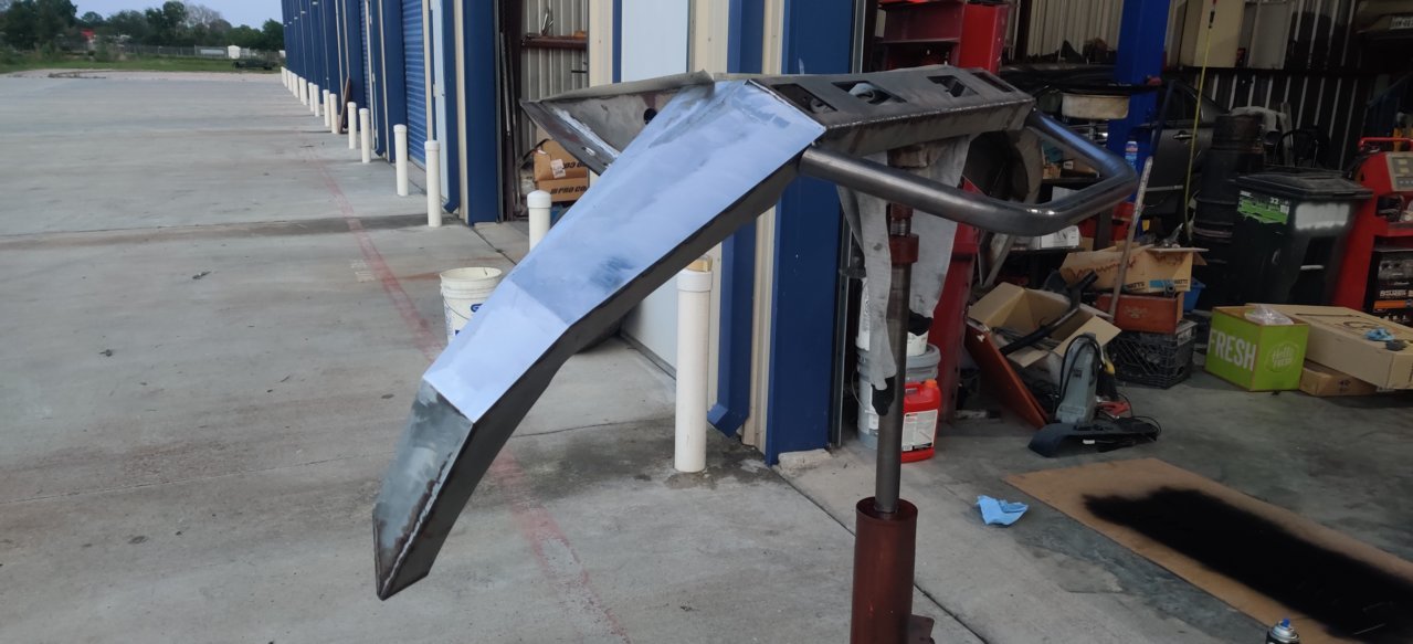

    Front plate is on! All that's left is some more grinding and paint. Hoping to finish by Monday!

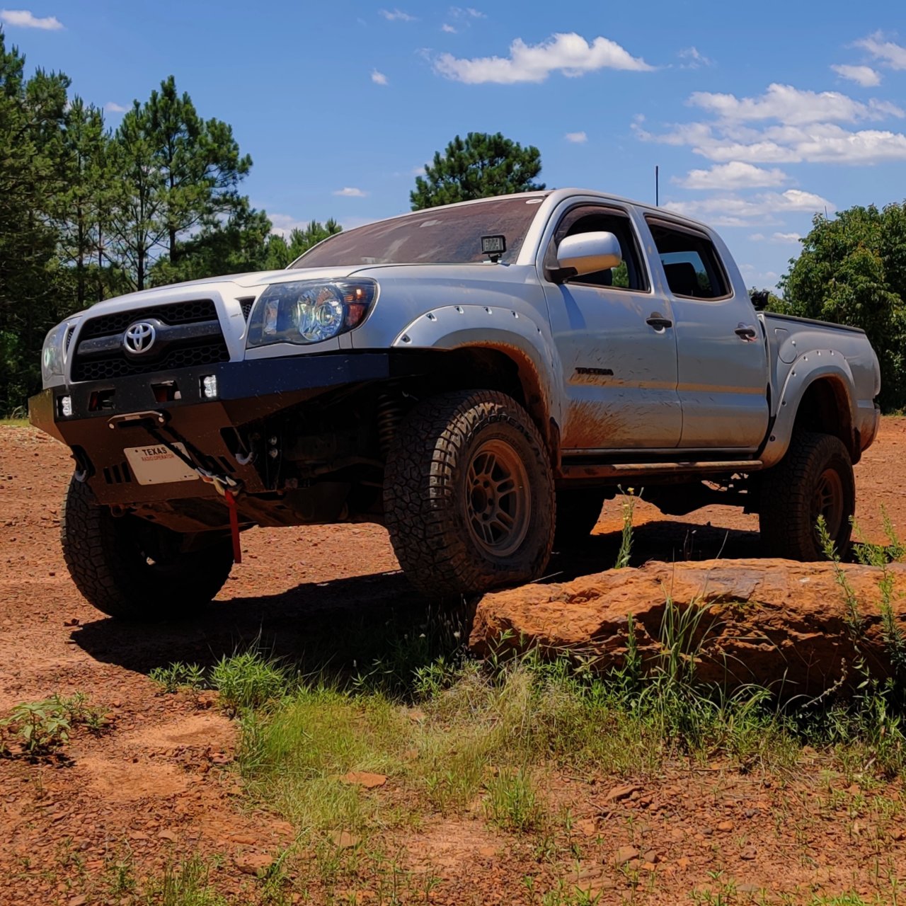

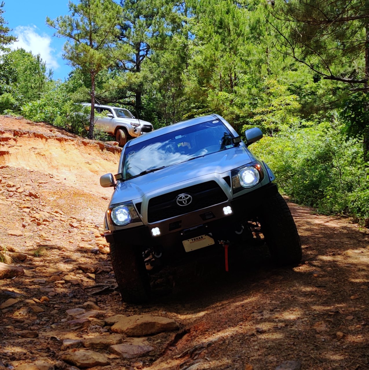

    So I completed the build (still need the weld hoop and lower support) added a winch and do some wheeling.
    I noticed -
    1. Front mounting points NEED to be angled otherwise the bumper wings look like they are sagging. My bumper upper plate is complete level so additional modifications to the front mounting area will help to level it out more.
    2. Mounting holes are NOT enlongated enough for correct alignment after modifying front mounting point angles. This will cause a huge gap of 1" without modifications.
    Other than those minor issues which I will resolve, super happy with how it turned out.
