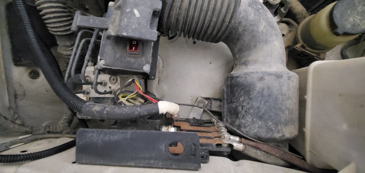

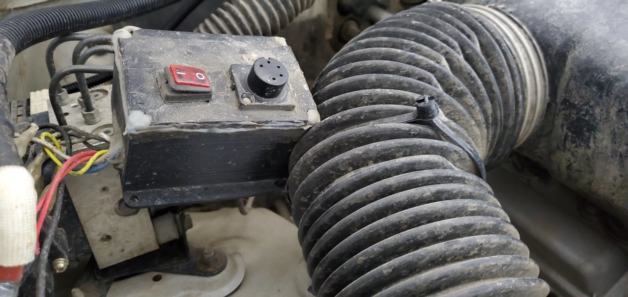

    Sorry it took so long. I am incredibly selfish and normally only come on to look up parts. But this is the 3d printed box. Its pretty cheap to make. And its easy to just zip tie it somewhere. I guess you could do the same thing with Tupperware. I covered the screws, the hole for the wires, the switch, the plug and the seams with silicone. Its completely waterproof. I mounted the contractors on the passenger side inner fender. I plan on rewiring everything with 14g wire I get from work. (I'm a forklift mechanic/welder by trade) I can get the super flexible wiring that has hundreds of small copper fibers instead of a few thick wires. And the insulation is 100% silicone. I will be making it longer and feeding it though the fire wall and have the switch, plug and reciever on the back side of my glove compartment. That way I don't have to open the hood to turn the switch on. I'll post pictures if I every get to it. Lol if anyone has suggestions on a better way I'd love to hear it! Or if anyone has a suggestion for something better thats just as good too lol. As far as I know it's not too common to put a apex in a coastal offroad bumper so if I can answer any questions about what I did, I'd love to help!20200425_194846.jpg

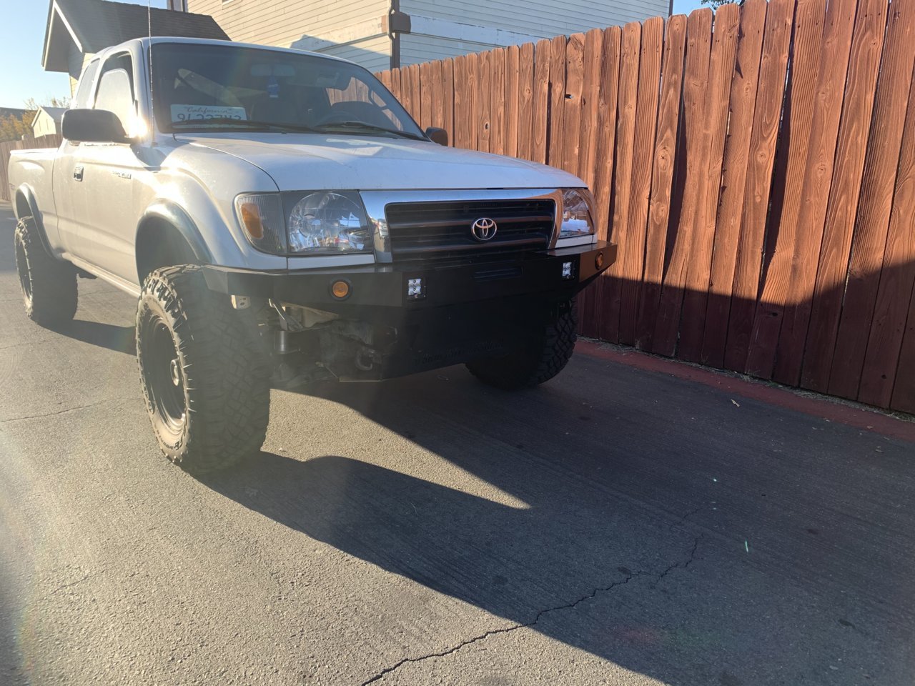

    C646C48F-3E1F-4183-87C1-7C91906FE7B5.jpg Crappy pic but here’s an updated look with LEDs and turn signals added
