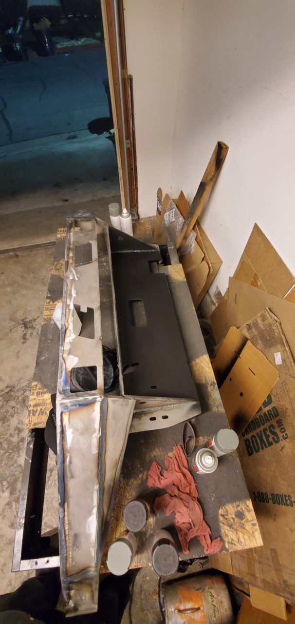

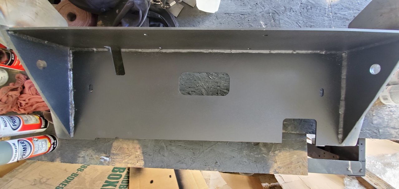

    Tacked my skid set together going to test fit it today then burn it in if everything looks good. This kit is really nice everything seems cut perfectly, directions could maybe use another pic or two but once you kind of set everything up its pretty straight forward.

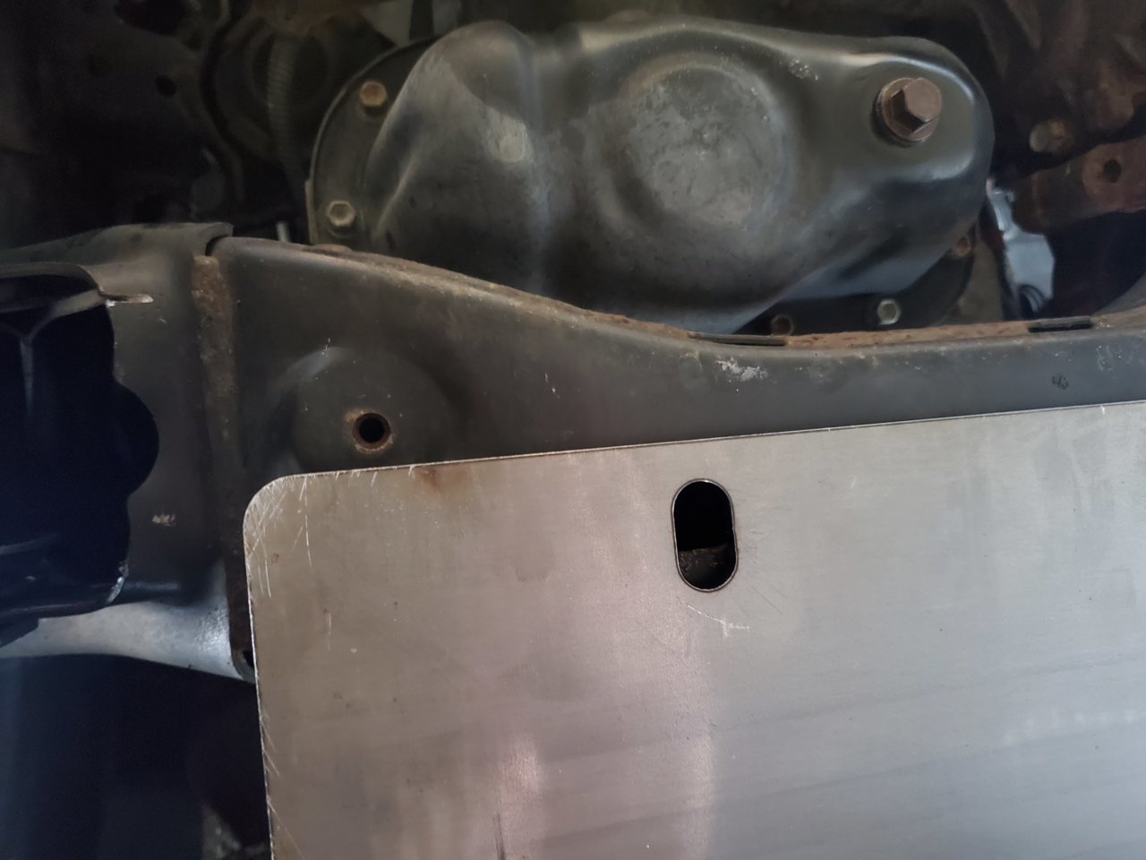

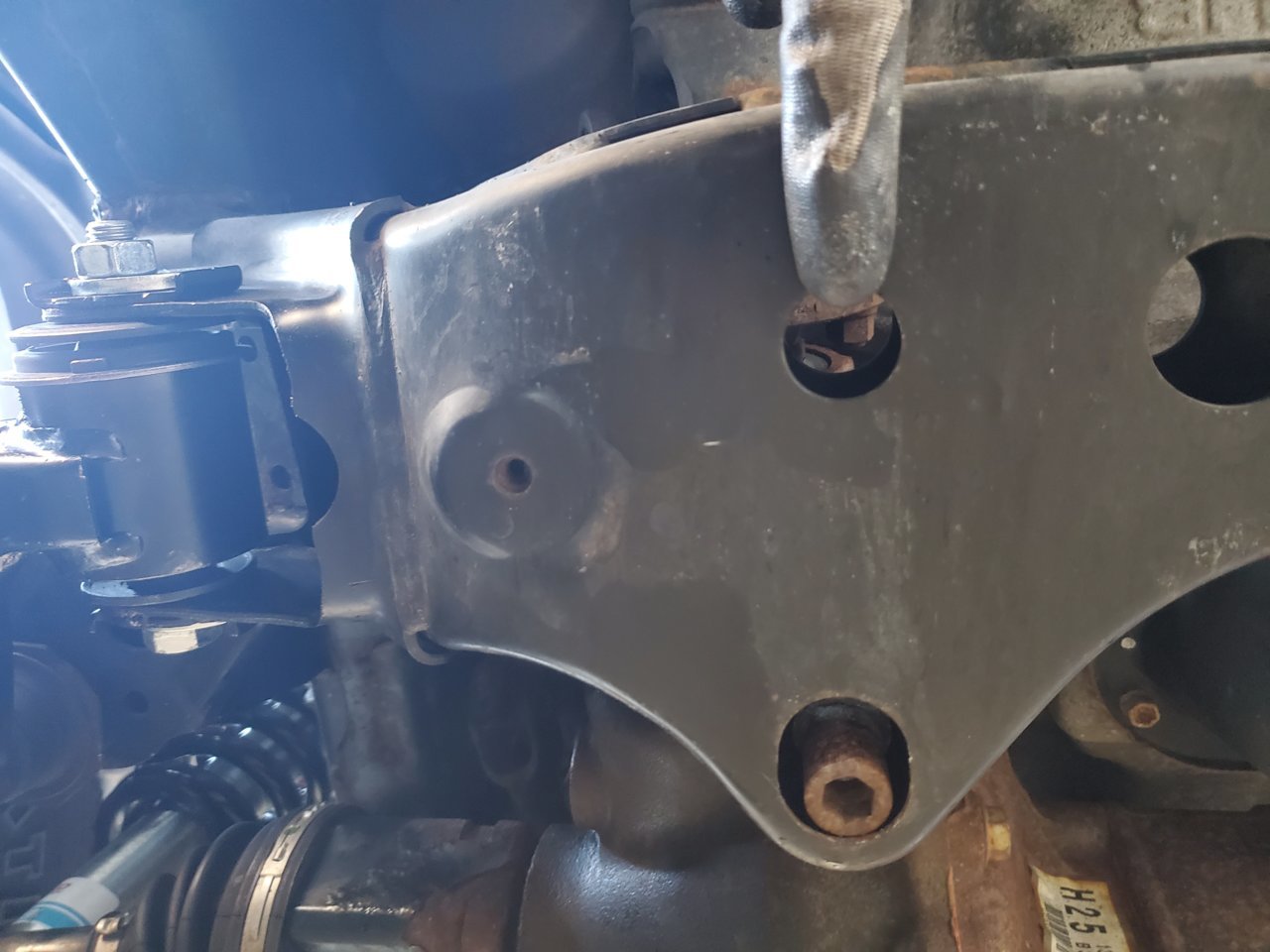

    What is the rear of the skid supposed to bolt to? I see two welded in bolts by Toyota but they don't match up with the rear standoffs. Only thing that matches up to the rear standoffs is the holes in the cross member. (Where i am pointing in the second pic)

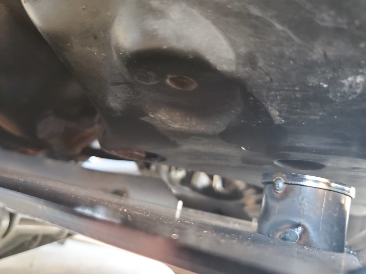

    Better pic with the rear skid in place

    Gotcha that makes complete sense. I was looking at it like, how in the hell do I get a nut inside that cross member and how do I keep it from spinning. Going all the way through the cross member makes way more sense. Thanks dude you saved me a lot of headache, I was beginning to freak out a bit. Ill have to grab some hardware at the store tomorrow but at least I can start finish welding it!

    Yeah I grabbed the directions and it shows the size bolts but it didnt mention how they mounted to the frame, Once I saw your message I went back and read it and it says you need bolts but I figured there was something you bolted them to instead of just clamping it to the frame. I then started looking for where the gussets go, mine came with 4x gussets for like a 90deg gusset. nothing is referenced for them either.
