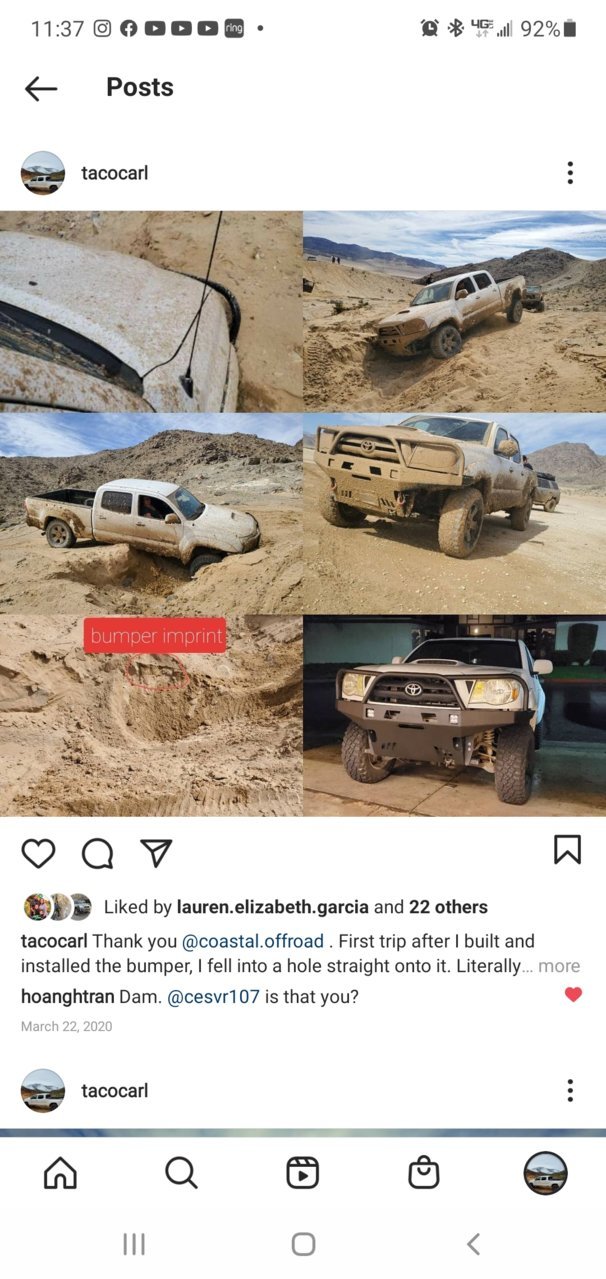

    This was right after I welded and installed the bumper. Now I'm not saying I'm the greatest welder ever and that I know everything but I do know that if this bumper was welded with a little hobby flux core welder, Like all harbor freight welders are, (They are getting better though) then it would have cracked. I'm not saying go out and buy the best welder you can. If you can only afford a little buzz box then have at it. I don't even own the welder I used. It's my work welder. But facts are its not going to be able to withstand what a bumper like this is supposed to. Maybe with every edge beveled pretty hard and multiple passes but with flux core you are just inviting porosity and contaminates into every joint. If you do use a hobby welder, be super meticulous in cleaning all the slag off in-between passes. AND FOR THE LOVE OF GOD. Do not quench your steel.

    I hit a deer with mine with no damage.:notsure: Not flux core but still HF. TBF it wasn't highway speed but it wasn't a soft hit either.

    That's awesome! It's good to hear. But I'm not saying I absolutely can't be done. And even if I did say that there is an exception to every rule. But generally speaking it's not a good idea.
