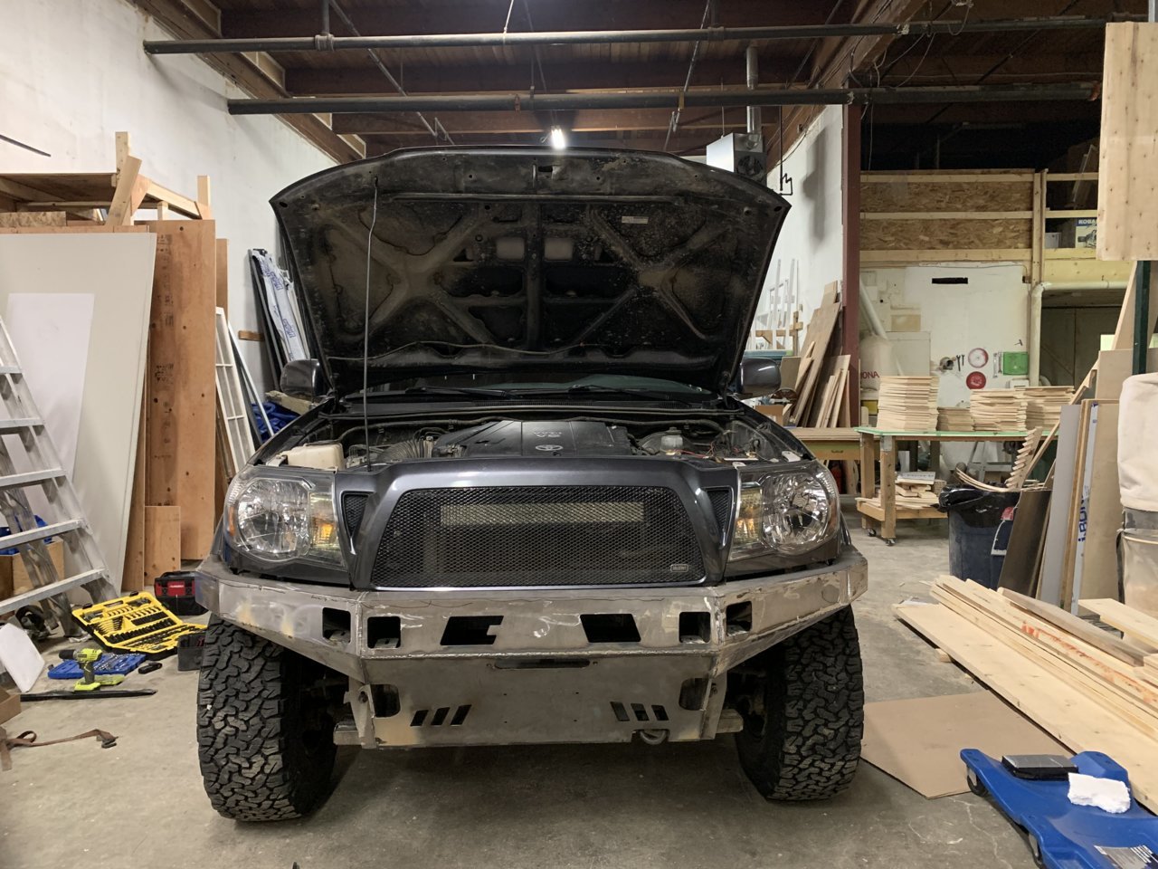

    Braeden
    BC
    Pretty sure it was designed around the amittybilt 9.5k, but we have put the x2o in as well. Need to drill out the fairlead bolt holes though. It is very very tight. Maybe have to trim some other stuff out of the way as well, and likely relocate the solenoid.
    Bigdaddy4760 likes this.
  2. Feb 1, 2021 at 7:30 AM
    #322
    thebang86

  11. Apr 21, 2021 at 10:23 AM
    #331
    Dye22
    Dye22 Well-Known Member
    Sep 2, 2016
    #196288
    425
    Squamish
    '15 TRDOR ACLB
    JBA UCAs OME 2.5 in lift w/ heavy duty dakars. 33" ko2s tc bed stiffeners firestone airbags w/ ride rites cmc/pinchweld rear flushmount leds amazon ditch lights apex sliders 0 degree w/ kickout Coastal Offroad high clearance front bumper w/ full tubing Coastal Offroad high clearance rear bumper w/ tubing and dual swingout 100 AH LiFePO4 Aux battery blue sea fuse panel for aux battery rear diff mod breather Mountain Hatch tailgate insert Smittybilt x2O 10k winch Anytime Camera Mod Front and Rear GPS locator brick BAMF Hangers w/ custom crossbrace 2lo Mod by up2nogood yakima access cab roof bars thule hyper xl cargo box amazon roof basket ARB 1250 awning WaterPort Meso Dual Color Dome Light Durobump Front Bump stops
    All their bumpers are similiar in that they all come fully disassembled and and require you to weld them up. I am not sure what you mean by with a little press brake work some welding could have been eliminated though. I will say that these kits are incredibly easy to put together, (especially this type considering you don't have to cut your truck up at all like you would with the high clearance version) and many people take it on as their first big welding project. If you are really worried about warpage, just make sure you take your time and measure everything twice before and after tacking. And when it is time to weld just go slow and do a bunch of small welds all over the place rather than welding full plates at once as well as letting welds cool a bit and you shouldn't have any issues with warping.
    I think most of use here have been very happy with our coastal off-road products, and I haven't heard of anyone really screwing anything up.

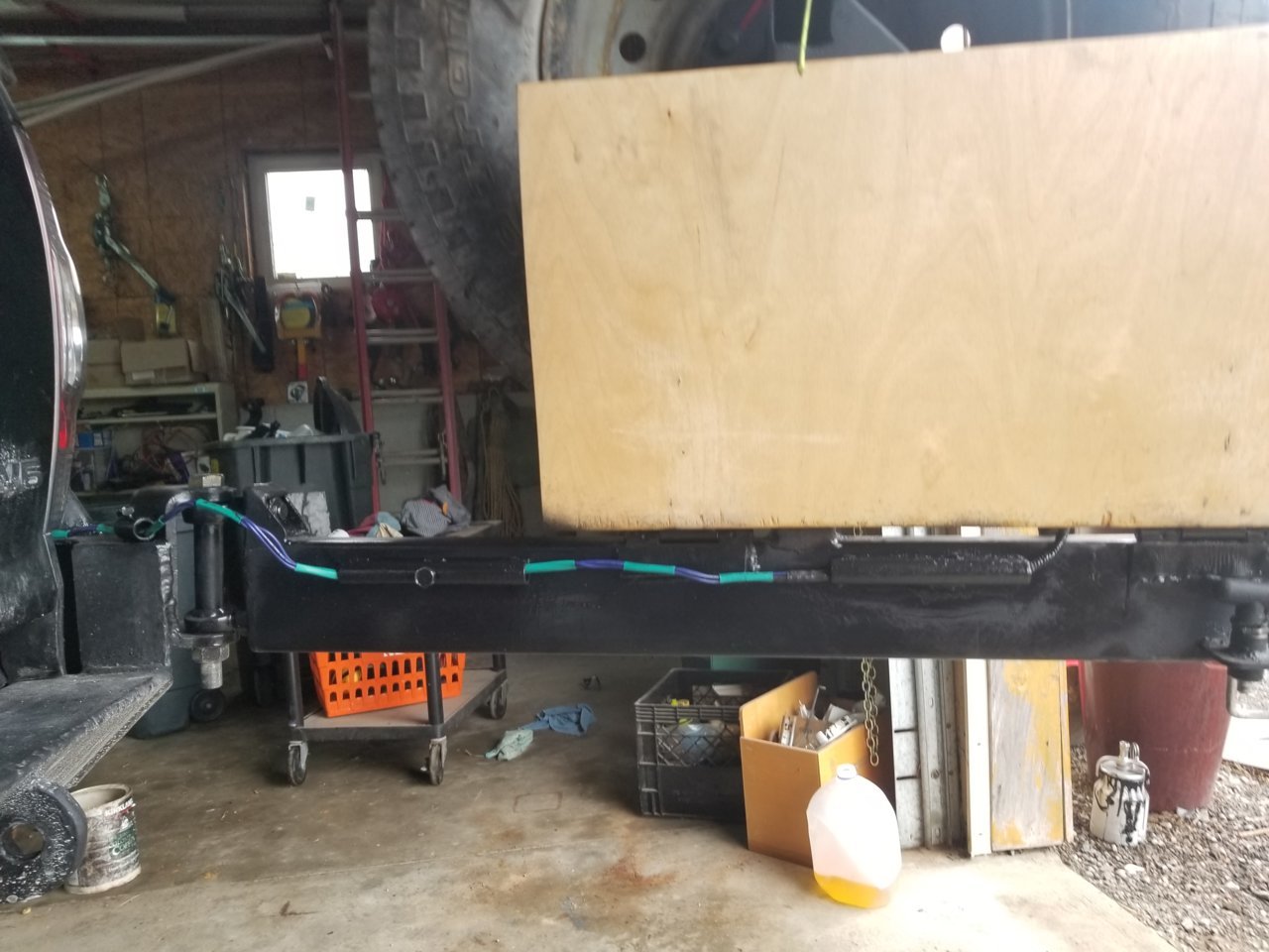

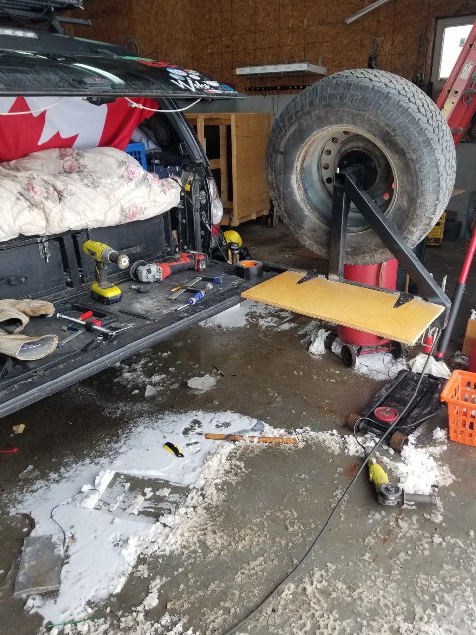

  19. Apr 28, 2021 at 12:10 PM
    #339
    Dye22
    Sep 2, 2016
    #196288
    425
    Squamish
    '15 TRDOR ACLB
    put a table on the swingout to have more counter space while cooking. folds down flush with the tailgate and is supported by 90 degree max door hinges. I wanted avoid the wire/rope supports as they get in the way.
    and relocated the back up camera
    used some thick tube so i could tap it and put a bolt through to pinch the wiring in place. inside the tube is a small flat bar that spreads out the pinching force to prevent any wire damage.
    there wasn't a whole lot on what people did with their wiring that didnt involve zip ties so I thought I would share what I came up with.

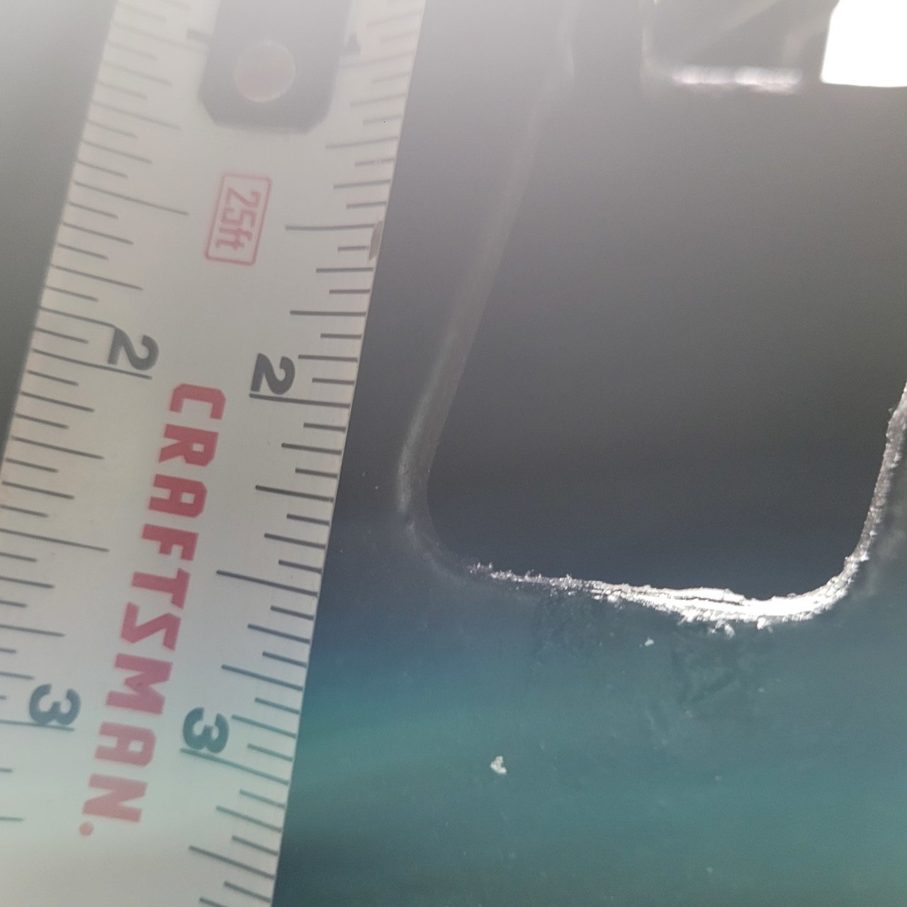

  20. Jul 20, 2021 at 1:03 PM
    #340
    __TT__
    __TT__ Well-Known Member
    Jul 17, 2018
    #259620
    57
    Jason
    06 sr5
    does anyone have access to a non body lifted front bumper that is not installed? I need a measurements for the ac line cut out. like this
