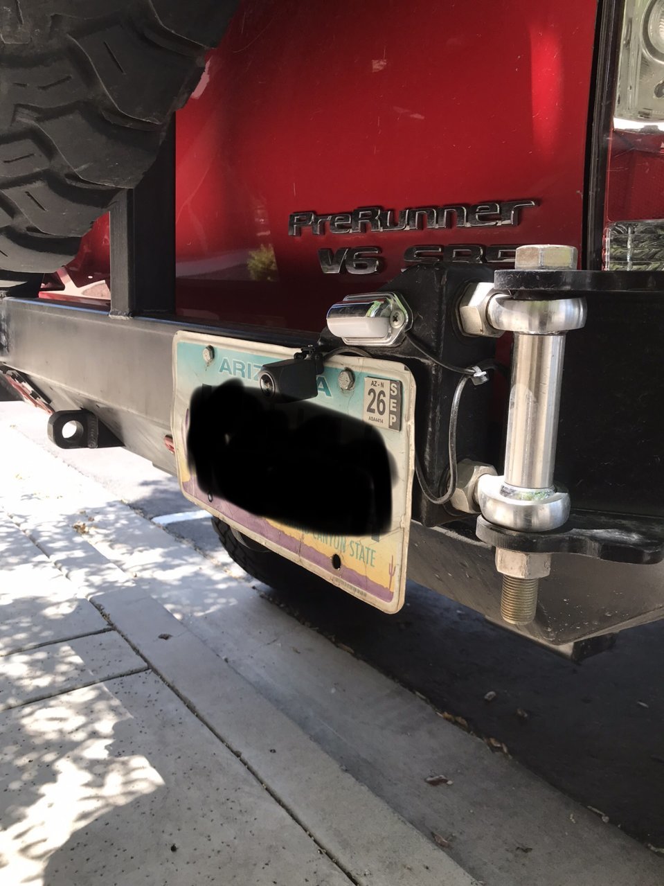

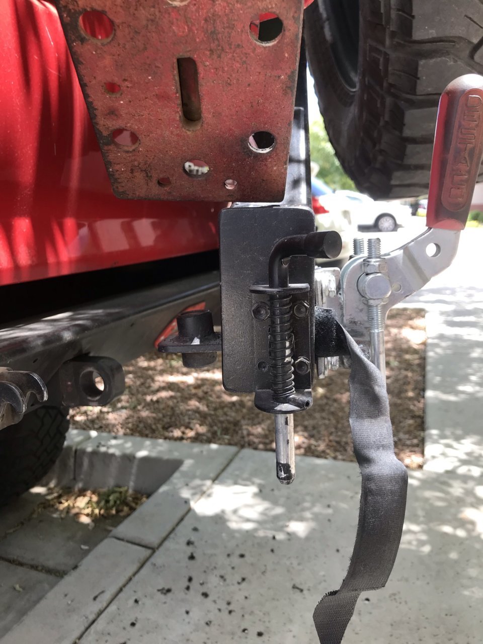

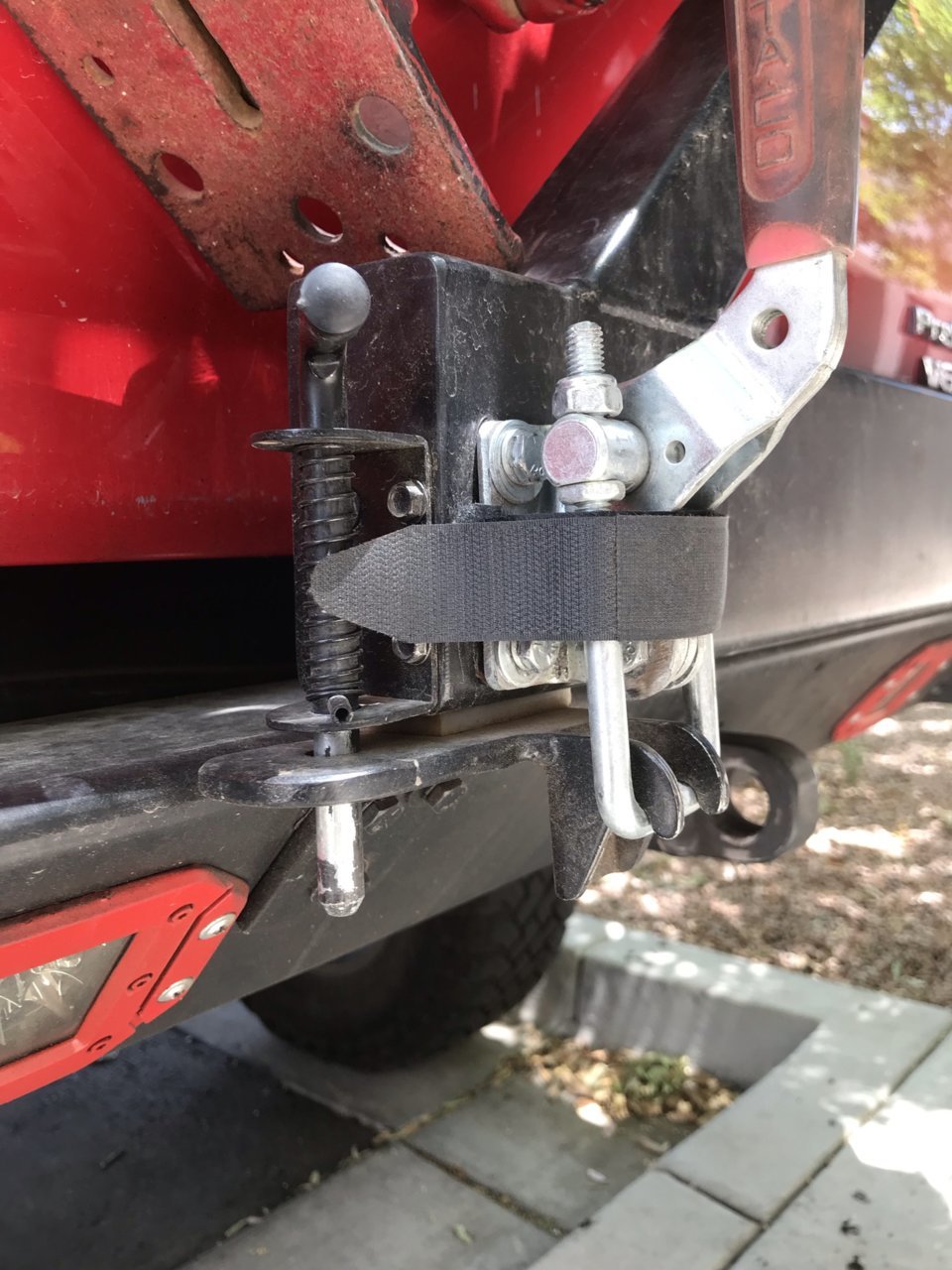

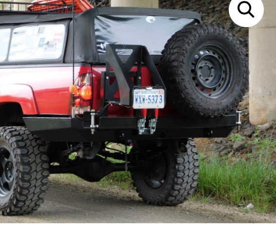

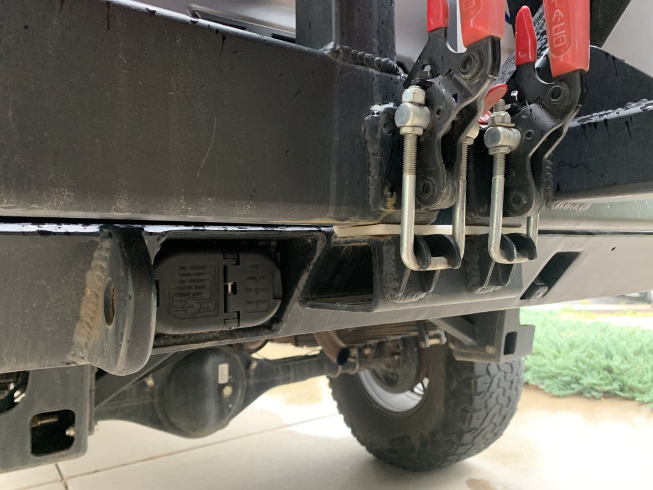

    I did mine a little differently, I had the same kinda issue and made it work. I also wanted mine to be removable (other than the C bracket for the swing out). Here is what i came up with, i couldn't get the little bolt to stay in the hole while bouncing around on trail and added the strap for added insurance incase the latch popped open as well. So far with a new bolt pin on the side hasn't came open or wiggled any. The Velcro strap is still nice insurance.

    That 2x3 tube they sent made its way to my scrap bin after i seen how they used it. Def. not clear on the install directions. had to come up with my own.
    *edit*
    Also the plastic deal that mounts under the arm had to be trimmed flat to avoid my tail gate while open and sitting/stepping on it. Not sure if its the same for everyone ?

    @KingOfTheNorth No problem, I can send you more if needed. I tried a few different ways to clean it up. The pin provided seems too short and couldnt get it any lower on the tube or it would drag.
    PS the PoPo didn't like my license plate on the angle over the receiver hitch so I put it on the PS side tube with some 1/4"x20 bolts and wired a light and camera.

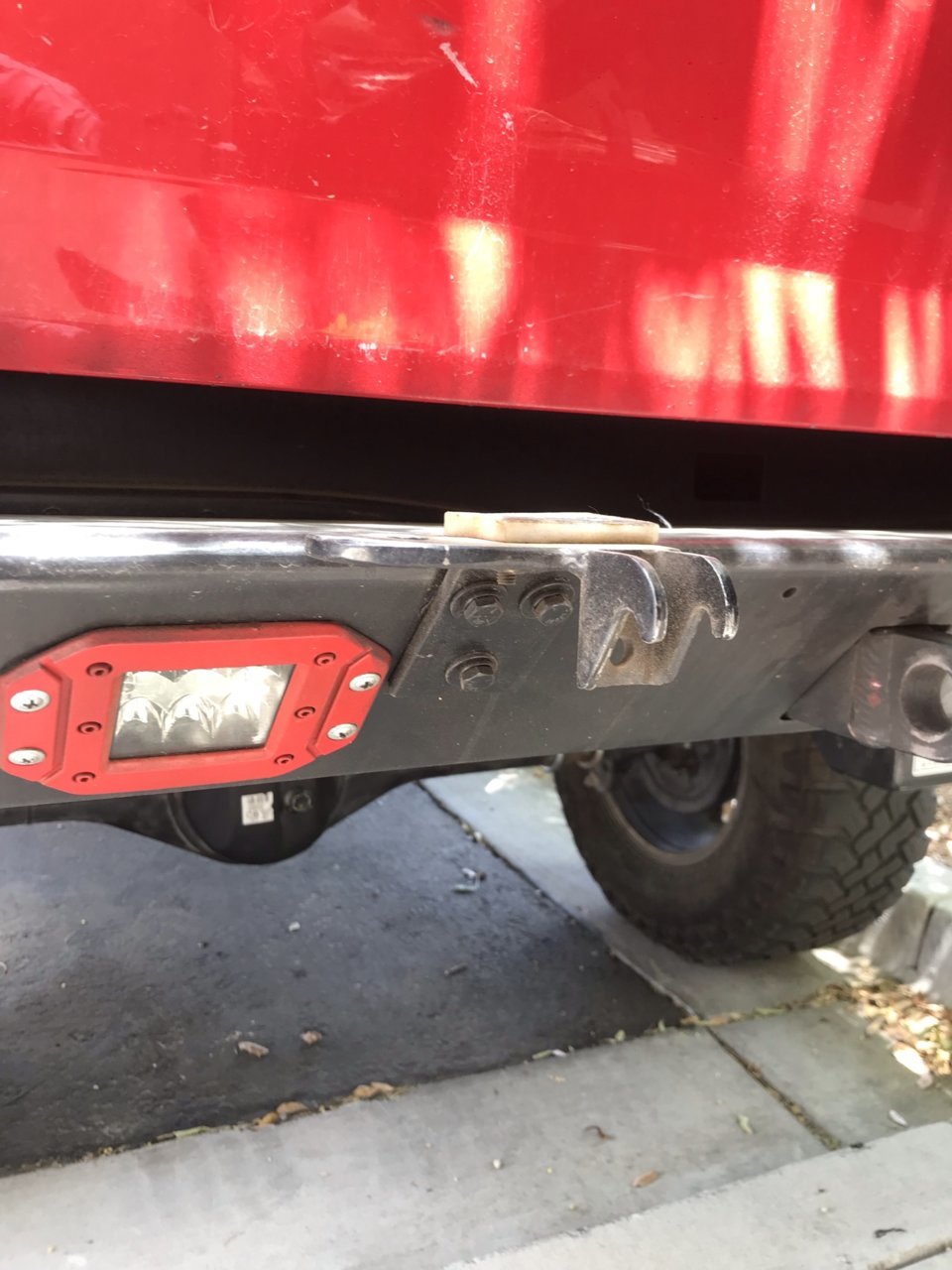

    I think cutting the block at the 45 is what they are calling for on the install, but it looks like poo and sticks Way out with both swings out. I think @Atl-atl has the same issue. Maybe he can chime in?

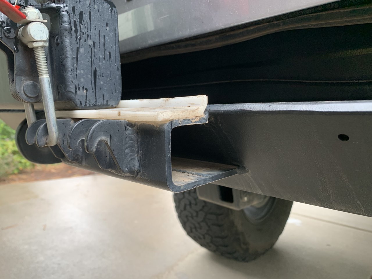

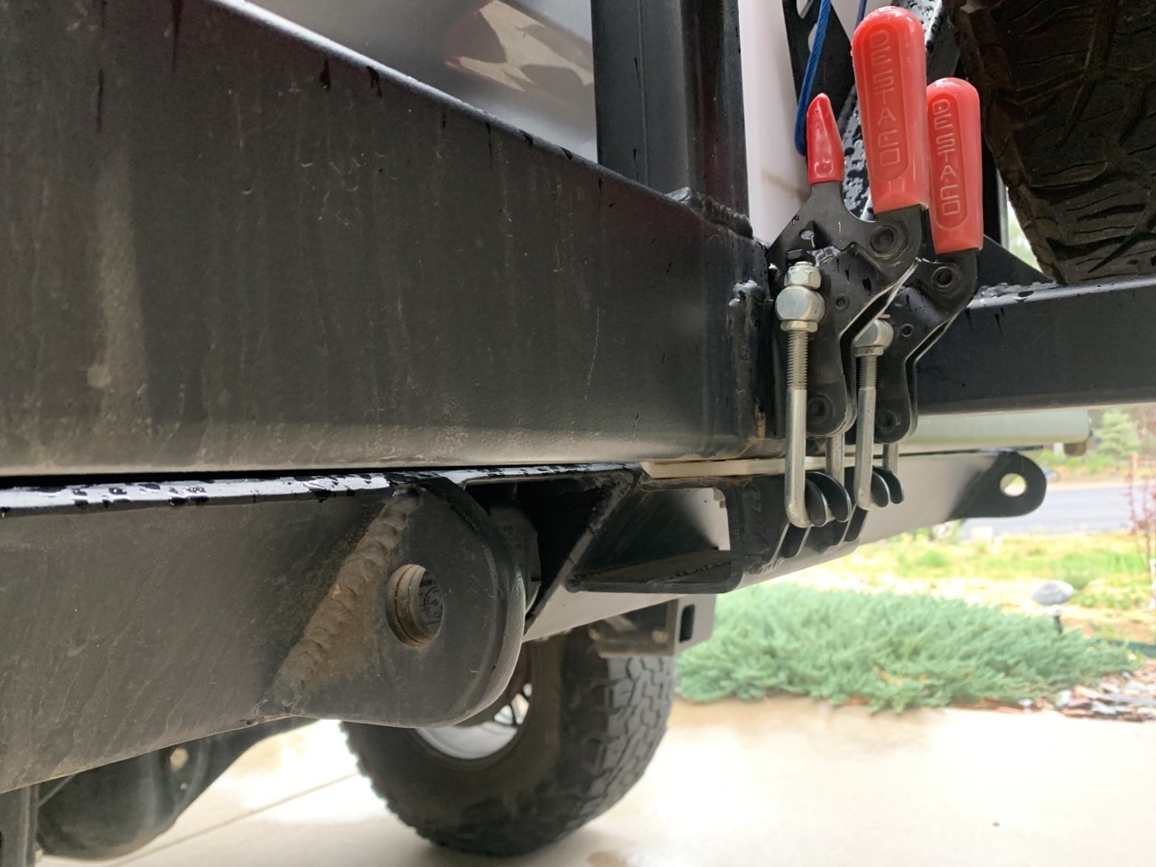

    Mine does use the piece they send that you cut at an angle. When the swingouts are open it sticks out about as far as the d-ring tabs. I basically never do anything in the back of the truck without the tailgate down so I dont care about how far it sticks out. I did have the same problem as @Yacob_D where the pin kept creeping up while offroad and eventually the tire swing latch would try to work itself loose and the swing would move about 1/4". Thankfully instead of opening it would just cause the latch to get tight, really tight. It was enough movement to make the latch so hard to undo I would have to loosen the bolts to get it undone. The extra little lever with a lock/catch thats attached to the handle doesn't do its job. Eventually I found a sweet spot where the tightness of the lever is enough that it doesnt loosen itself anymore but holy fuck is the latch tight. I have to go into wrestlers neutral every time I open or close the latch and I weigh 190 pounds. Ive noticeably stretched the u-bolt and should probably keep an extra in the truck. Just look at the length of the u-bolt on the jerry can swing vs the tire swing. Its been about a year with a lot of time in extended rough high speed offroad conditions and it hasnt loosened again though.
    Here you can see how much lip is left on the HDPE. That little bit really helps keep the swing in place. I wouldnt cut it all the way flat unless you absolutely have to. Maybe 2nd gens are different than 3rd here.

    Ok thats what I was picturing in my head as I was looking at the directions. Looks like we are going to have to figure out a better latch system. That is less than ideal. Thanks for the pics dude :thumbsup: I am going to head home tonight and play around and see what I come up with. I already cut some flat strap for that option. For a woppin 2 bucks its worth it. If I dont use them they will be good caps for my sliders I am building.
    Edit: Looking in between the handle and the smaller catch handle I wonder if I could make a spacer that slides in there that keeps pressure back on one and forward on the other to keep it locked.

    There is a little spring that pulls down on the secondary lever but its not strong enough to truly keep it in place.

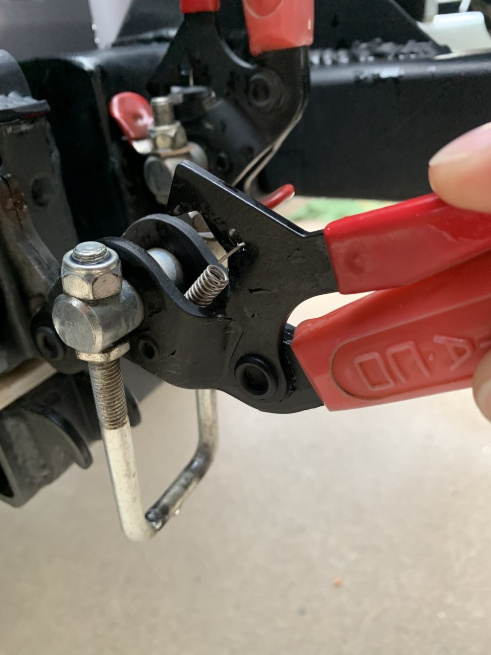

    These latches are soooo much better and beefier than the ones supplied. I need to switch mine out and ditch the velcro strap!
