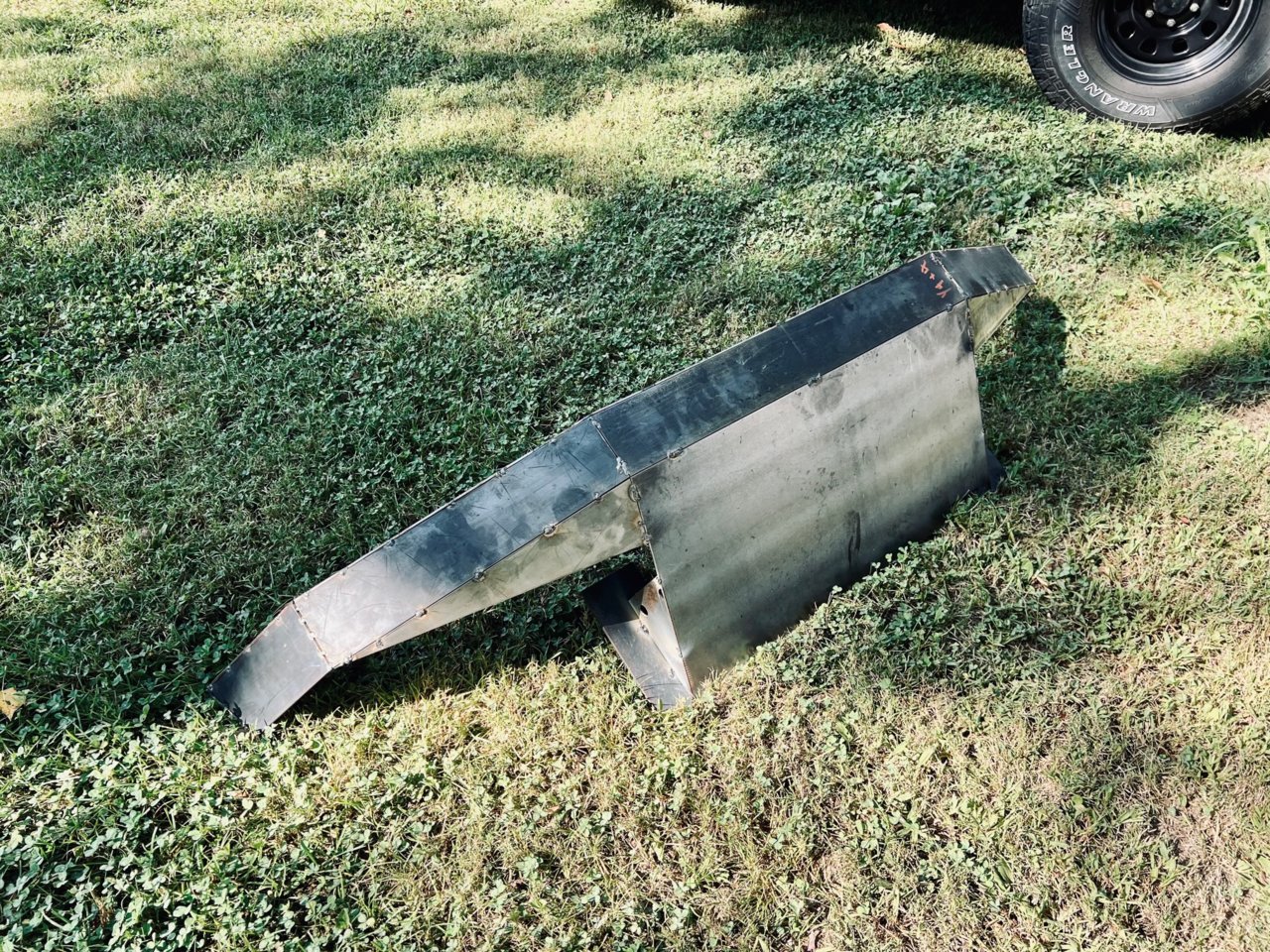

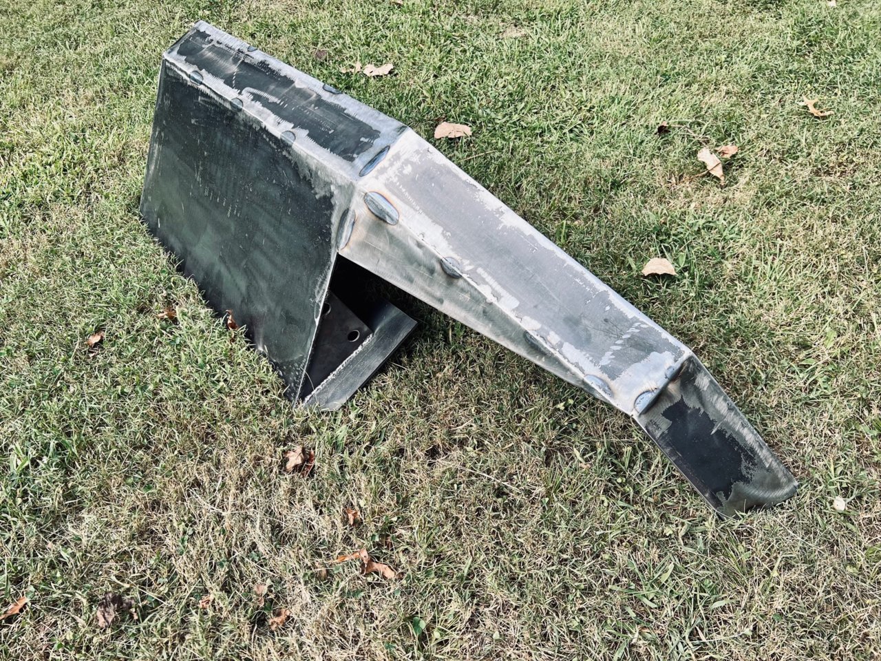

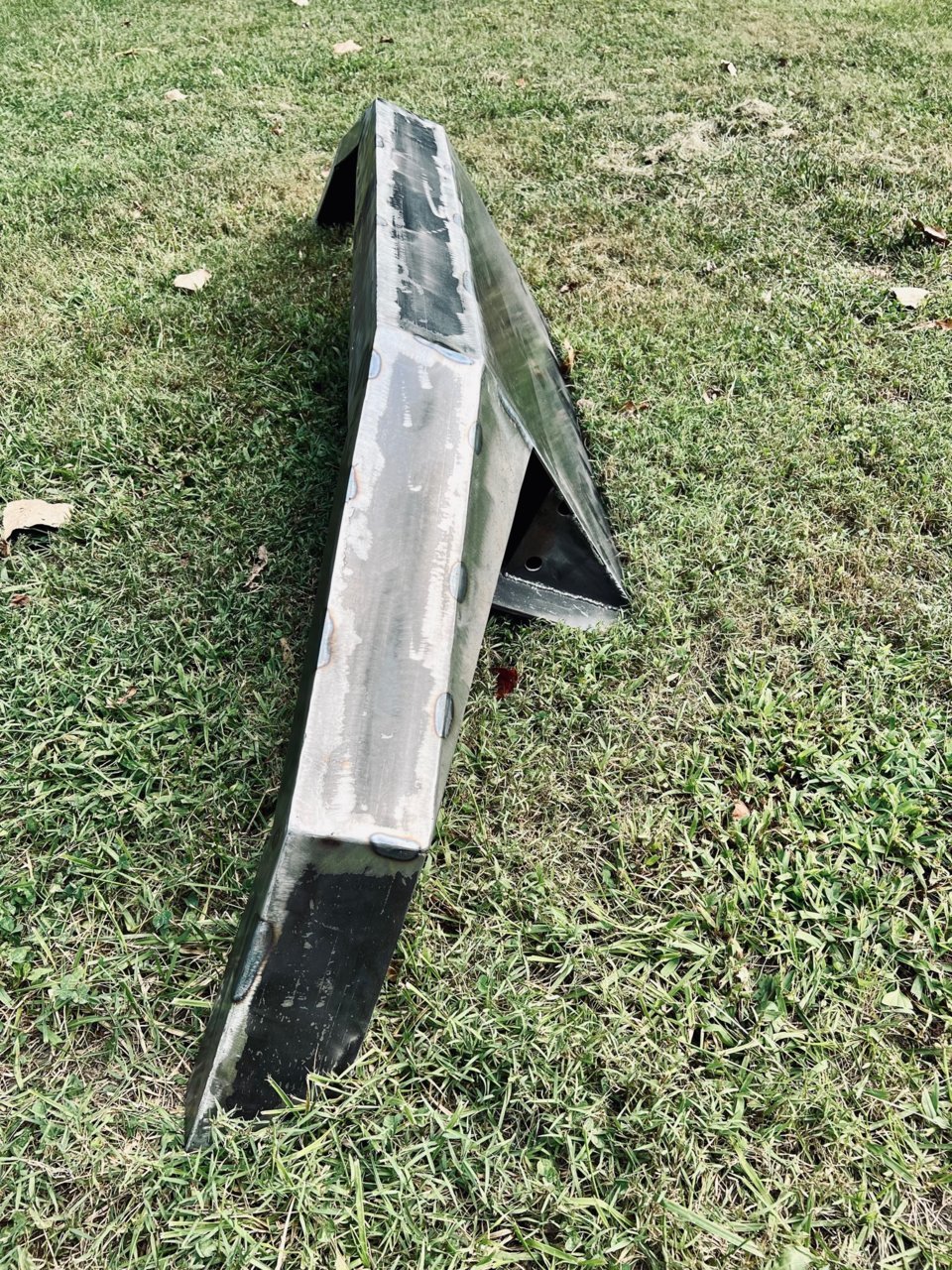

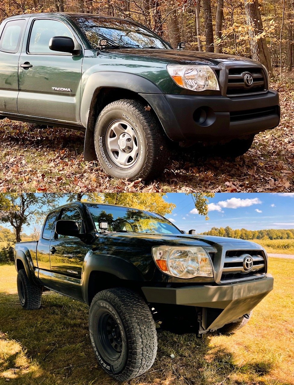

    Its been a minute but I been viewing this thread off and on while my truck was being repaired from an accident. I almost ordered CO's basic bumper after reading some reviews and seeing some customer photos but after a new set of tires and wheels another $825 wasnt an option, so I just bought the material locally and half assed a similar design...which still has some refining to do ‍ If I was to do this again I would save on the welding and grinding and bend the main front part. Mine is 1/4 inch and the rest is 3/16. For those who want to do this themselves, the easiest way to mock it up is by removing the grill and starting with your main front piece. Tack the top to the front and utilize the holes in the grill support to hold it in place. I didnt have as much material as I thought so mine doesnt wrap all the way around. Not sure how they recomed to do it but after roughing out the entire bumper I put some beads on the backside as well.
    At this point im undecided on running a winch but I might add some recessed lights or cut some vents in the skid plate portion...anyone have a recommendation yay or nay on the vent holes
    Also...for those thats gonna tackle one of these or make it from scratch like this, the right size welder is a plus. My little old Hobart did the job but the money I saved doing it myself will go towards upgrading to something a little bigger
    The new 285 75/16's didnt rub before but after losing the stock front bumper they have lots of room. There was some slight rubbing at first but only when turning while backing up and only the bottom portion of the fender flare on the cab side had to be trimmed. If anyone is in IN and needs a good set of 265's on rims with all the sensors still intact ill be selling my old ones soon.

    100% weld the inside. That's where all the strength is. You grind most of the weld from the exterior for looks. Looks pretty good! :thumbsup:
    09IndianaTaco[QUOTED] likes this.
