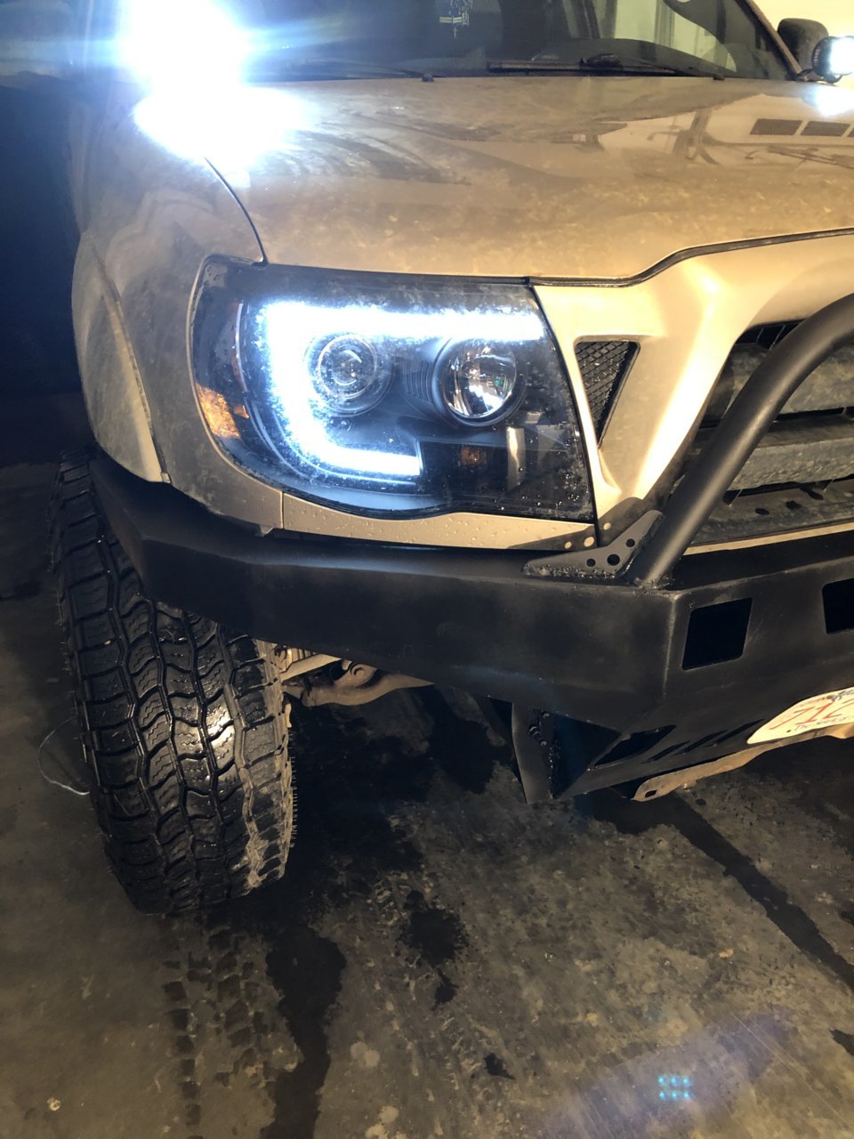

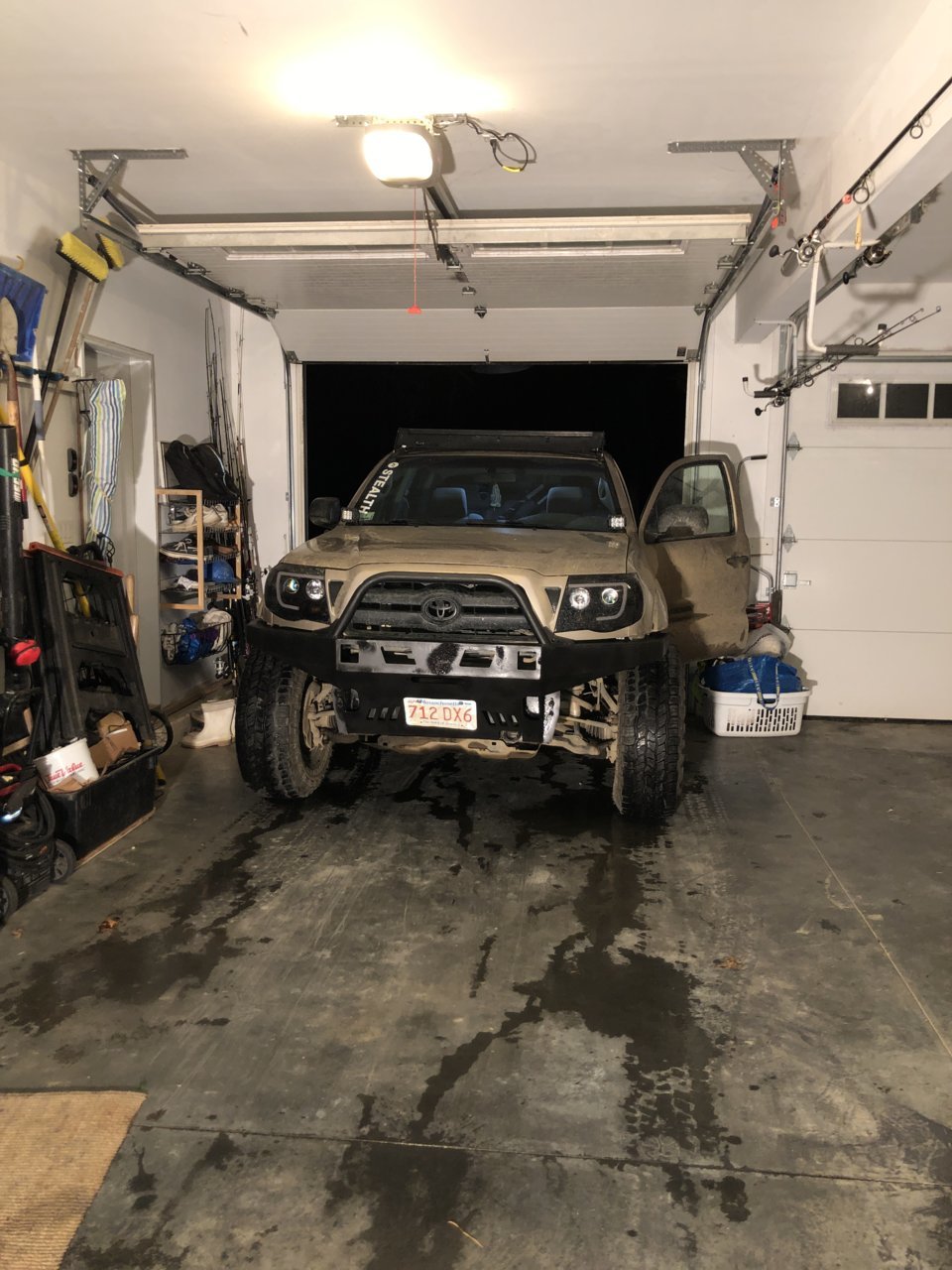

    Do not judge my painting skills, removing the bumper, grinding some more, and re-painting this weekend. Weather is not behaving itself and I didn't want to drive around w bare metal, or no bumper for a week.

    NO JUDGEMENT HERE!! Thank you very much for the pictures. This is exactly what I needed to see.

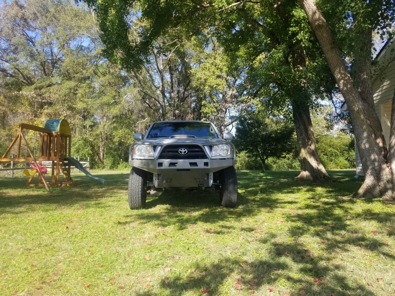

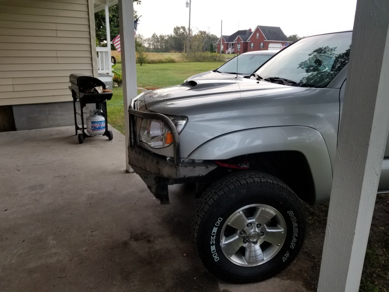

    The biggest question I have about this bumper and problem really, is how to treat the inner cavity from rust? Once its together you can't get in there, and if you paint it before the face plate goes on you will burn the pain up by welding around it

    You also realize at about hour 12 of welding and grinding why bumpers like this are 1500$
