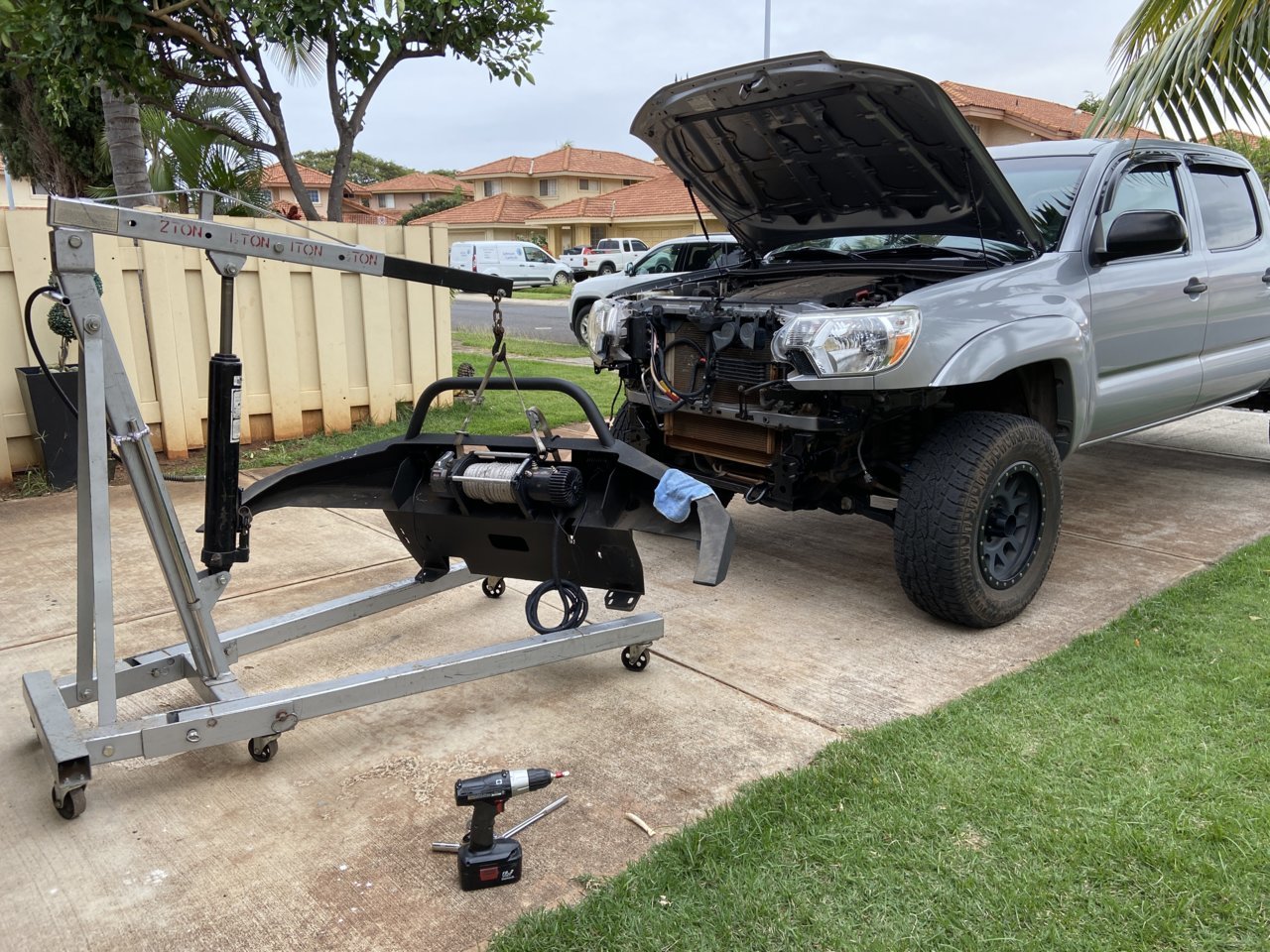

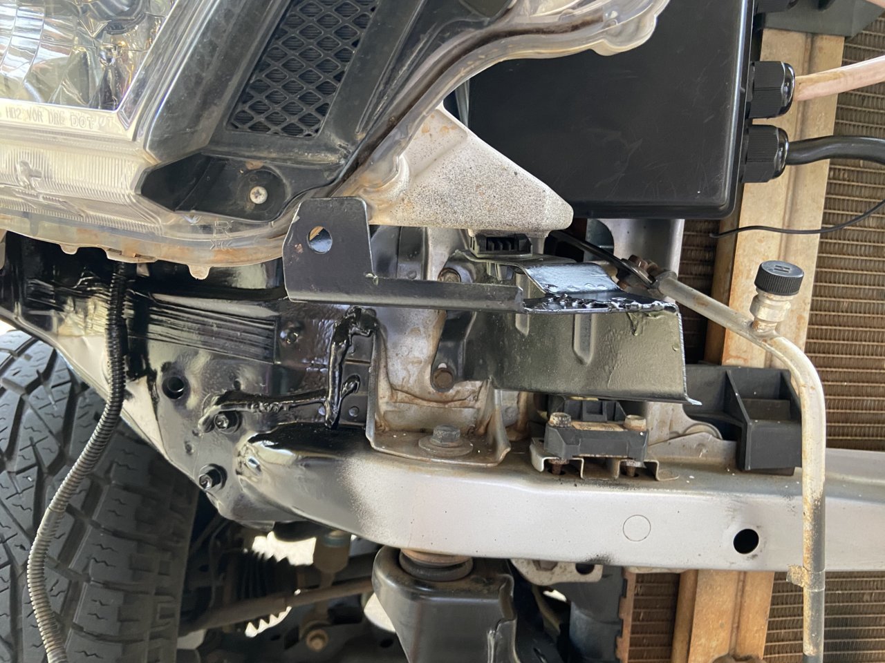

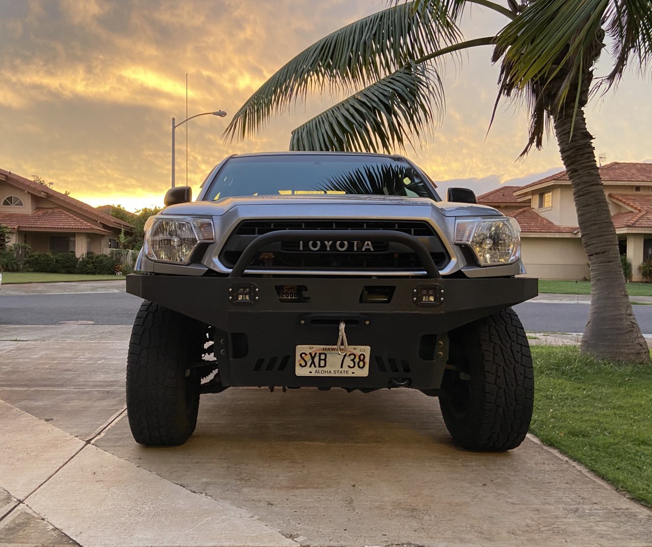

    With the stay at home orders I have had time to attack some projects. Pulled the bumper, chopped up some of the old brackets and made new ones to hold the trim pieces under the headlights. Also painted the sheet metal black around the edges/corners of the bumper. Mounted my winch control box behind my passenger headlight ( i know its a weird spot) I was worried about blocking the radiator and the control box didn't fit on top of the winch (too tight).

    I had to relocate the trans cooler up about 1/2 inch, chop the clutch engage handle about 1/4 inch and remote mount the relay/control box in order to get my winch in, I'm not sure about the Apex dimensions but I would expect some "fitment" to be done.

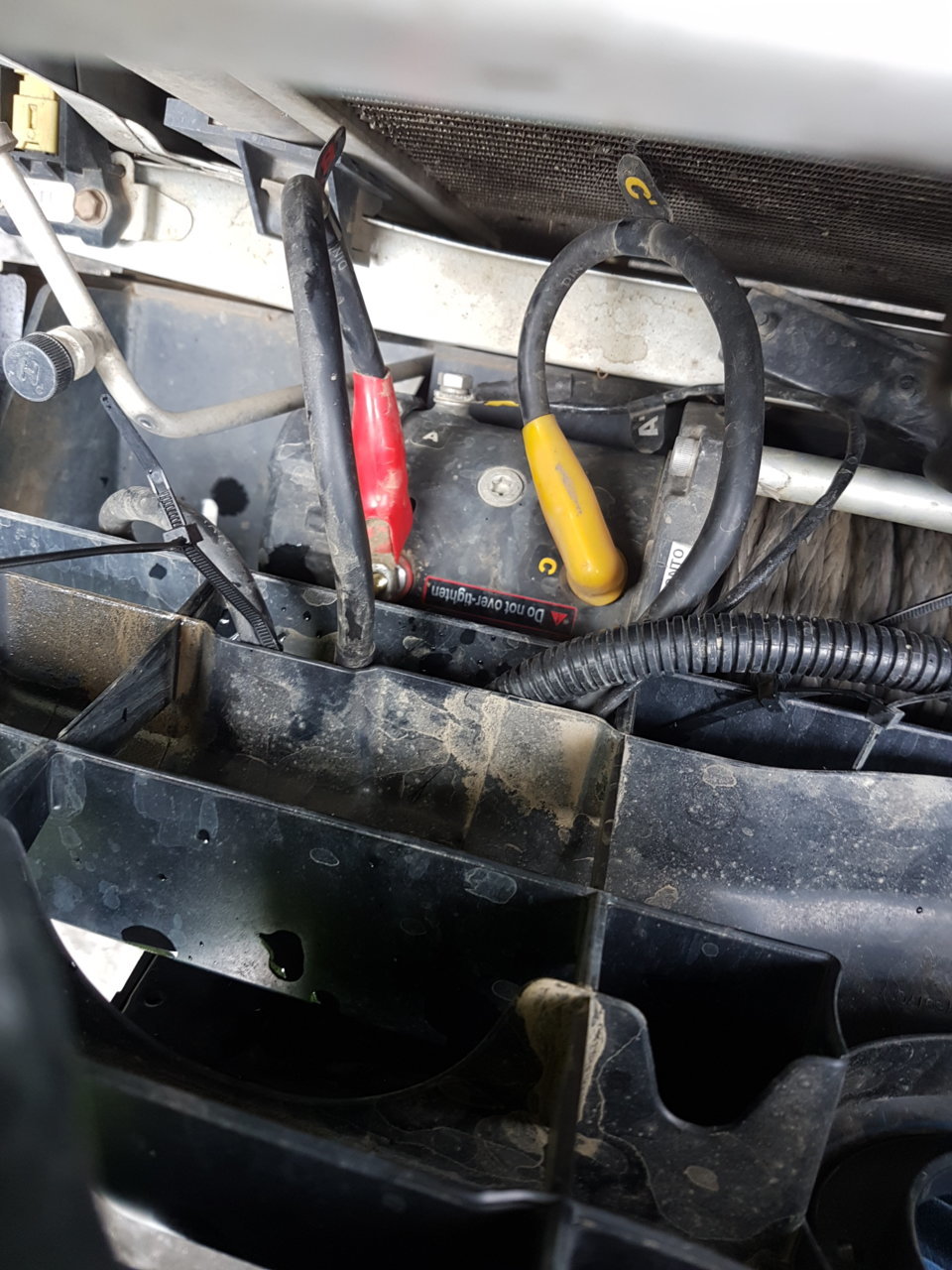

    So I pulled the trigger on the badland apex 12000 lb winch. I managed to shoehorn it into the bumper. I just can figure out where to put the controll box! It's so big and bulky it doesn't fit anywhere. Going to try to see what else I can do. If anyone has suggestions please let me know.

    Can you extended the wiring cables coming out of the winch to the controller box? Then mount it in the engine bay.

    Oh that's not the problem. I've got miles of cable. I just find a place to fit it in the engine bay. Its bulky as hell. And an awkward shape.
