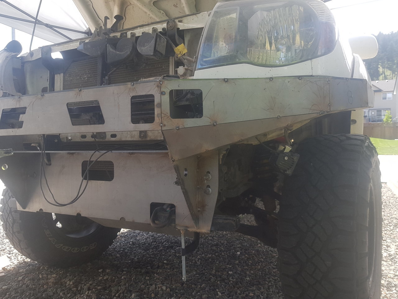

    I had already moved the trans cooler and horns in order to fit some lights behind the grill (never installed). I’ve since replaced the stock cooler with a larger aftermarket one with a fan—there’s plenty of room there.
    There’s also a metal line on the left for the AC that I needed to unbolt the bracket and move slightly to clear the winch. No big deal.

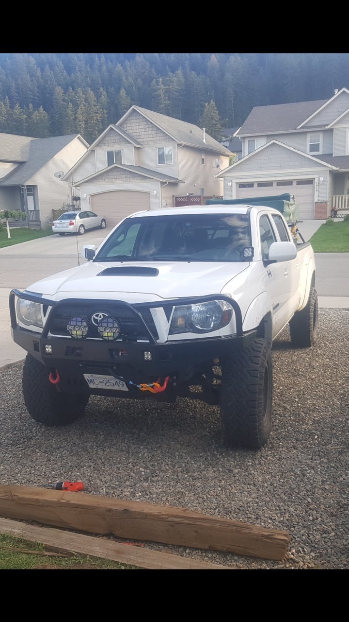

    Well boss heres a shot of the finished product. I managed to get my grill to stay flush by trimming a slot out of the bottom for the clutch handle. Had to cut that cross member out as well but oh well.

    Looks amazing! I’ll have to take another look at mine, I’m jealous now. Haha

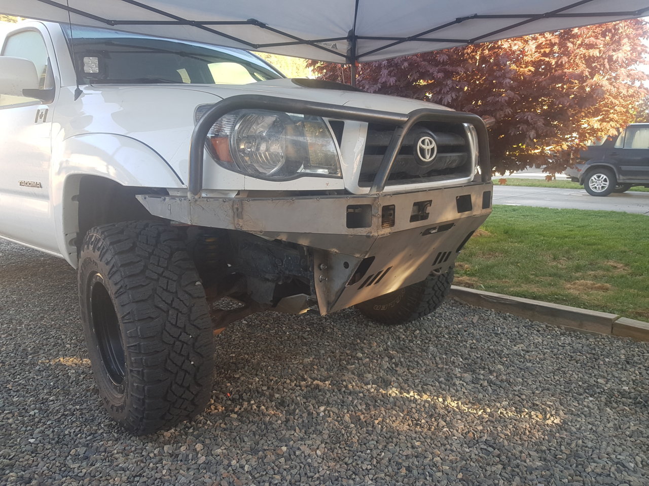

    The construction of it is phenomenal. Had a guy at work try ripping on the hoops as hard as he could and nothing happened(I wasn't a fan but was impressed with the bumper) this is a shot of the stupid heavy deer smasher bumper. Stuck out like 8"

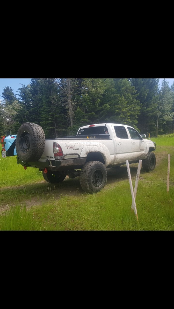

    Well gentleman. Heres the finished product. Coastal offroad all around

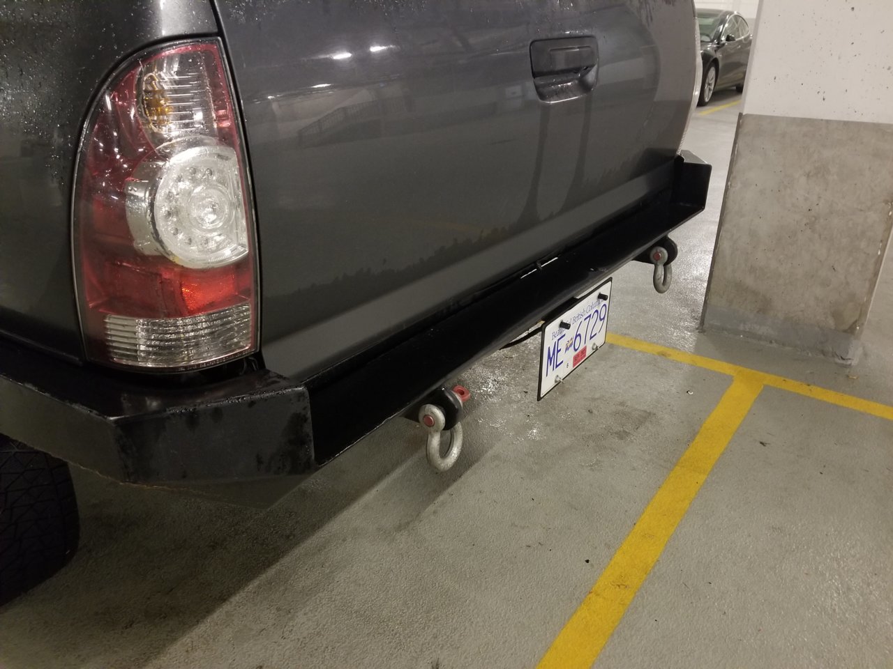

    Can anyone direct me to some closeup photos/ideas on license plate mounts for the high clearance rear bumper?

    You can get a license plate hitch mount
    I built mine. I'll post up some pics after work
