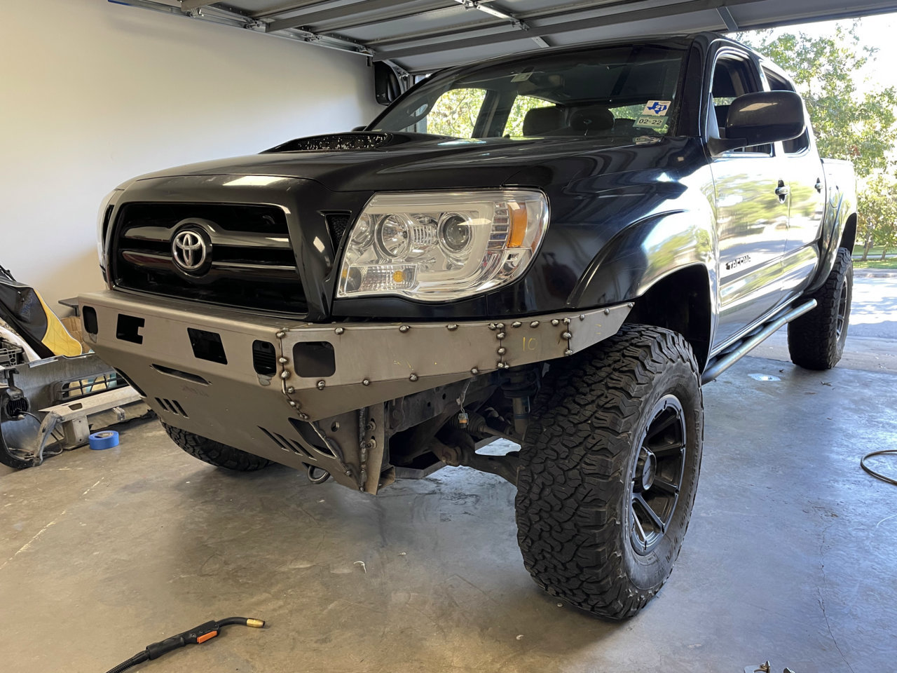

    Never posted here but I installed my Coastal bumper back in Dec. after a long slow build while I learned to weld and 2 tries at the powder coater.

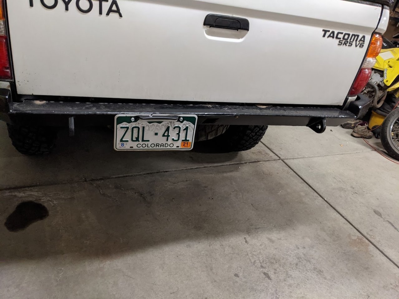

    Made from a piece of thin plate I had lying around. Drilled a hole in the bumper for the wiring. It does hang down lower than the bumper as the license plate is taller than the bumper, even if you were to put it at an angle. The lack of good mounting options is probably one of the worst parts of this kit. I'm considering adding a swingarm, and if I go that route I'll move it there.

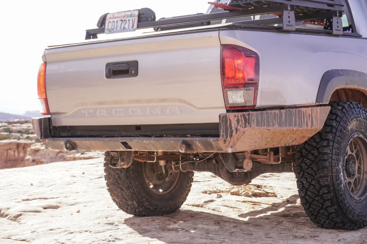

    Couple weeks ago I ordered a 3rd gen rear up, and they made sure I got their updated bumper which comes with a pre-bent center instead of having to weld together the center portion. Top quality customer service :cool:
    Kit went together perfect, and I made a fancy flip up license plate bracket with lights, took it to Moab a couple days after I got the bumper done and destroyed my license plate/license plate bracket lol. Think I'm going to fab up a tire carrier and mount the plate on it.

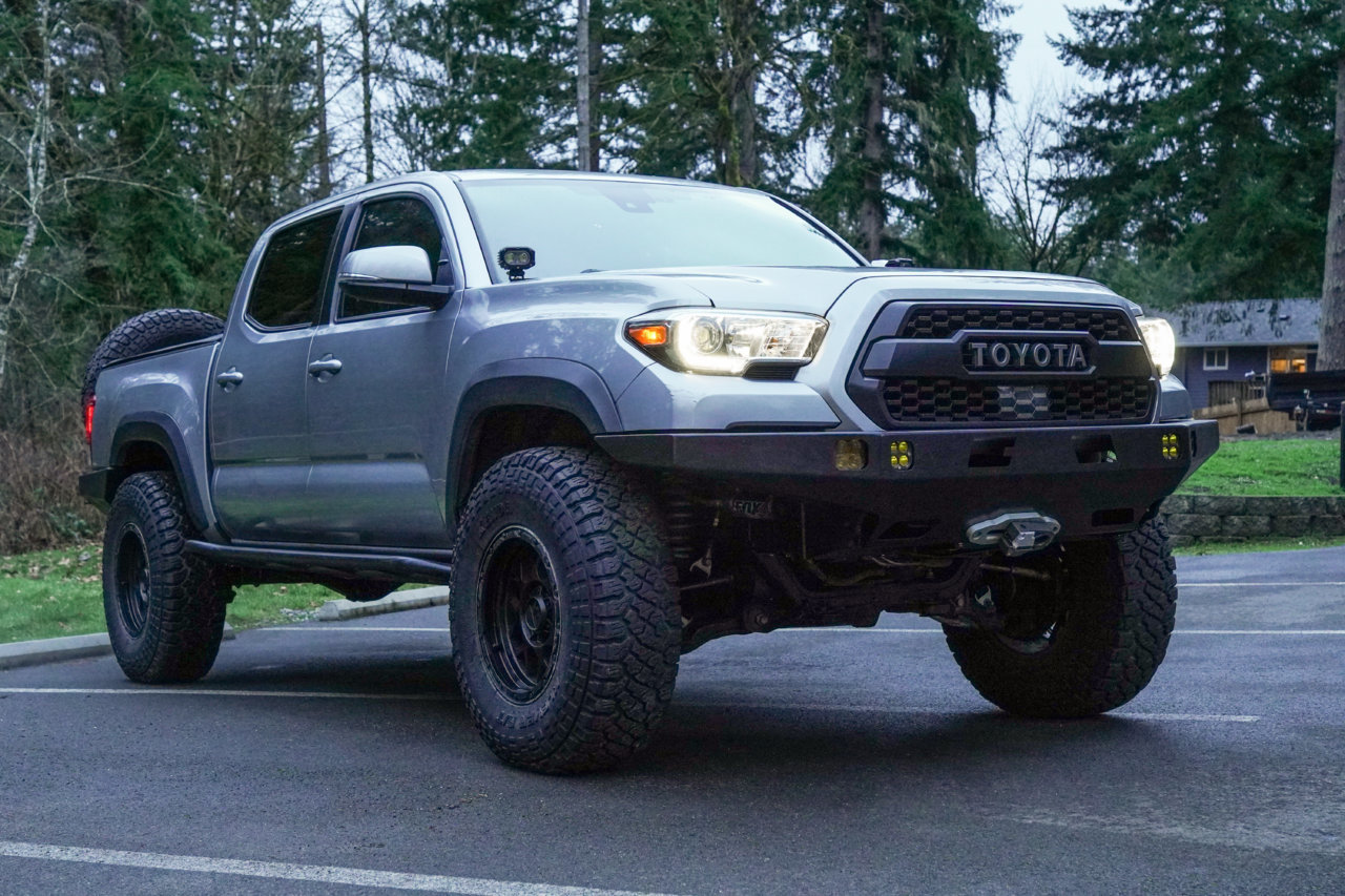

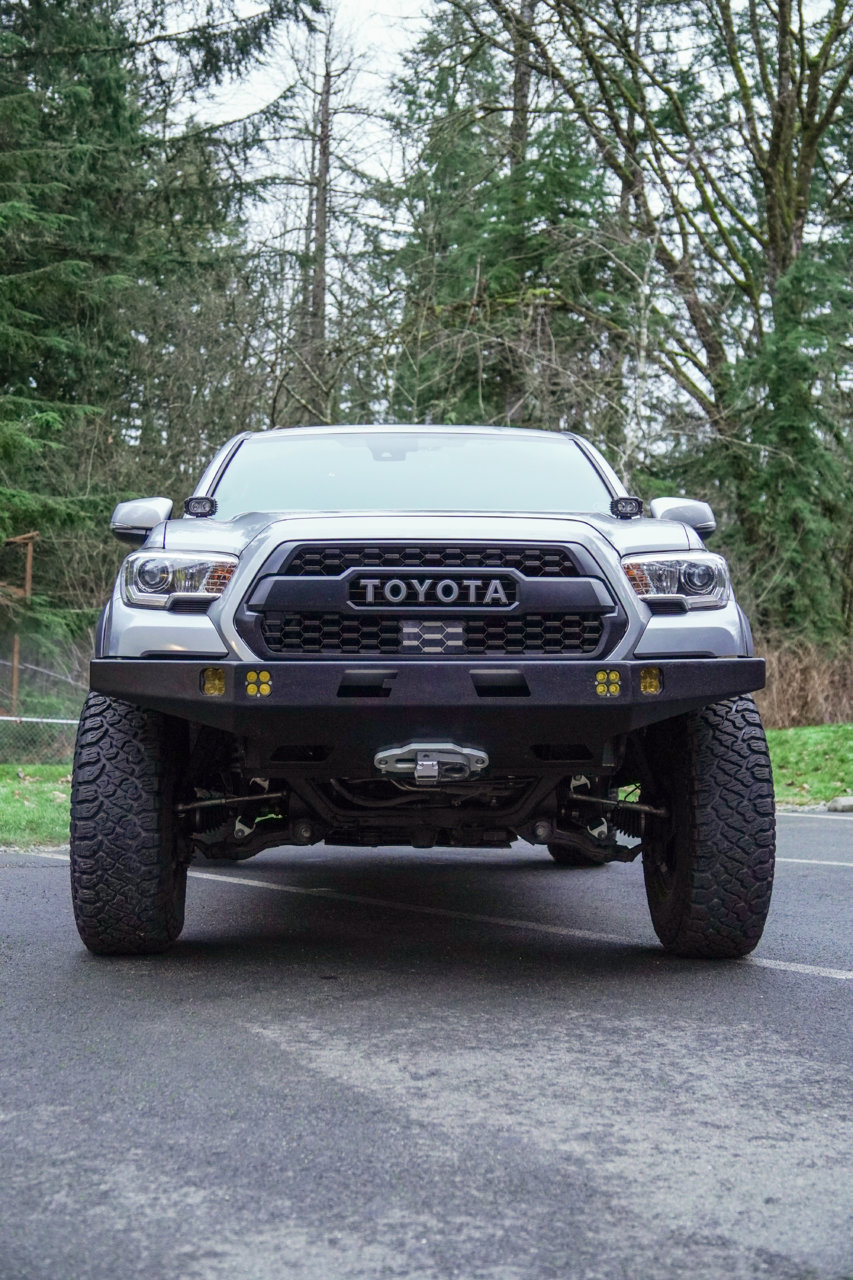

    Their new 3rd gen Extreme Clearance front! Gain's 4.5'' of clearance by replacing the thin, low hanging crossmember and welds a new 1/4'' thick one in between the frame rails.

    Wow, that extreme high clearance looks so much cleaner!

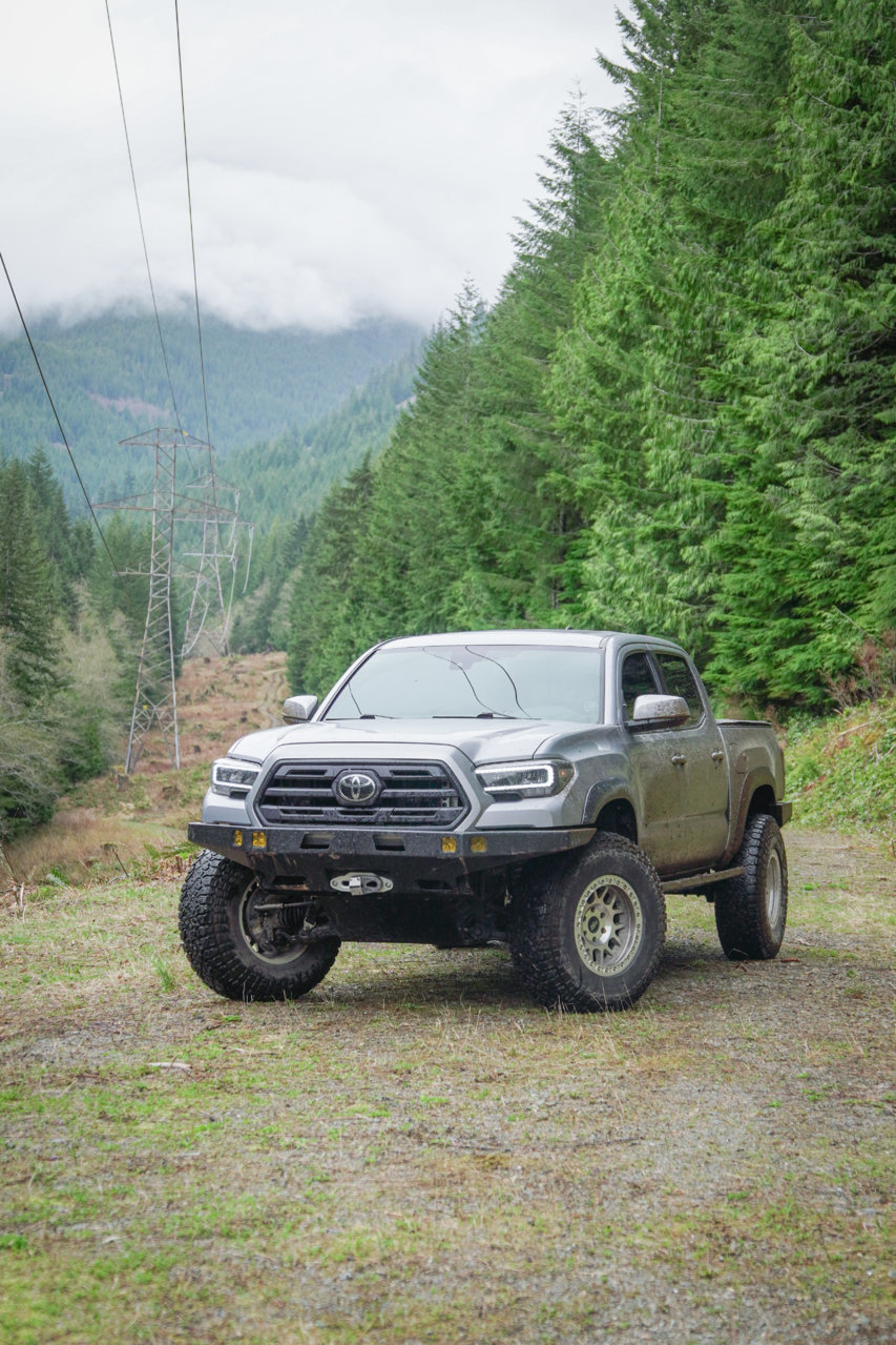

    Agreed! Also recessed the fairlead in a bit, plated the whole front frame rails, and added a couple more mounting bolts on top the original 9 bolts the bumper had. After that stuff the bumper is finally the weak point instead of the weak frame, as I have tweaked the bumper some and dented it a bit, but its expected when you use the bumper as a shovel on a 6k lb rig.
