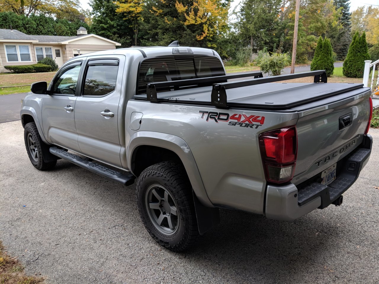

    Voodoo bars are in.
    Just need my ski rack.

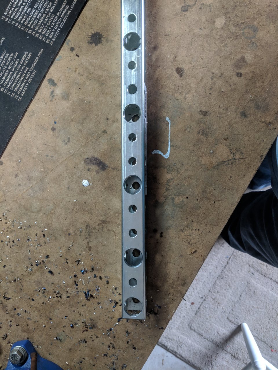

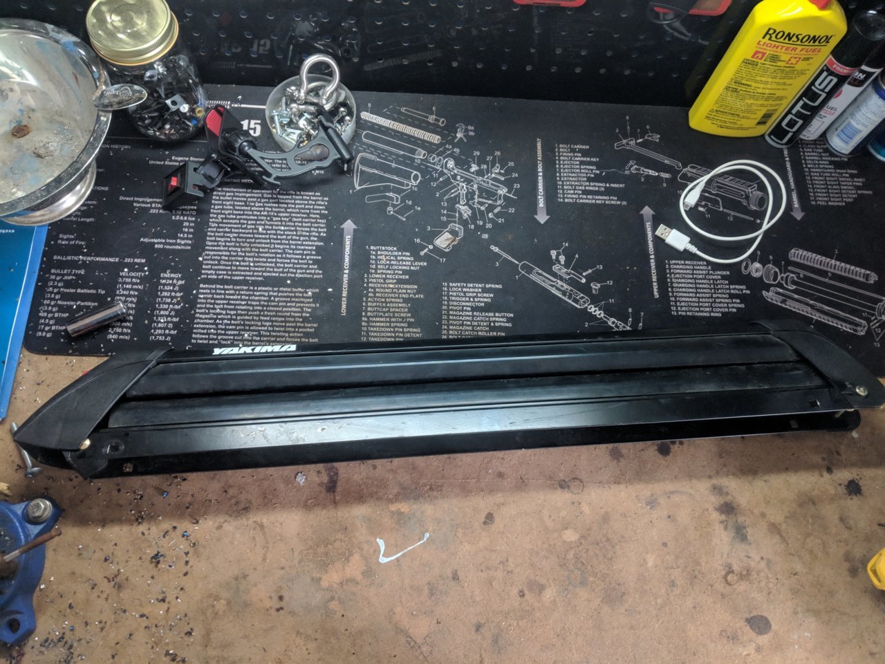

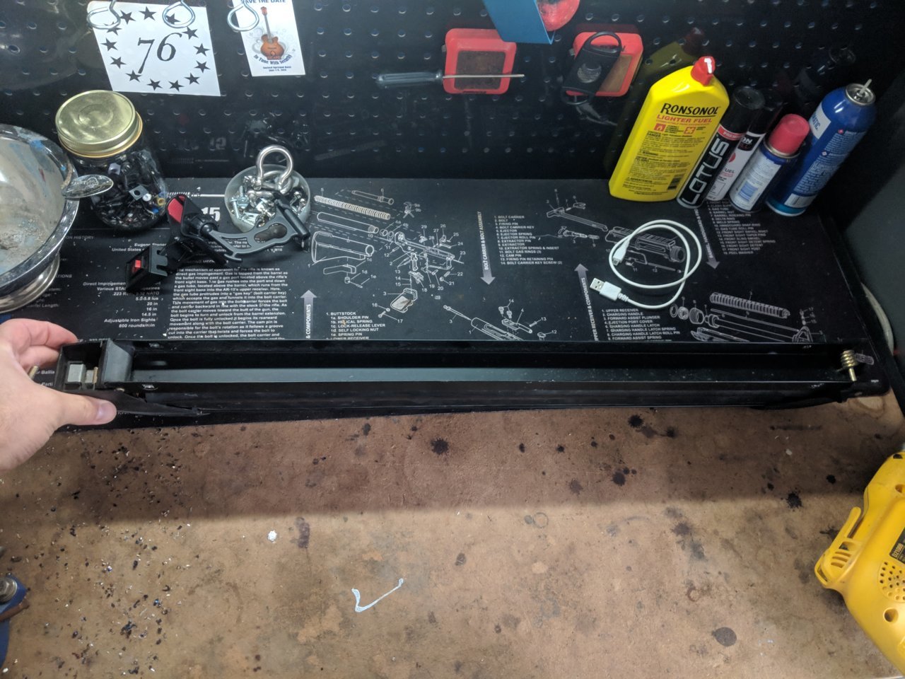

    Got a set of Yakima 6 ski button down ski racks for really cheap, but have to fab something to mount it to the cross bars with.
    As you can see from this picture, no place to put screws:
    So I grabbed some stuff to fasten these to the bars:
    Just waiting on my trusty cousin to get home so I can cut.. .

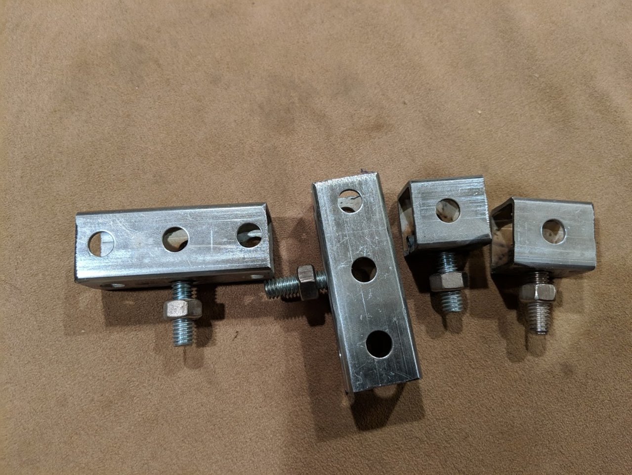

    All the pieces are cut to size. Cousin going to weld the bolts on for me. Going to make this so I can fasten to bed bars using wing nuts.
    He's gonna powder coat them flat black as well.... I love my cool ass multi-disciplined shop ninja cousin.....

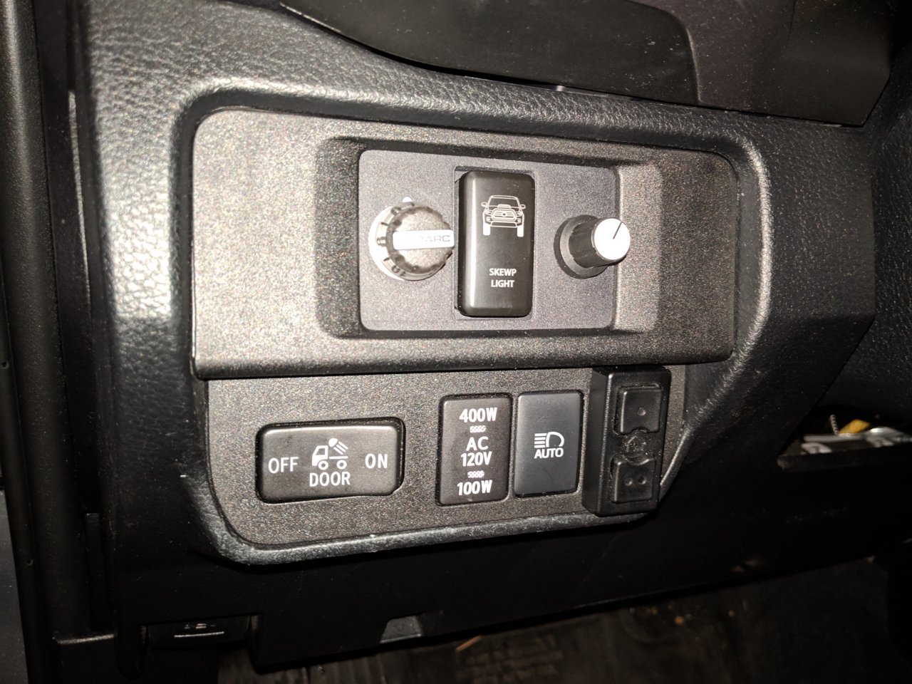

    A couple of items of note on this:
    It no longer works. I'm not sure if it's a battery issue (it shouldn't be) or a wiring issue, or a switch issue, but it's getting swapped out to something different, because even when it worked it was inconstant. It was a fun little project though.

    This is another slow going project. Snow is coming, and that means its time to get my ass in gear on it. My cousin forgot about welding the bolts last week, but got around to it yesterday. I'm going to mock it all up soon (tonight maybe?) I promise, it will all make sense when it's all together. My plan is to fasten these to the ski racks using the hardware that came with the racks, then use wing nuts to fasten them to the Voodoo bars. Here's to hoping. When Phil (my cousin) get's powder coating again, he'll do these up for me as well.

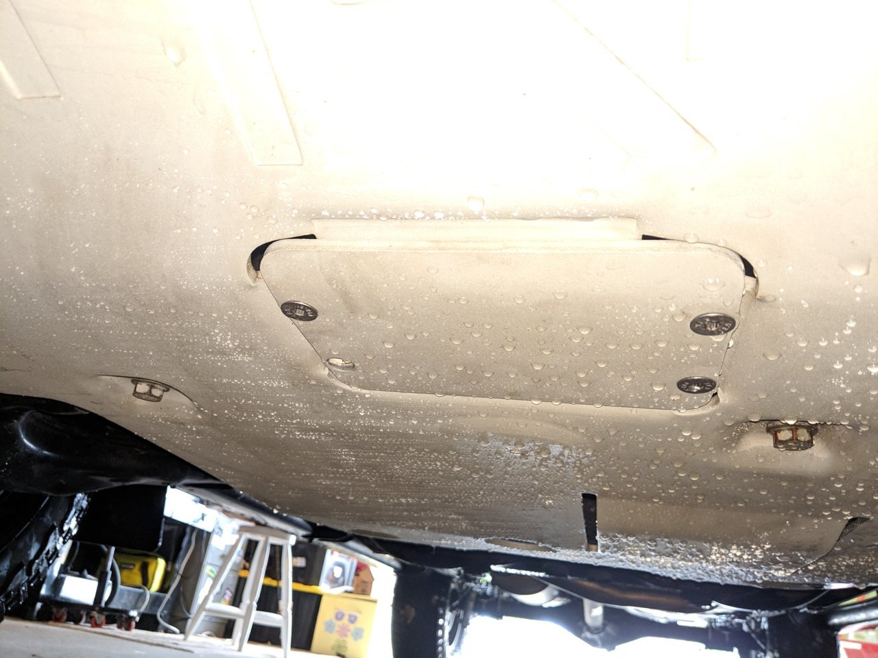

    Went to Toyota of Nashua yesterday for a 20k mile service. How the hell do you fuck up putting the access plate back on and lose a screw?!
    What a fucking mess. Truck goes back this afternoon to be made right because that's just bullshit.

    Well they cleaned it up, reinstalled correctly but had to order a new screw.

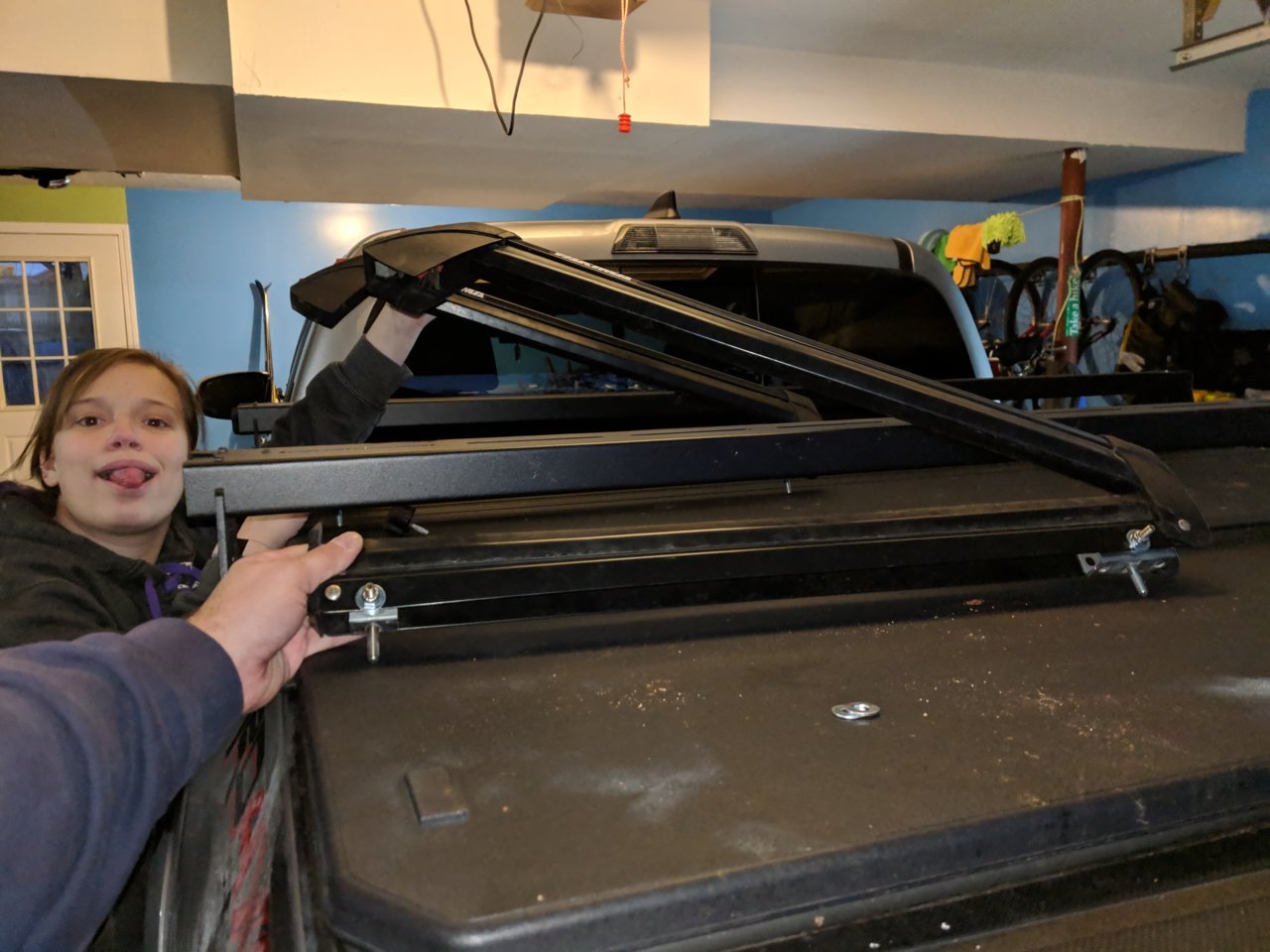

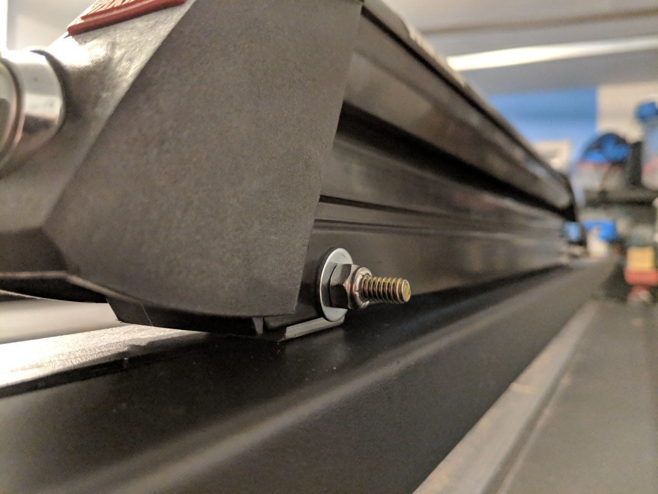

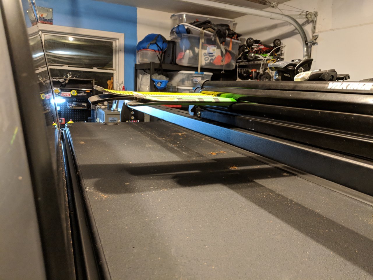

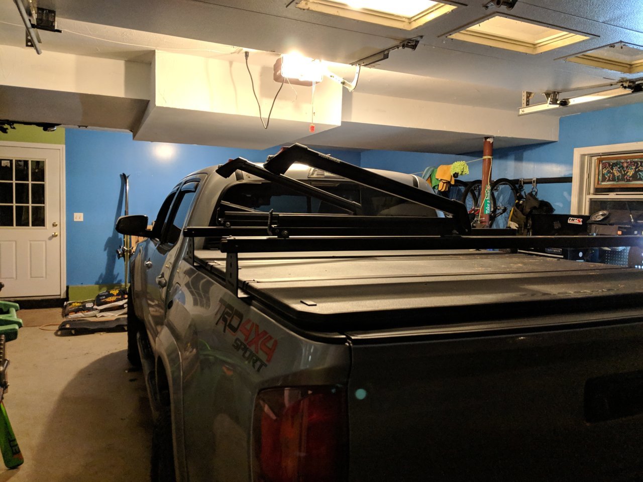

    All right, I finished it!
    So the pieces that my cuz welded went into the bottom of the racks and we're bolted using the stock hardware
    They are attached to the Voodoo racks using wing nuts.

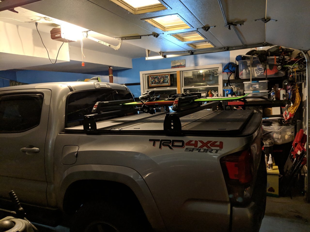

    With the skis on the rack. Decent gap from the back window
    $39 for the racks on eBay, $19 on hardware to get them mounted, $0 for welding and $0 for future powder coating.
