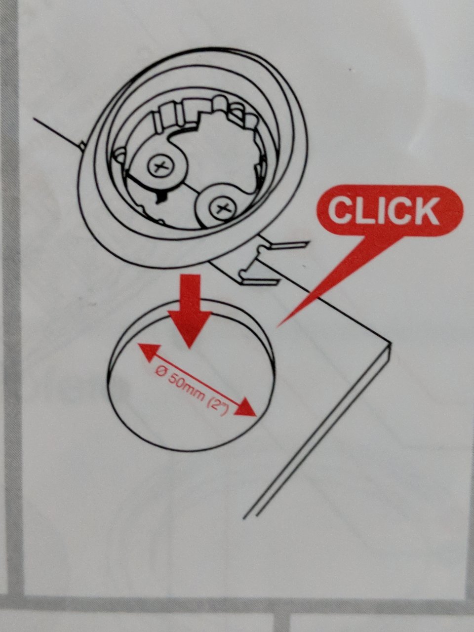

    Too much.
    50mm or 2"

    Thanks, I ordered the Maximo 602 for the rear, going to order the 692s. How did you go about getting crutchfield to comp the adapter ring?

    When I ordered the mounting plates, I got the closest to 50 mm
    I did the live chat with them. They put it all in my cart for me.
