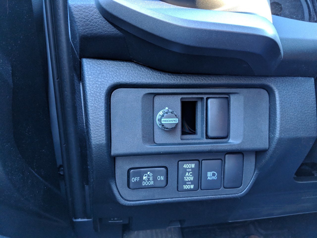

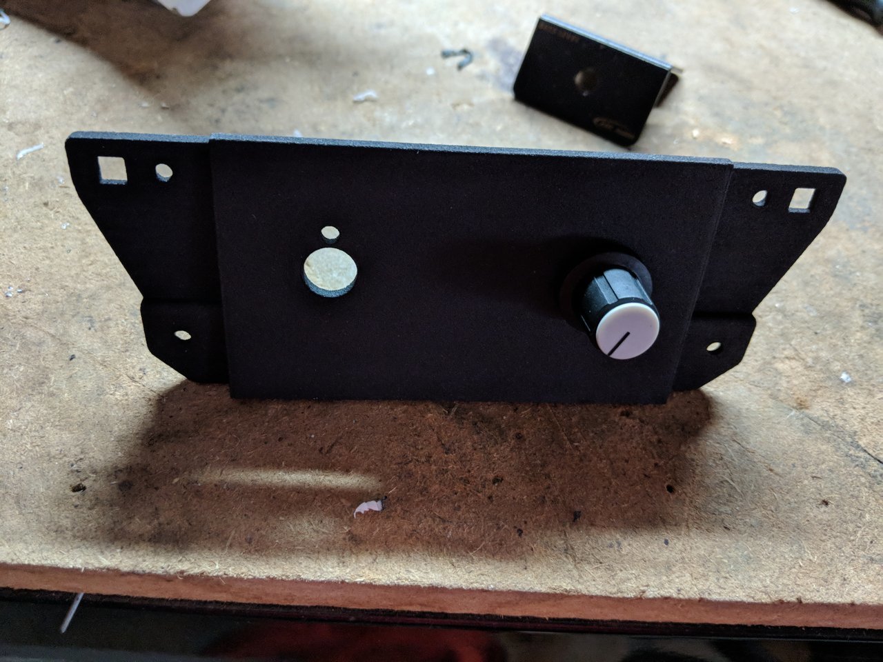

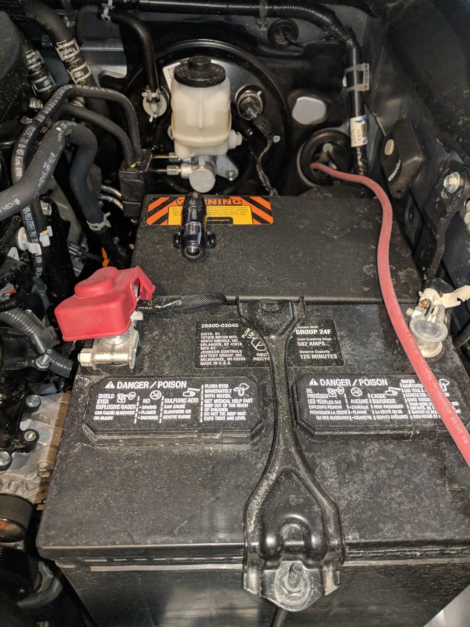

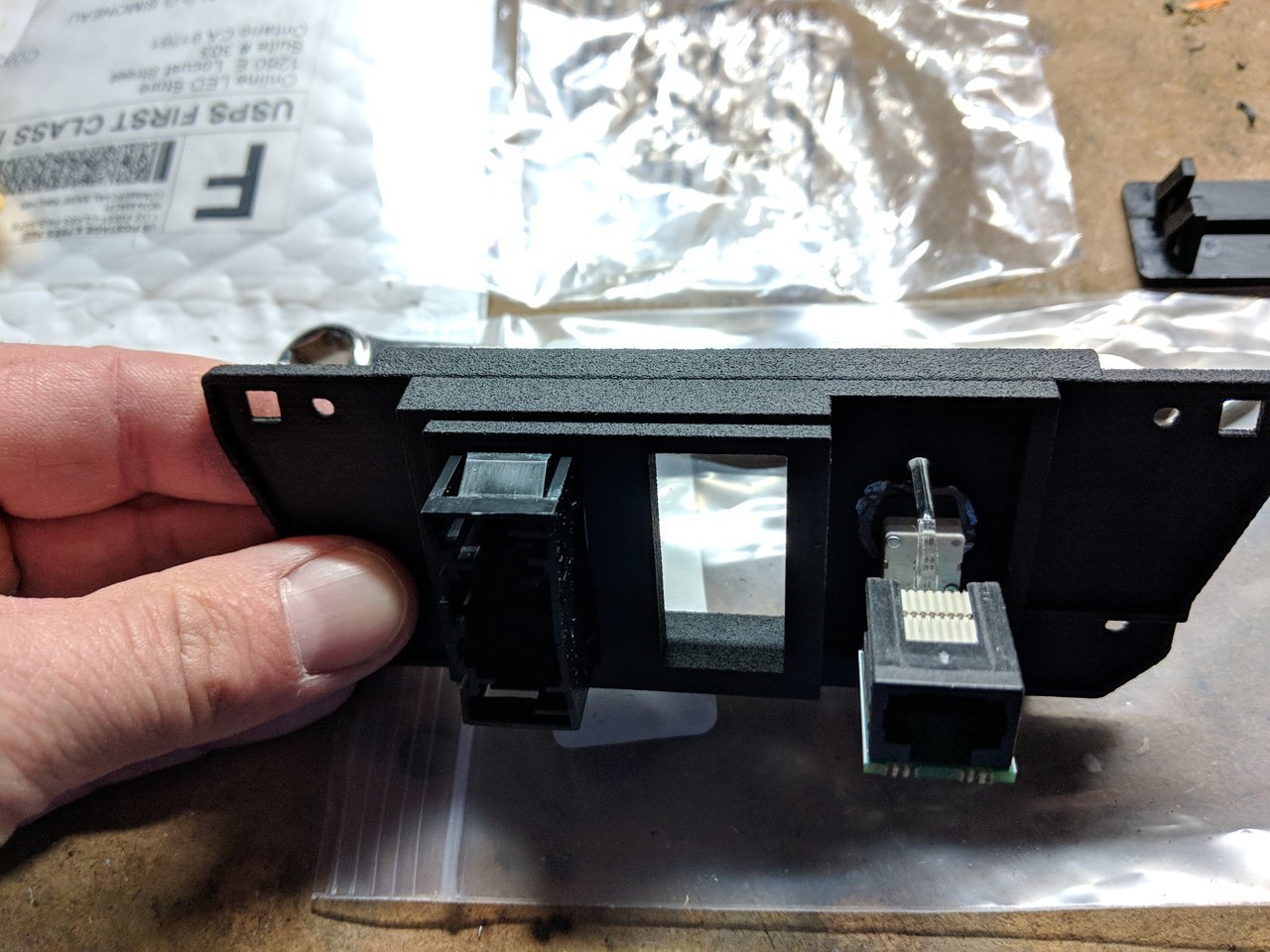

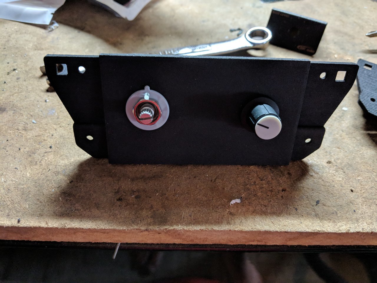

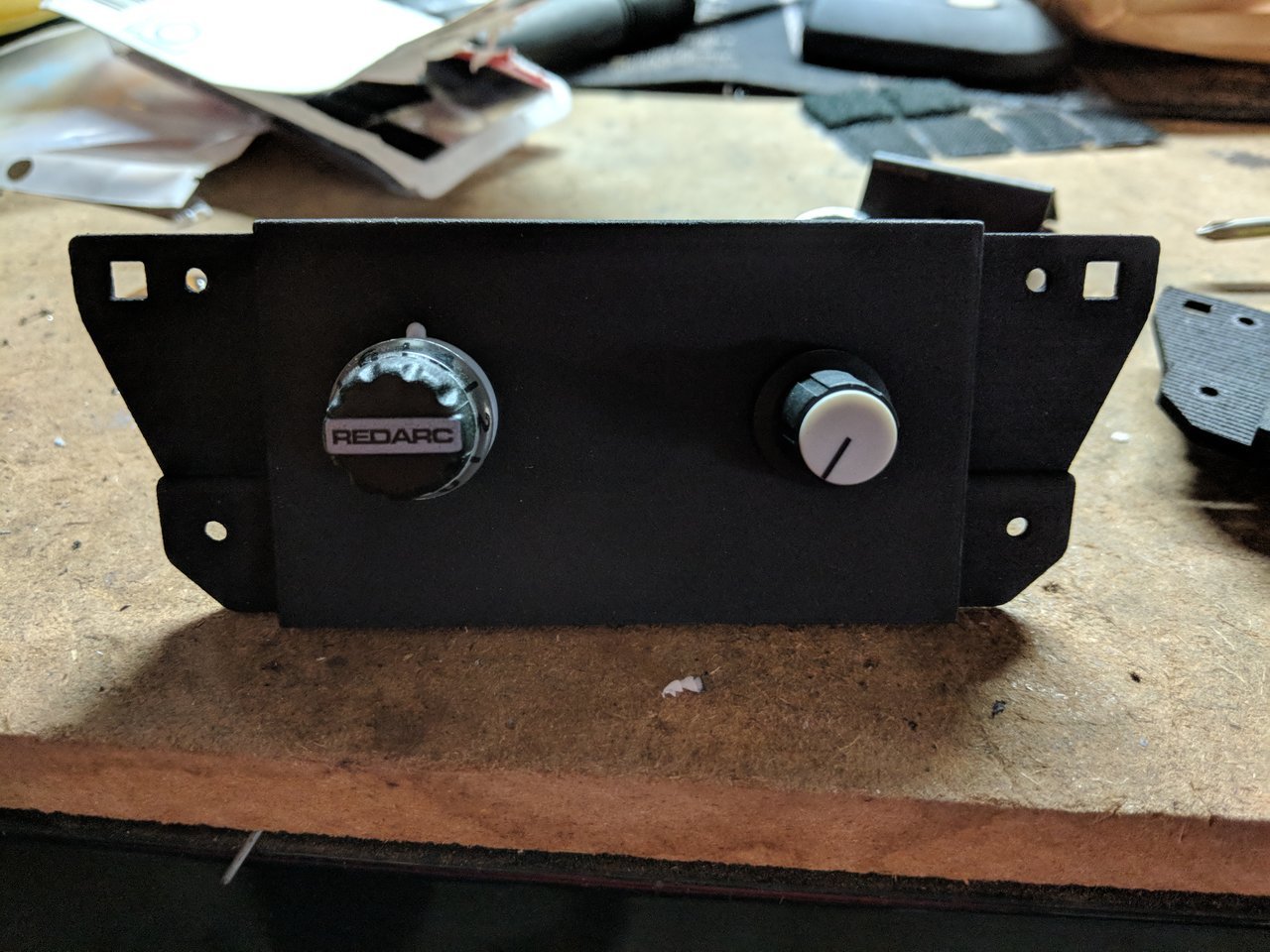

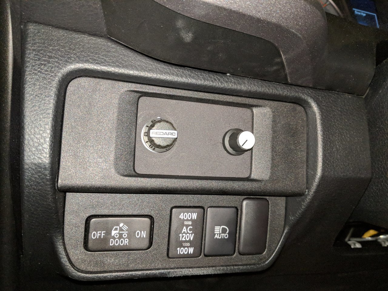

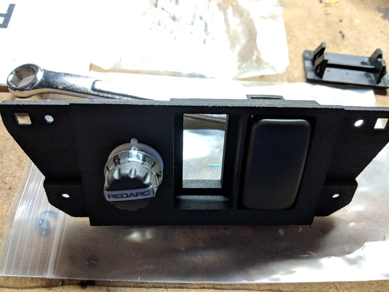

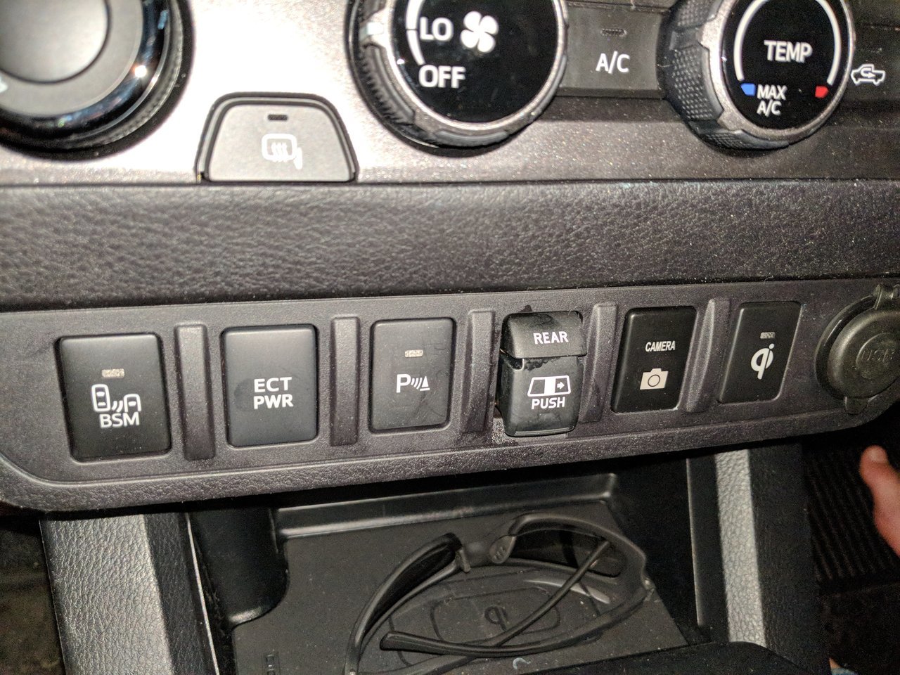

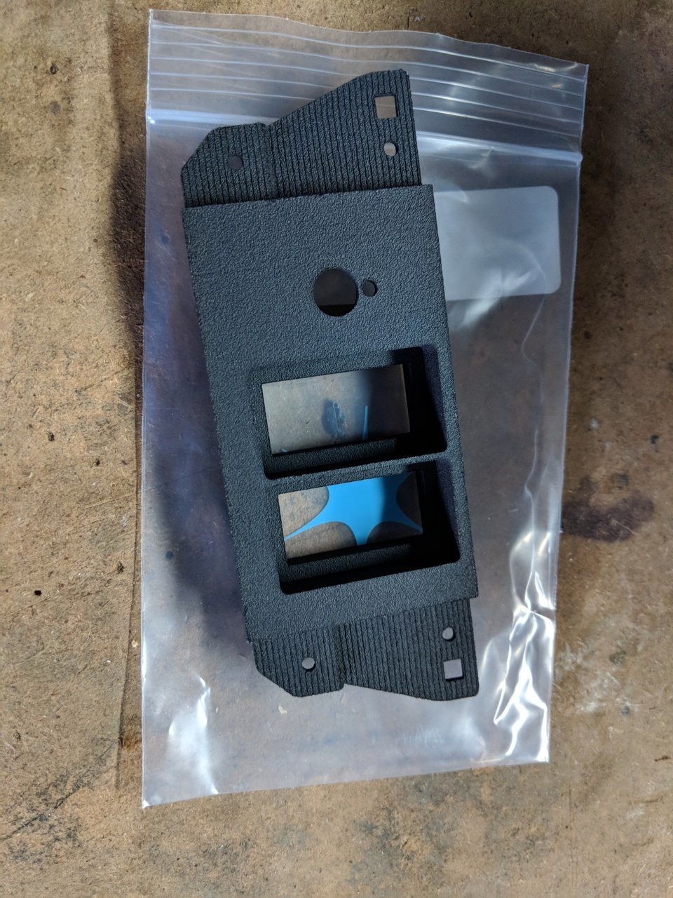

    Finished up putting in the tow brake. Nice out of the way install. Great design by a member here @forty2 (I think?). Need another cover for now, but I do have plans for those spots....
    MVIMG_20180212_170121.jpg IMG_20180212_173335.jpg MVIMG_20180212_173346.jpg MVIMG_20180212_173936.jpg redarc.jpg
    I needed to put a washer in to tighten the unit in firmly. Other than that, pretty clean finish. The other spots will have my sub nob and reverse on demand/front camera (maybe).
    I have to slow down....

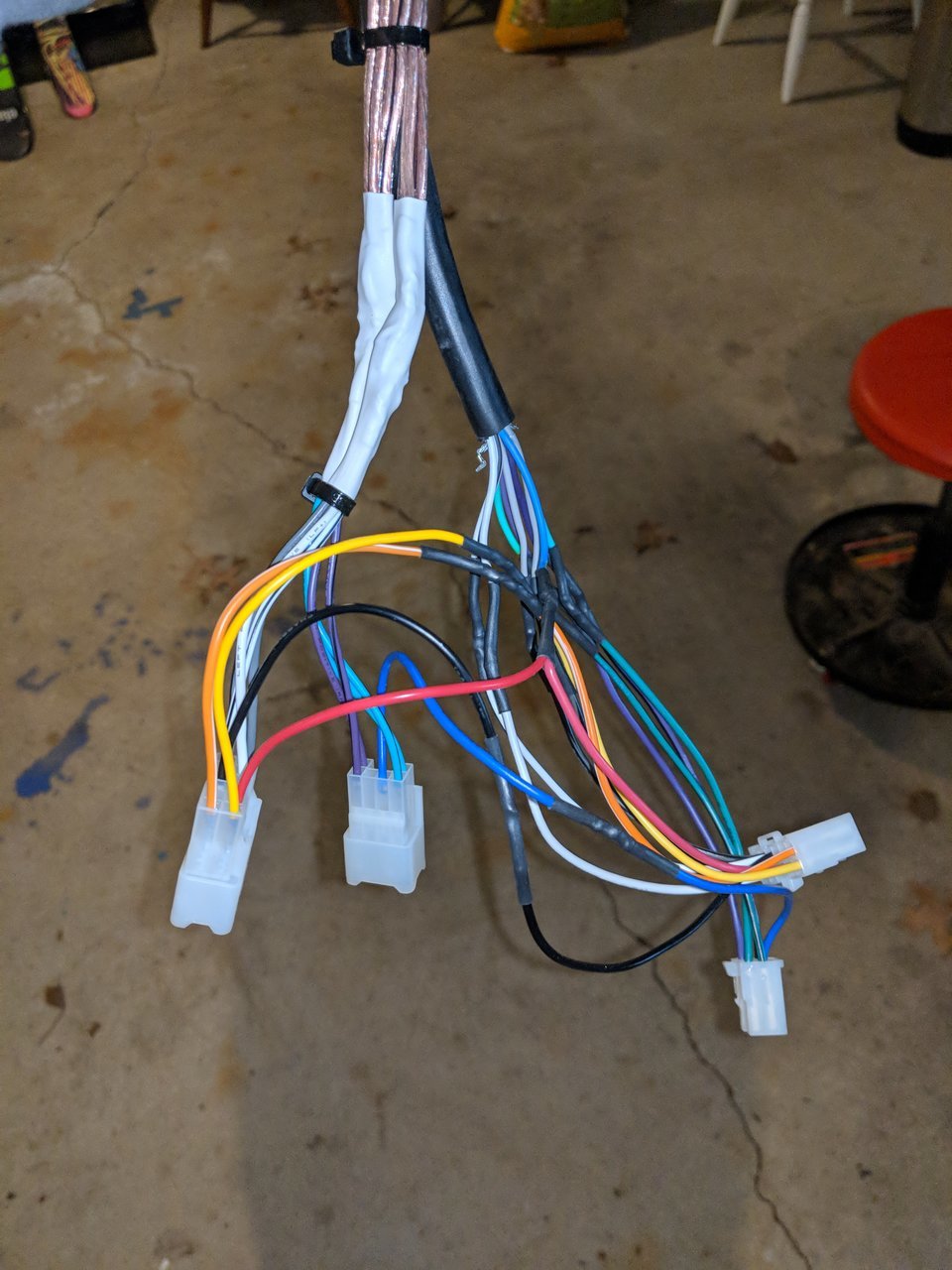

    Audio 7
    Today I had some things arrive, and did a couple of little things.
    Goodies:
    I put a hole in the amp rack for the wires
    I have other things to do with the sub box/rack before they go in. It needs wood filler and painting, and I'll do some of that this week. @Mr Marv does beautiful work.

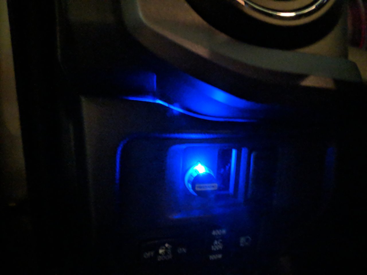

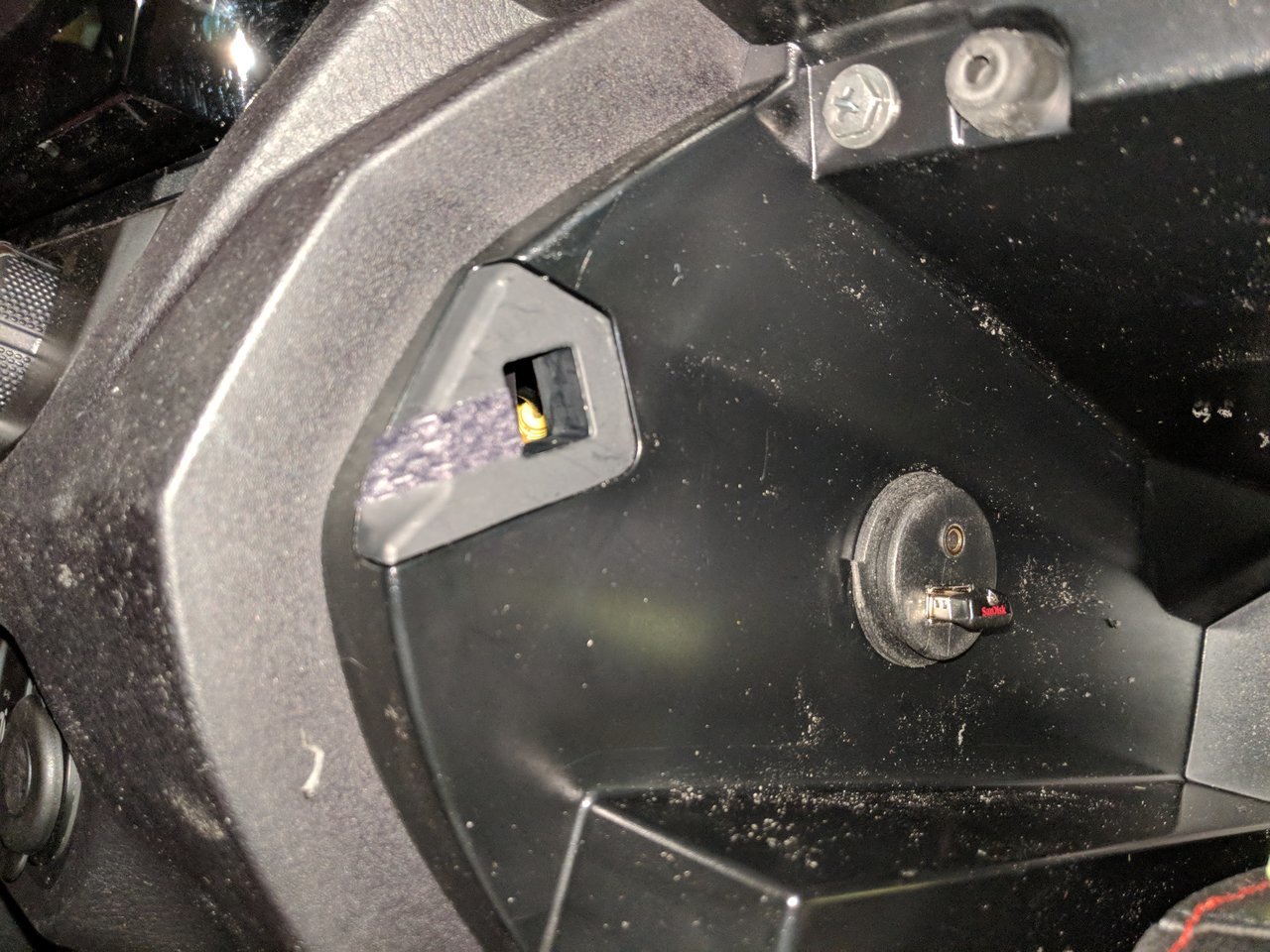

    Today I had the opportunity to move the USB to the glovebox. I'll be honest here, I somewhat fucked this up by putting the hole too far back. I couldn't reach far enough back to properly tighten the retaining nut, and now I feel as though I need to take the whole glovebox apart to correct my fuck up.
    Then I put the Beatsonic camera system in. I don't have a front camera yet, but I had rear camera on demand for the last truck, and I wanted it again. I'll add a front camera later.

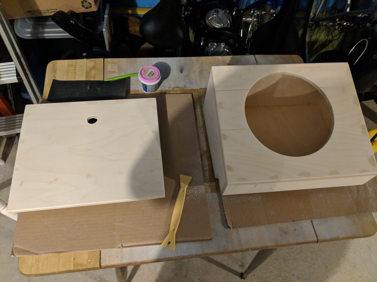

    Audio 8

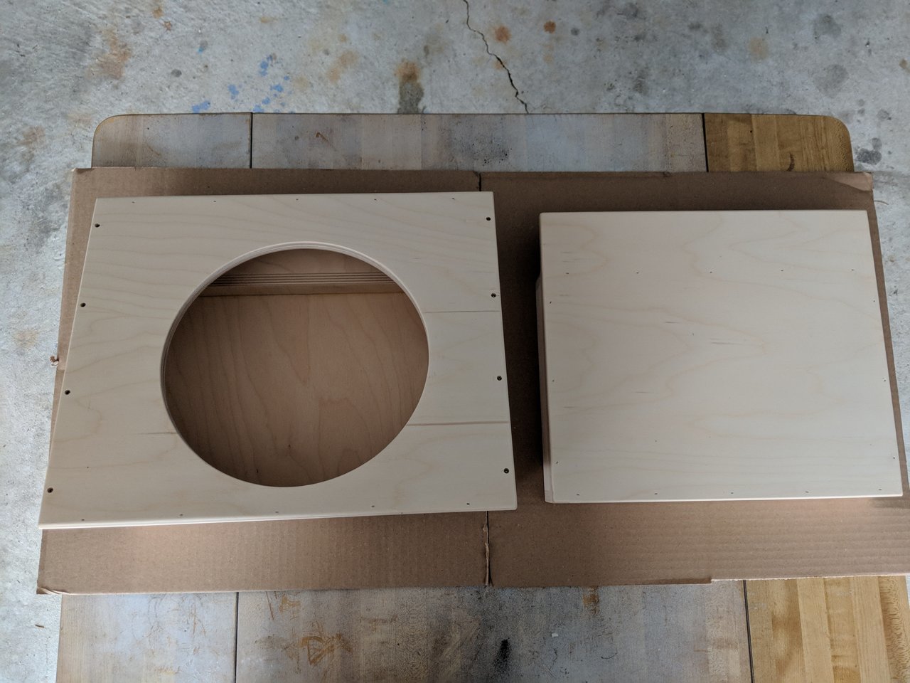

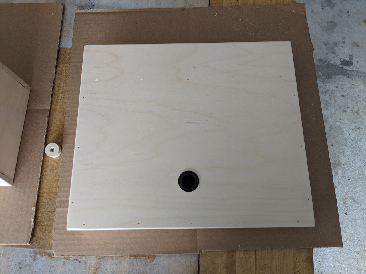

    A little filling and sanding
    I bough a quart of Acry-Tech DuraTex to paint these items with that should hopefully come in this week. This project has been slow going with baby steps because I can't seem to find time to blow it all out at once.

    First the Redarc/Sub panel

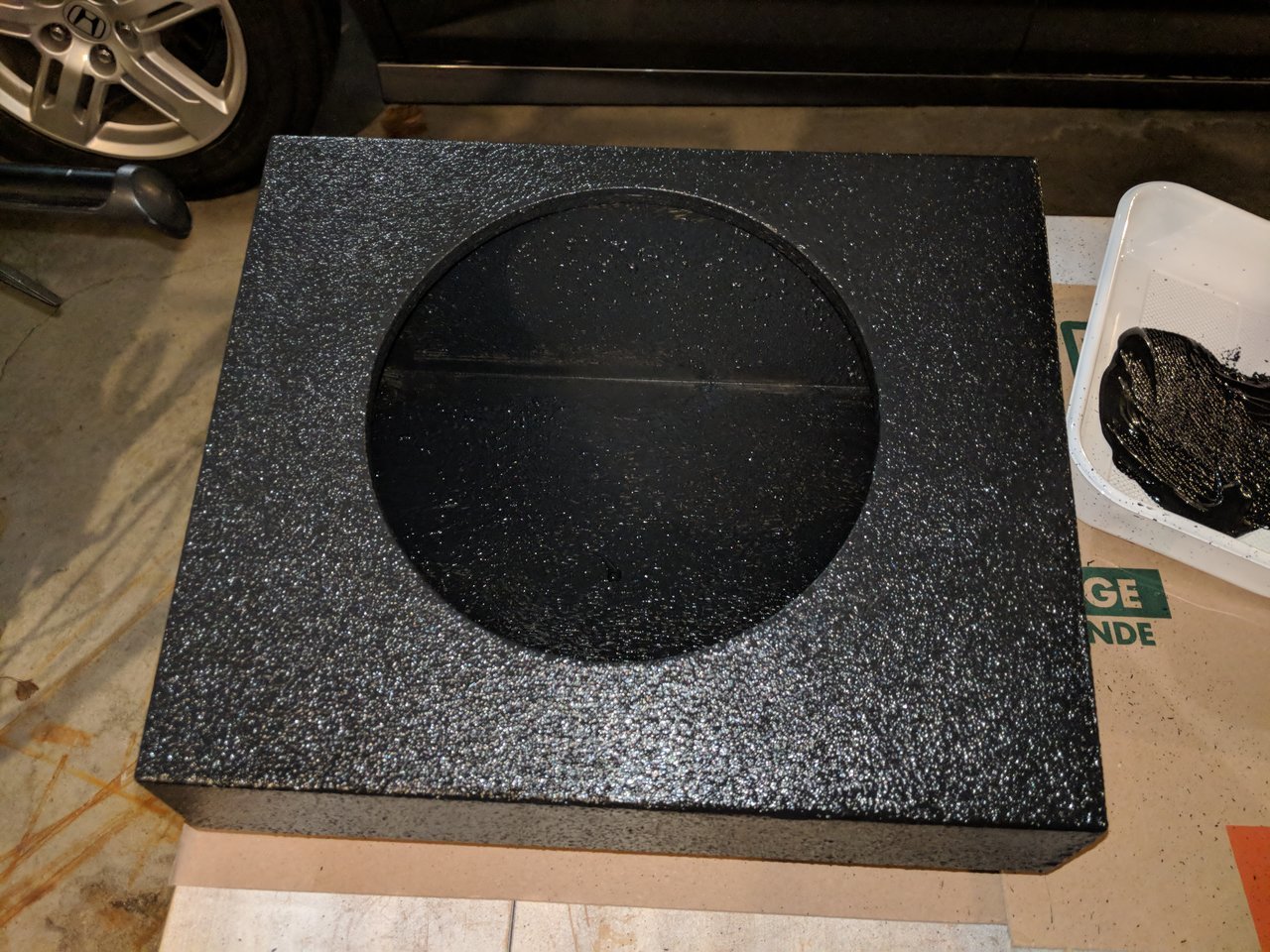

    Audio 9

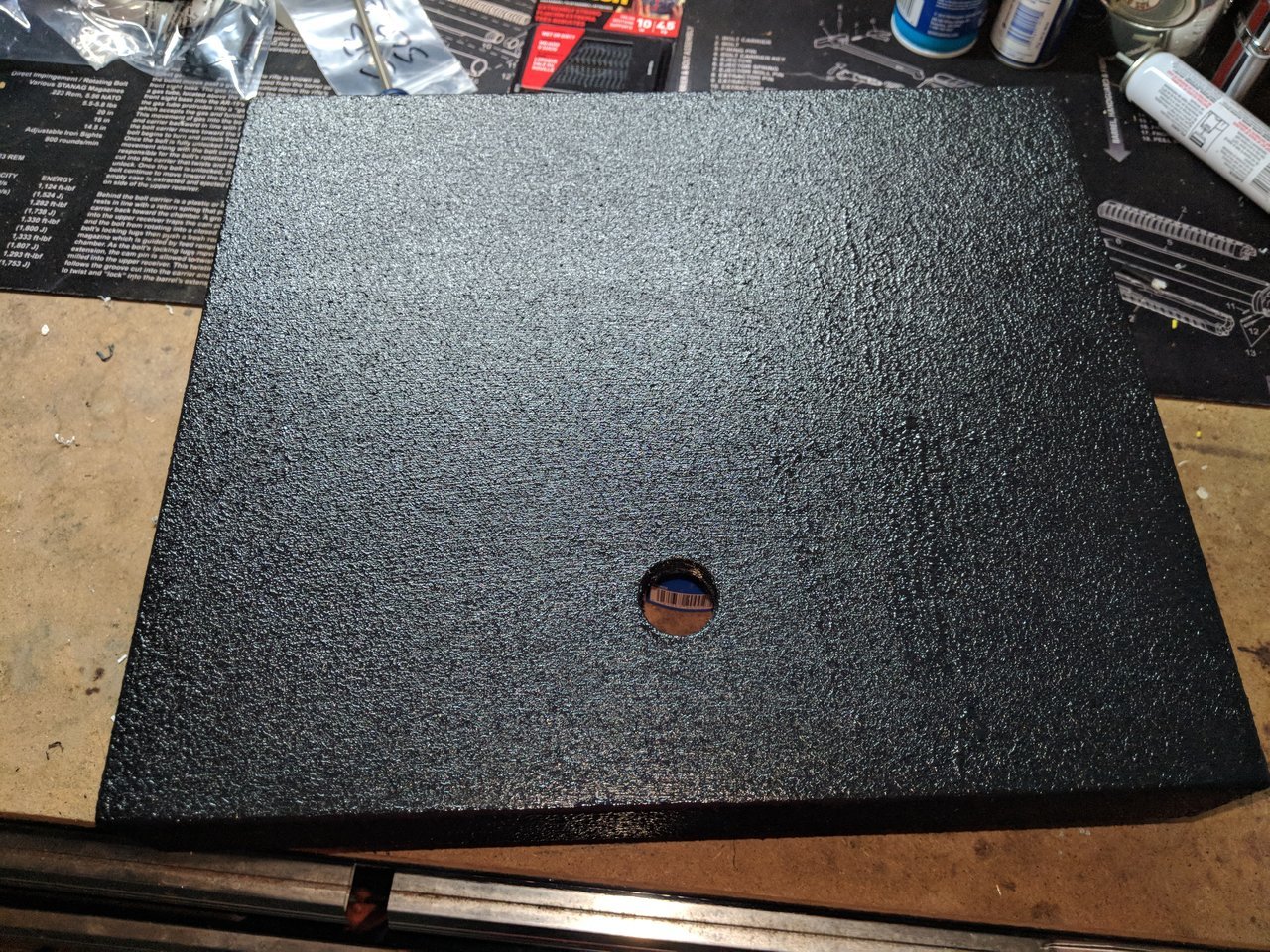

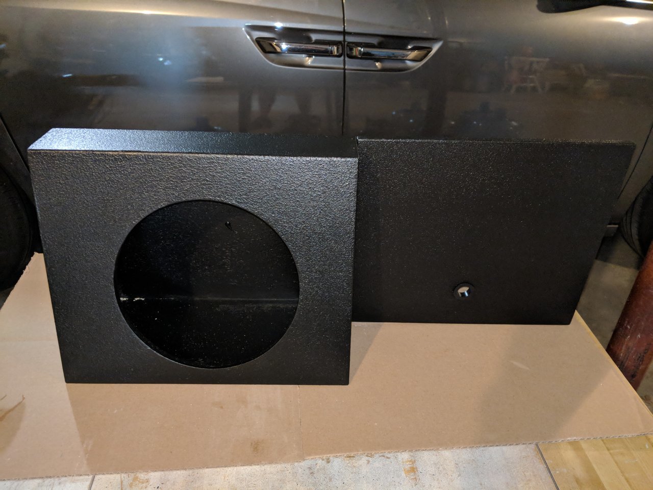

    Staying busy setting up for final install. The DuraFlex paint for sub boxes is awesome, but a quart goes a very long way. I started by brushing a coat, letting that dry/set, then rolling it using the roller supplied. I have enough of that stuff to roll another couple of coats. Will probably roll at least one more on the front sides.
    Still a lot to do, but me and time aren't getting along right now.....

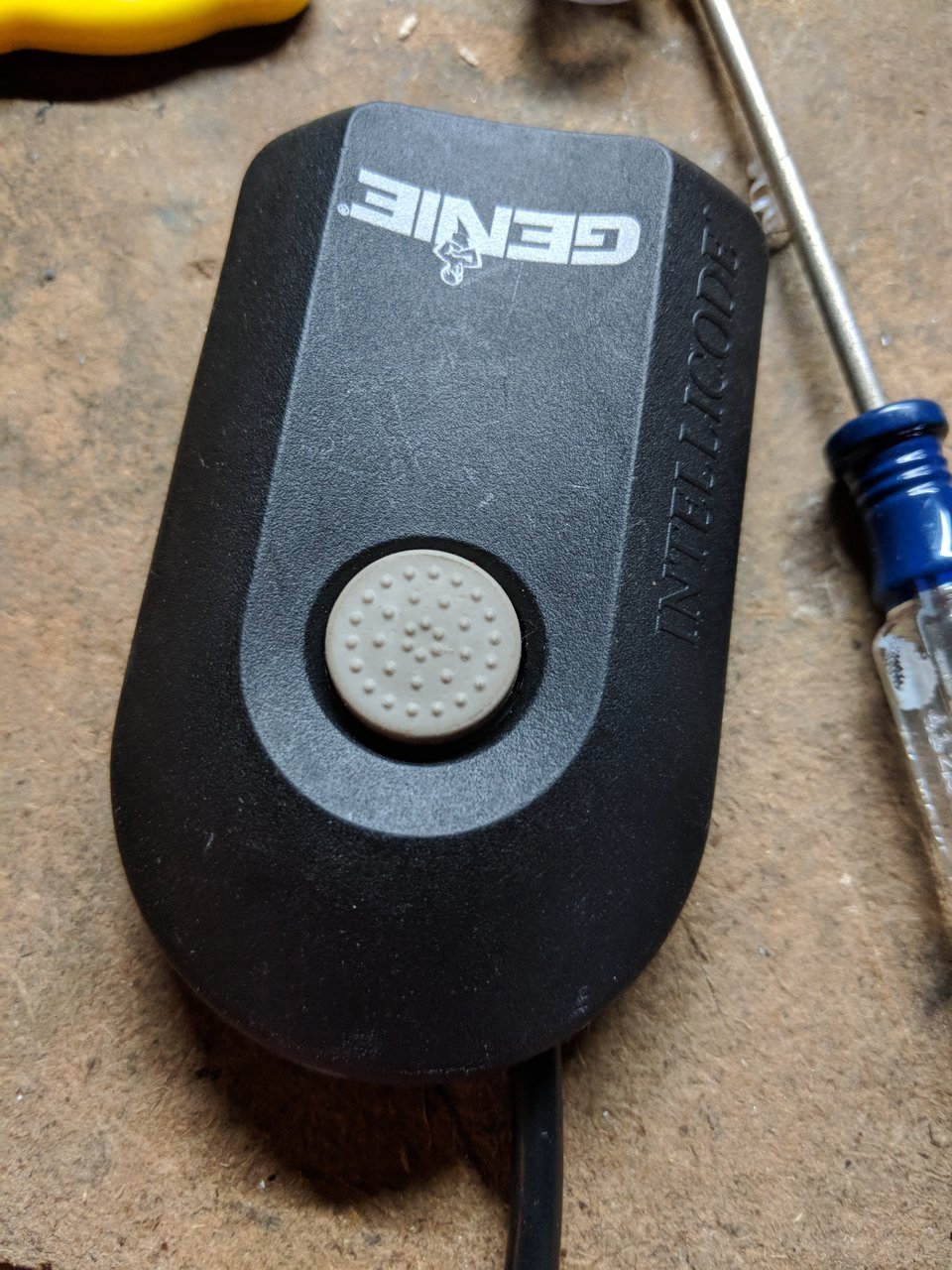

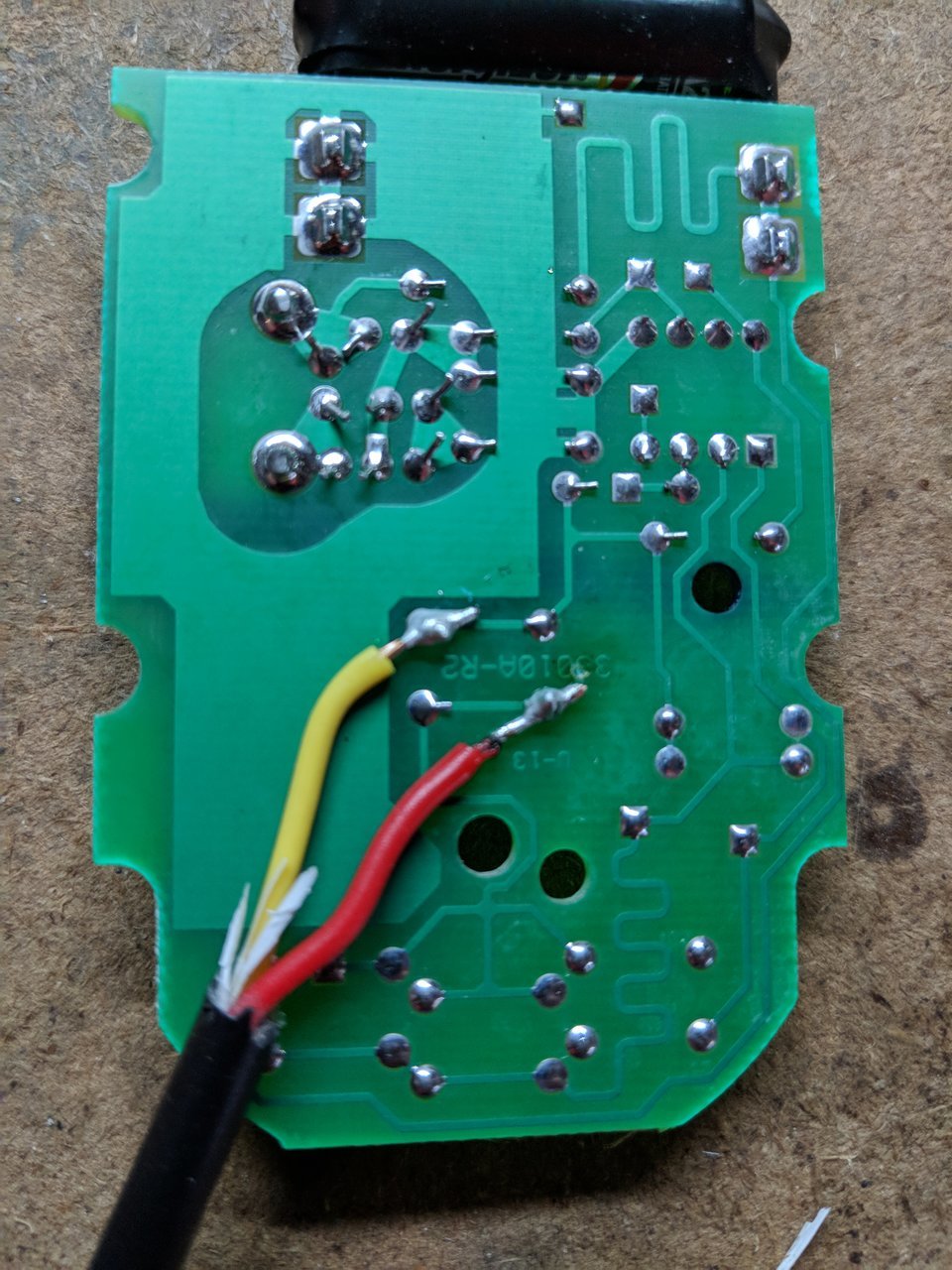

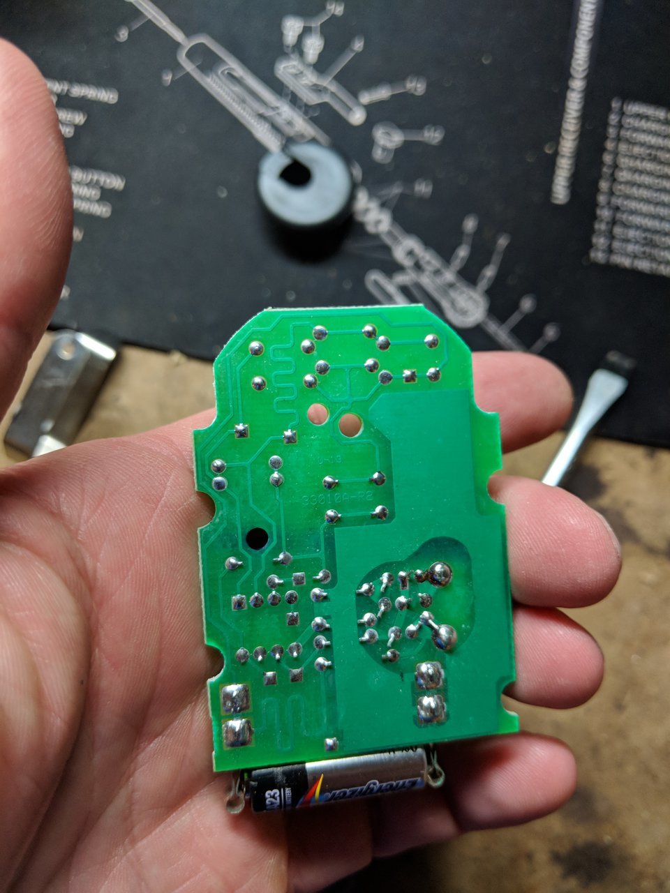

    Finished out my garage door opener project.
    Works just fine. I wish it was a momentary switch, but I like my switch just fine. My kids have called my trucks the yard matey for years, because the plate (YARM8E), so why not...
    Audio 10

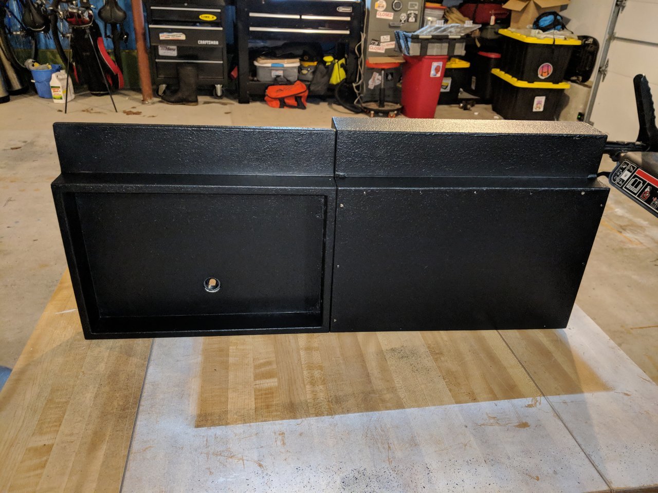

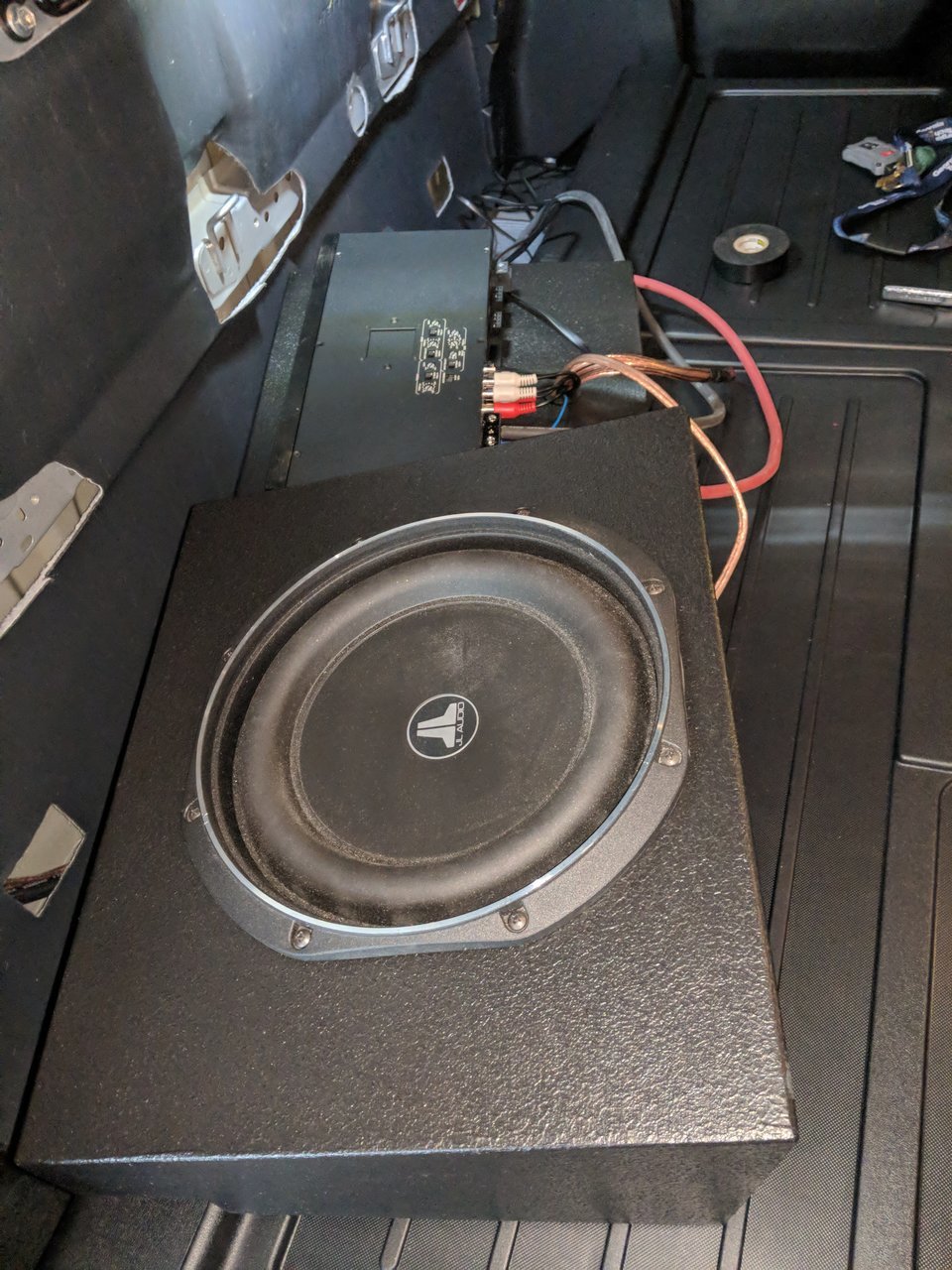

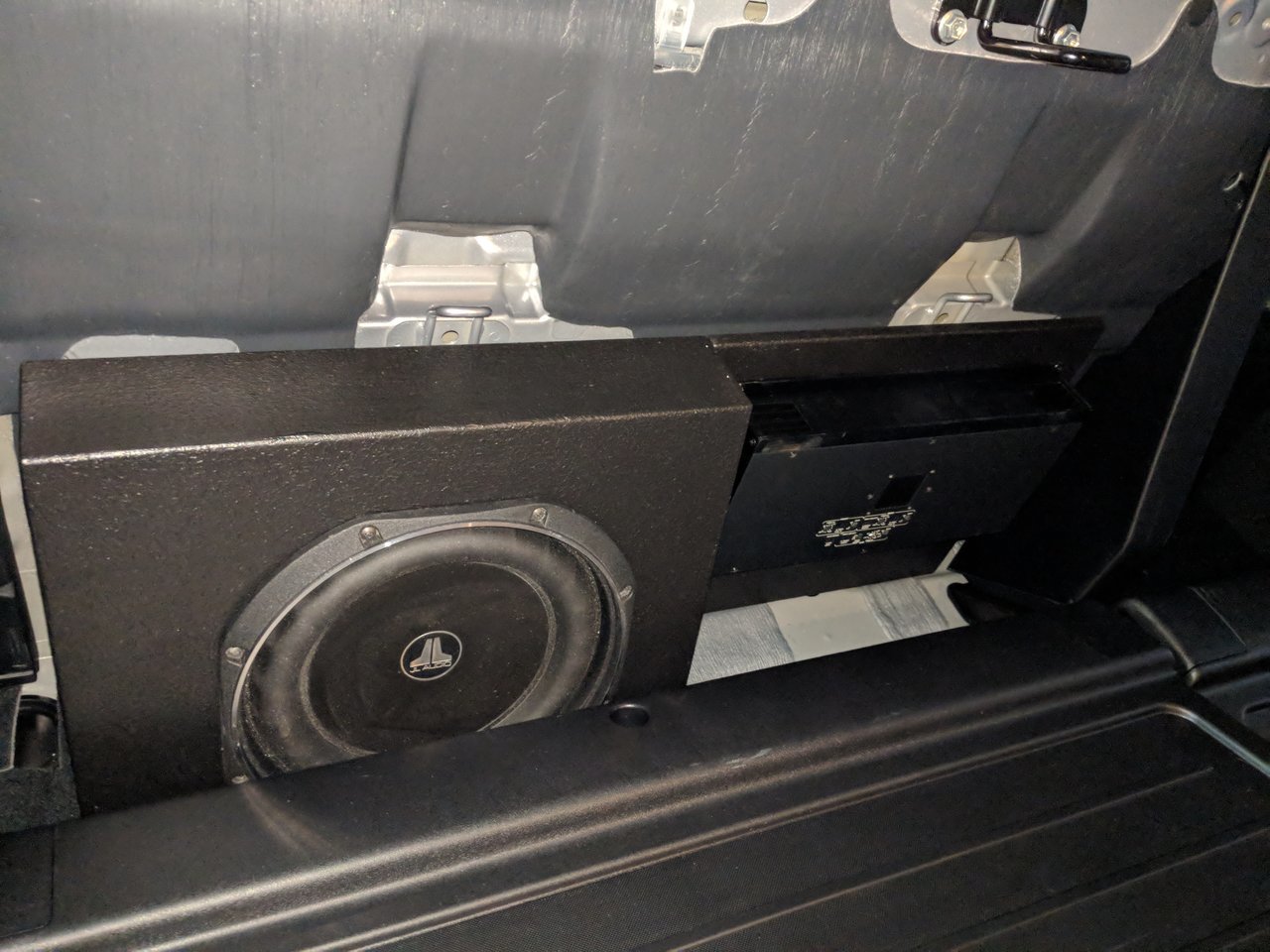

    Finished getting the sub box together. The Duratex paint is fantastic.
    This weekend, hopefully I'll be able to get the amp and sub installed.

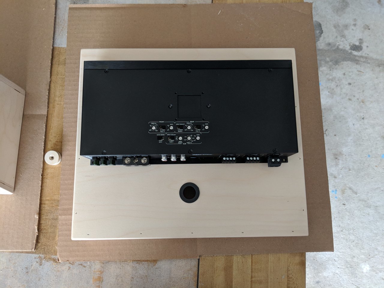

    Audio 11
    Fit test.
    Can't wait to get everything wired and dialed in

    Audio 12
    Getting shit done.
    Maybe I can get this done this weekend.

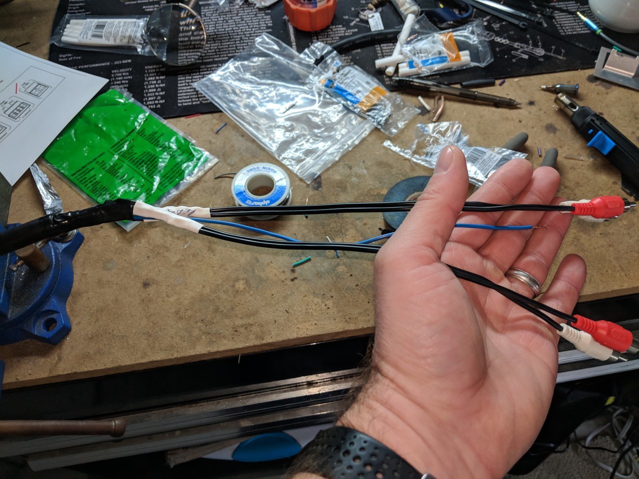

    Audio 13
    Just need to solder RCA connections.

    Audio 14
    Today's work!
    RCA plugs soldered
    Fuse is in. This might be a temp spot
    Tuning done!
    I used a DSO Nano oscilloscope to set the gains. The OEM head unit doesn't clip even at Max volume, but I set the gains at 52 volume, using 1khz tone at 0dB, and 60hz at 0dB. @Mr Marv was very helpful.
    All snug and done:

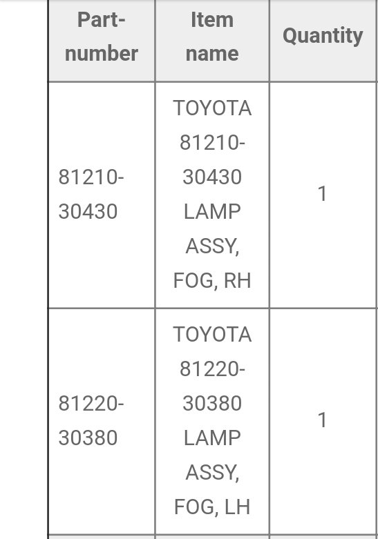

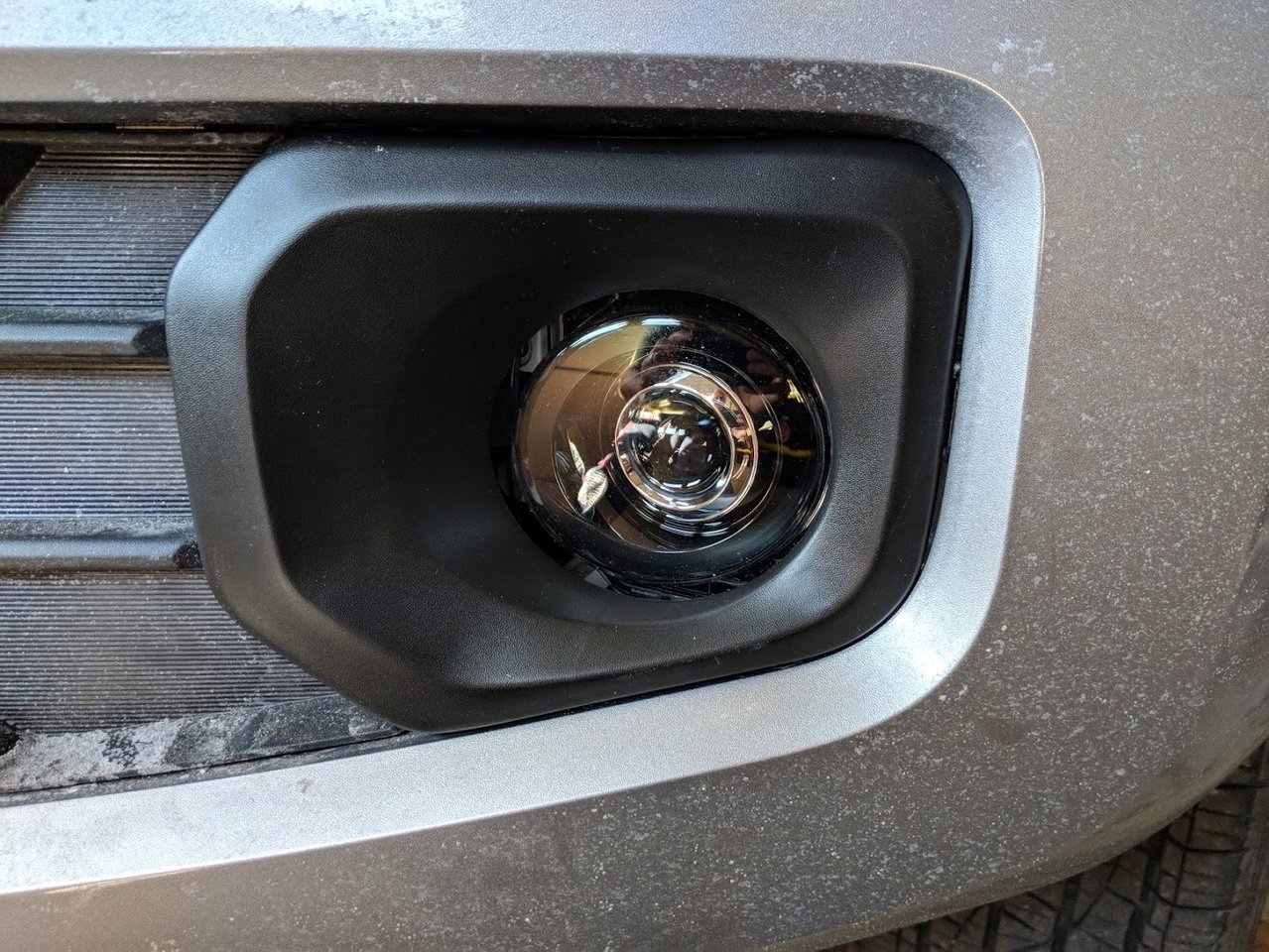

    Put in the lexus projector fog lights tonight, and they look great. I didn't take off the grill. Tried to take off the fog trim and may or may not have broken a clip. I was going to get sr5 trim anyway. Took 5 minutes a side after figuring out I could get them in with minimal issue without removing anything.
    Right one switched, left one OEM
    Just DRL
    Lows
    Part numbers

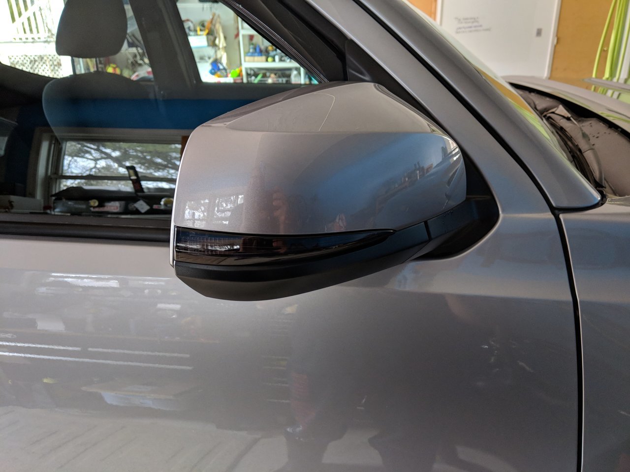

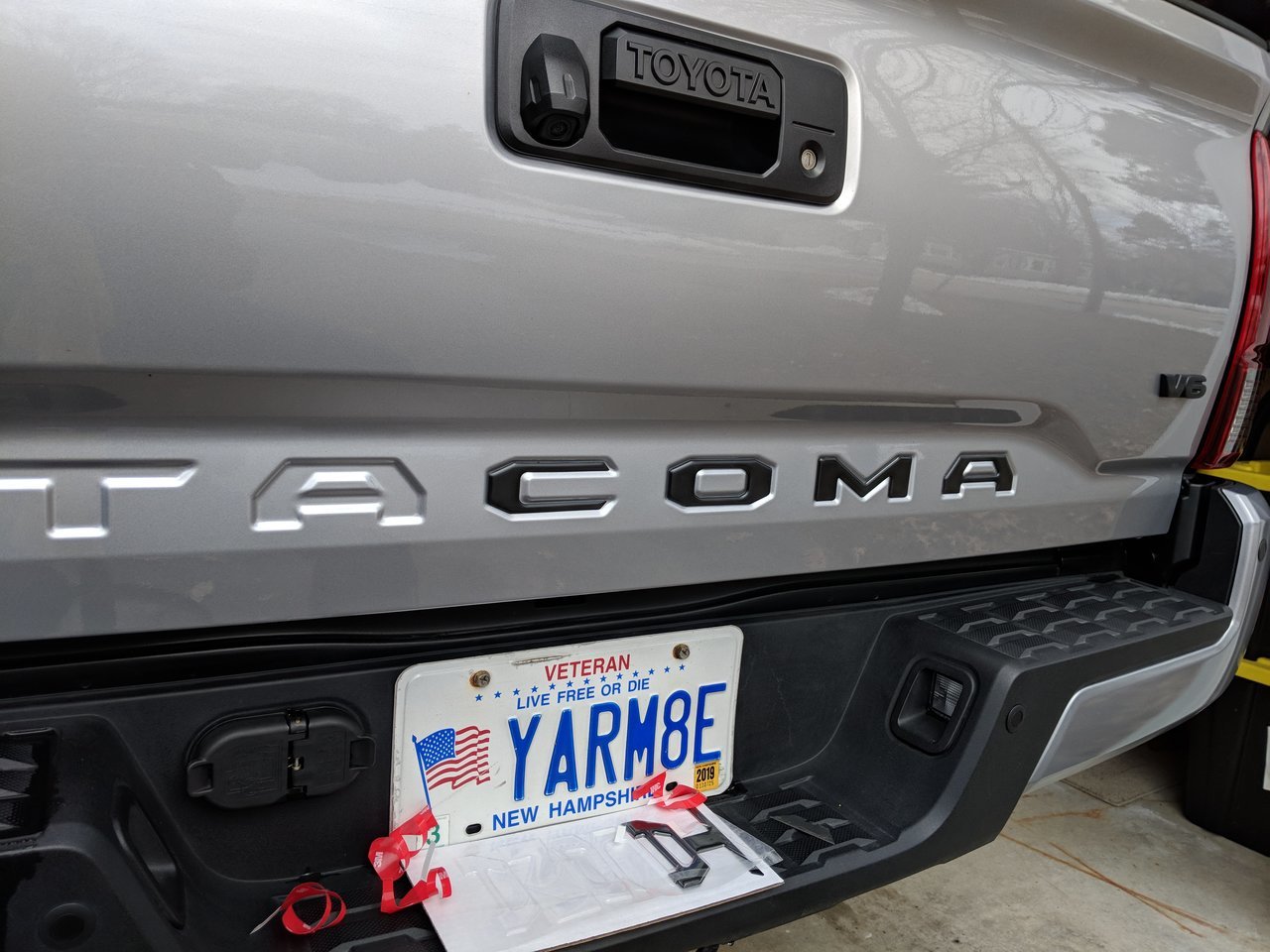

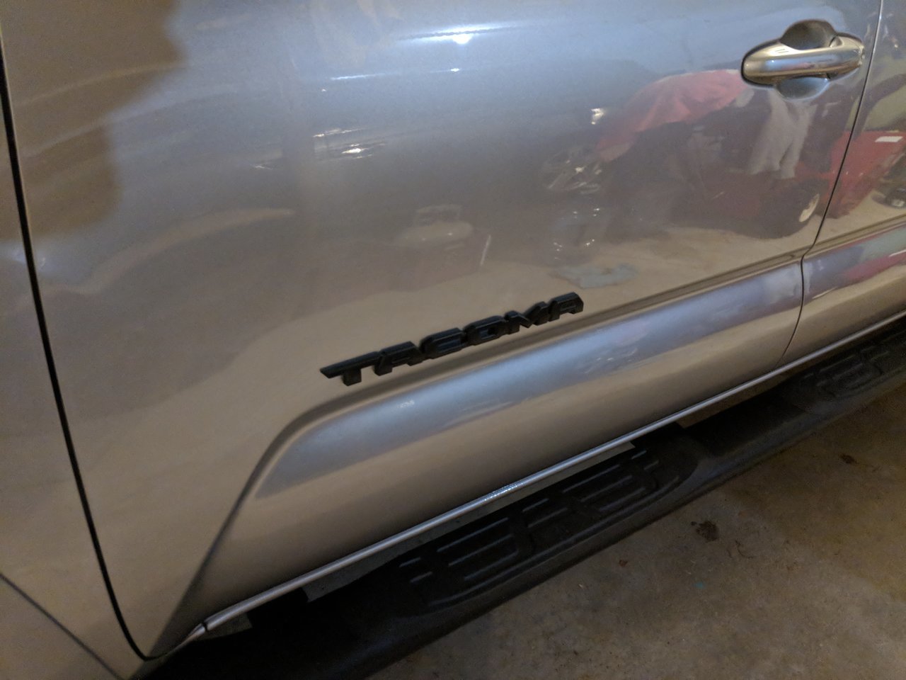

    Good day today! Washed and a quick once over inside, then:
    Tailgate inserts, matte black bt TuffSkinz
    Covered the chrome emblems
    Installed @mesojdm ultimates
    The blinkers went in quicker than the inserts did, and look fantastic.
