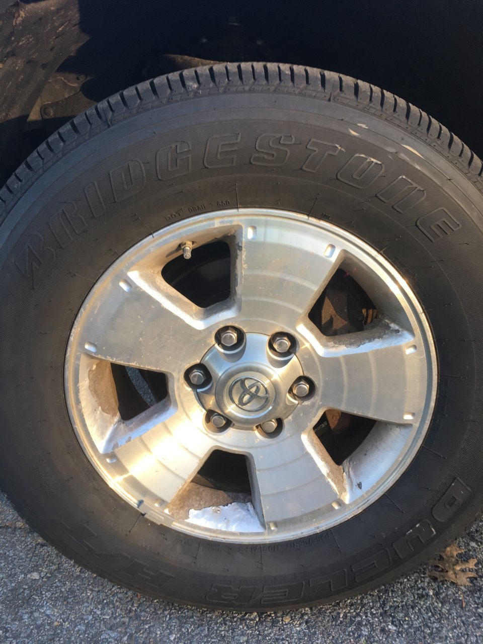

    They were ugly. These are the Level 8 MK 6 wheels. There was a huge 8 in the hubs, and I hated it.

    Good call. I’m pretty sure I’d get sick of those too. I need to find a place to refinish my of rims . All pitted
    I’m in Nashua too . Any suggestions?

    There's a powder coat place on Simon St. Rapid Finishing. I've had work done by them.

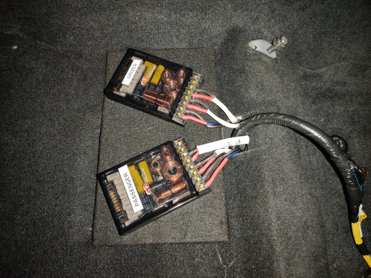

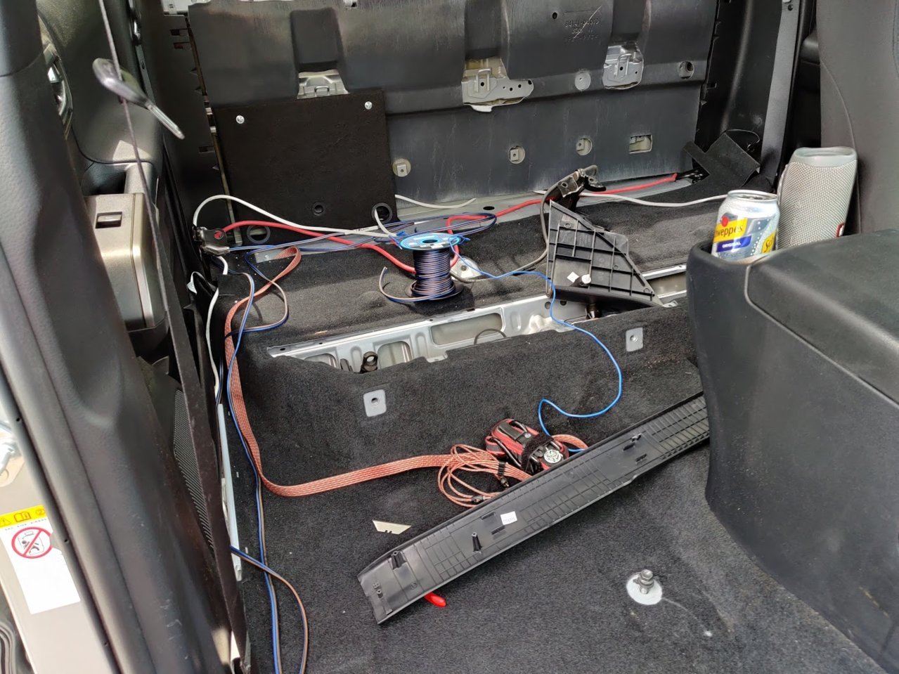

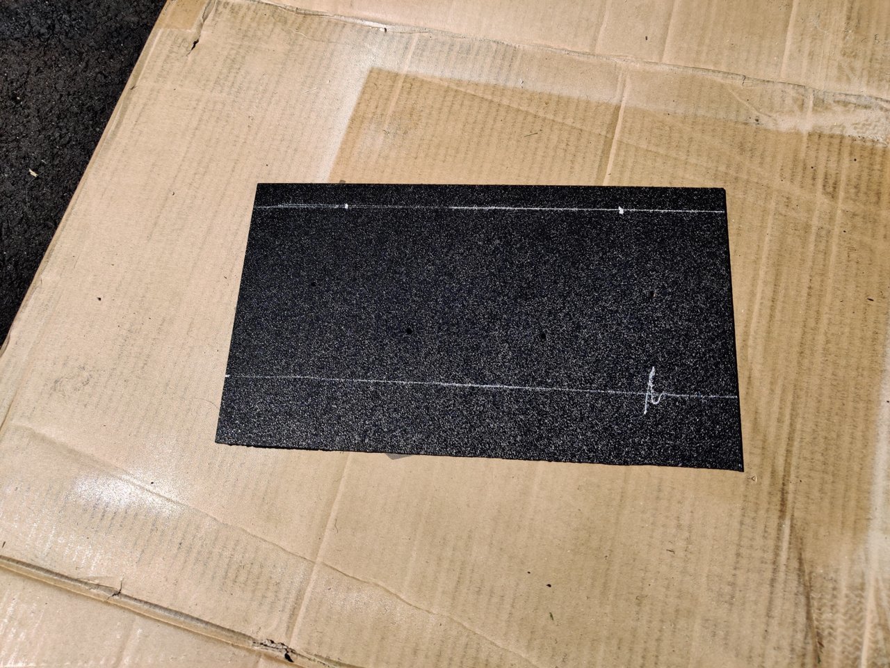

    So I've decided to completely rip shit up in the interior while waiting to get my amps back. Going to fix all my wiring sins, starting off by moving the crossovers to under to under passenger front seat. Had a piece is ABS left over from another project:

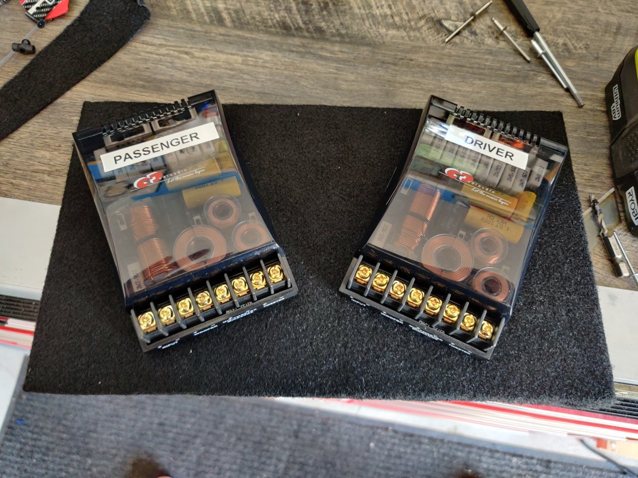

    I carpeted it and mounted the crossovers to it by tapping the holes to M4 size and used screws left over from an RC car project
    Because the crossovers are light(ish), the mount will just be Velcro-ed on

    Finished this part of clean-up

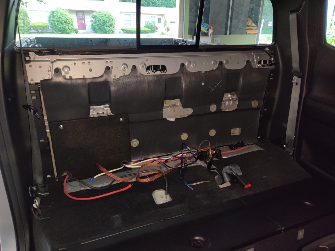

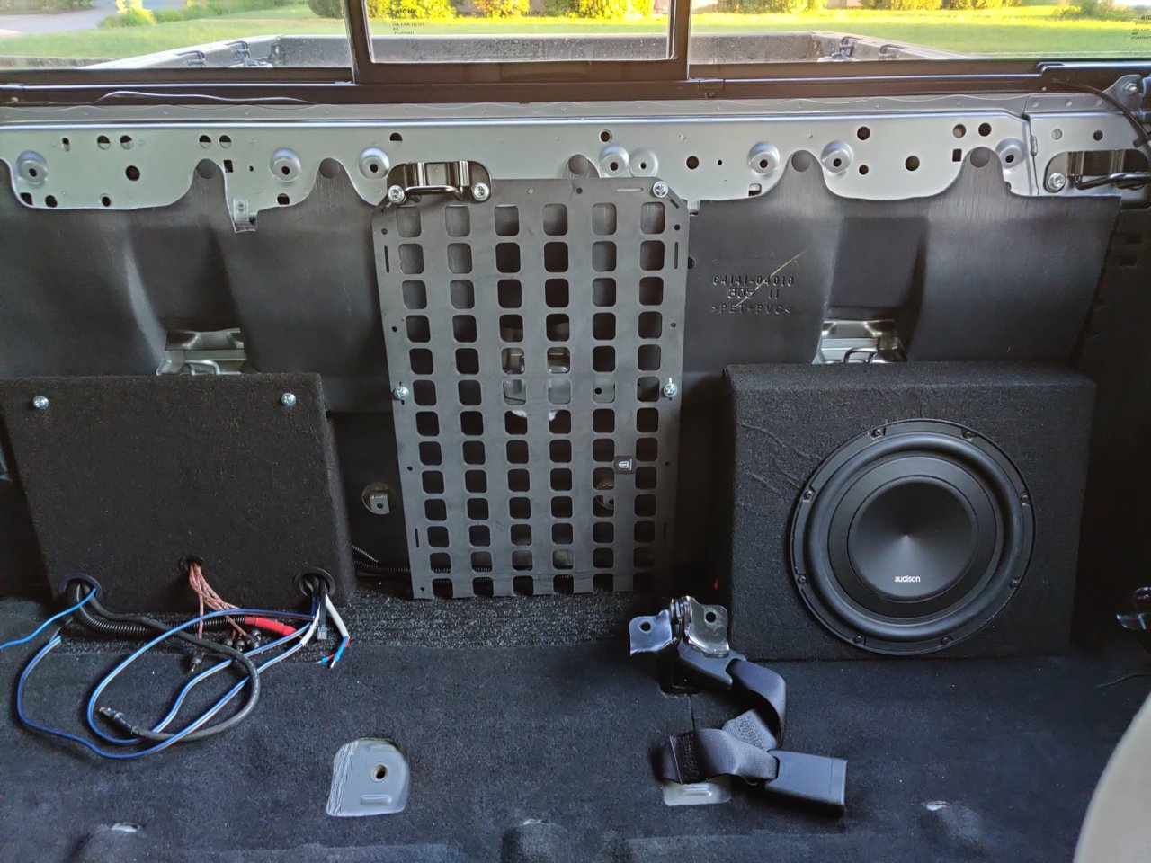

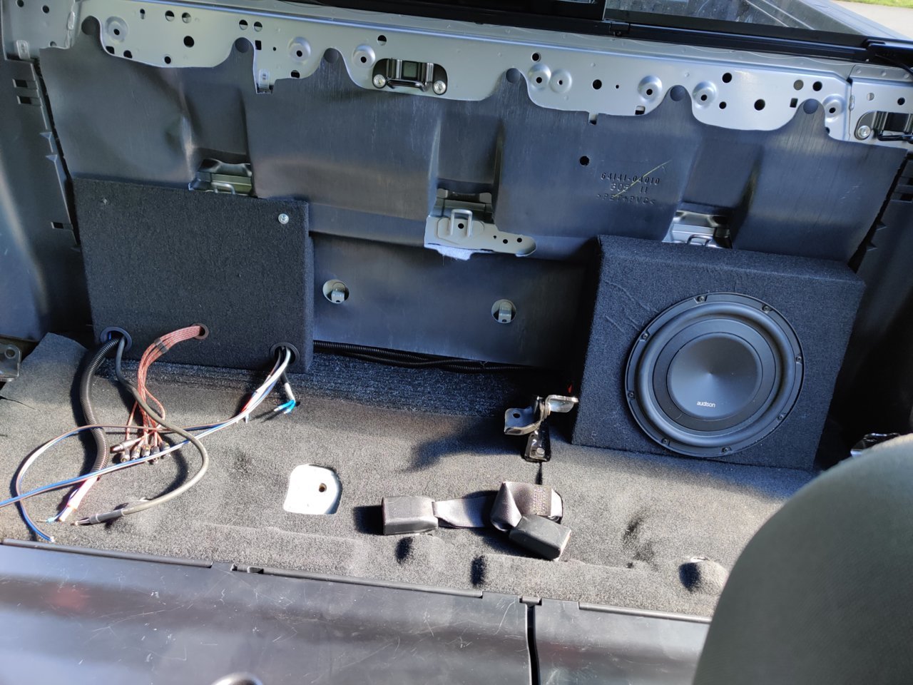

    Yikes. So hhe sub is going to be behind the driver side. I've got a MOLLE panel coming in to center between the sub and amp to make up for lost storage (IFAK, Emergency Clothing and Rain Gear).

    It's a mess still, but way cleaner now...

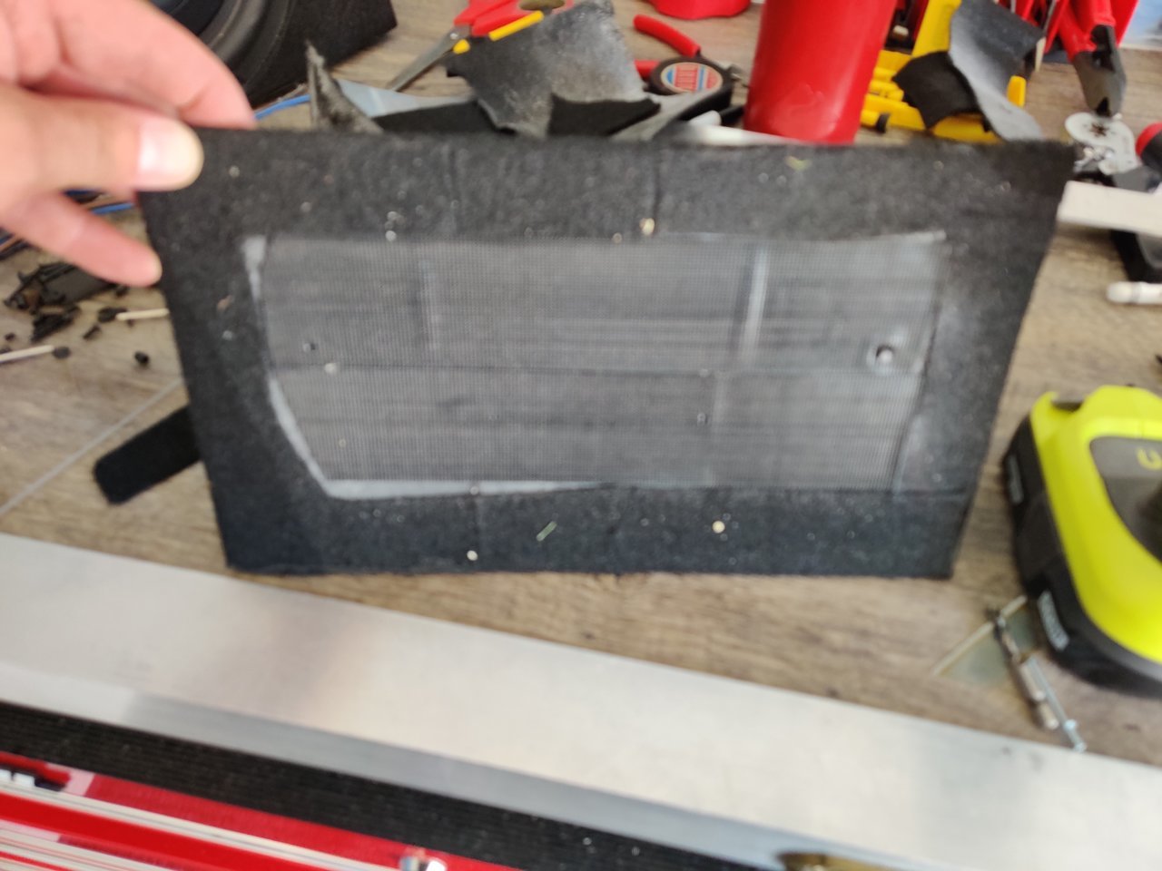

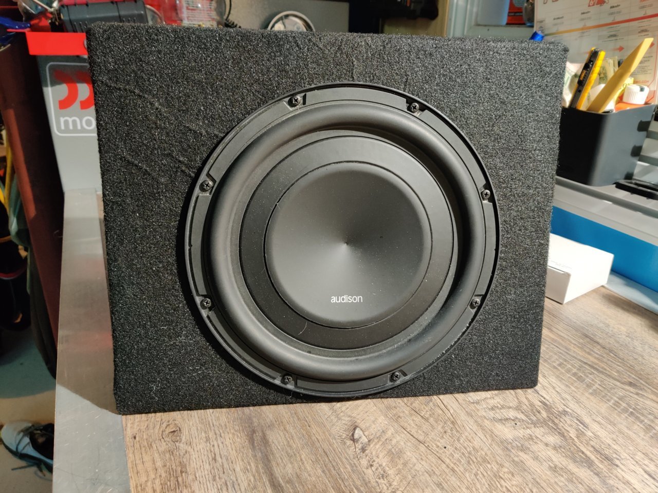

    Note to self:
    Don't carpet a sub box after day drinking in the sun...

    It's as ready as it can be... Waiting for amp is going to kill me LOL

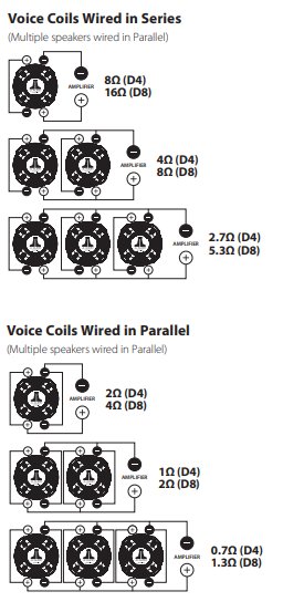

    So, audio update 2,000:
    I am going with a JL 12TW3-D8. I'm going with the D8 because the amp I am using (if it ever gets back to me) is the AudioControl LC-6.1200 - which is not 2 ohm stable on channel 5/6 when bridged. That said, when the D8 is wired in parallel, it has a 4 ohm load, which is my target:
    Mr. Marv is building me a new box as well.
