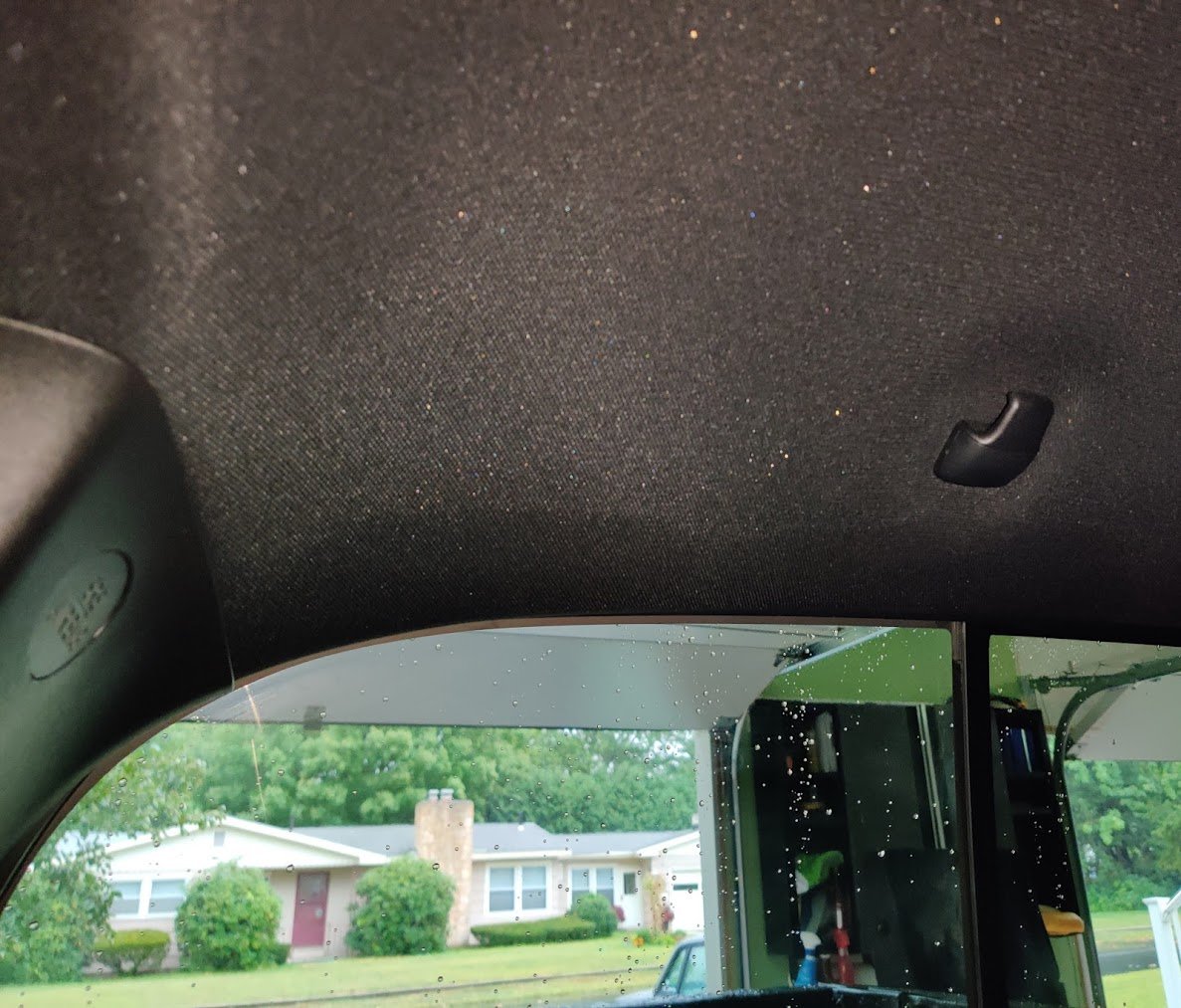

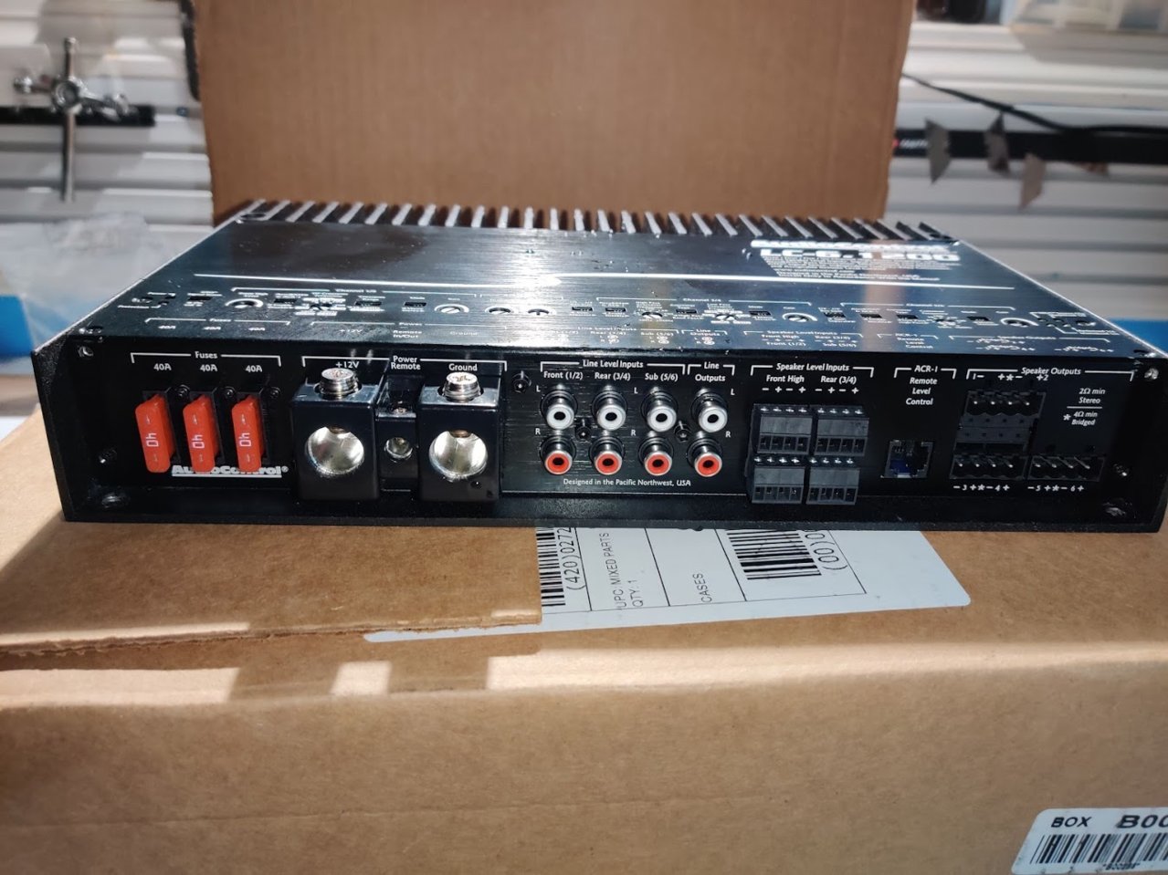

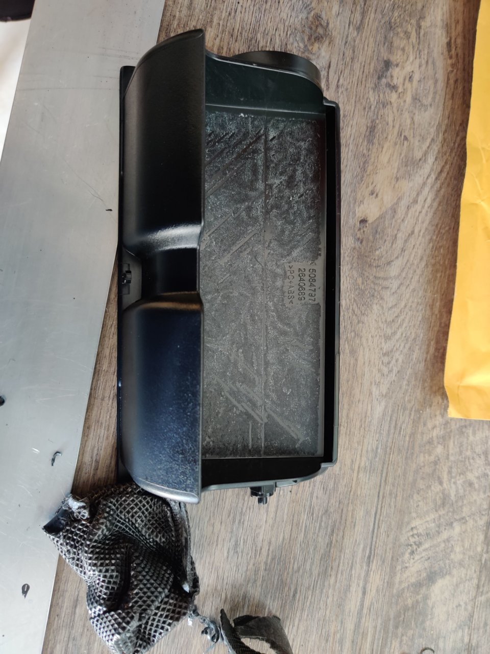

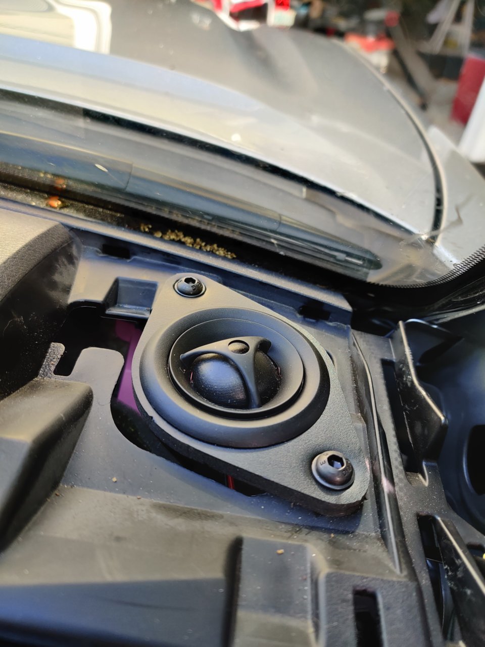

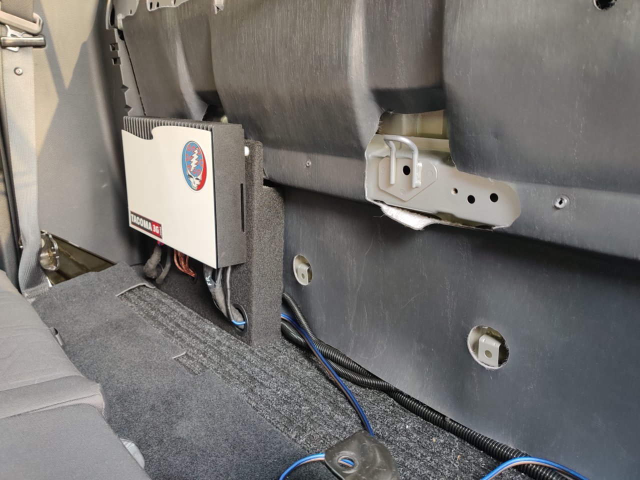

    This may or may not be long winded - and I didn't want to post anything when it happened, because I was pretty pissed off.
    Thursday (9/10) we had some significant rain. I had my truck parked in the driveway, as me and the old lady were sitting in the garage, watching the rain because we hadn't gotten any in like a month.
    I recalled there was something in my truck I needed to get, and when I got out there, I found that the third brake light failed, pooled up in the headliner right above the amp, and then dumped.
    Right into the amp I had just gotten back.

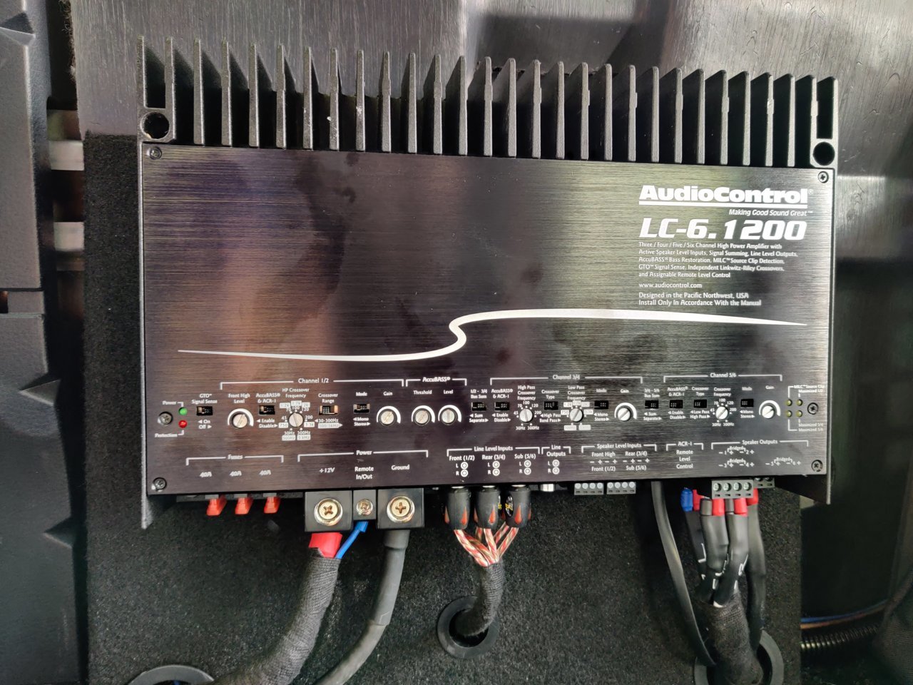

    Son of a bitch. Anyway. I disconnected power and pulled truck in garage. Took the amp out and called Toyota of Nashua to make an appointment to get the issue fixed. I called AudioControl and talked to Josh (we're on a first name basis now) - he stated that because the amp never powered up while wet, to just let it dry out a few days, then reconnect. So I set the amp to just dry out, with a fan pointing straight into it.
    On 9/11 I brought my truck in to have the third brake light repaired. I was charged the full amount - the reasons given?
    1. There is no recall for this item
    2. My truck is out of warranty
    3. There is no TSB extending the warranty for this issue
    4. My truck had vinyl done by a third party.
    Well, to make sure this doesn't happen AGAIN, I think I'll put some silicone sealant around the third brake light.

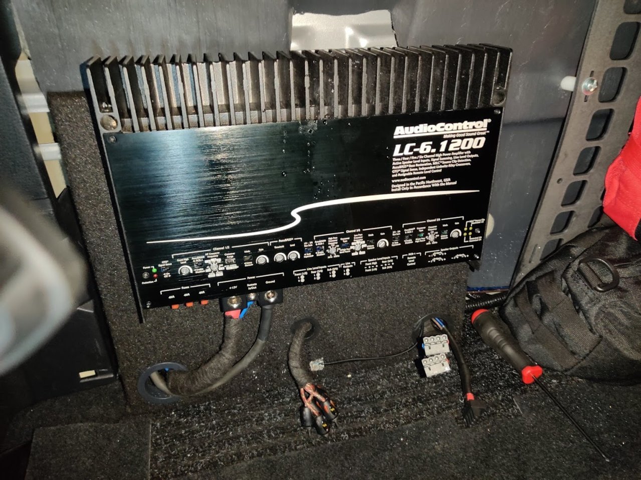

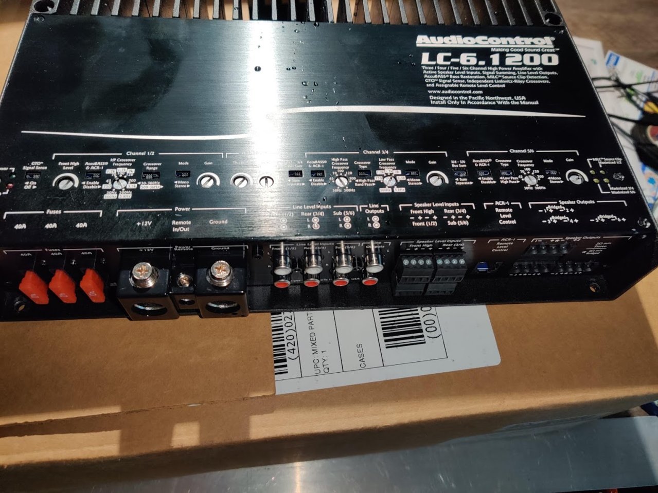

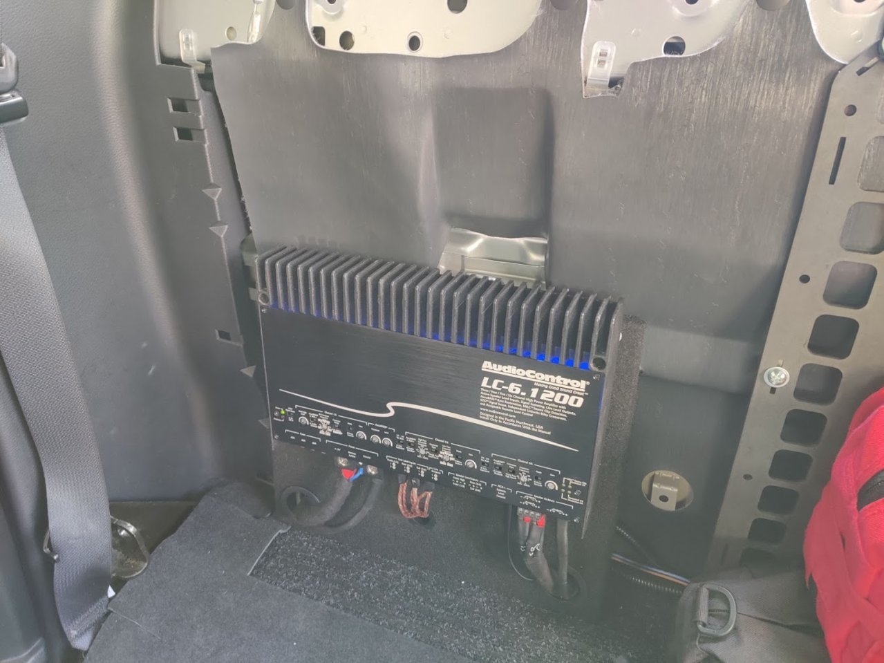

    So yesterday, after allowing the amp to dry with a fan on it for about 3 days, I hooked it back up in the truck, and low and behold, it flipped on like nothing happened.
    No warnings, no blinking, no smoke. Just good clean power to the speakers, like nothing happened. At least 1 thing went my way......

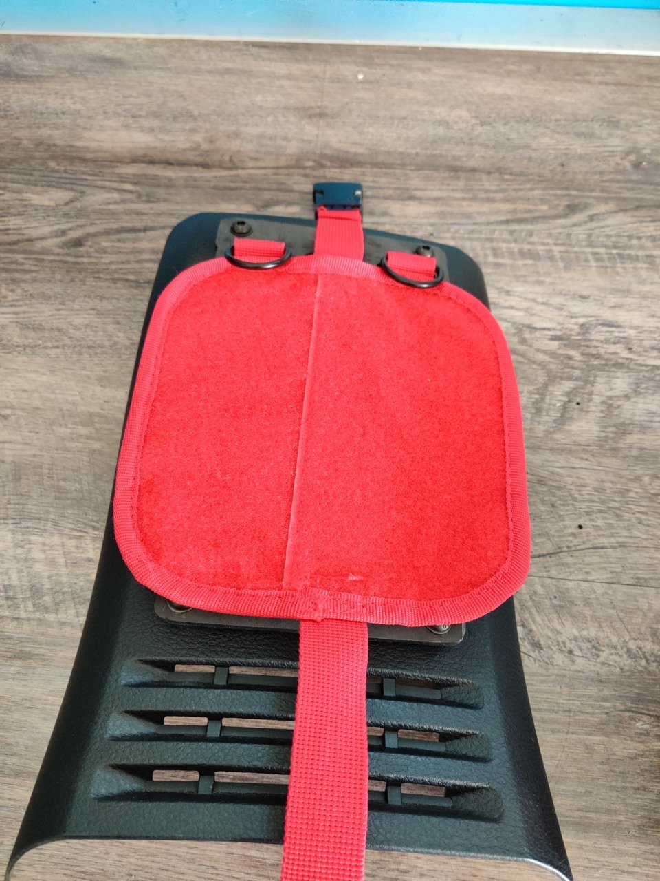

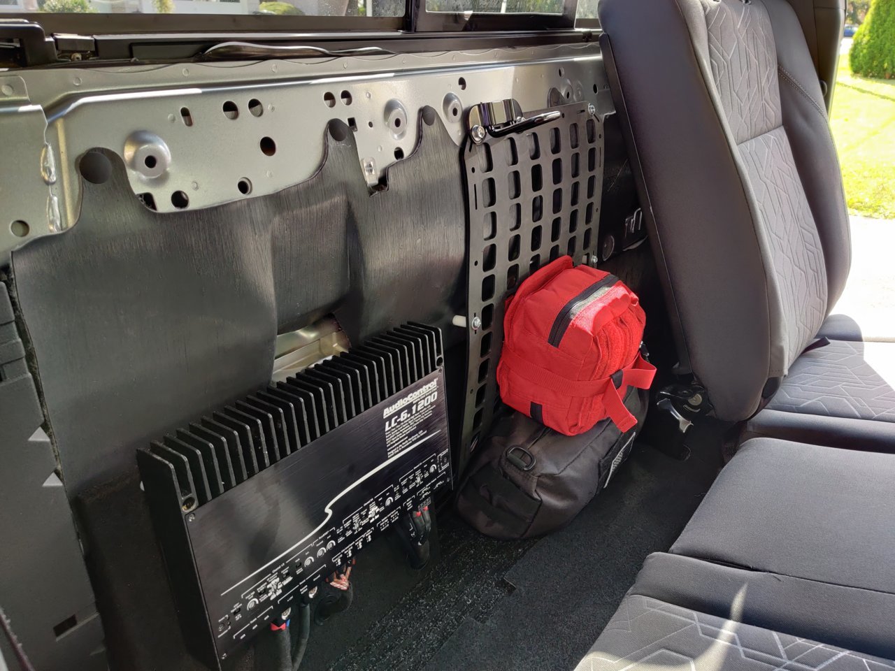

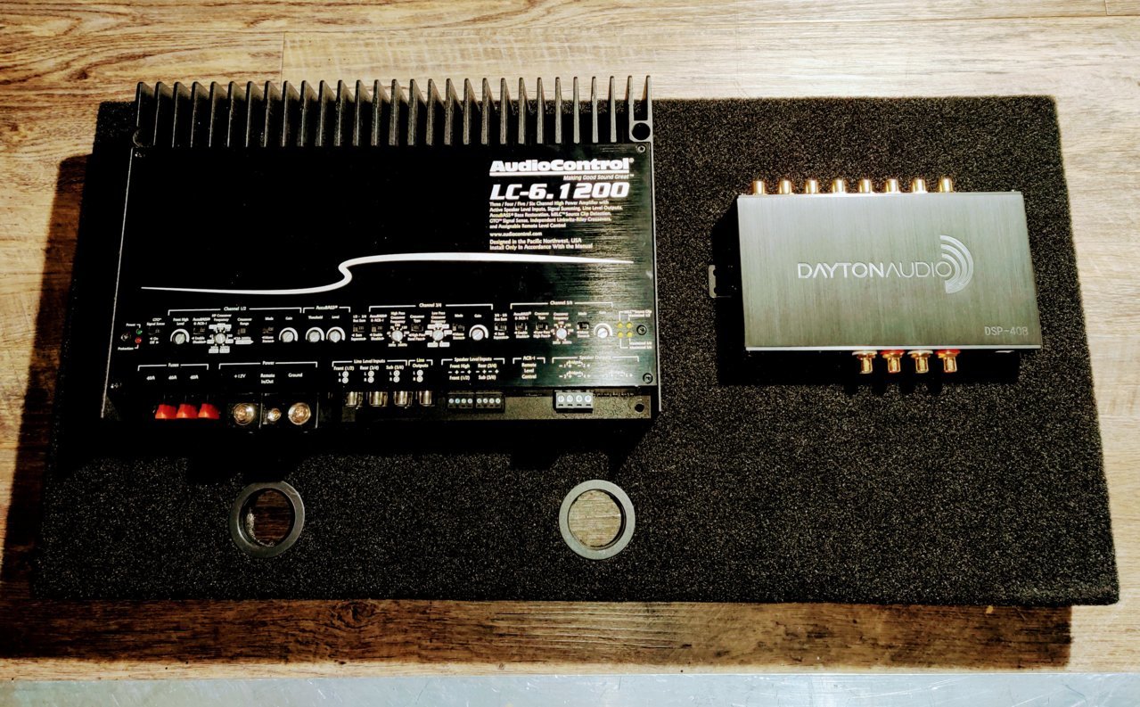

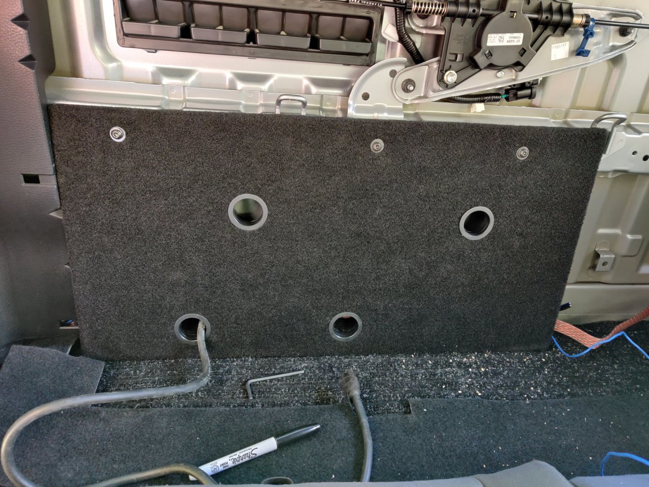

    Prepping for my sub box to come in! Took down the Molle on the back wall
    Repurposed a left over piece of molle I had from a while back and did this
    IMG_20200915_153405.jpg IMG_20200915_161751.jpg IMG_20200915_162231.jpg IMG_20200915_170130.jpg

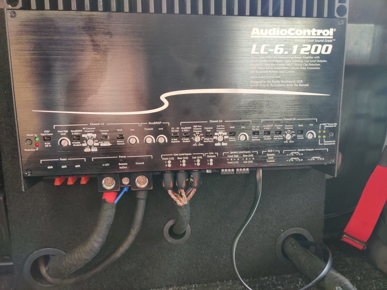

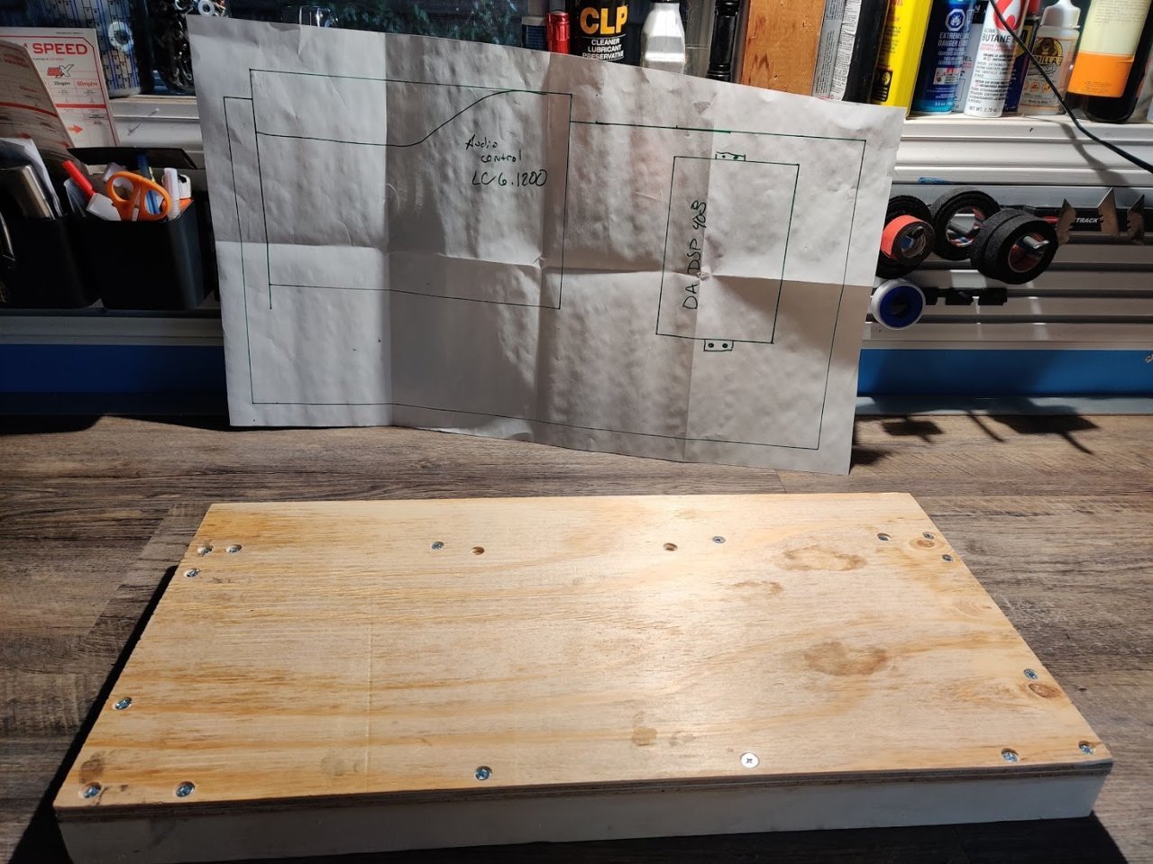

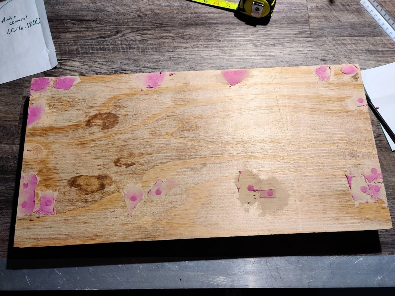

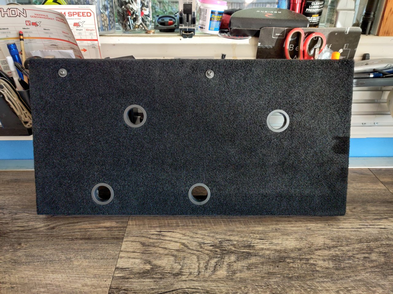

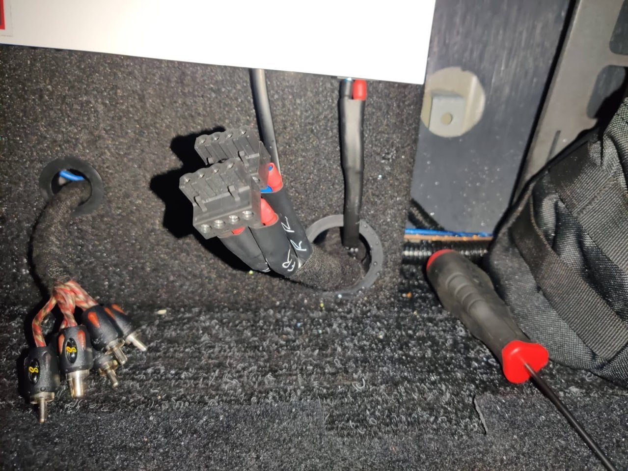

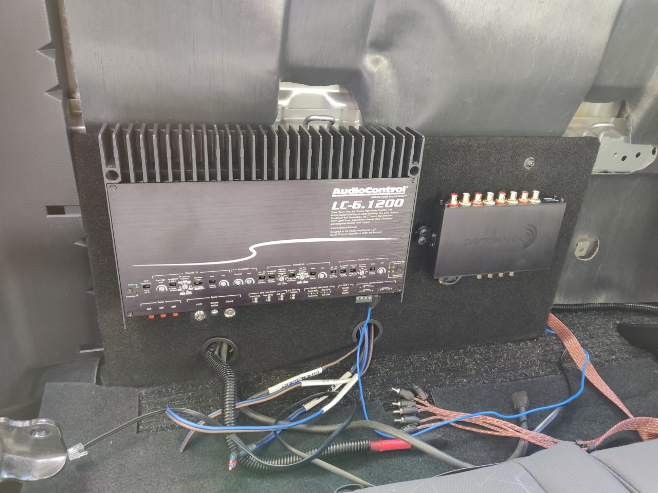

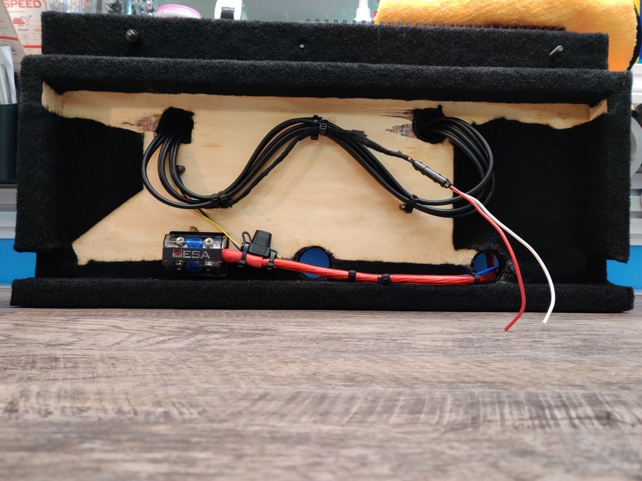

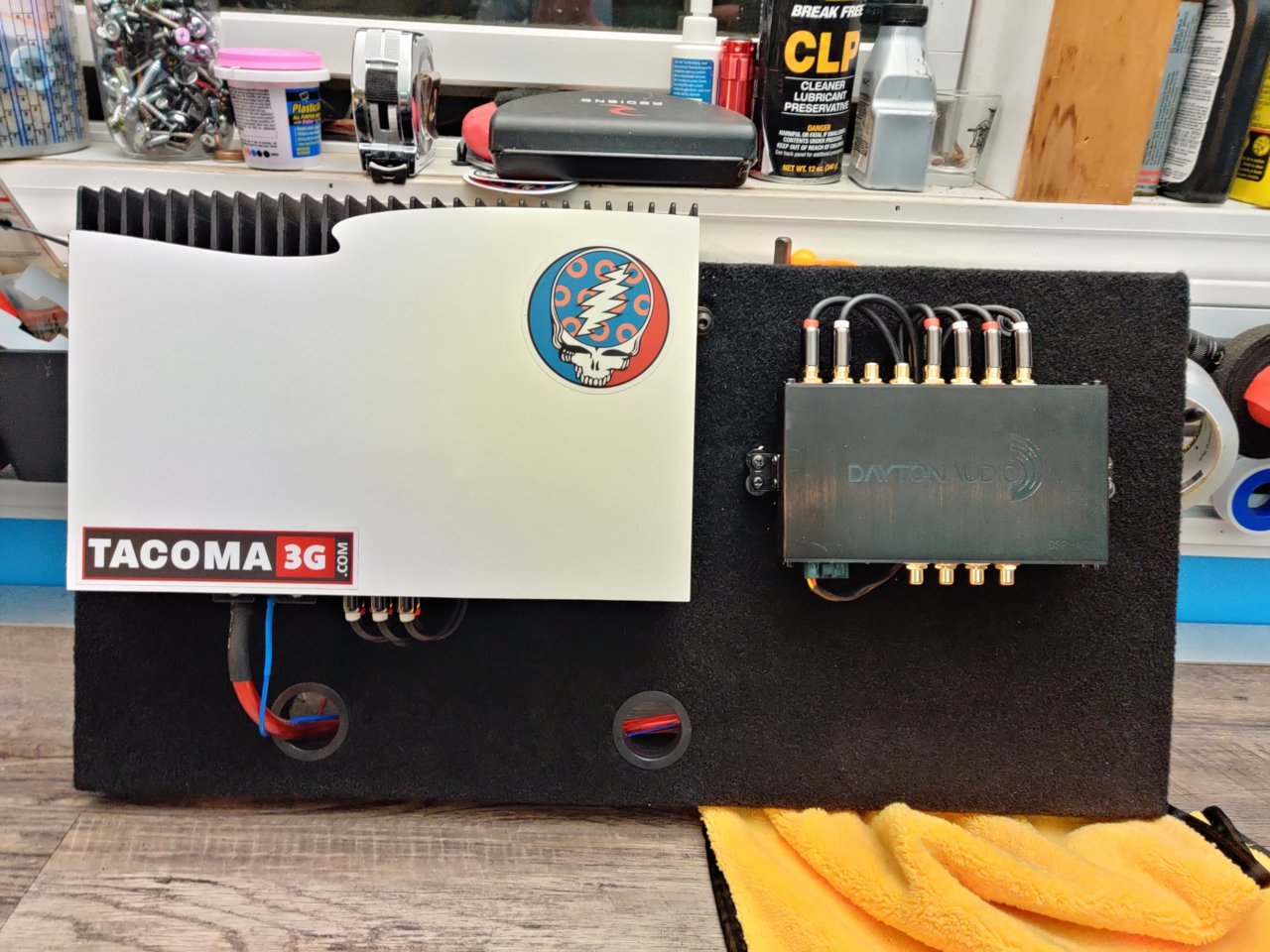

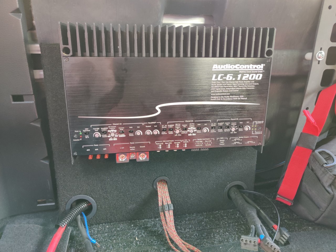

    Built the new amp rack. This weekend I will probably remove the amp, rear speakers, the passive cross-overs, then re-run wires.

    Tonight's progress. Tomorrow I'm going to put power to it IMG_20200921_192000.jpg
    Getting ready to tune....

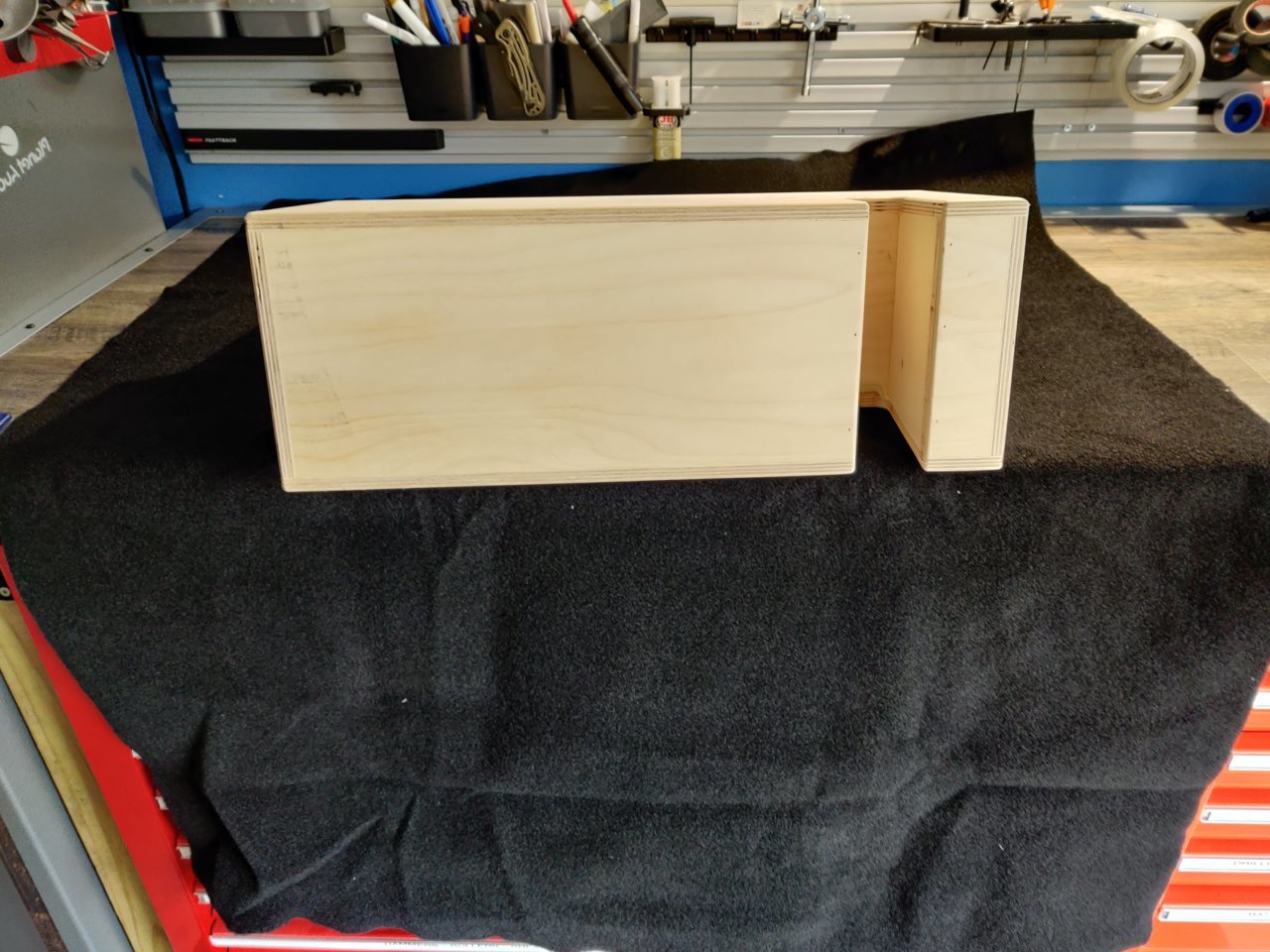

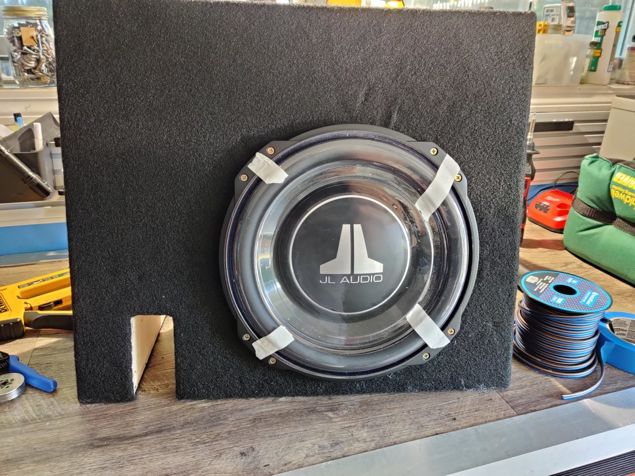

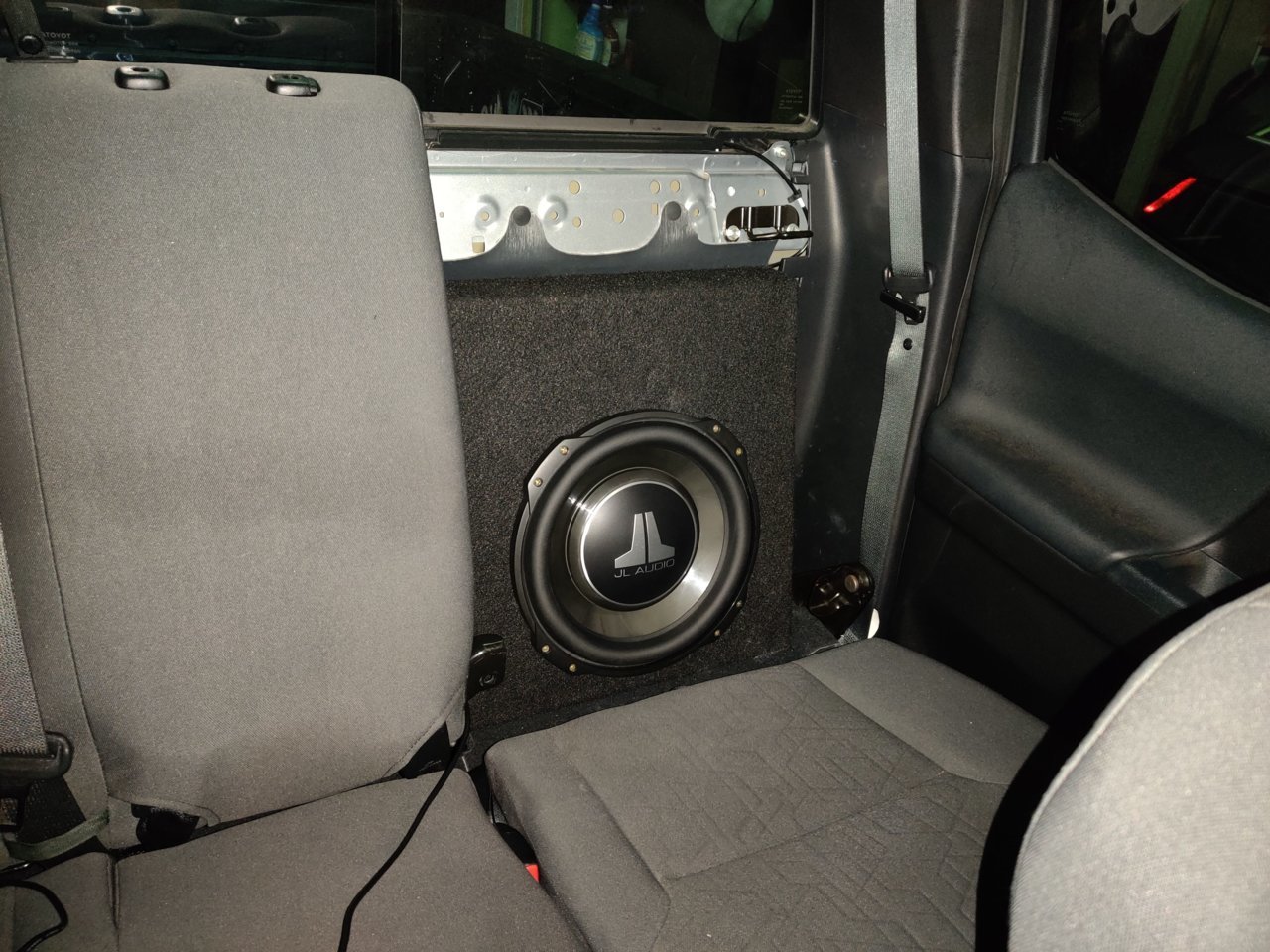

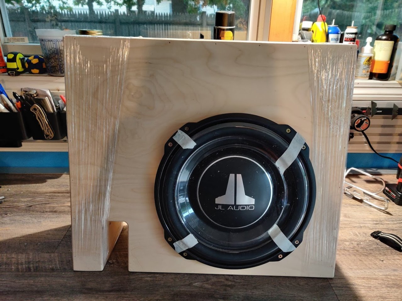

    A bunch of things happened on Friday. First I received my new sub and box:
    Then I had to carpet it:
    I'm getting better at it, but I always end up with a damn wrinkle near the sub opening...
    So I installed and plugged it in. I need to relocate the power wire to the amp, it takes up over a half inch of room, and blocks the sub box from scooching in snug to the rear wall, making it impossible to install the rear seat back without damaging the sub.
    With the seat on:

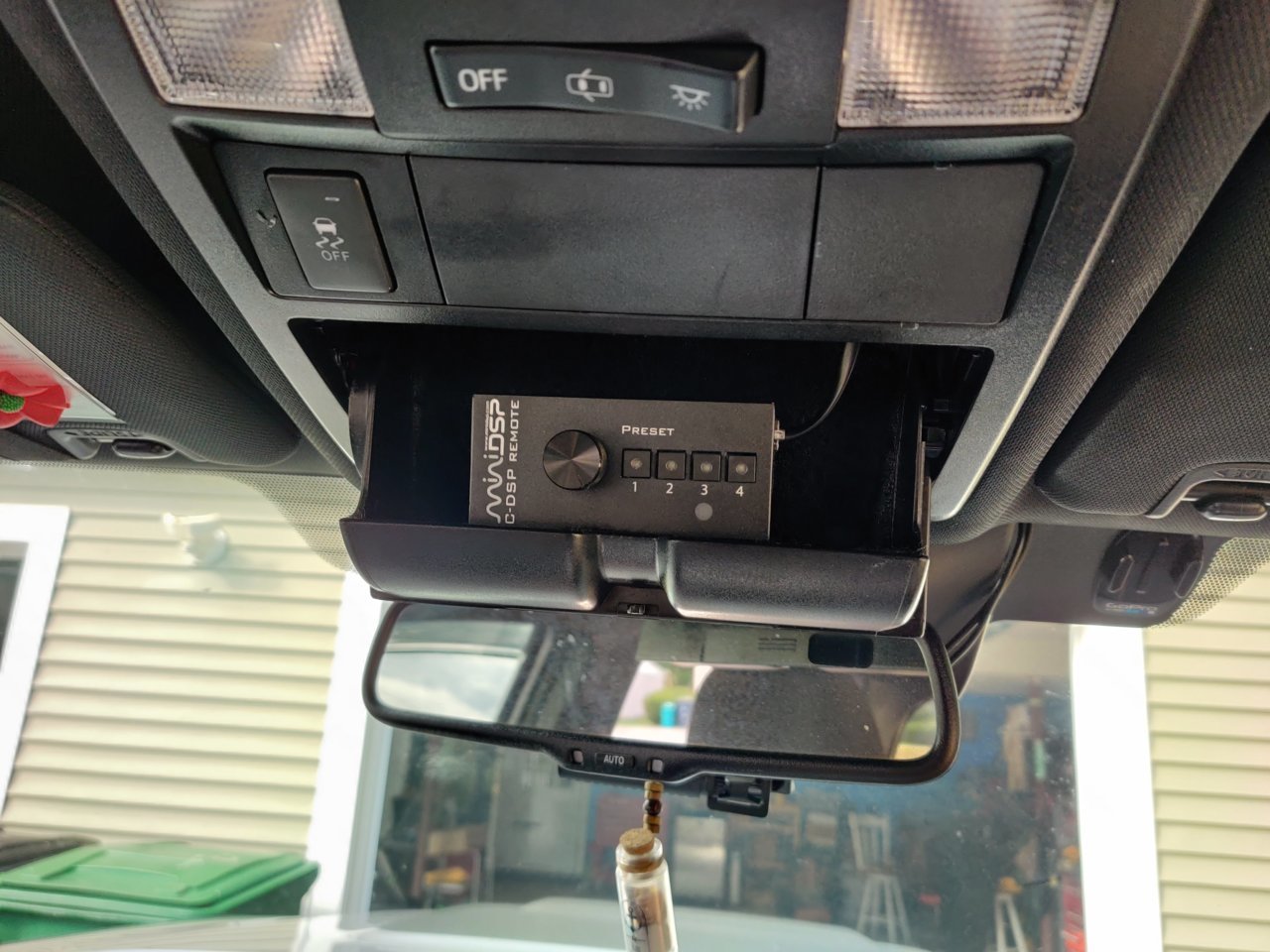

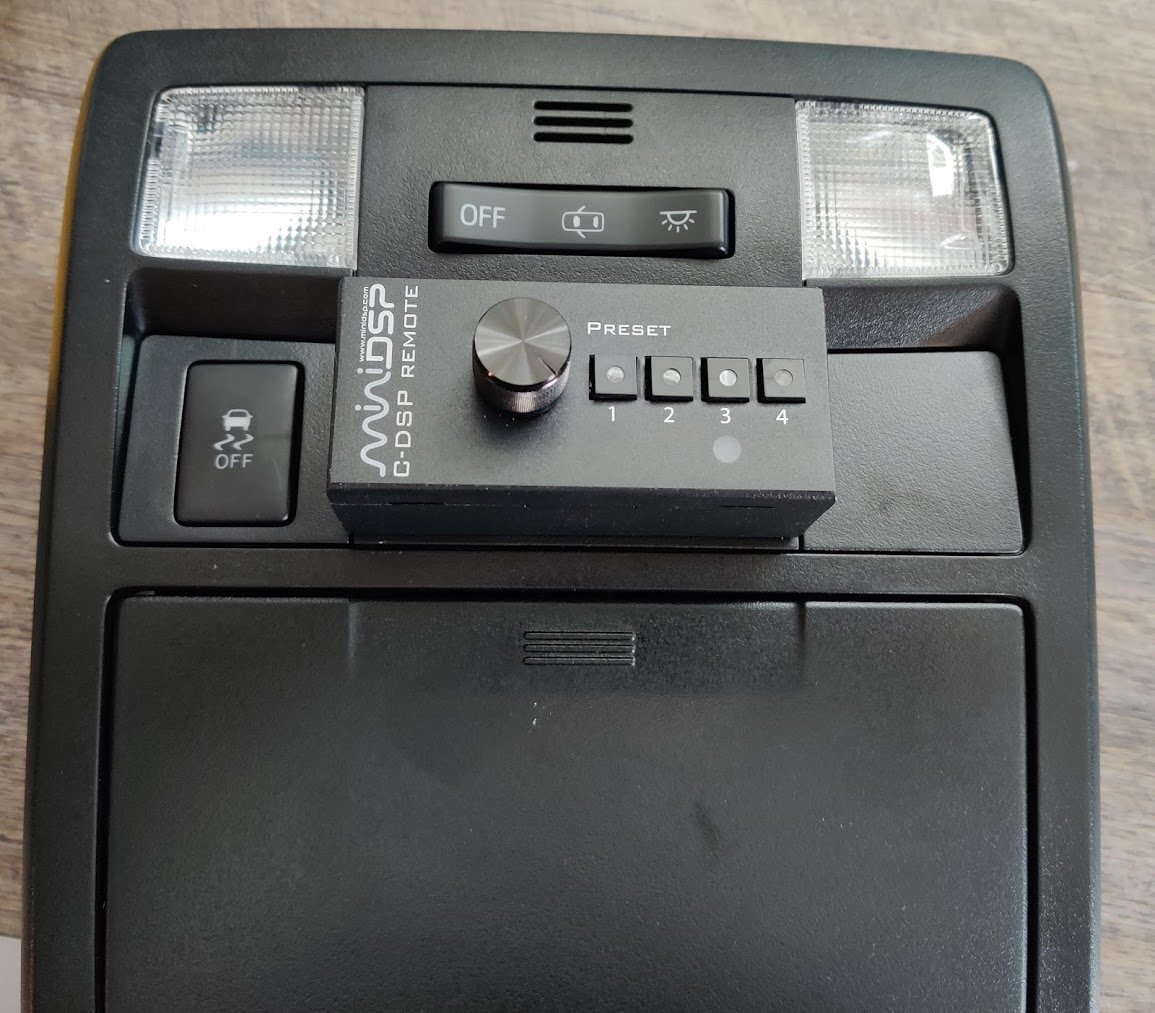

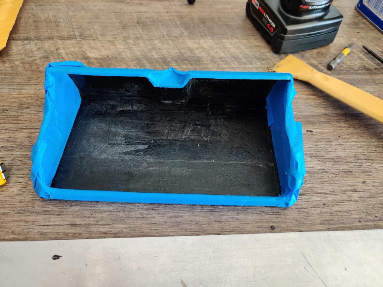

    Next I needed to find a place to put the remote for the DSP. I wasn't going to use it, but I like the idea of switching tunes based on listening position, etc. I wanted to find a way to put it in the overhead console here:
    but the control itself is too deep, and would require more cutting than I was comfortable with. So I decided to use my un-utilized sunglass holder:
    But I had to get rid of the rubber stuff in it. In order to get the remote to hold in their without issues, I carpeted the inside of the cubby in order to velcro the remote in:
    What a pain in the ass this was, and it was not my best work.
