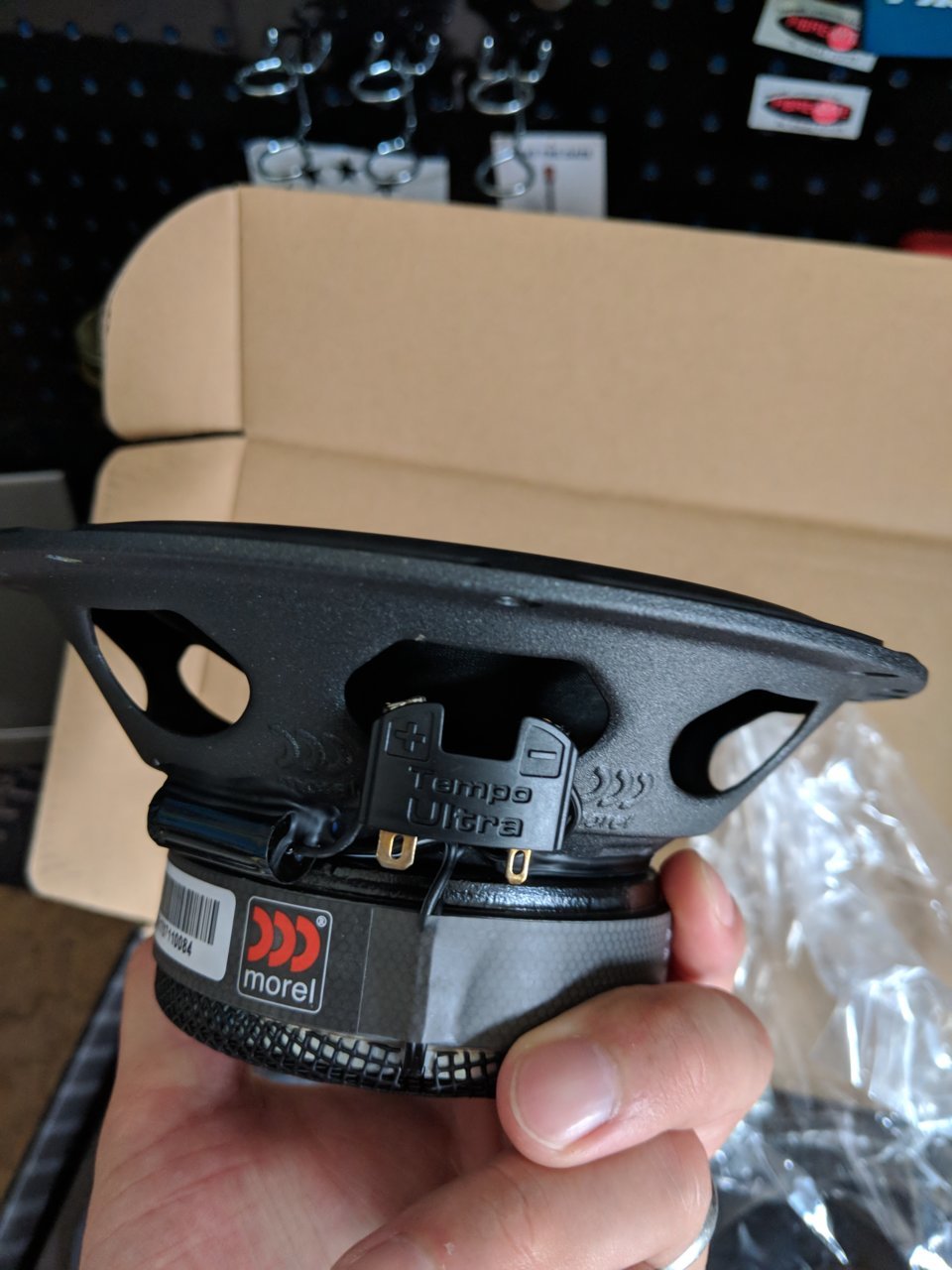

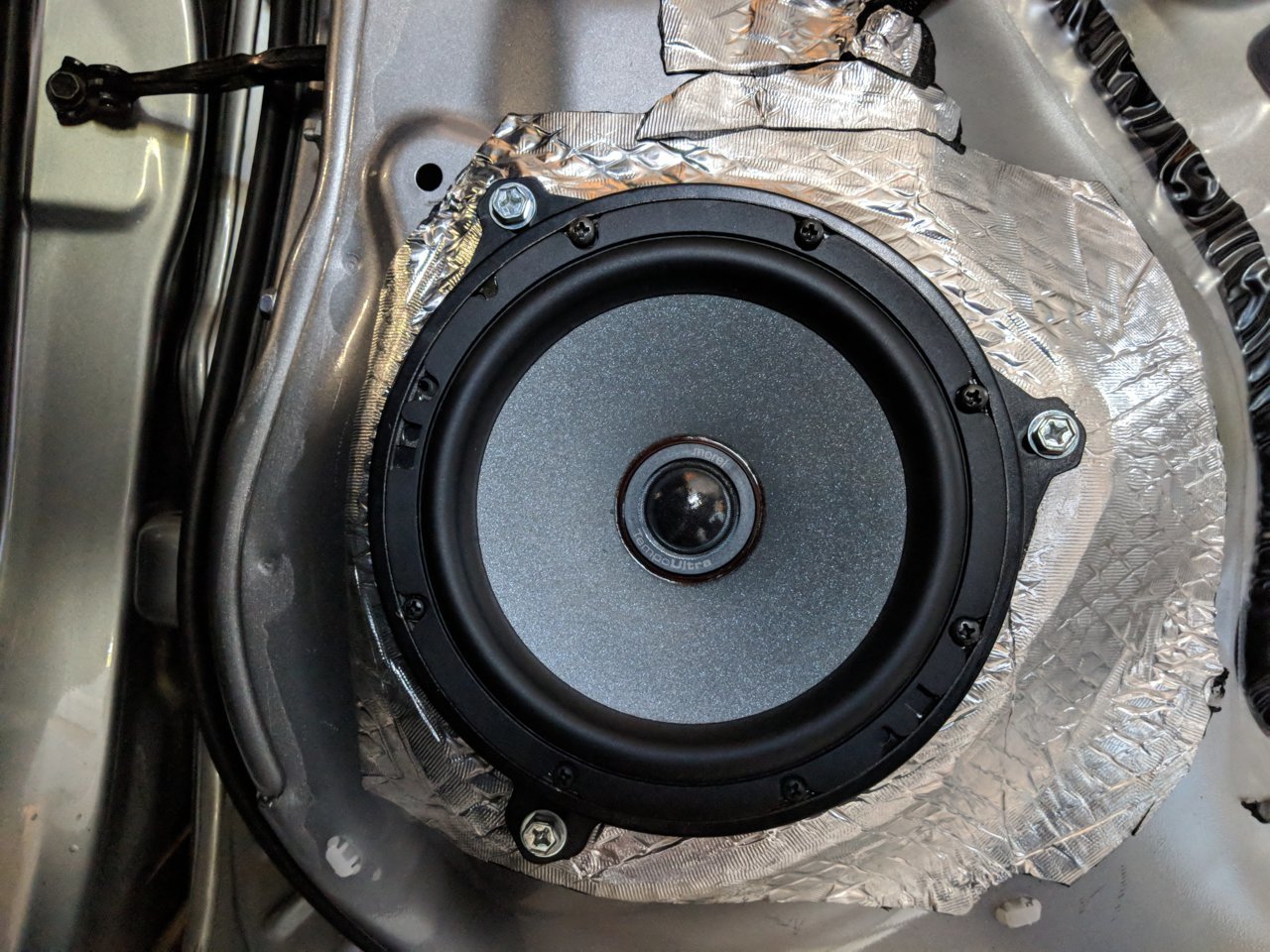

    The Morel Tempo Ultra 692s came in today, so I swapped out my PPI drivers for the Morel drivers. They are not on the proper crossovers yet, so I'm going to be listening low volume until I can figure out where the tweeters are going.
    Drivers
    Comparison
    PPI in door:
    Morel in door:
    You can see in this picture that I put some noico deadener on the surface that the speaker attaches to the adapter.
    Crutchfield's "what fits" guide says these will not fit. They do, and just fine. There is 1 thing I do not like about the Morel drivers so far. I do not like the connection posts at all, and will probably end up soldering wires with bullet connectors. Right now they are hooked up the same way as the PPIs were (using the OEM wiring for the speakers to the amp). When I get a weekend free I'll install the crossovers and run new wires to the doors. Of course a lot of that will depend on figuring out how to make the sail panels without getting pissed off and breaking shit.
    This morning I tested the speakers at what I considered the old middle volume (23) and found the drivers to be a high step up from the PPIs, even when not crossed over properly. I was listening to Umphry Magee's "Death by Stereo" album, and the morels kick amazing. When this gets fully set up with the crossovers, these things are going to be monsters.....

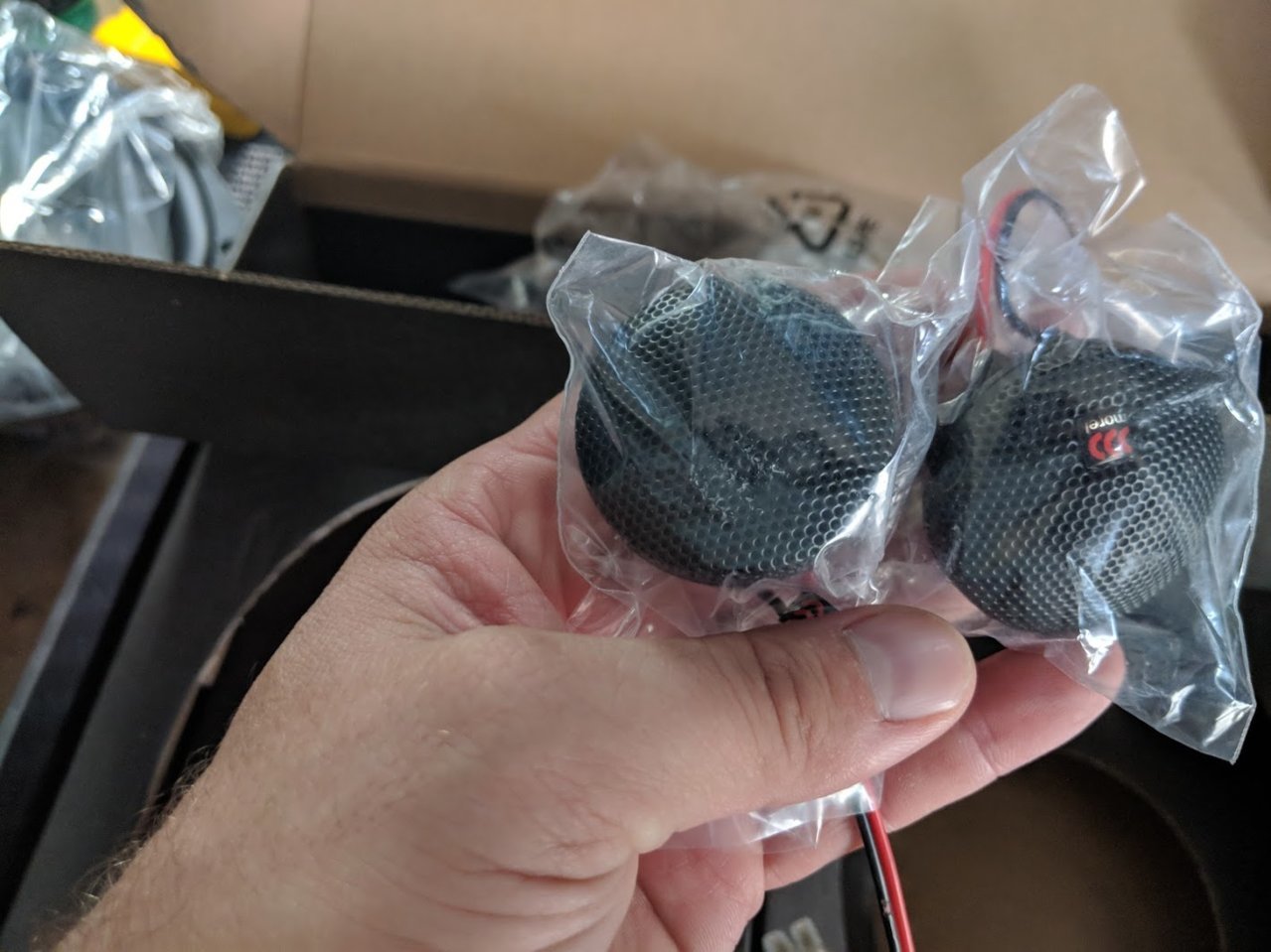

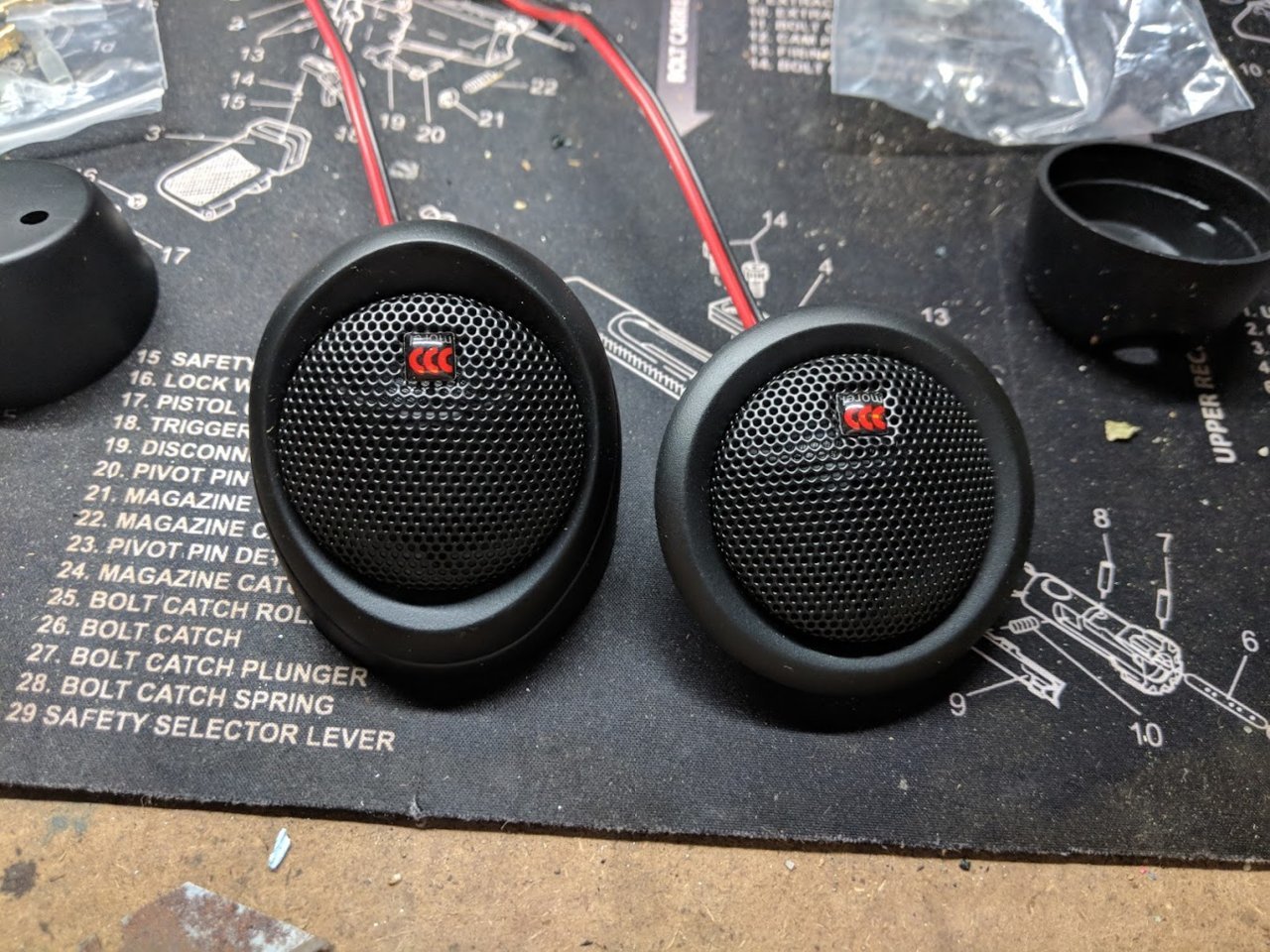

    Tweeters:
    The tweeters come with 3 mounting options, but no swivel mount. I'm going to have to look into finding a swivel mount for them.

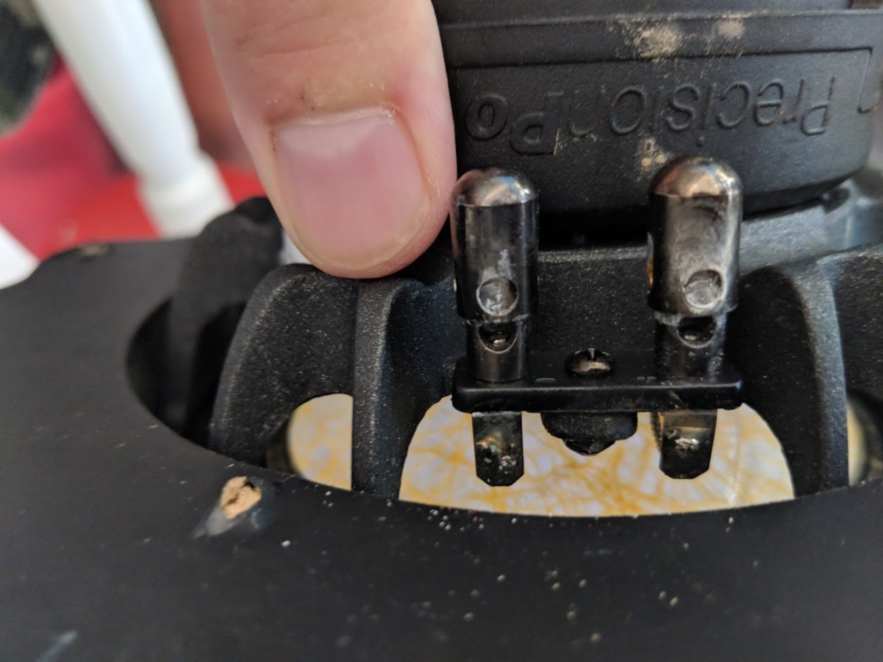

    A quick note about the PPIs: These are great drivers, but they were unmatched by the Kicker drop ins, and needed to be on their proper crossovers, getting at LEAST 200RMS. They were severely underpowered. I have the crossovers and the tweeters from the 3 way kit, and the crossovers will work in just a 2 way configuration, but I'll be honest, I don't like the AMT style of tweeters without the small mid range drivers, and I can't find a set to match.
    Anyway, when I took them out of the door, I found some mild corrosion on the wires:
    Another reason for me to solder the wires to the speakers, then heat shrink to protect the connections......

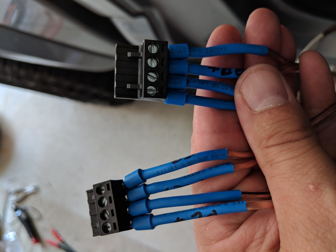

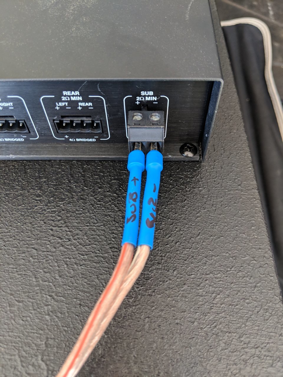

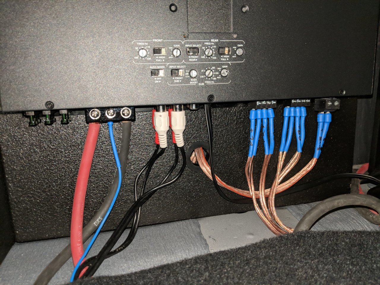

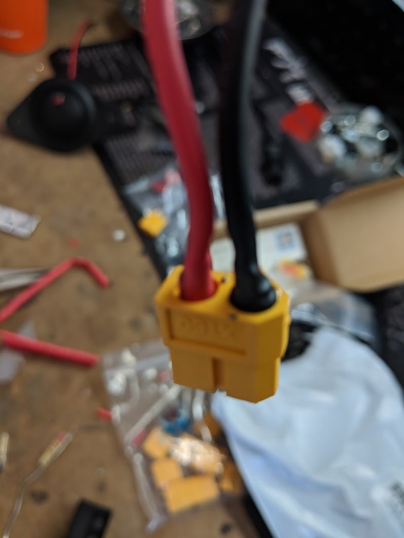

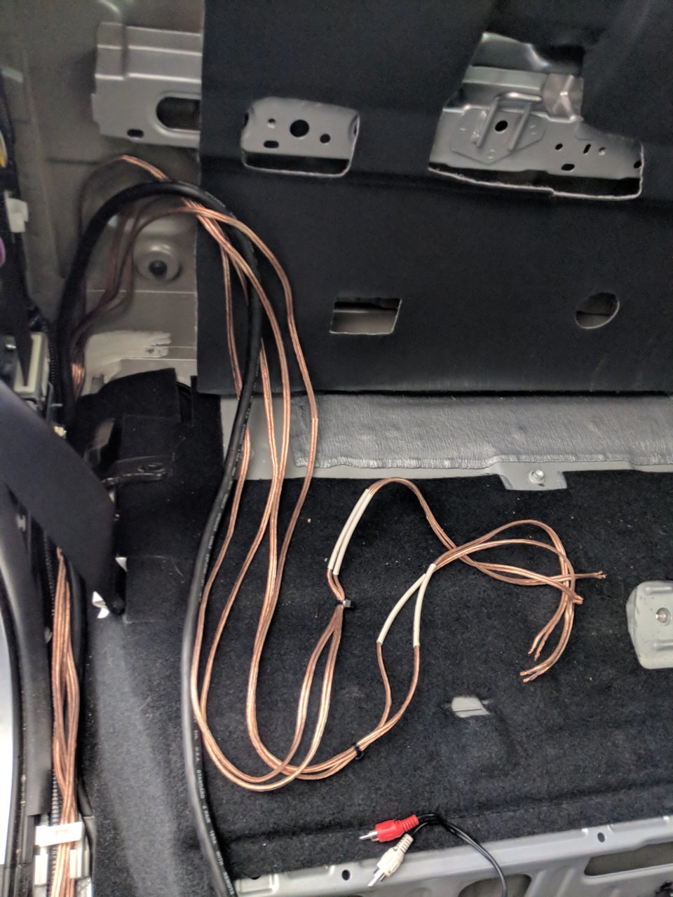

    Clean up! I grabbed some stuff on Amazon to clean up my system and to prep for doing the tweeter / component crossovers.
    Put new teminals at the end of everything
    Ran wires for the crossovers
    Not done yet tonight, more to follow...
    Left the rear seats out so when everything else comes in, I can finish up "quicker". But for some reason, my back up camera is not coming on. The only thing I did to effect (affect?) That was disconnect my neg terminal to my battery when I was doing everything?

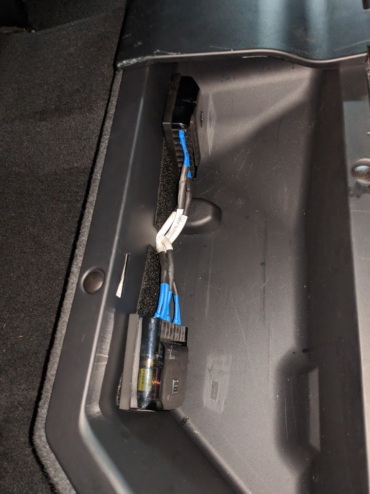

    When I cleaned up the wires last night, I took the seats out (tops and bottoms), took the storage compartment out, took the driver side rear seat cubby out (the passenger side has been out since I put the sub back there), and then removed the panels for the C pillar (is that what it is called? The panel after the rear doors). I disconnected the ground to the battery and went to work.
    When I completed cleaning up all the wires (new terminal ends, new shrink tubing, new routing), I put the C Pillar panels back on, which were a pain in the ass, and I know clips fell, so I need to fix that, then I put the cubby back on, re-installed the under-seat storage. I re-connected the ground to the battery, checked to make sure the audio was working properly, shut it down, and called it a night. I left the seats out because I will be running the wires for the speakers to be on the proper crossovers this week.
    After dinner, I went to Home Depot to get some velcro, and the reverse camera did not engage. I have the Beat Sonic camera on demand, and the button lit up like normal, but nothing on the screen. It just stayed on the audio screen. Even pressing the button for the camera did nothing.
    My question is: is the camera wire in one of those C Pillars? I'm wondering if I might have broken/unplugged a wire by mistake while fucking with those pillar panels. Does anyone know the routing of the reverse camera wire so I can track this nonsense down?

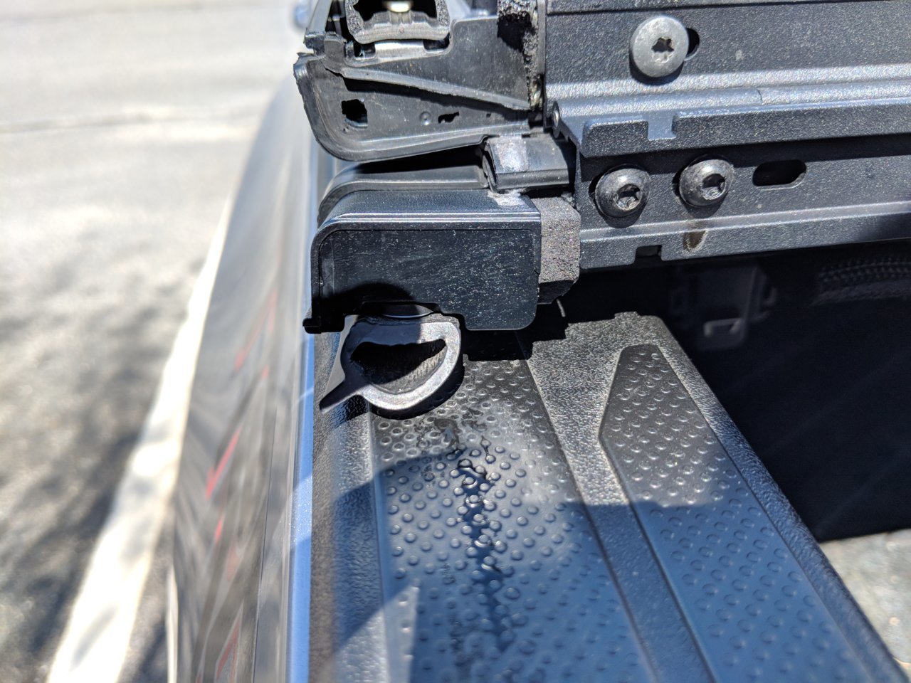

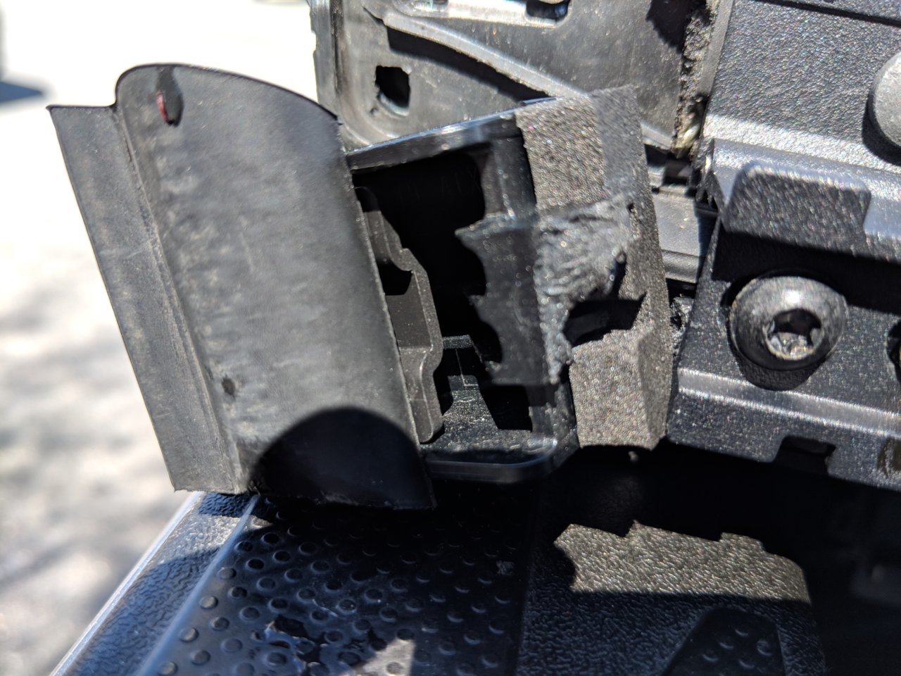

    So last night, I had to get in the bed of the truck. When I shut the tail gate and backed out of my truck, the camera was working. Something is loose at the tailgate causing it to not work randomly. I'll have to get in there and check it out.

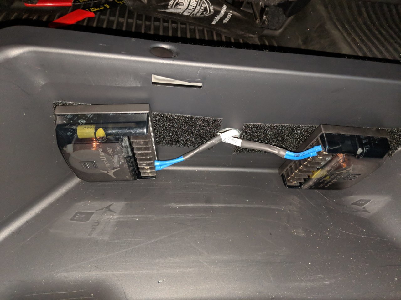

    On another note, I prepped my wiring for the speakers getting hooked up to the crossovers. I'm so ready to get this finished out and finally hear the Morel tweeters under power. The wait is the hardest part at this point. Everything should be in tomorrow. It be cooler if shit came in today though.....

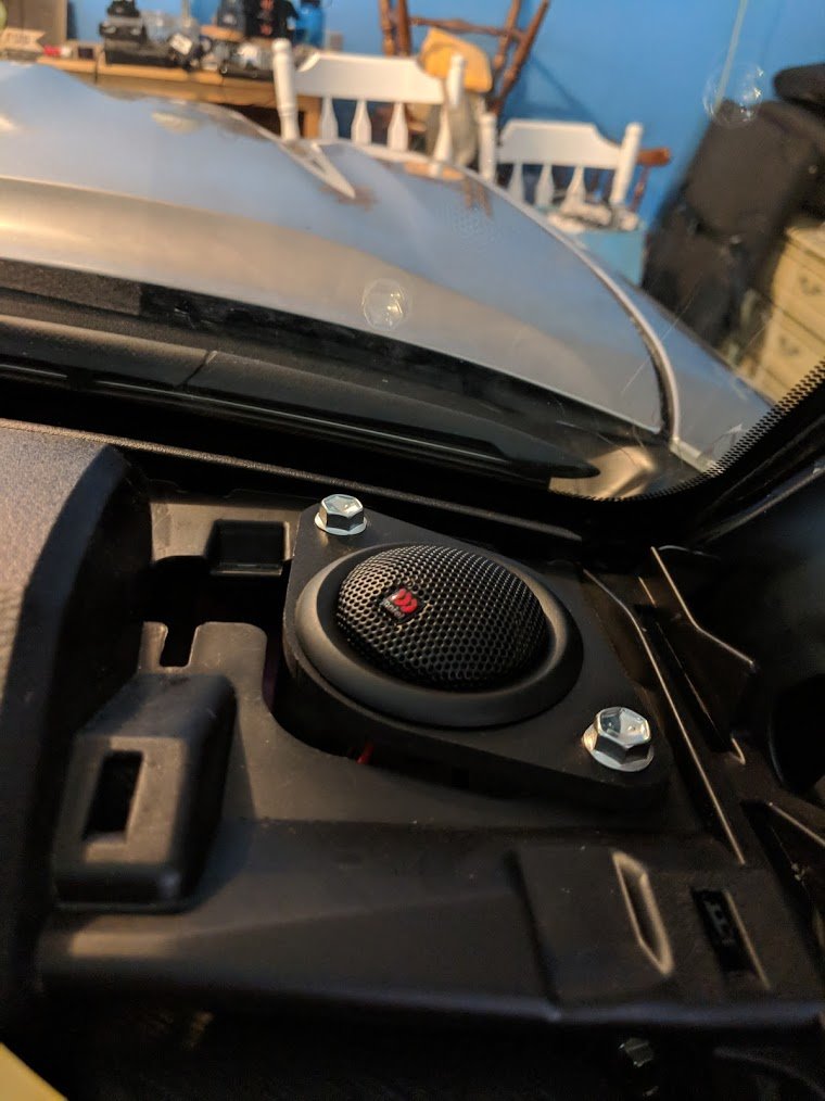

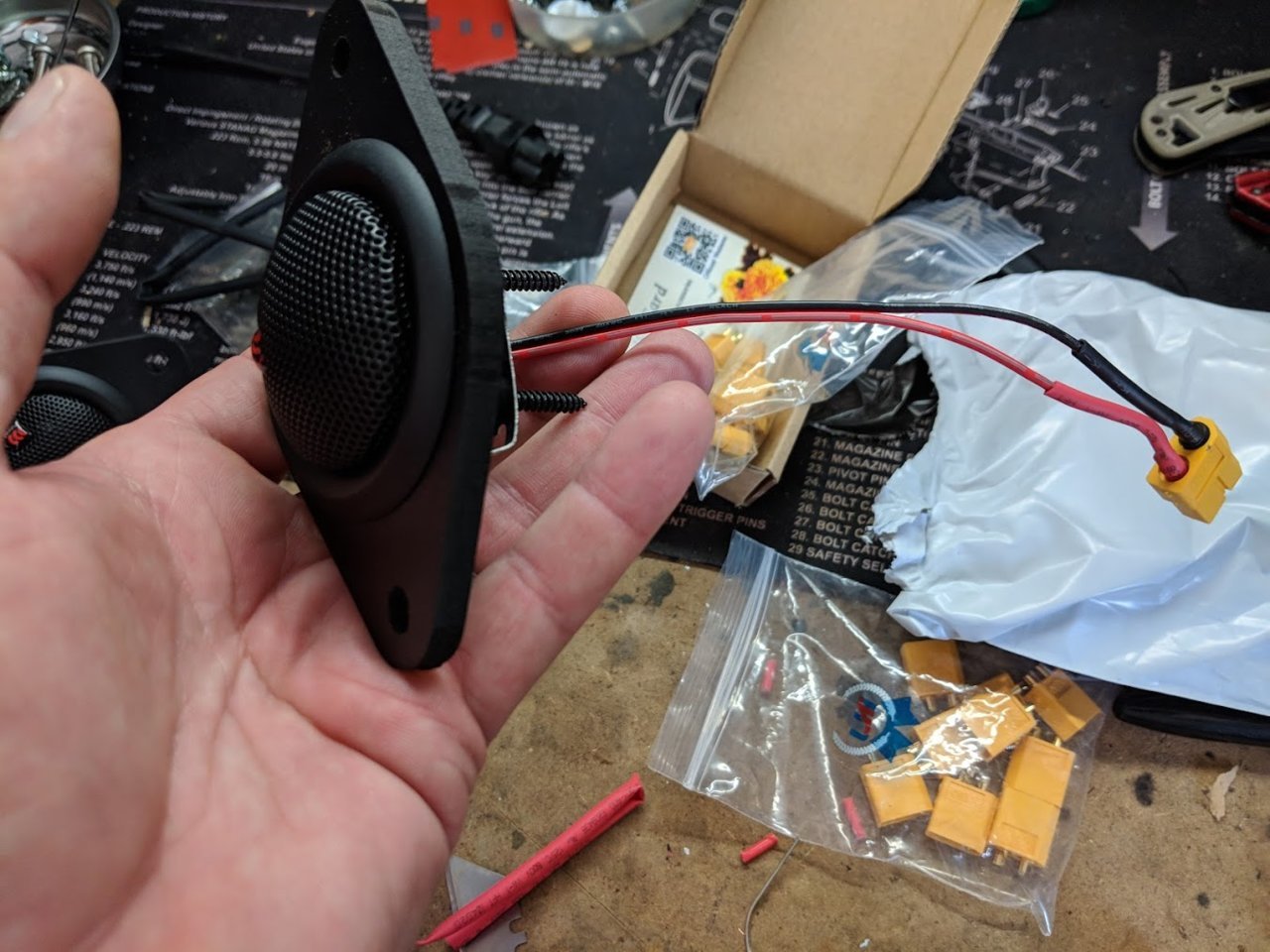

    Audio 24:

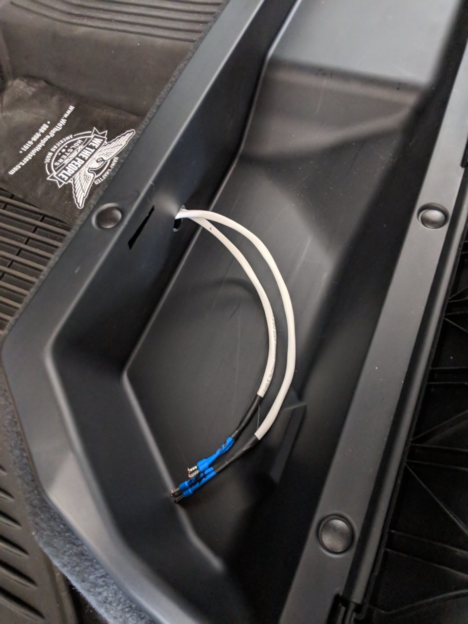

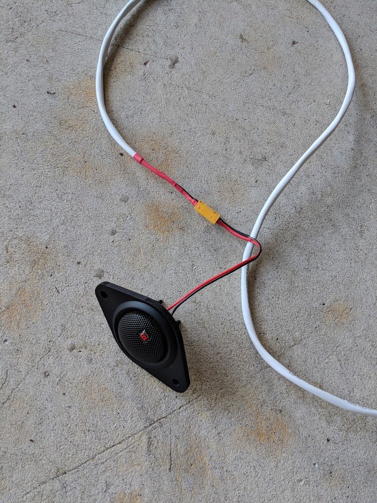

    Last night, the connectors and the adapters for the tweeters came in, and when I got home from work, I got to work soldering the connections for the tweeters.
    I then started on the passenger side, removing all the trim panels, Oh shit handle, a-pillar, etc, and ran the wire down. When that was done, I removed the door panel, took the woofer driver out and ran the woofer wire to the door. This was MUCH easier to do than my Tundra was. The wire boot comes out easily. There are two wire harnesses to unplug, and you can push the boot out from the cab of the truck, then run the wire through a pre-existing hole in the boot, and into the door. Run all the wires back through the hole in the cab, plug in the harnesses and away you go. I didn't take pictures of that though. Next time I have the kick panels off, I'll try to remember to do that.
    All in all, running all the wires and installing the tweeters took around 3 hours of taking my time, taking water breaks (it was hot AF in my garage), and finding misplaced tools.
    With the crimp on connections I used, as well as proper labeling, hooking up the crossovers was a breeze
    When I was all wrapped up and before putting the door panels back on, I took the truck to the parking lot down the street and did a function check on the speakers, making sure each channel was functioning properly (left was actually left, etc). All was good, so I went back to the garage and buttoned things up.
    This morning I did sound checks with a few different styles of music to make sure I had my sound settings good to go. I actually turned up the mid-range by 1 tic, and played with the treble until I ended up 1 tic higher than I was at. I started at a volume level of 25, and moved up by increments of 5 until 40 (almost ear splitting for me). The speakers really really open up right around 32 on up.

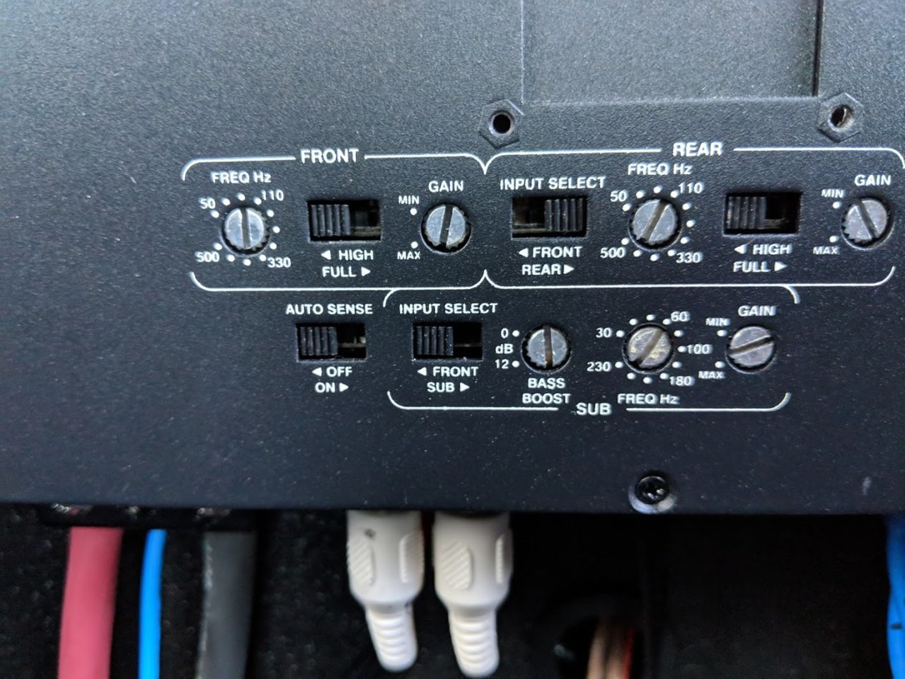

    The woofers have been breaking in for the last couple of weeks (days?) and are flexing really nice with rich full bass. I have the high pass for the fronts set at 90 so I'm not overwhelming the woofer drivers in the door, but it sounds great right there. The tweeters are plugged into the +2dB attenuation slots, and sound pretty good there so far. I'm not sure if tweeters need the same sort of responsible breaking in period, so I'm going to take it easy on them. But they are clear with great sound reproduction. I did not reset the gains at all, as I tuned the amp with an oscilloscope to match the input of the head unit.

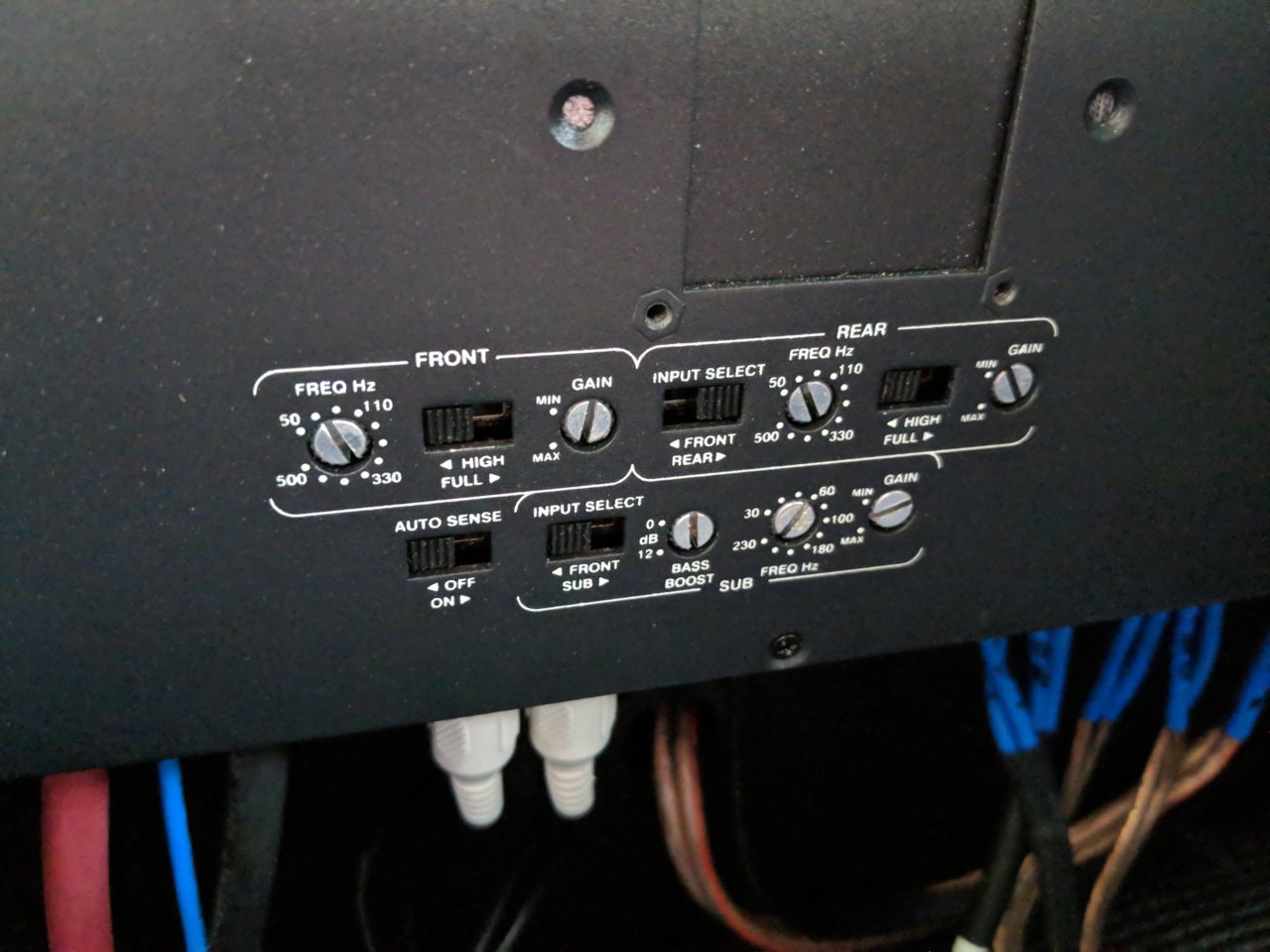

    One thing I do need to adjust on the amp is the rear high pass setting. Right now it is set at 110 (ish, more like 108 or something, see picture). The kickers in the rear doors sound almost tinny and flat compared to the fronts, and I need to get just a little more bass to them.
    I'm very happy about the sound in the truck right now. Some minor tweeking of the amp aside (I might go a smidge lower on the front woofers on the high pass), I am rolling in the right direction.

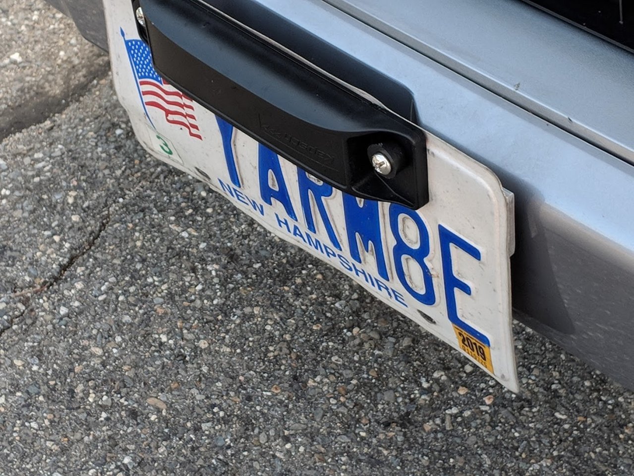

    I forgot to add this tidbit!
    Stealth license plate mount
    I need to clean up where the original mount was, so dirty.....

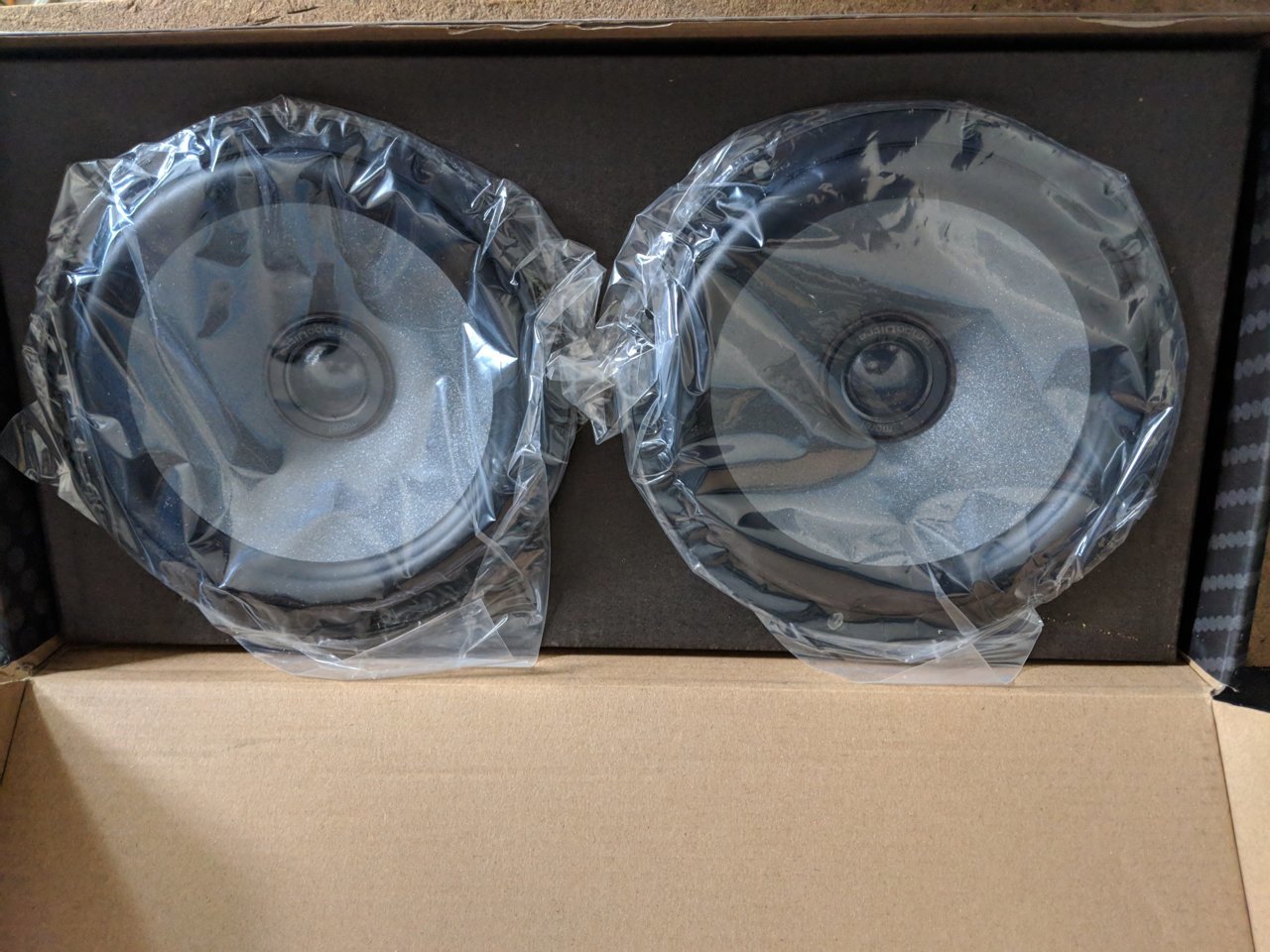

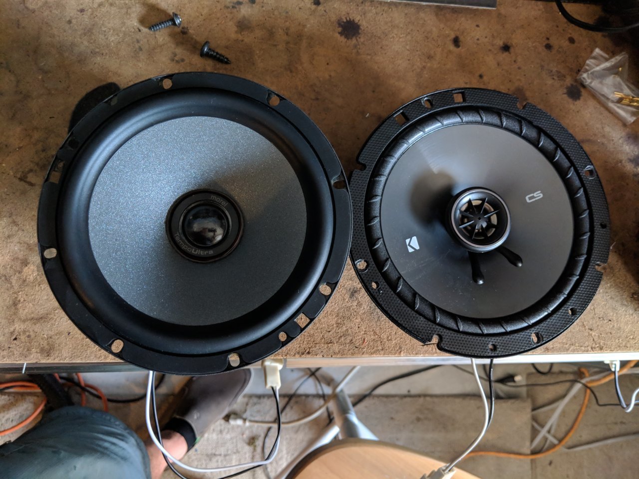

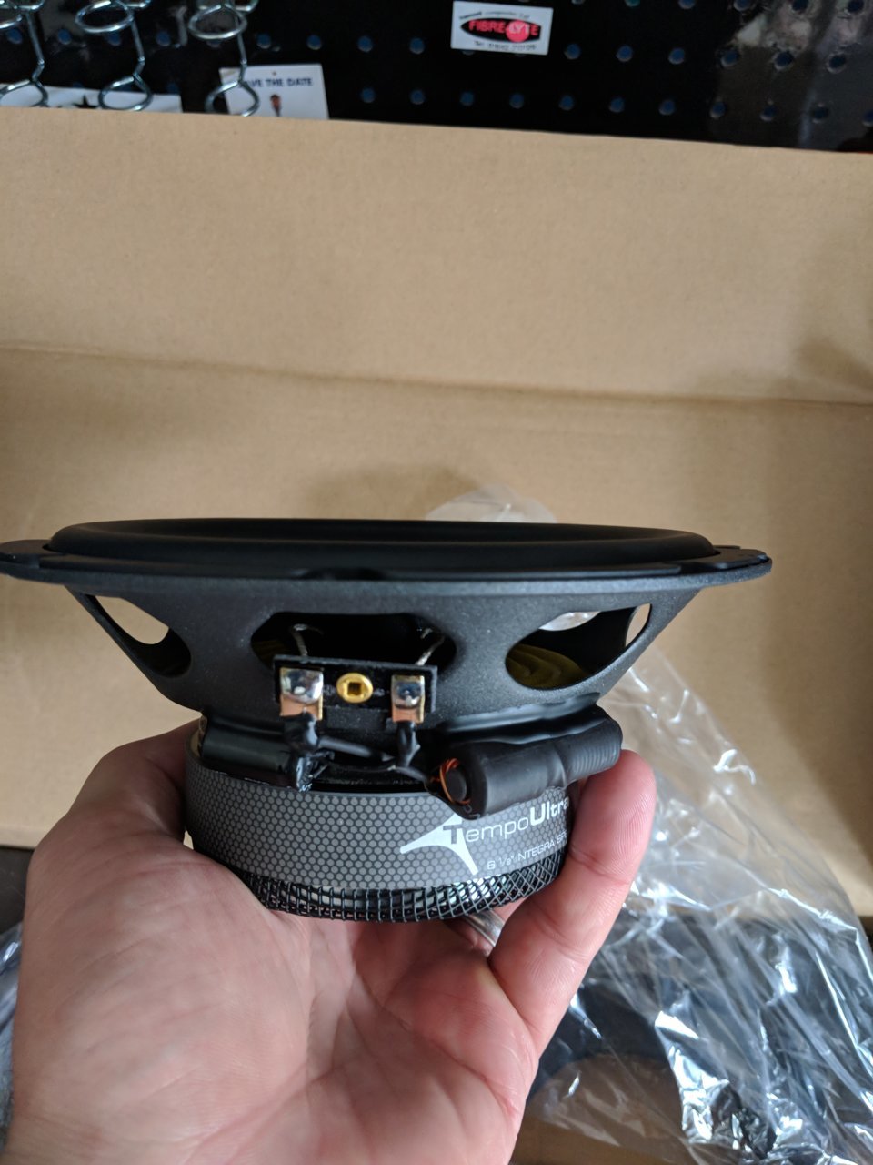

    The Morel Tempo Ultra 602 Integras came in today, so I did a pit crew change out. I'm getting really friggen good at getting the panels off at this point.

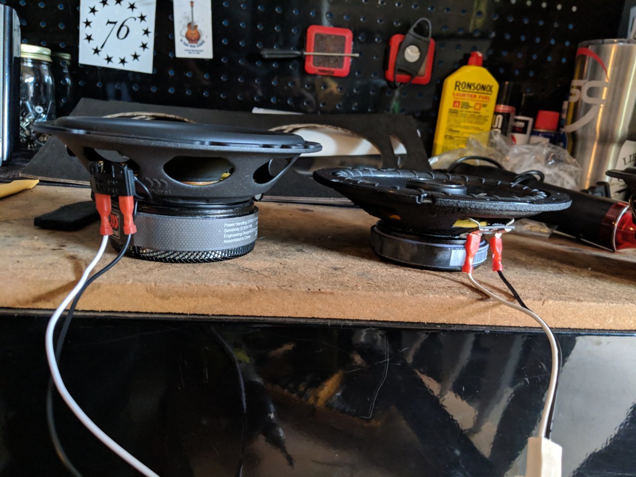

    Anyhow, here is a side by side of the Morels and the Kickers. Please note that the Kickers are the 6.75" coaxials, and the Morels are 6.5" coaxials.
    Unboxing:
    The speakers have soldered in resister style crossovers to protect the speakers from going too high on the woofer or too low on the tweeter.
    The terminals in my opinion should be more robust for a $269 pair of coaxials
    Side by side comparison
    Look at the size of that magnet on the Morels!
    And we're installed:
    Right at this moment, I am not getting full range of these speakers. I have my high pass set at 110-ish Hertz, and will leave them like that for one month for responsible break in. Then I will probably set the rears to "full", or at the very least down to 60-ish.

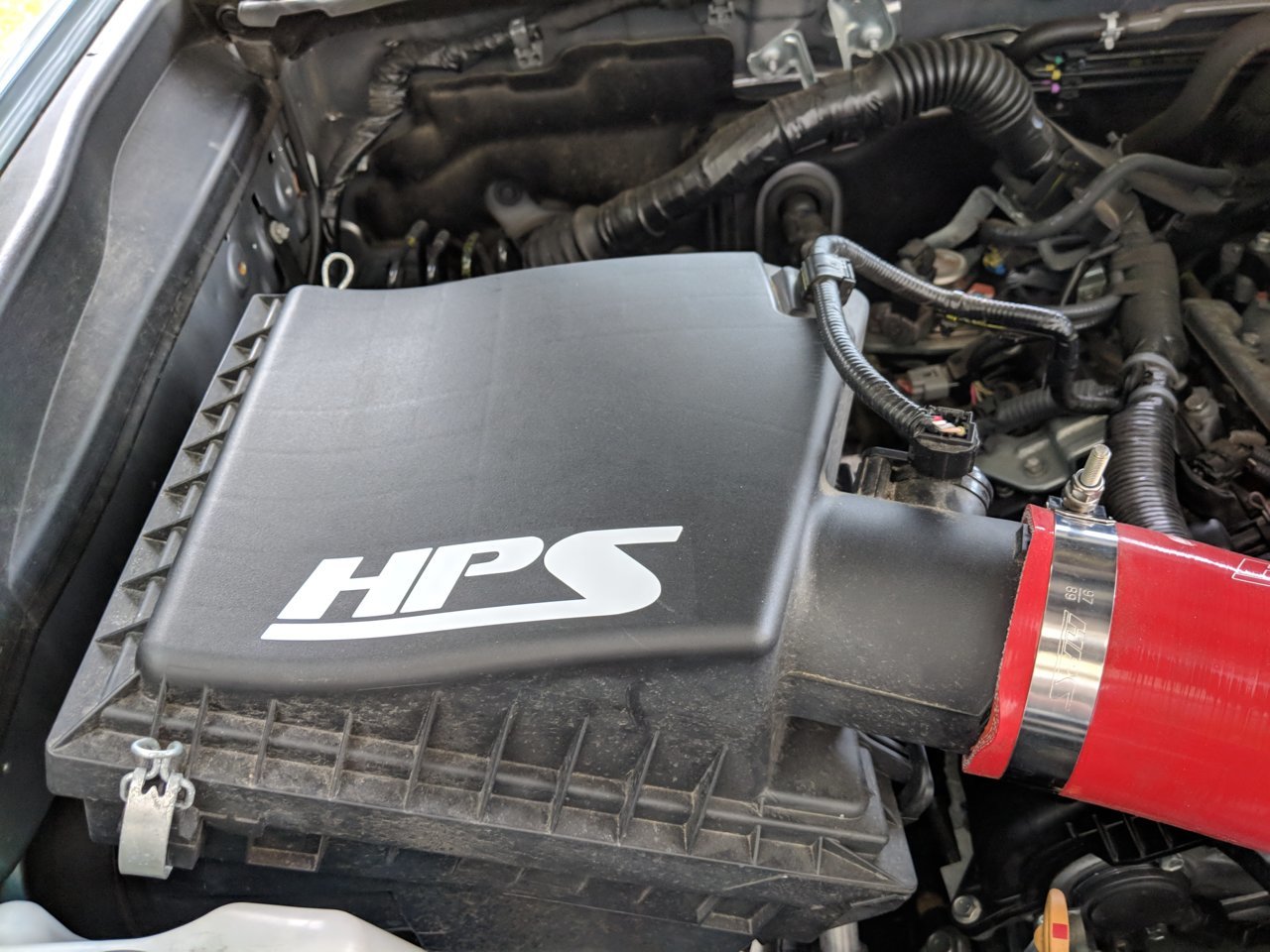

    2. Ordered one of those HPS intake hoses in red, because why the fuck not, and I had a coupon.

    I needed one ricey looking thing under the hood
    Mission accomplished. Easy quick install.
    I had already installed the "TRD accelerator" a few weeks ago. Let's see what this does to my gas data...
