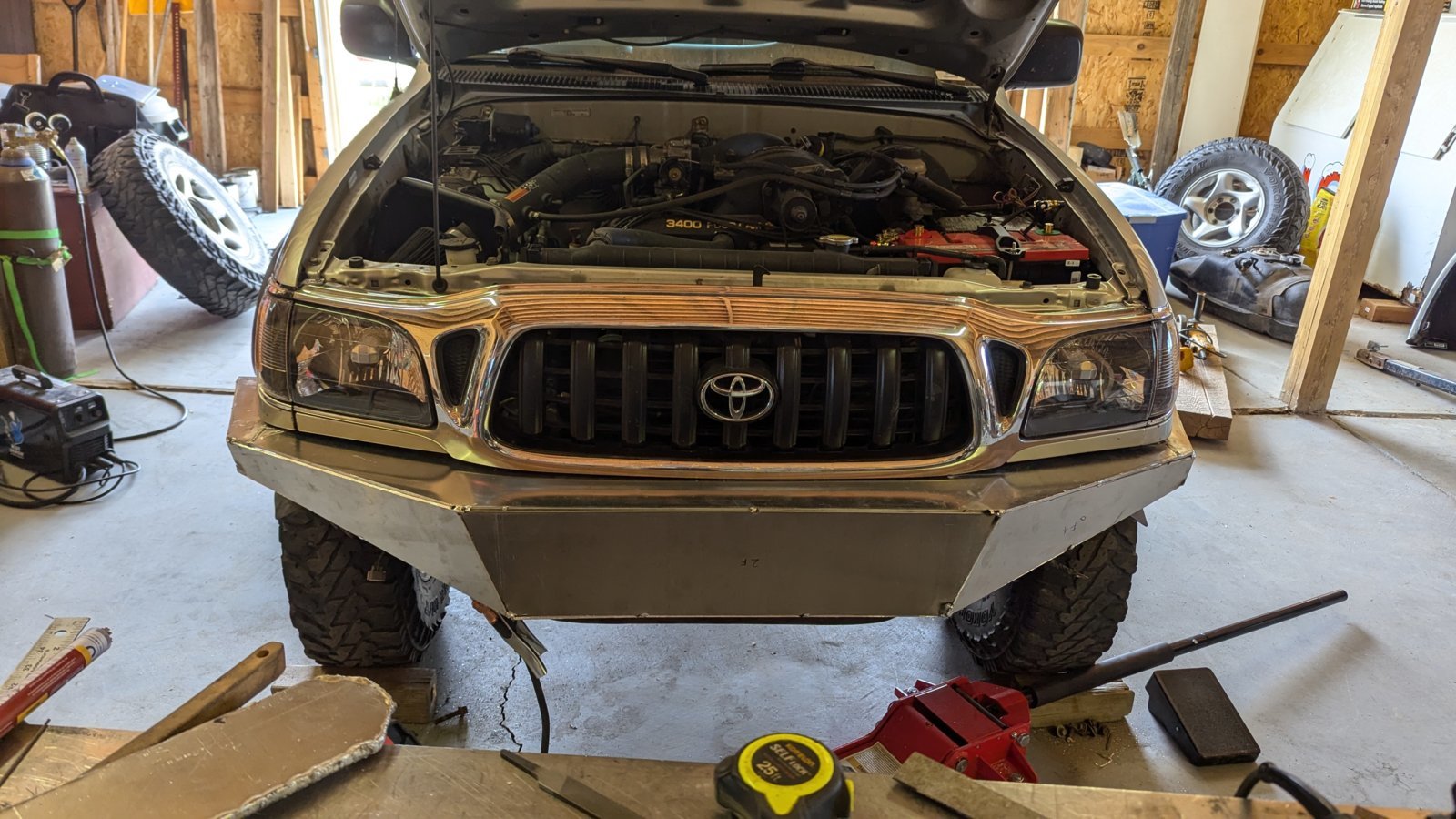

    Here's the front all tacked up:

    Looks like either Raptor Liner or Monstaliner is going to get the nod for this project. The truck is a hunting truck so it doesn't see the abuse of a dedicated wheeling rig, hence the aluminum vs steel armor. All of the fab and welding should be done Wednesday, it will all get installed sometime in August. More pics to come once everything is on the truck.

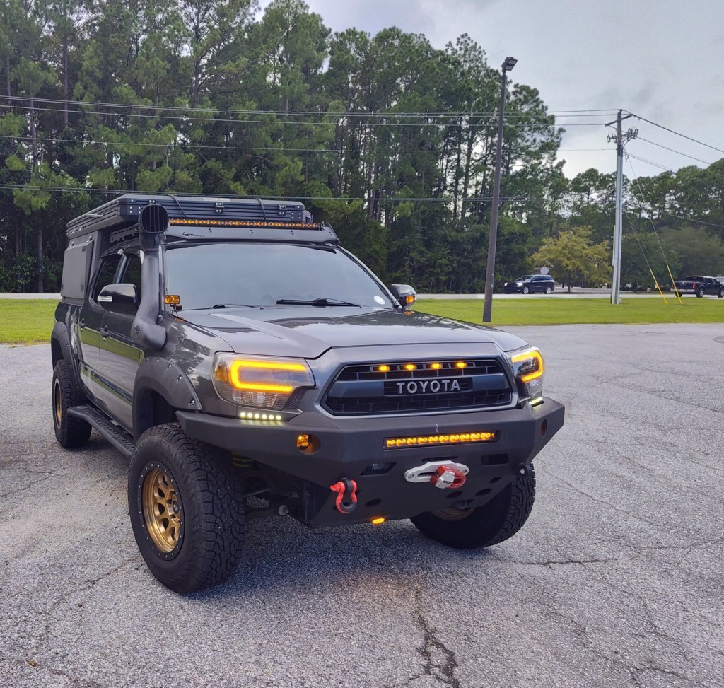

    My Pelfreybilt aluminum bumper is coated in Line-X. My fenders are in Bullet Liner. Both have been great.
