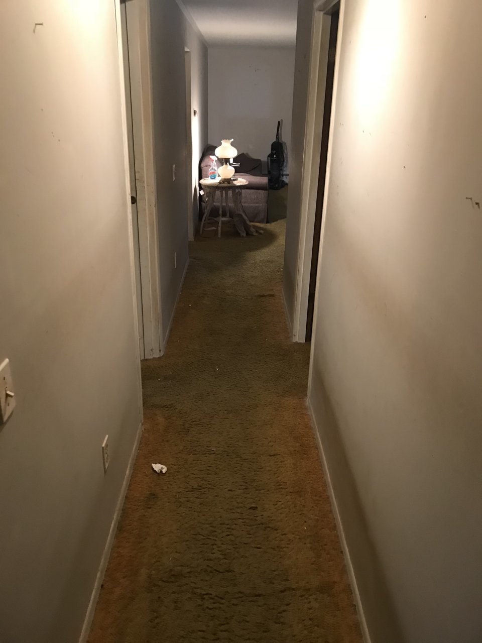

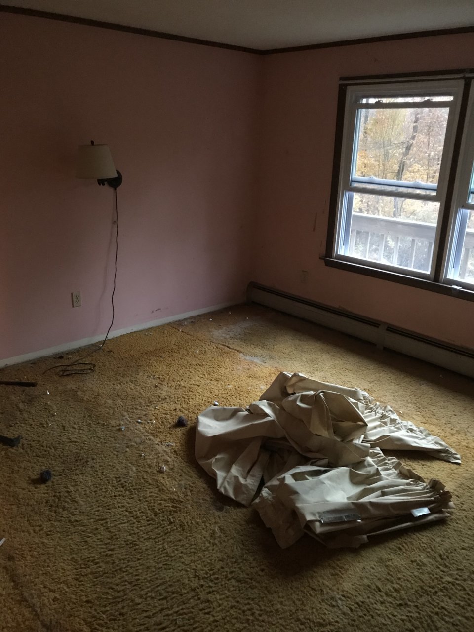

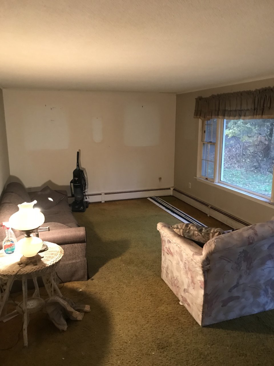

    This should be up your alley. And anyone else interested lol. Some before and afters. I still gotta install some high hats in the living room and get rid of the stupid lamp
    Disclaimer* don’t panic, those are my couches, I’m not keeping some late 70’s who knows what’s on them things. I just moved them before I took the first pics lol
    Bedroom
    AFCABD87-EA59-45C6-804B-CEE4AC247B9B.jpg CBE59377-8D7A-4041-B0A8-8BA11F4CEA74.jpg
    Hallway
    F40BC787-E0B3-44D7-BE21-EA9C62554C6B.jpg 562949FE-F9BE-42DF-8E2E-AC4A3D367EDD.jpg
    Living room
    CA43F170-6C66-419E-884C-287C79BFB127.jpg FA2116AB-7FE5-4676-B51C-2B1976879891.jpg

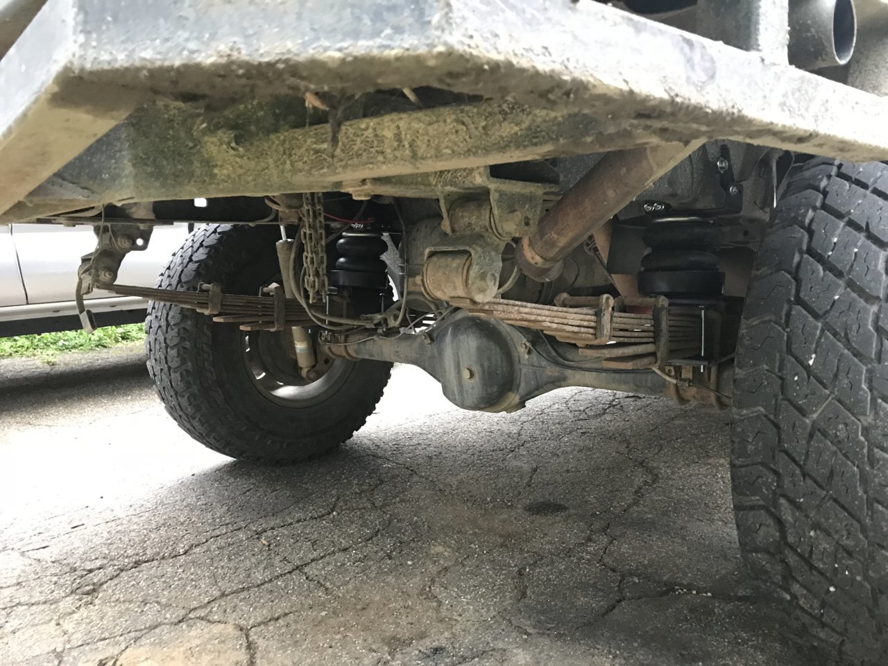

    Ah almost forgot. I copied the setup we did on @Chux rig and I threw a set of airbags under the back of mine. Not gonna go full write up, basically followed the instructions they came with aside from adding the thickness of the leaf packs to the lower support plates and using the daystar cradles on the bottom other than bolting the bottoms like intended. Then I ran the hoses up and put the schrader valves inside the driver side bed cubby. I was gonna T the hoses together so both bags could be adjusted at the same time but someone in another thread (can’t give credit, I forget who it was) brought up the fact that when the bags are T’d when you go around turns the weights of the truck will push air from one back to the other. So basically if they are set to 10 psi one bag will go to 0 and the other 20, basically defeating the purpose of the bags and it won’t support the weight.
    All said and done one of my favorite mods. Truck feels much more stable on the highway and rides much better not constantly slamming the bump stops. Also helps a lot doing side work hauling loads of logs. Then at the trail head I can air them down with the tires and it doesn’t limit suspension travel.

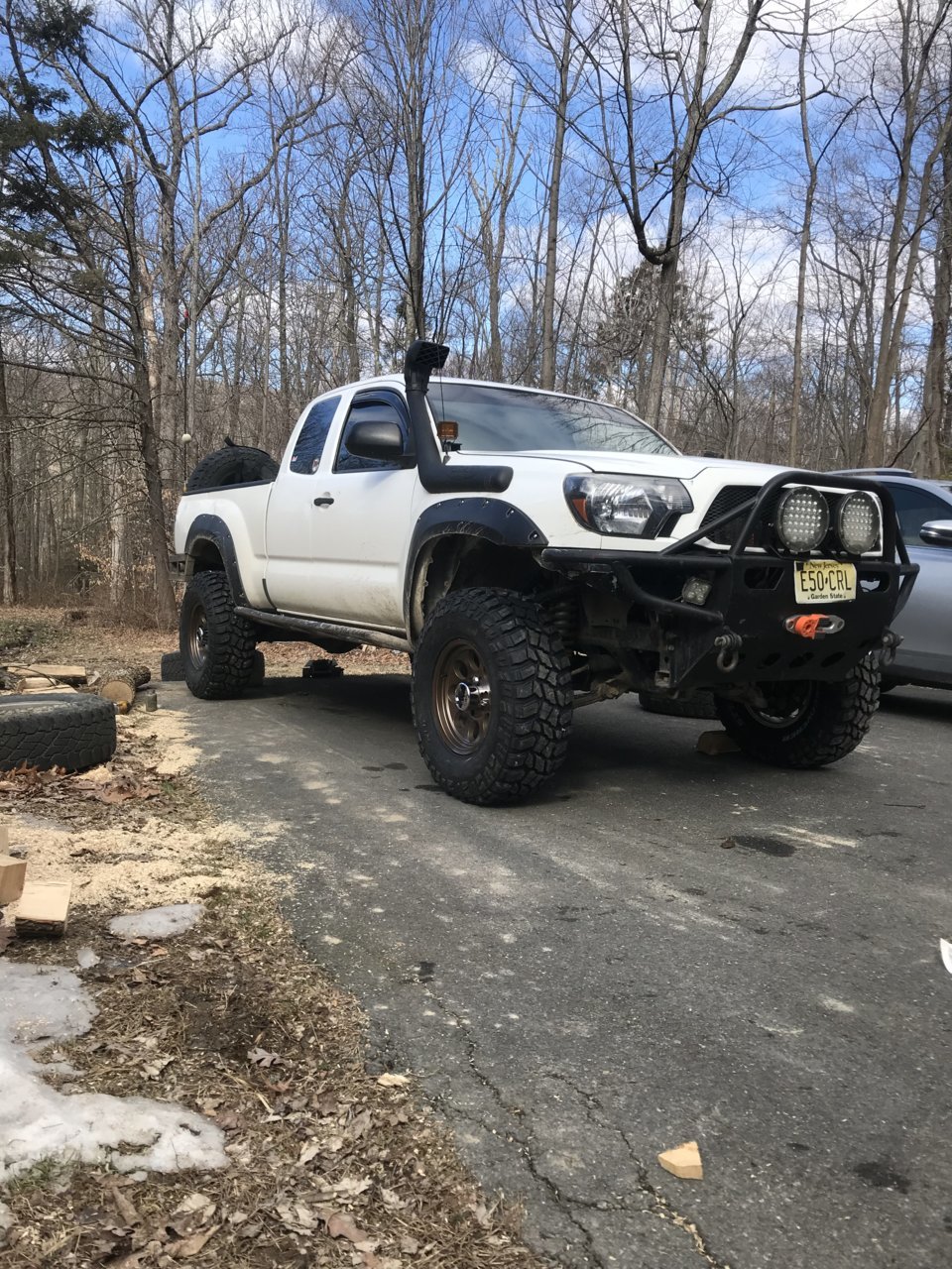

    Man... This St Maxx look like a baby next to that giant Stt Pro

    yea it’s pretty crazy lol and it’s not even an all mighty 35. The maxx is a 255/85-16 and measures 32.5 new. I’d imagine it’s less now being worn down. The stt pro is a 285/75-16 and measures a true 33”. I believe with the tape it was 33 1/4”

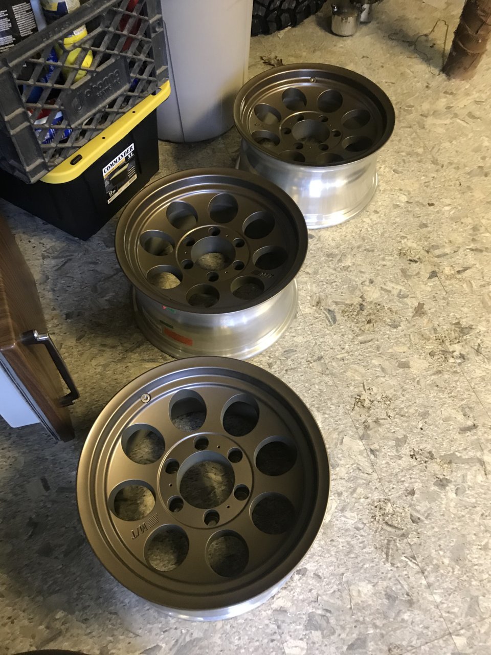

    Left work early today. Weather was too nice too nice to stay there. Got this done as well, no worries there are actually 4 of them lol. Just need to let them sit and cure and resist the urge to mount the tires right this second
