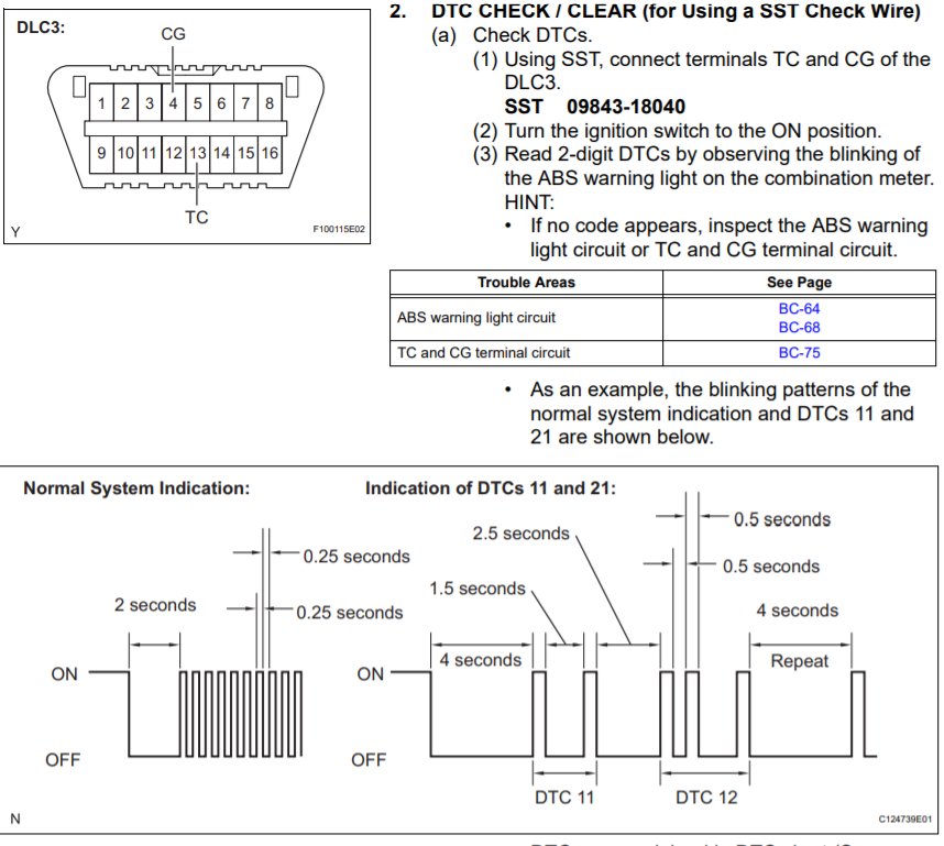

    Thanks, correct, drivers side rear & the old one, of course dirty on the outside, the inside looked brand new dry & shiny just like the new one. I do understand it could still be a wire or connector that looks good or possibly one somewhere you can't even see. I had found 2 places that told how to ck the sensors, one said it should read between 450 & 2200 ohm & the other said from 500 to 2500 ohm. Really feeling, by my old one being 319 ohm., good chance it is fixed. A little confused by post #4 instructions. it says with his jump wire method, there will be code ###'s flashing but doesn't say where they will be located or what they mean. What if my jump wire hits the wrong contact in that little plug? He says touch pins #4 & #13, what if I accidently hit the wrong pin??? Kind'f afraid I could easily screw up the whole computer things & I know that stuff is really EXPENSIVE. If I get to town, will most mechanics have the tools to reset the ABS lights or will one be pretty hard to find? I "AM NOT" not going to a Toyota dealer, that is out, I'll just drive it with the lights on. I appreciate your time.

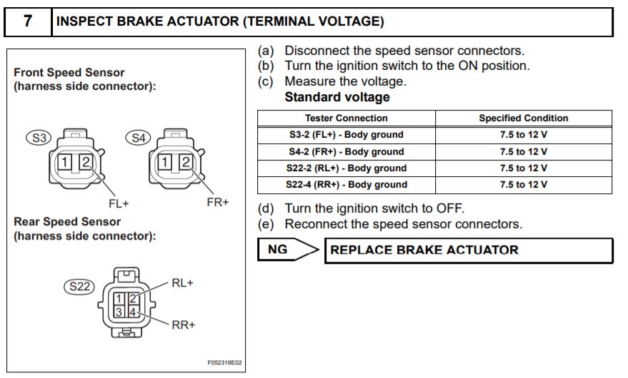

    Herculiner Hootus

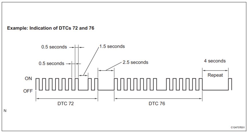

    I don't know what the ohm reading should be, I've never seen toyota give a specification for that so I'd be lying if I told you I knew what was acceptable or not. I've always just checked for voltage at the connector, and if I had that I would check the wave form using my scan tool. The tools these days are cheap, I have this one and it's more than paid for itself. If you are nervous about shorting the wrong pin, used a switched jumper. The codes are the frequency of the ABS light blinking on the gauge cluster.

    Thanks T444E, I can unplug & check to see if leads show between 7.5V & 12 V, should be pretty straight forward.... I punched on that Foxwell scan tool & was completely lost, EOBD, SAS, not a clue what that is, ABS & AIRBAG I knew what it was till I saw it said Brake Bleed Scan Tool, Just can't imagine this thing bleeding the brakes. I recognize it's My fault cause I've just refused to try & learn all this new electronic stuff, Too late in life, heck I can barely remember the old stuff. I'll ck. the V & see what's there. Thanks.

    first and foremost before buying a speed sensor and replacing it, i would suggest in removing the sensor to clean out any grease/debris that may be on it. You'll be surprised at how much is/will have accumulated on it. After reinstalling the sensor and if the cleaning does the trick, the ligt will turnoff/ reset itself after a very short test drive, or you can manually reset it yourself with a jumper wire.
    all you need is a 10mm box end wrench or socket to remove the sensor, a pocket sized screwdriver is also recommended to undo the connector harness at the speed sensor. I would also suggest spray WD-40 on the connector prior to removal.
    you can easily check for ABS codes or clear the ABS light yourself by using a jumper wire and deciphering the blinking ABS light on the dash..
