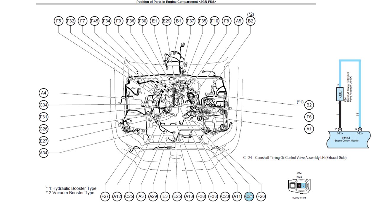

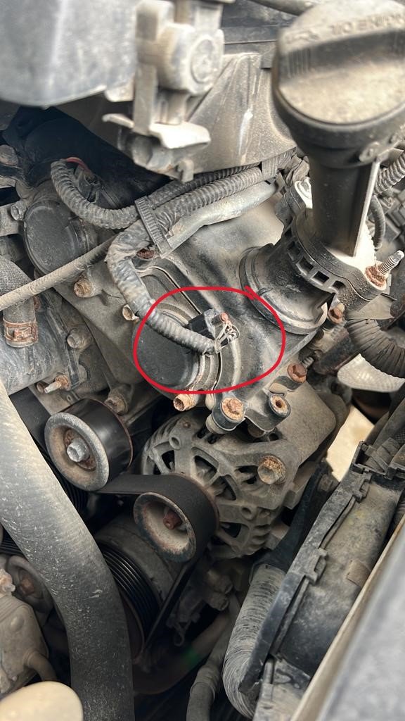

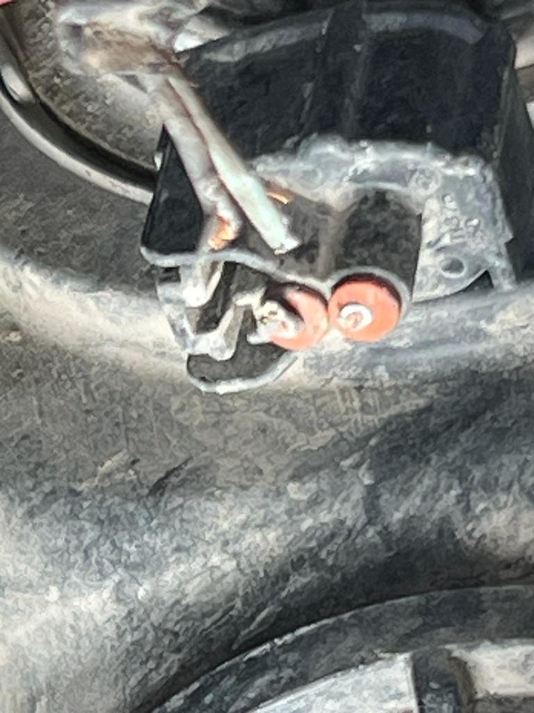

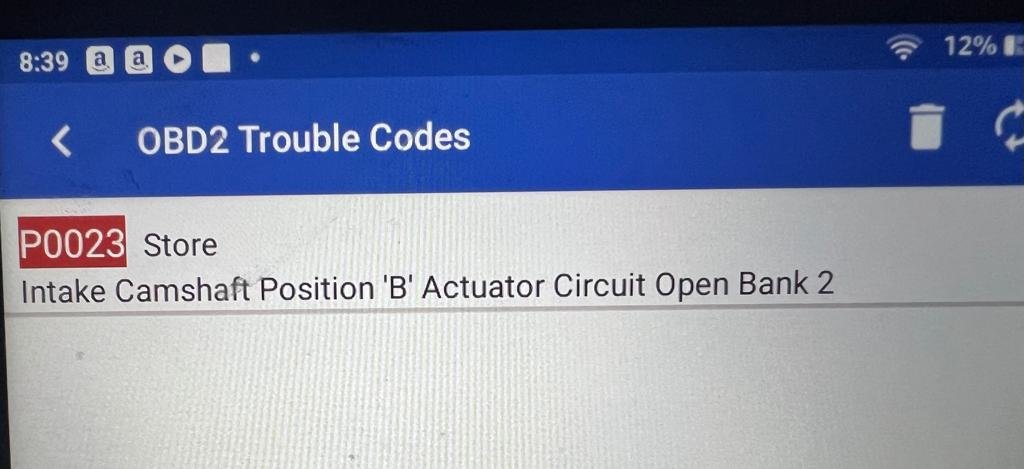

    I have a 2018 TRD Sport 4X4, last night I got the code P0023 and when reviewing the motor I found out that I have a broken connector, I'm trying to identify the name of the sensor involve... because that doesn't look like the Intake Camshaft

    I think it’s your vvt solenoid
