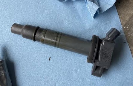

    My 2005 Taco Pre-Runner V6 (approx. 270K miles) engine light came on with code P0302.
    I have done the following but the engine light comes on and off every other day:
    1. swapped cylinder 2 ignition coil with cylinder 1 -> still got code
    2. replaced spark plug -> still got code
    I finally put in High Mileage Techron Fuel System Cleaner for 2 tanks now and the engine light comes on and off every other day.
    At this time, I think that I need to replace the fuel injectors.
    Question is do y'all recommend using aftermarket injectors or Toyota OEM injectors 23209-39015?
    Aftermarket is around $49 each as to Toyota $175 each.
    Please advise.
    Thanks

    Probably a video. Look at the coil tip and if it’s wet with oil, you need a VC job
  12. Mar 16, 2024 at 11:27 PM
    tacodudez
    tacodudez [OP] Active Member
    Mar 16, 2024
    #446002
    39
    Coil looked clean.
    How can I test to make sure that the injector is still good?
