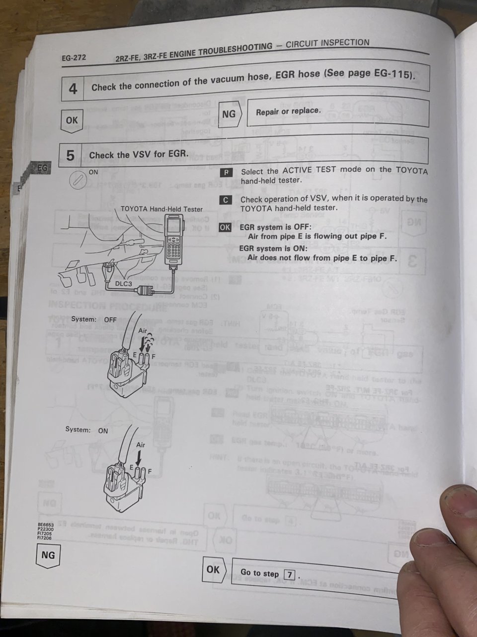

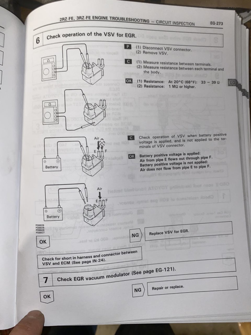

    This is from the FSM on how to diagnose this code. 6A01EEC0-E67A-4C6B-A581-159C31996EAC.jpg

    Could you take a photo of page EG-272?
    Thanks for posting these
    lo2hi and Falkor1 like this.

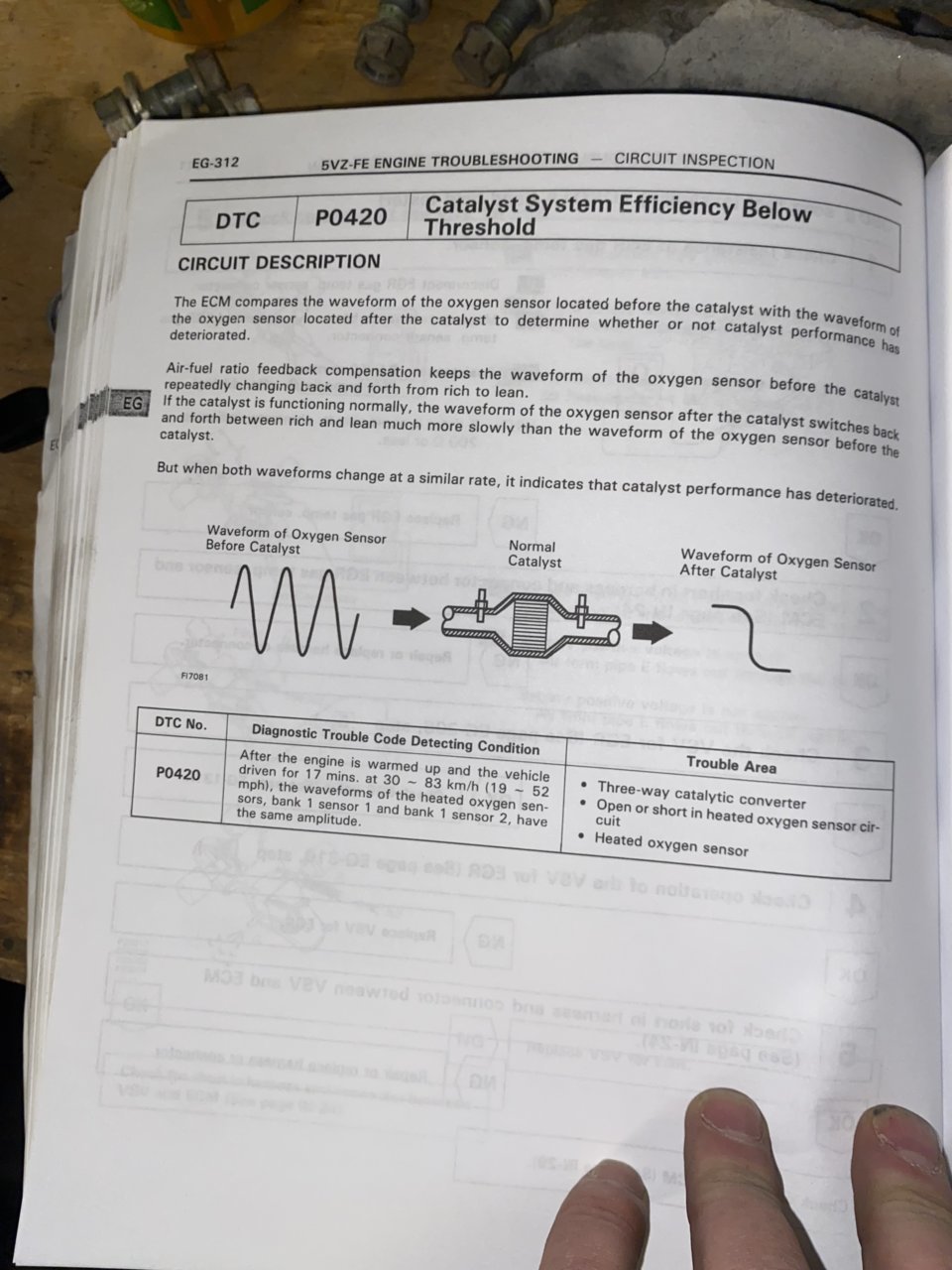

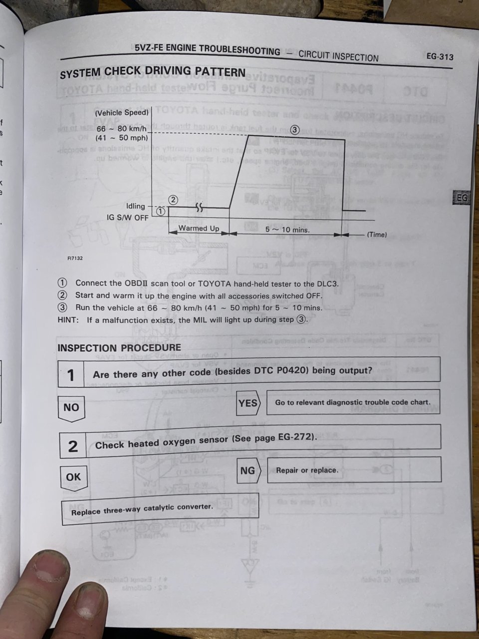

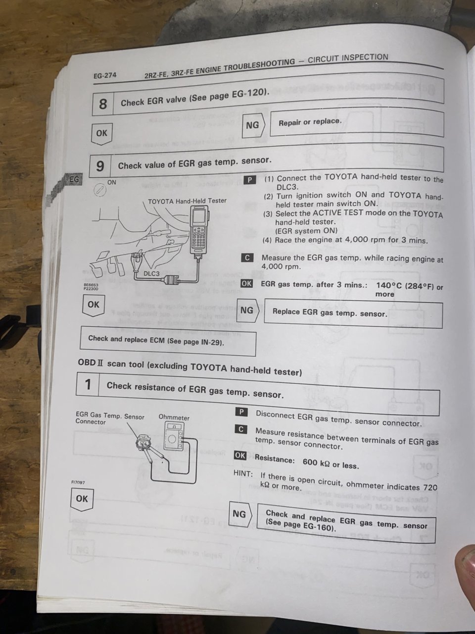

    Apologize for the late response.. 54EB72DD-F1E0-47D1-BD2B-553F76DEEDBE.jpgD4487096-EFD9-4CDB-A388-FBCEDD3FFAC0.jpg2953E53B-8697-4A53-9329-2A99A88994BE.jpg
