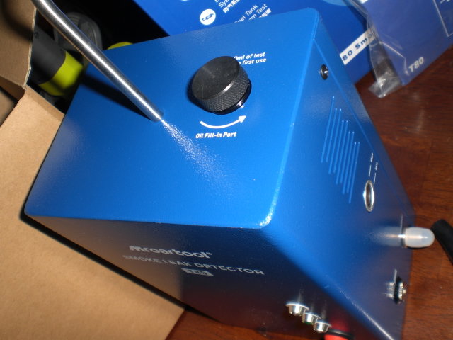

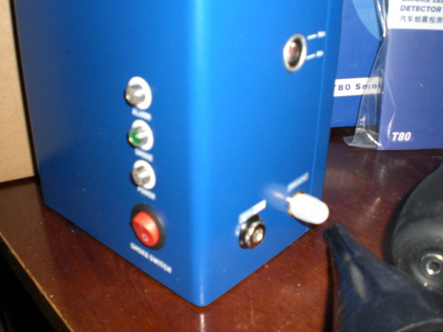

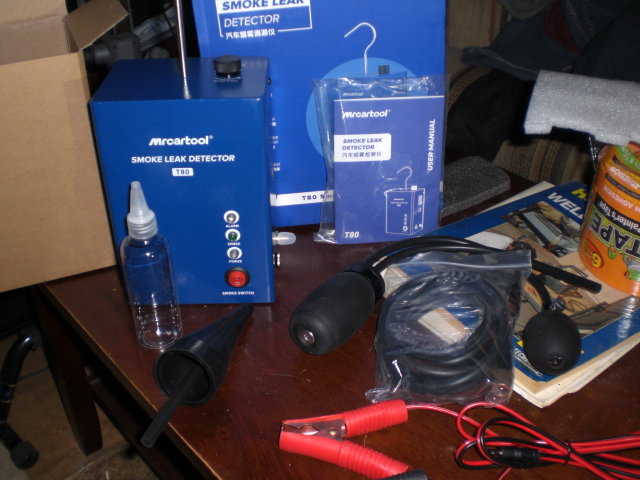

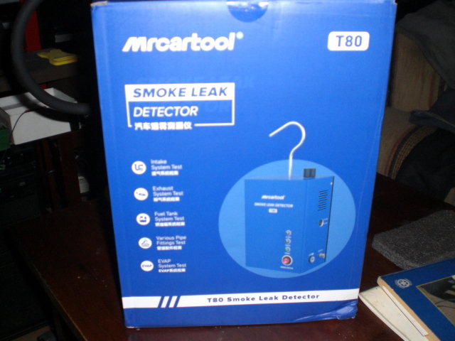

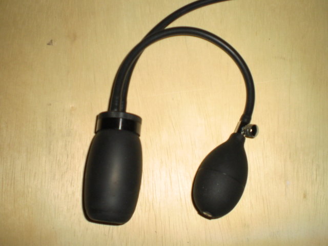

    3. This guy is great for finding vacuum leaks. Opposed to the break cleaner meathed. I've never had any luck with the spray or map gas/ propane.
    AutoLine Pro EVAP High Volume... https://www.amazon.com/dp/B07JVT1NG2?ref=ppx_pop_mob_ap_share
    Also most vacuum leaks cause a lean condition.
