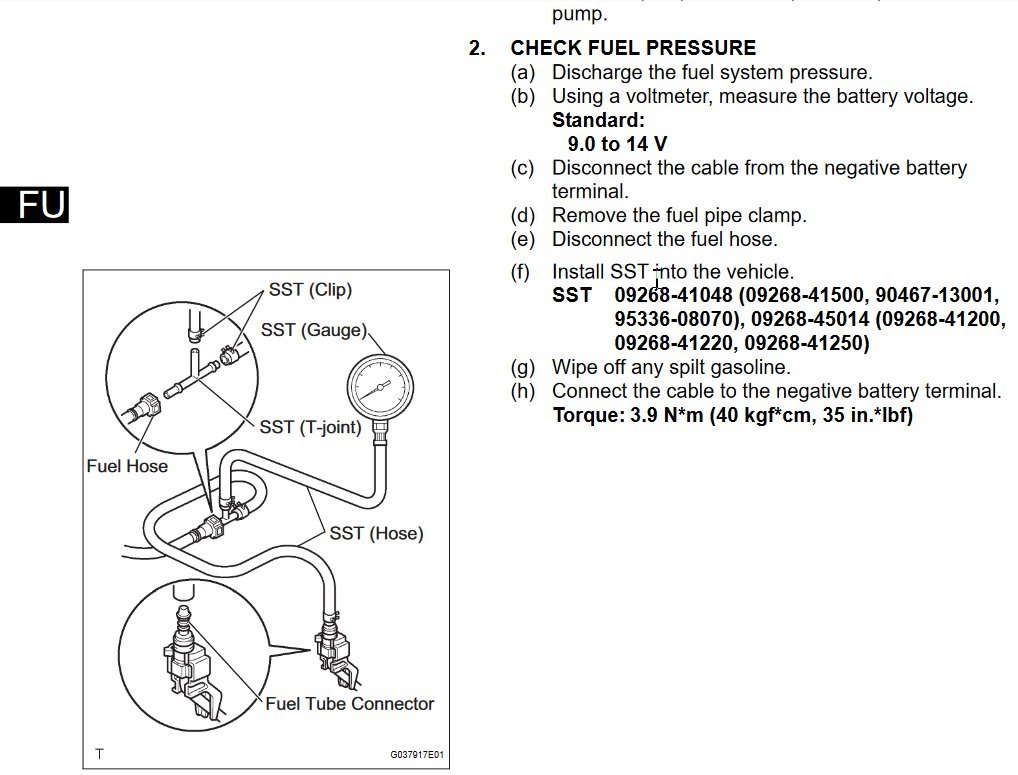

    Check the fuel pressure by teeing into the fuel supply line going to the fuel rail.
    Tank >> Filter >> Pump >> Fuel delivery tubing >> Fuel Rail >> Fuel Rail Regulator ( Set to ~ 40 - 41.7 PSI) >> Return to tank.
    If you tee into the delivery tubing the regulator still works and reads the regulated pressure ~ 40 - 41.7 PSI.
    If you dead head a gauge at the delivery tube it reads full pump pressure ~ 60 PSI.
    While idling:
    Standard: (40.8 to 41.7 psi)
    • If the pressure is too high, replace the fuel pressure regulator.
    • If the pressure is too low, check the connection between the fuel hose and fuel pump.
    Stop the engine.
    Check that the fuel pressure does not change for 5 minutes.
    Standard: (21 psi)If the pressure is not as specified, check the fuel pump, pressure regulator and/or injector.
