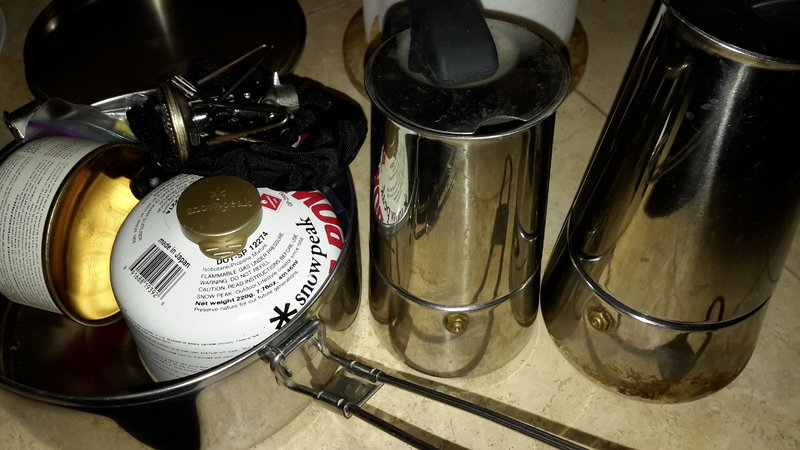

    no way you can run this off the bed outlet, I have one at home and the lights dim when it fires up lol.
    You need some kind of camping stove, use one with a compressed liquid/ gas like propane or isobutane as the white gas stoves above make a mess. They are great if you are trekking and may have to use unleaded gas in a pinch but that's about it.
    My truck camping coffee goto is this :

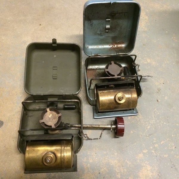

    Mine are the 8R, I thought they were Svea but you're correct that they are Optimus, at least the one with the sticker on it still. I have a Jetboil, an MSR and in fact several stoves, but I leave these in the cars all the time. They are part of the emergency kit, I don't typically but wouldn't have any issue burning nasty gasoline in them and I'm not going to do that with my nice stoves. They work just fine for their task. They were cheap (got the pair for like $5 at a gear swap) and they're rugged and not fussy.

    Those are way cool, I lived off a svea123 for 4 months once before switching to a whisperlite... very reliable , a Lil dirty w all the soot tho... I saw some military surplus multi fuel stoves the other day, going to pick one or two up for the SHTF /end of the world, haha, til then give me my compressed isobutane!

    Even though I still carry one as back up, the Svea 123 is an anachronism.
    The Svea 123 was introduced in 1955. It's a self-pressurizing design from about 1929. Heat from the burner pressurizes any vapor at the top of the fuel tank. So, no pumping is required, but the stove does need about a minute to warm-up the fuel tank -which is done by burning about 2 ml of Coleman fuel or ethanol in the circular well area. The well or donut shape fuel cup is directly under the burner. The warm up, also heats the vaporizer portion of the burner.
    Unfortunately, the flame of the Svea 123 and 123R - "once going at a full roar" -will only crank out about 1/3rd the BTUs of heat of the typical modern pocket rocket type, mini-stove that screws into a disposable Isopropane gas cartridge.

    Nah, that's unnecessarily harsh. They are just as useful now as they were back then for their task, which is to just work without a bunch of parts to wear out. Anyway, aren't they still made? Maybe not, I dunno for sure. But I know a few years ago they were still making them.
    They just ride around with some food, a cheap Sierra Trading Post pot and blankets for months and it doesn't bother them. Stale, dirty fuel, so what? In the truck I also have a Lexan French press and I'm king of dirtbags in the parking lot. Of course I don't carry them hiking or bikepacking but as as vehicle survival stove they are still fine. Unlike beer can alcohol stoves and wood fires they don't violate the fire restrictions currently in place, either.

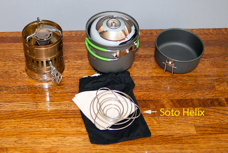

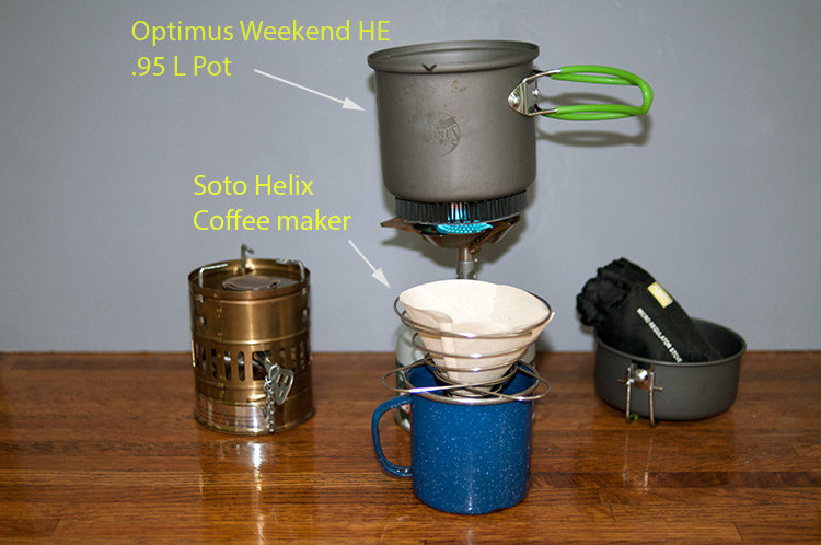

    My kit below, except for the coffee cup, all fits into a .95L cook pot. I use a collapsible Soto Helix to make drip coffee. With a modern stove, it takes me about 3 minutes total to make a cup of coffee. The water comes to a rolling boil in about a minute.
    The SVEA 123R on the left is to show a sense of scale. Notice how the Helix filter holder folds to fit into the cook pot with the micro stove, which is not visible and the gas canister.
    Fire in the hole with a set up of less than a minute. Within a minute, this set up will boil 12 ounces of water.
