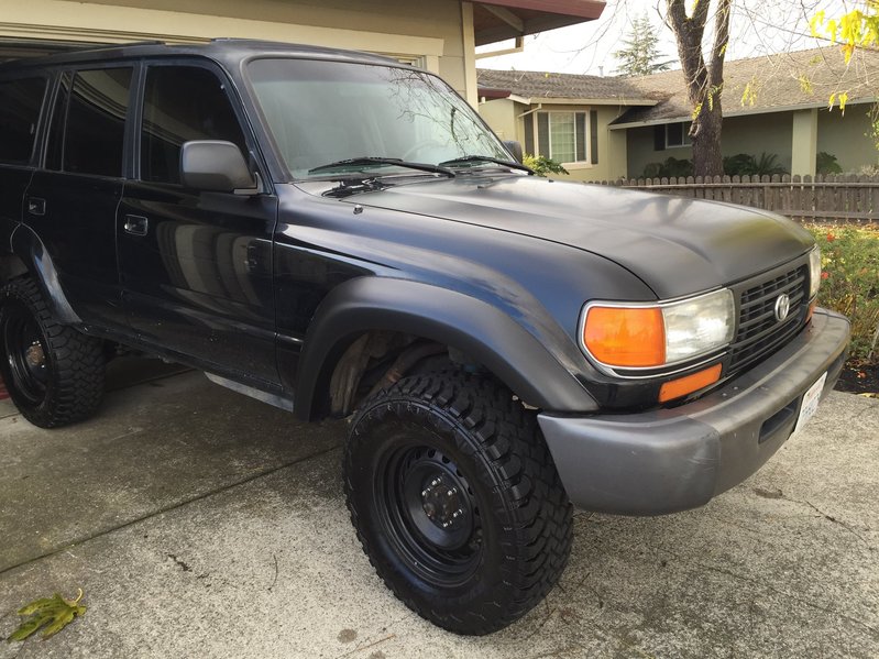

    not the best pic.
    @Box Rocket helped me out with many words of wisdom while i searched for mine!

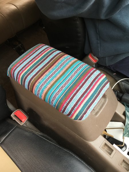

    we decided to ditch the stock torn up raggidy leather center console cover and go with something alittle more festive.
