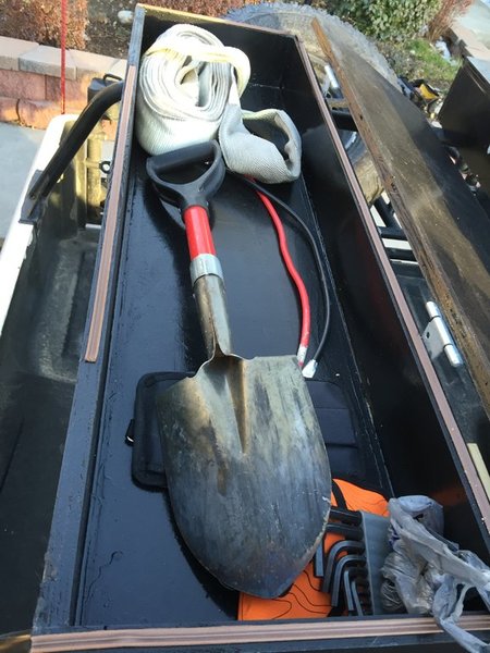

    Got the trax mounted up top, the relentless bed bar I got from Black Friday showed up so I got the mounted, and I mounted my cargo boxes.

    Matthew
    Lone Star Republic
    Supercharged '01 TRD
    Looks great. You just made those boxes out of wood?

    Pretty much stock with some crap welded to it.
    Yeah! I'm into them like 12$? I got all the ply for free at work.

    Any concerns with it holding up against weather? Now I'm thinking I could make something like this out of some thin steel to hold recovery gear so it doesn't bounce around in the bed...hmmmm
    First I ran silicon on all the gaps and such, then rubbed exterior glue on the end grains,then sprayed primer on it, then I plastered these thing in about ten layers of deck coating, I expect a few years, like I said, if they start falling apart I can pull the brackets off and make something out if metal, and use the same brackets.
    How do they secure to the rack? This would be good for me to put chains, straps, jumper cables...all the things I like to have with me but rarely use. I could stick the boxes on top of the shell and then I have a convenient tire to use as a step.
    I welded tabs to my bed rack and just ran two bolts to them. There solid
    Grab some exhaust clamps, and just bolt the box down with the bolts from the exhaust clamps. @MatthewMay1
