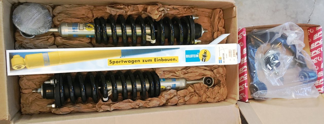

    Received Kit from Marie! Now looking into either buying or refurbing LCAs. Refurbing doesn't look difficult with the correct press and a torch, I'm in sw Florida right now so if anyone knows of a shop which could take the bearings out and replace I'd appreciate info. If I refurb I plan on getting whiteline bearings but not sure about ball joint, Moog seems to be popular but the reliability is a concern. CoiloversUCAs.jpg

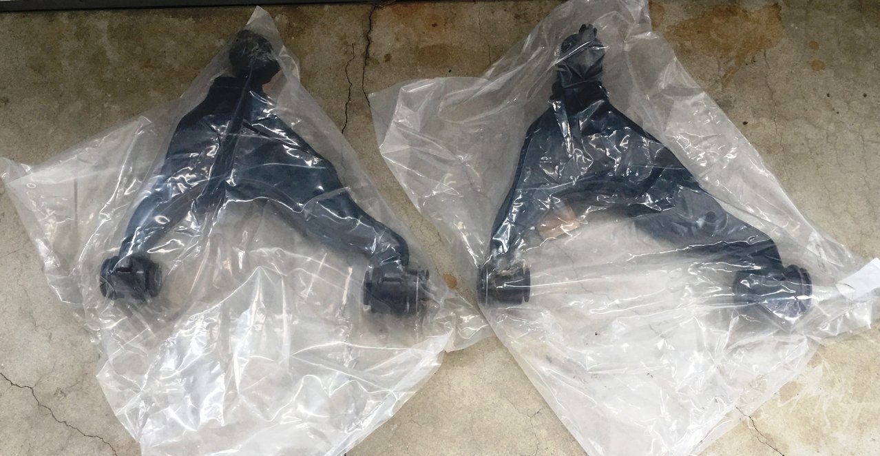

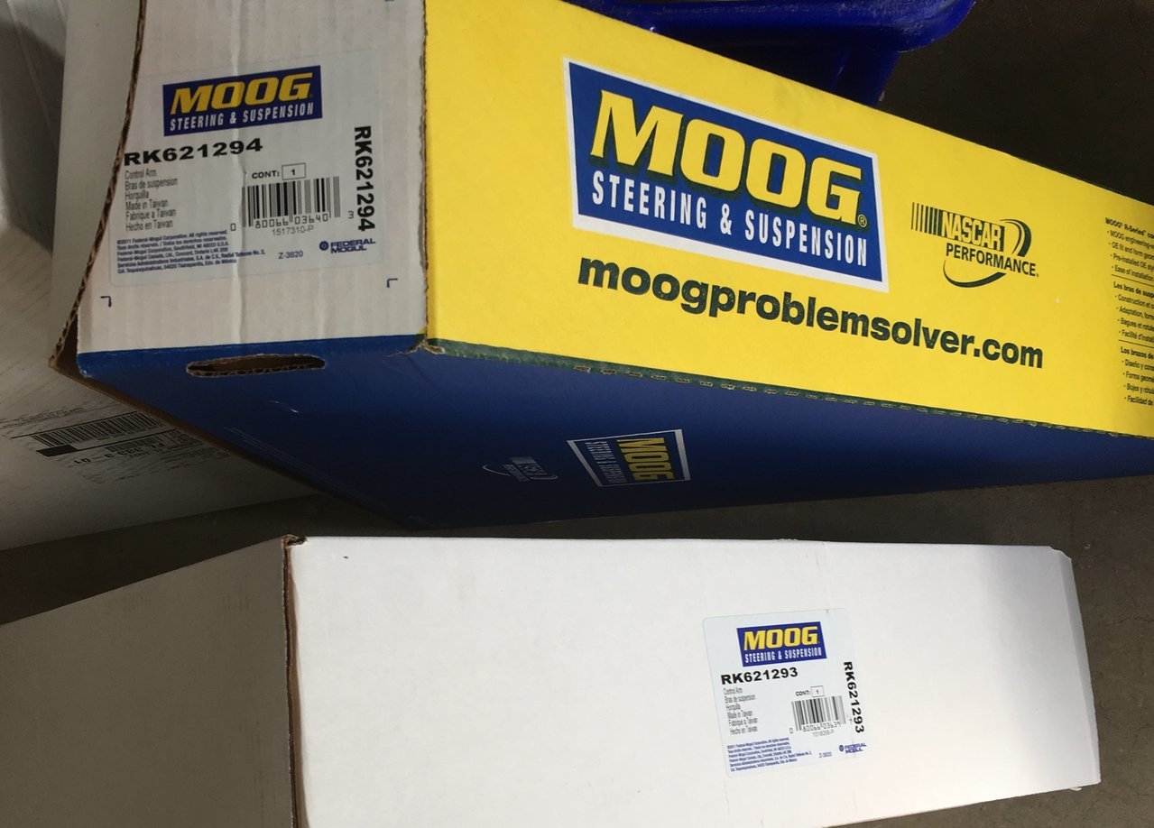

    So I ordered the LCAs and received them today.

    They sent the correct LCA. No cost, just wanted pictures of LCAs and boxes.

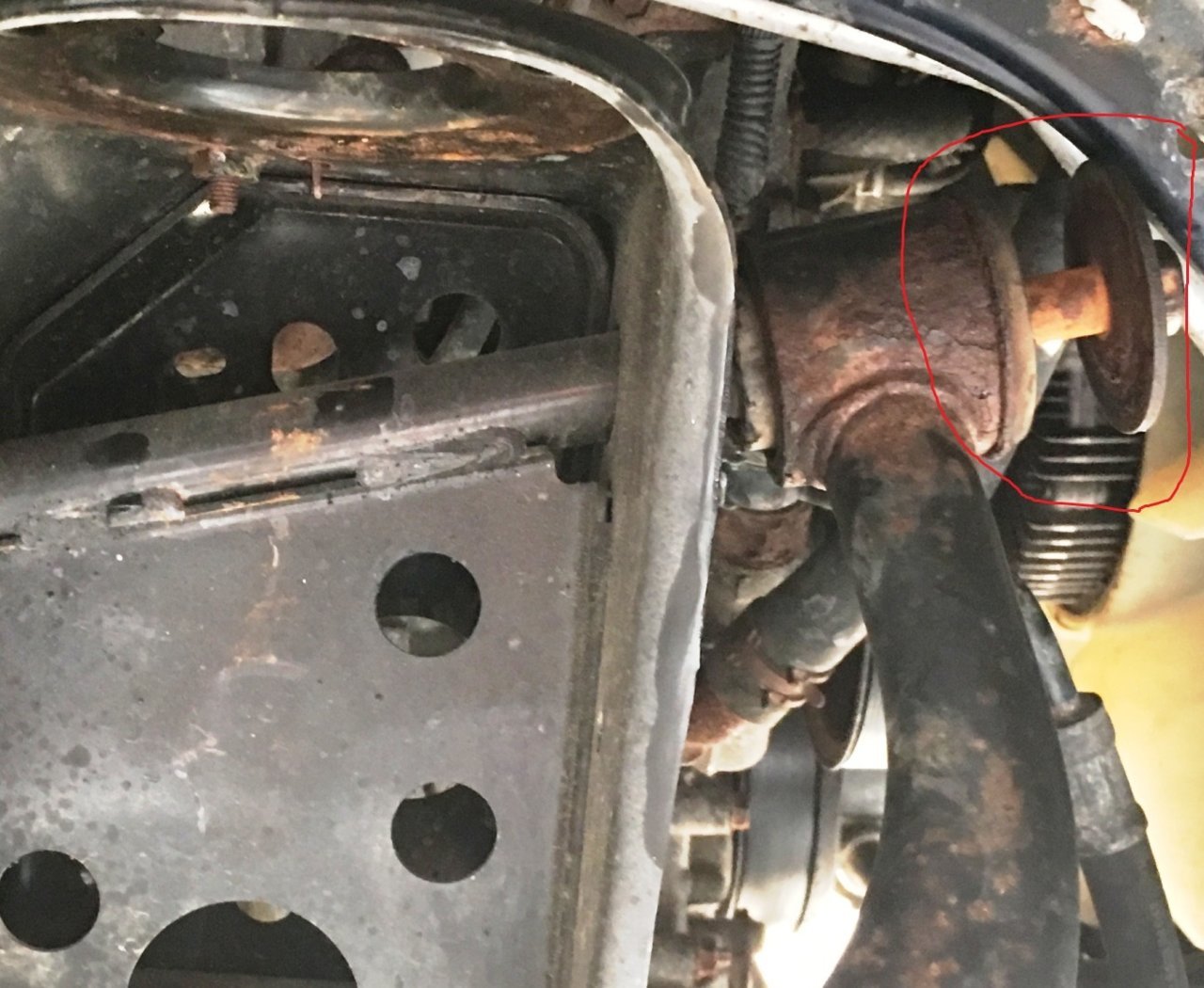

    Another question; how do the Toyota mechanics remove the UCA bolts without bending the frame or cutting them. I can see why they would want the nut on the bottom, nut falls off bolt can't fall out, so I want to install with factory orientation.

    Can't speak for Toyota techs, but you will have to bend some sheet metal to get the UCA bolt out. It's not too bad just some minor tweaking.

    Radar, do you bend in towards engine or out?

    Out

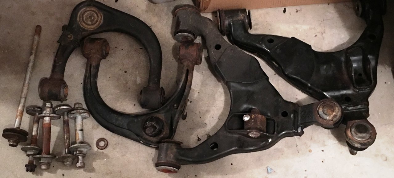

    Thanks for all the help! Fun project, done except for the alignment next week.
    I have the original UCAs and LCAs as well as some bolts I didn't need to cut off.
    Lot of miles, but maybe worth it for someone who is interested in swapping
    the bushings and bearings out with minimum down time. In SW Florida and only
