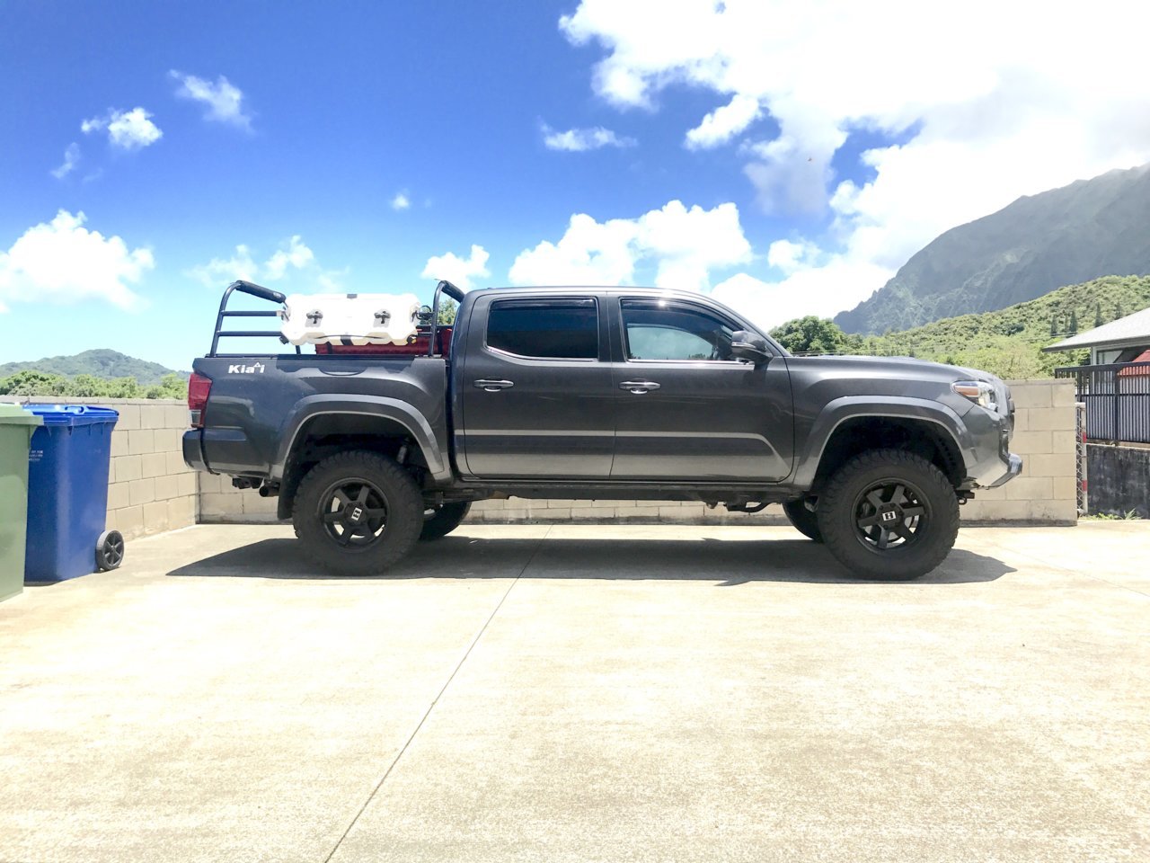

    Finally installed small spacers.
    Here's what 5100s with 888 coils plus 1/2" thick spacer on driver side and 1/4" thick spacer on passenger side looks like. Got around 2.5" lift up front and about 2.5" lift in the rear from the Dakar HDs. Very happy with how it rides. So smooth.
