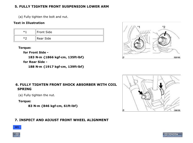

    I've not done it that way myself yet, but that is likely how I would do it if presented with the job.
    The LCA and shock bolt torque specs in the video are incorrect though.
    Correct specs (3rd Gen):
